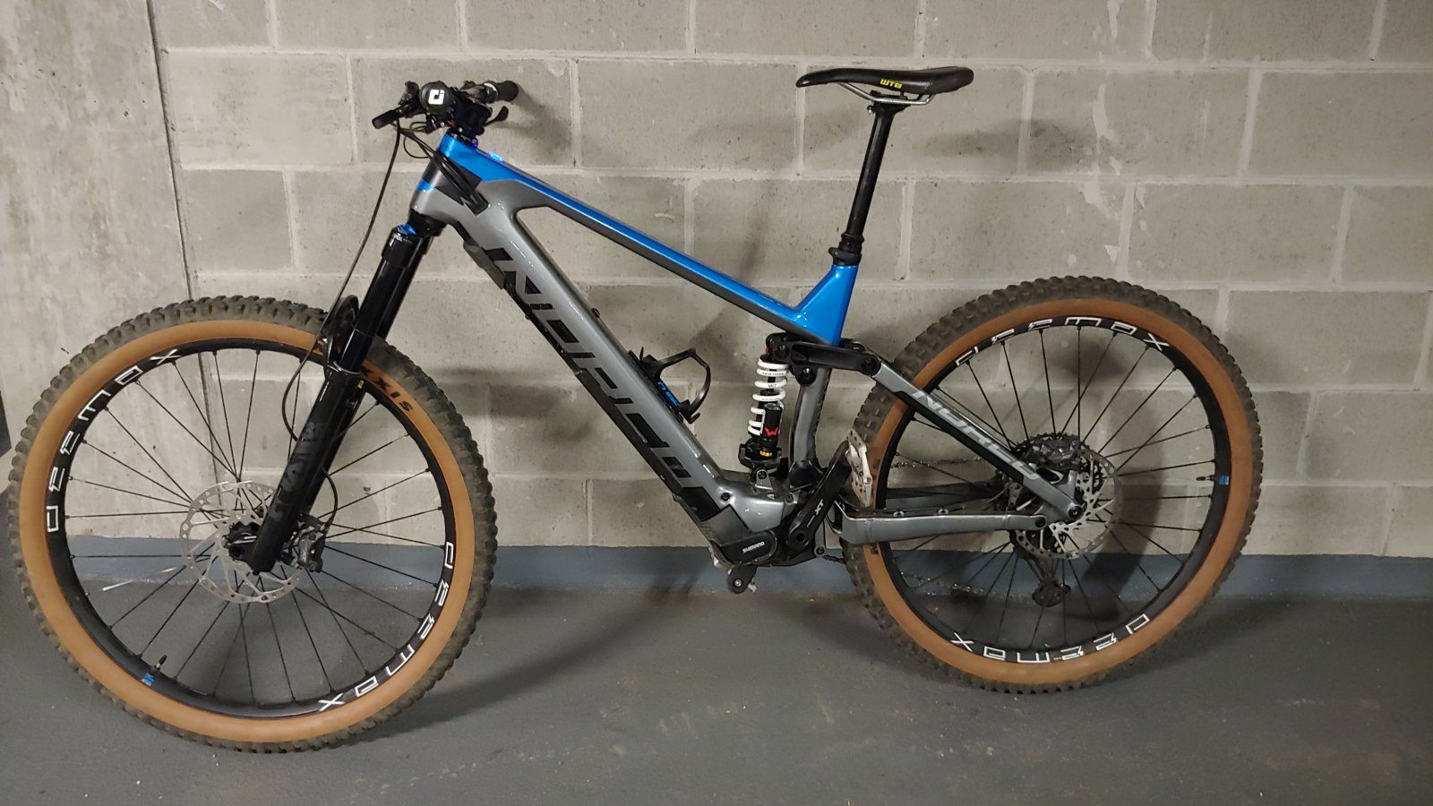

Just wanted to say hi. Bought a year ago but not much ridden. C2 build with fork and shock replaced with fox36 and bomber cr shock. 500-710lbs valt progressive spring for my 200 lbs. Feels pretty good ))

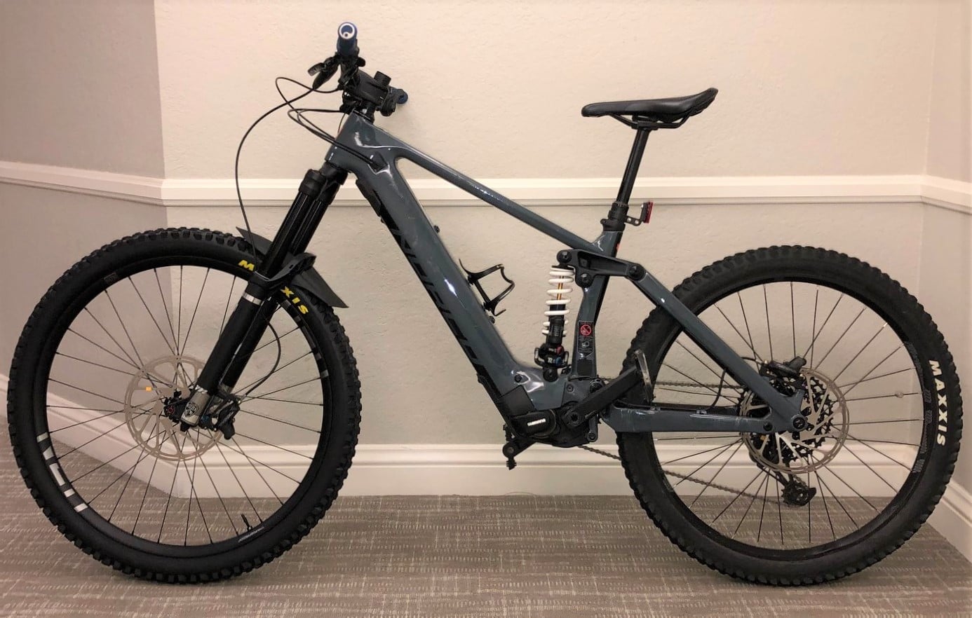

im done setting up my sight vlt’s.. confident enough with my current setup and it feels good in traction in all direction. running cane creek db cs coil shock with cane creek progressive 500lbs-610lbs spring. fox 36 elite 170mm travel with 2.8 butcher tire front and 2.6 butcher rear, 35x35 chromag stem and 760mm chromag carbon handlebar. awesome ride in all types of terrain.. enjoy the ride guys
Looks awesome can you give me details for suspension size and bushings you used to put coil instead of 185/55?thnx

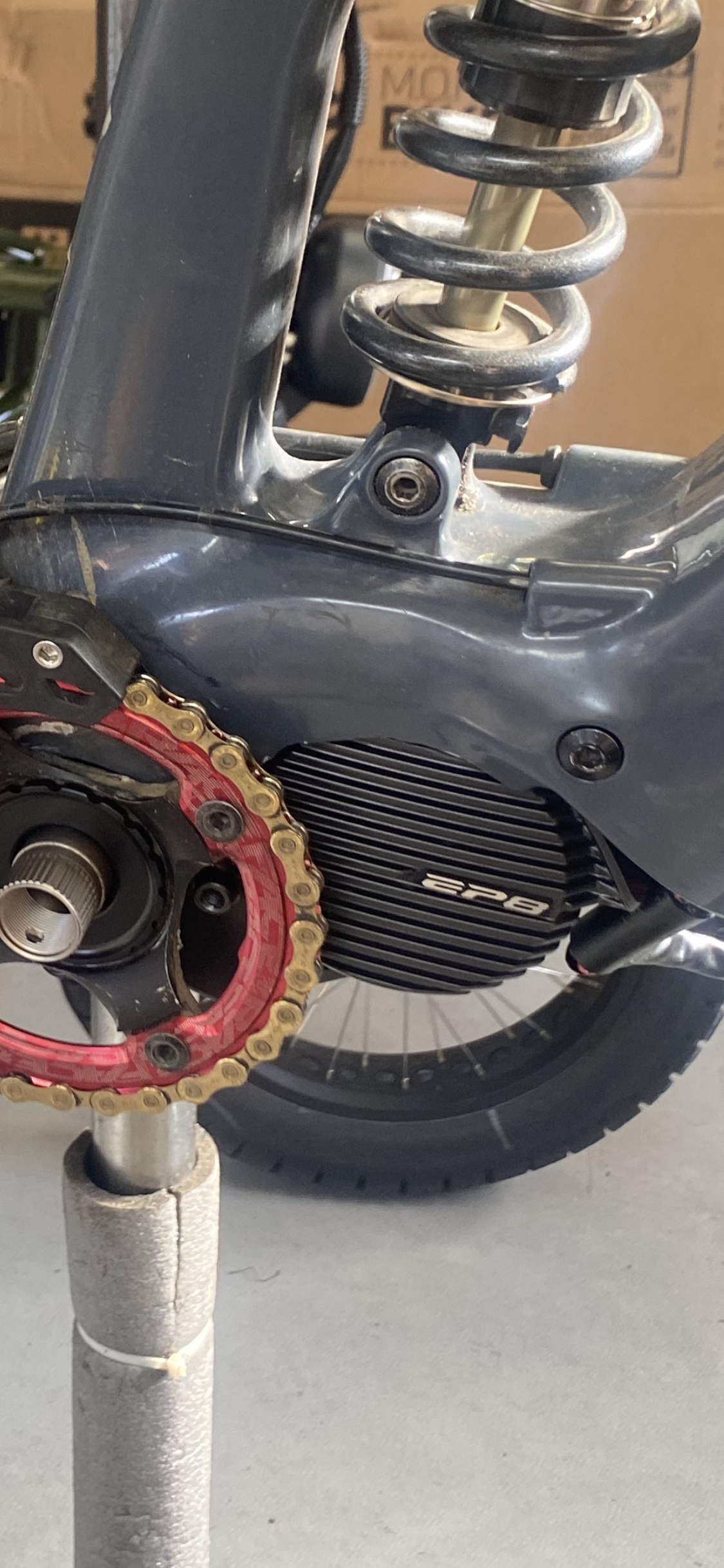

Purchased a Ep8 online to bolt into the 2020 Range before mimicking the procedure to the 2019 Sight....
Took to the bike workshop, installing the first 2 bolts, front position of frame motor to swing into place, eyeing off how it sits before removal to a small piece from the frame, all going ahead well....
Next, so close but yet so far, motor reaching its inline position for the next 2 bolt lugs position.
The EP8 became restricted by frame, or the top of Ep8 the "spine" of EP8 compresses up against frame, roughly at the shock mount region.....

The EP8 will not line up in the 2020 Range Vlt.... due to the frames moulded design at the shock mount bearing.... is taking up space with the motor cavity....
The Sight Vlt and the EP8 bolts in.... some grinding away to a small restriction of carbon.... Bike still at shop awaiting for the cables and display....

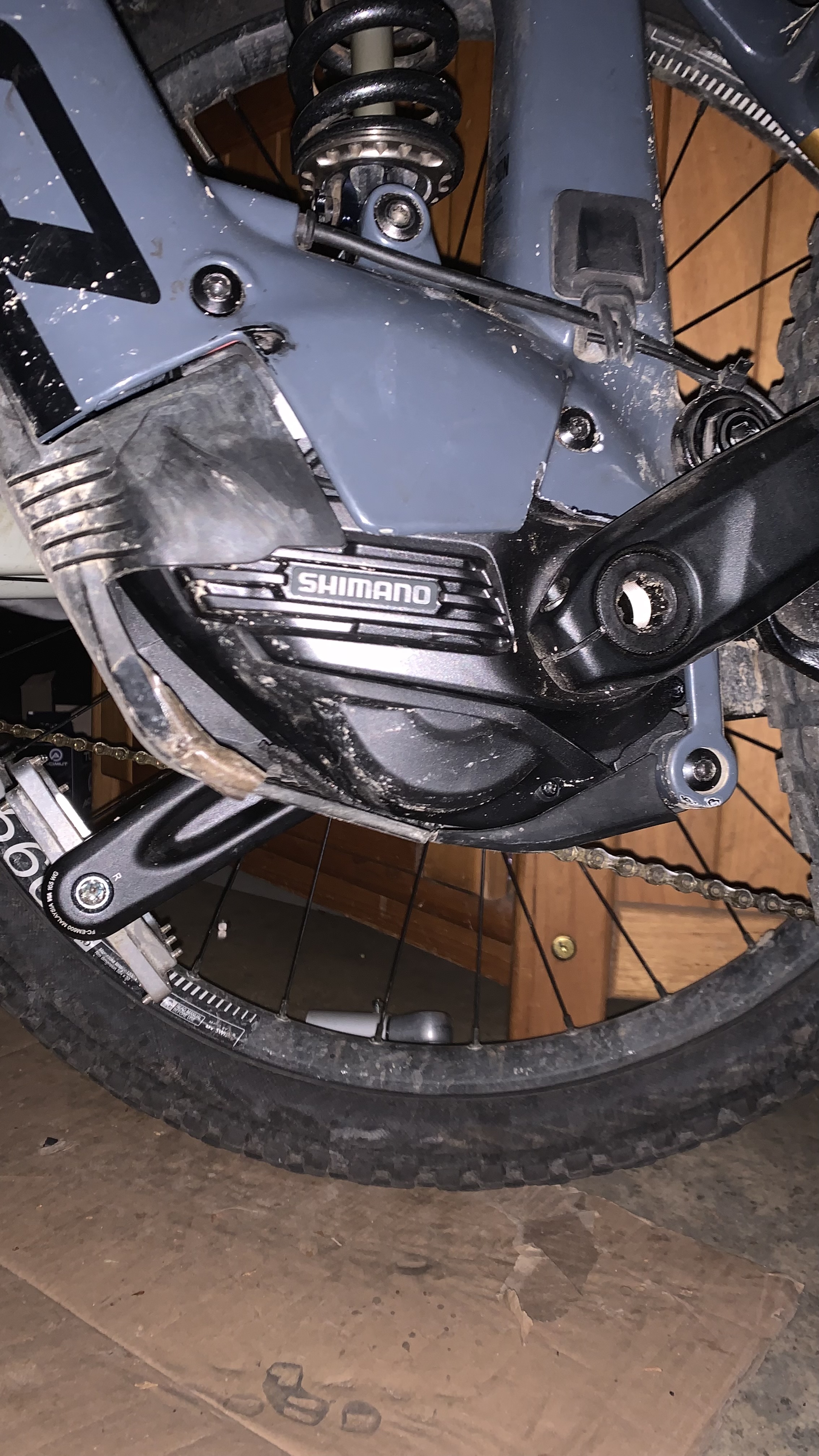

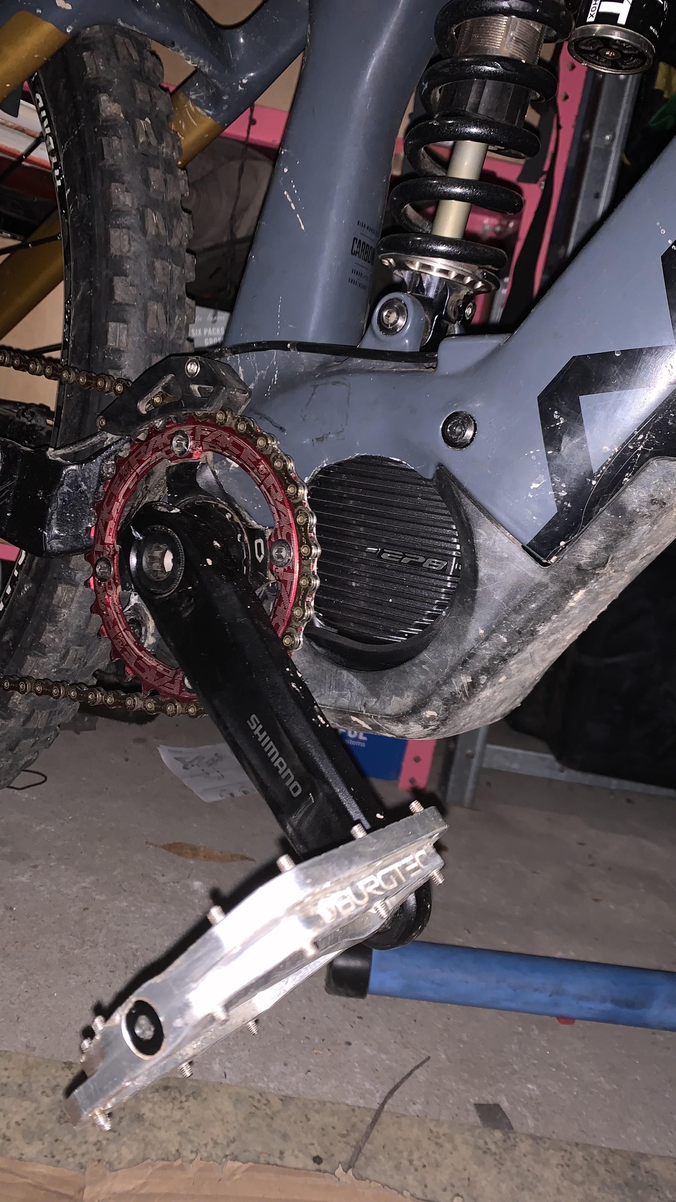

Ep8 has been working well.... ep8 lower guard fits snug under the steps guard.... just on noting we kept the rear of the steps speed sensor cable, leaving the magnetic reader as is for the spoke magnet... cut both adaptors refitting tape or soldering the ep8 adaptor to complete connection to the ep8 motor....
