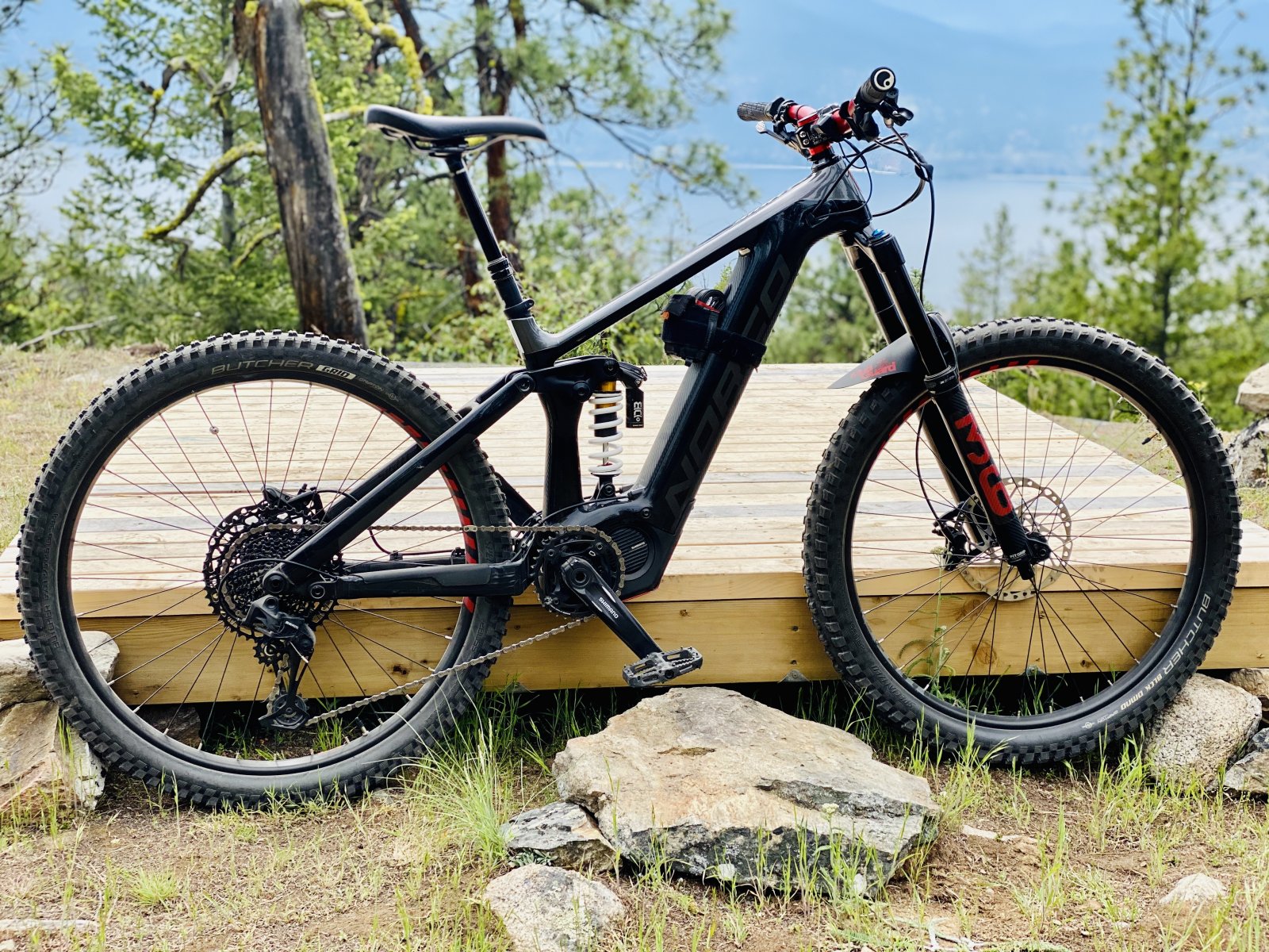

im done setting up my sight vlt’s.. confident enough with my current setup and it feels good in traction in all direction. running cane creek db cs coil shock with cane creek progressive 500lbs-610lbs spring. fox 36 elite 170mm travel with 2.8 butcher tire front and 2.6 butcher rear, 35x35 chromag stem and 760mm chromag carbon handlebar. awesome ride in all types of terrain.. enjoy the ride guys
