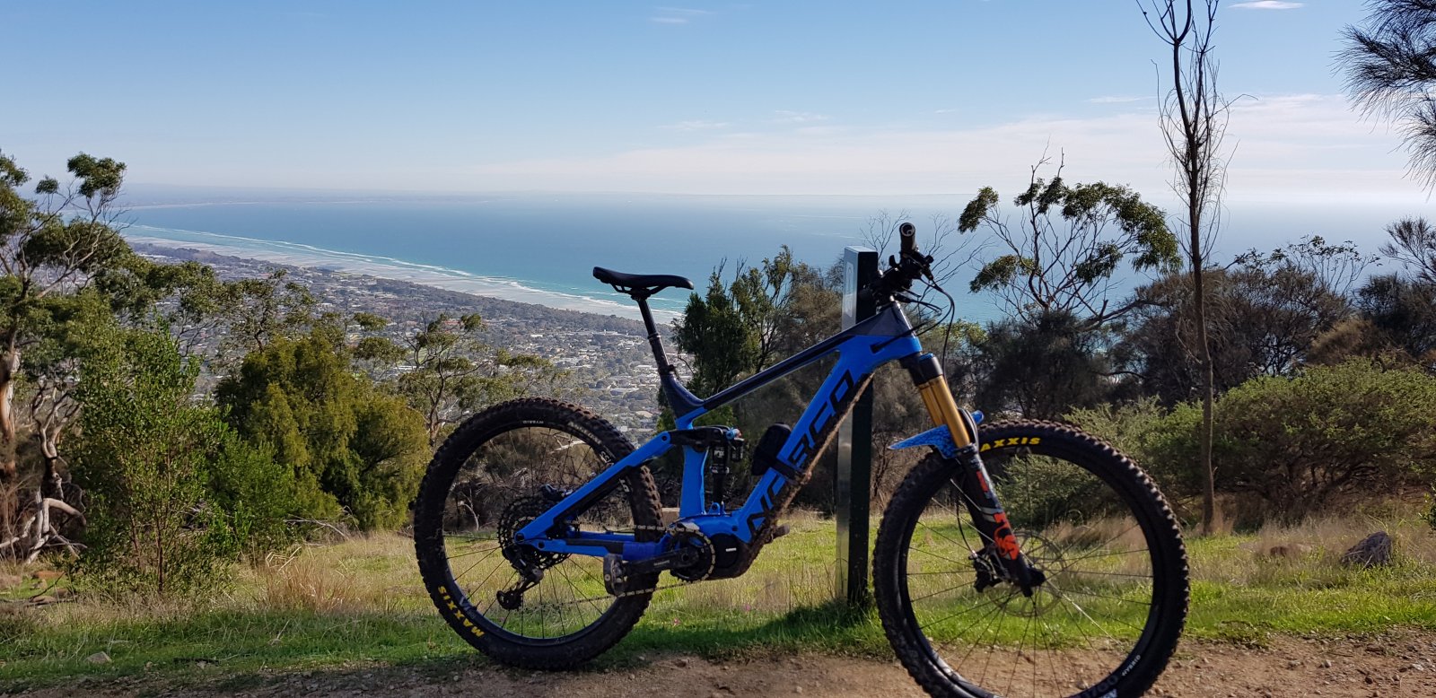

I have the mullet on my yt decoy. Its been fun. I can get the rear loose in the corner sometimes. Not yet sure if thats the mullet or the ewild. I have a fresh 27.5 rockr2 to swap on it to try but the ewild has been generally quite predictable and supportive and its been fun climbing throw wet roots and some mud sections in the fall. I can get the rear loose but its when im trying too but it seems ez to do. Rockr2 like the dhf's weak point is mud so that rockr2 will have to wait til spring. Figured i need to give this moto set up wider rear/normal front mullet set up a go

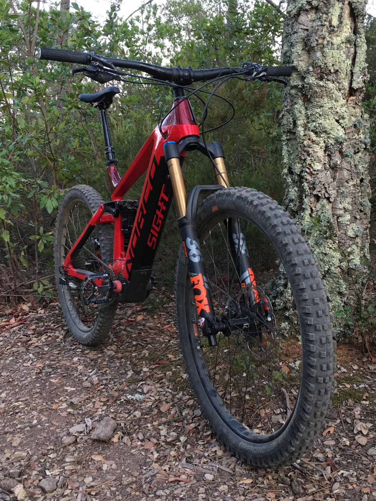

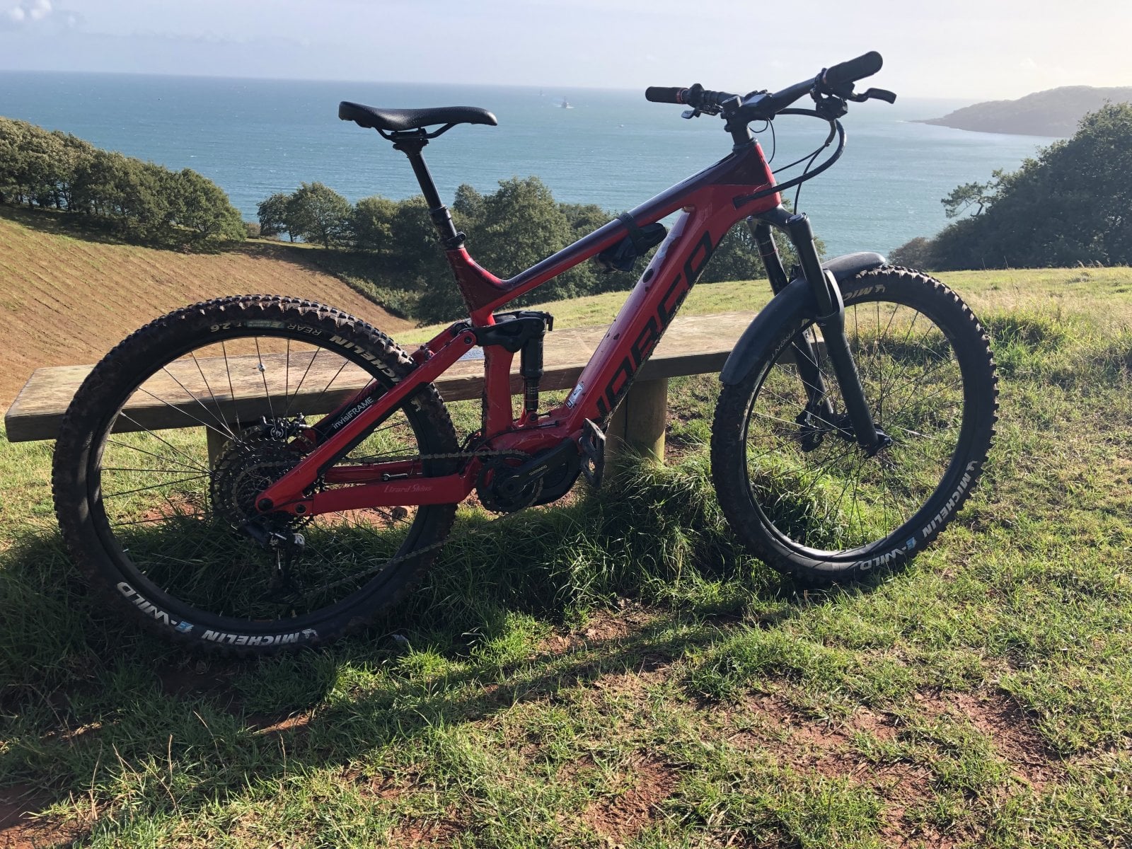

After suffering a couple of rear end pinch flats swapped out the original Exo DHR for a Michelin rear E-Wild 2.6. Way better side wall support. Now running a 2.6 E-Wild front too. Great tyres imo and not that pricey ?

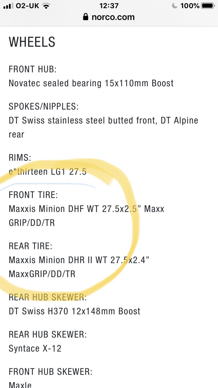

TBH the 2.6 E-Wilds don’t come up any bigger than Maxxis 2.6s they replaced. However I see Norco are fitting a more suitable Maxxis 2.5/2.4 DD WT combo on the 2020 Sight VLT now
Ya i noticed after i posted that my 2.6 ewild isnt much bigger than my 2.35 rockr2. Itd be even less of a dif if they were both on 35mm inner rims. Their measurements seem to vary. I recently bought a 2.35 wild performance for my trail , thinking itd be the same as a 2.5 maxxis because my rockr2 is , and was disappointed that it measured a true 2.35

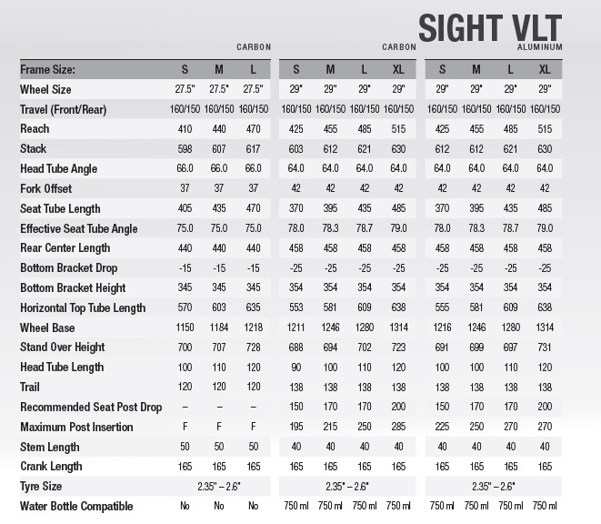

there you go.... I wonder if they changed the bottom bracket height at all. They can’t really make the cranks much shorter than 165. I’ll have a look
Nope. BB stays the same. Except now it comes with a Lyric instead of my Pike and Guides with Code callipers ???

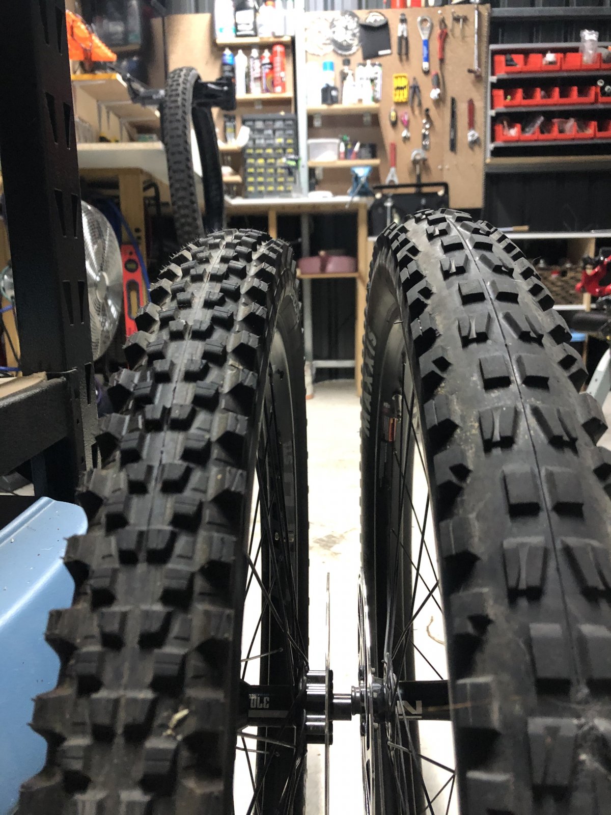

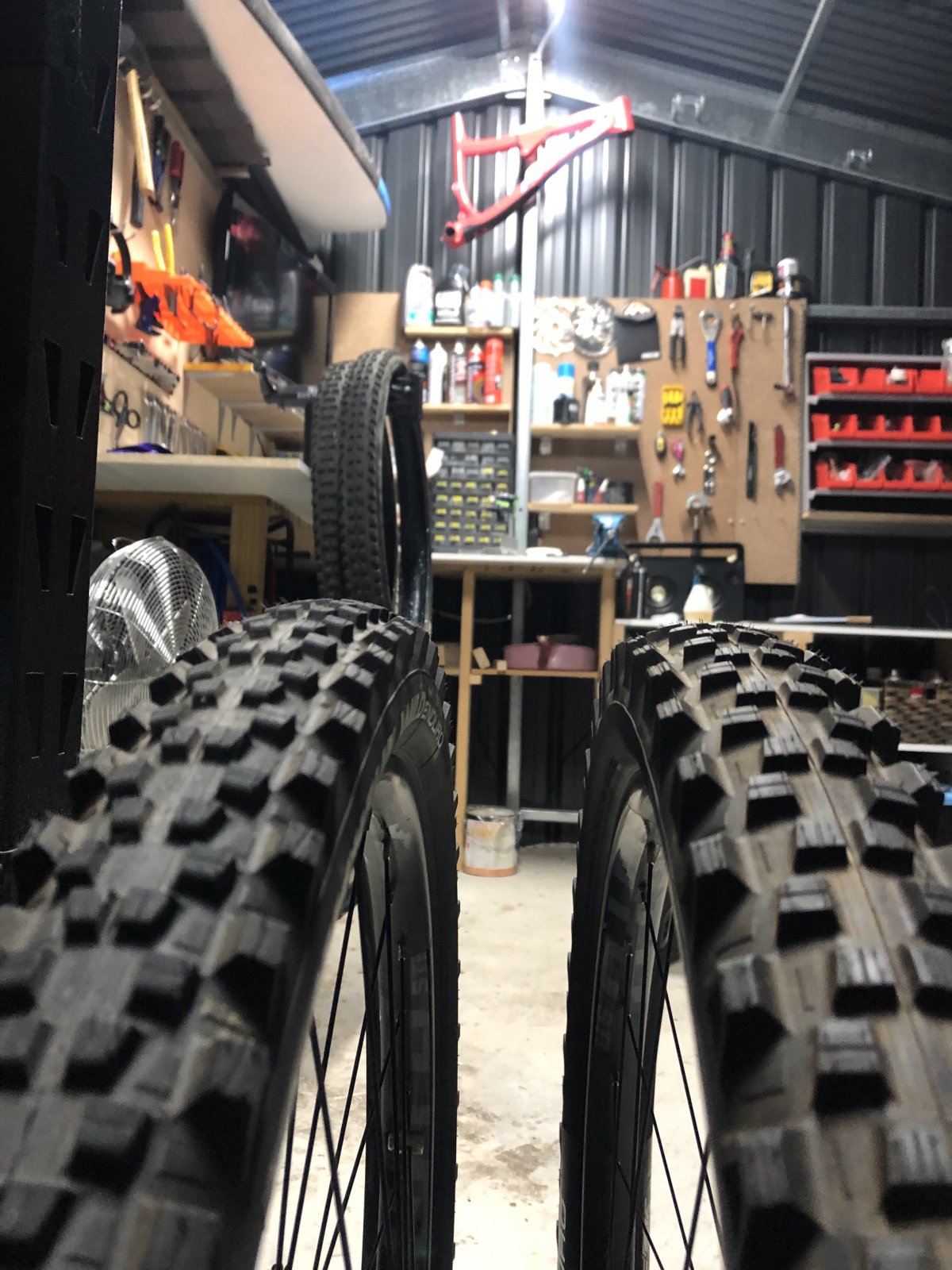

Just mounted them.

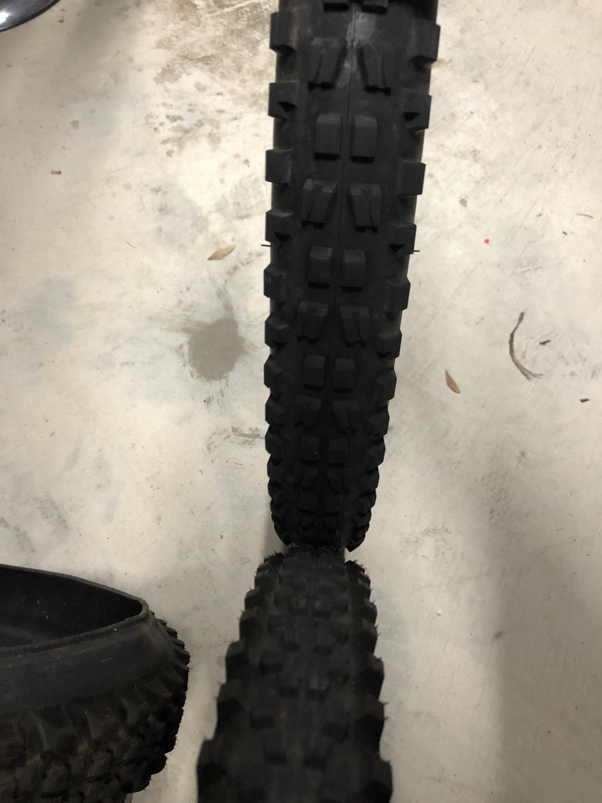

The first pic should be if the wild enduro 2.4 (rear) next to the DHF 2.6 (front) Width is pretty well the same but there’s a Pretty big difference in height! Over 5mm. 5mm might sound like nothing to some but try going back to a 170 or a 175mm crank and tell me you don’t get more pedal strikes. Pedal stike at speed is not fun. (Google Richie Rude pedal strike and watch his crash)
The second picture is the the same tyres but just in front of each other to show width. last picture is both Michelin front and rear next to each other. Let’s see how they ride ey?
Took it for a 30km ride today. Bit of trail and dh stuff. First off... noticed straight away that the ride was a bit firmer. Kind of like going from carbon bars back to alloy (not a massive difference but you feel the lack of cushion from the previous 2.6 balloons). Second thing I noticed is the confidence you have with these tyres when you want to plough into a rocky section!!! No deflections or squirm... just point and shoot. So good and very compliant. Not quite damped as the SuperGravity casing (gold writing) on the magic Mary that use to be on my last bike, but much better grip on off camber sections due to the squared off profile (almost too square but very similar to a E13 trs). On tarmac it was not too noisy and rode much the same as the DHF dhr combo but when leaning it over on the road one has to be careful as the squared profile doesn’t have much to grip with like it would on dirt. biggest surprise was the rear tyre (wild Enduro rear). Sooooo predictable and the perfect shape (not too round that it loses traction on steep stuff but not too squared off that it sucks in flat turns or rolling resistance). Front I ran at 20-21psi and rear at 22-23. Will try different pressures next time but I think it’s about as good as they will feel without any inserts (huck, procore). And the drop in the bottom bracket?... well it’s noticeable. But honestly it ploughed through rocks so easily that the bb probably felt taller because it wasn’t bobbing up and down hence keeping the bb level. I’m not the best jumper in the world but when I tried to ‘style up’ a little hip jump I landed a bit too crossed up on my front wheel and I thank god that I had the Michelin on the front because the 2.6 DHF would have folded under itself and I would have been over the bars!it just lands jumps with no extra bounce (but with a little more harshness).

458 rear center though. Id rather mullet the current one, -1 works headset, and slide the seat forward , and have the 440 rear center
You know, I almost bought a -1 headset the other day. Someone was selling it locally and would have been a perfect fit. But not without putting a Lyric at 170 on it first.
Works components are pretty good quality as well. The headset and 170 fork together would effect the seat tube angle and bb height very little. Be a nice HA too.
The new one has a shorter toptube but a bit more reach. Sliding the seat forward on the old one probably makes the toptubes similar length.
