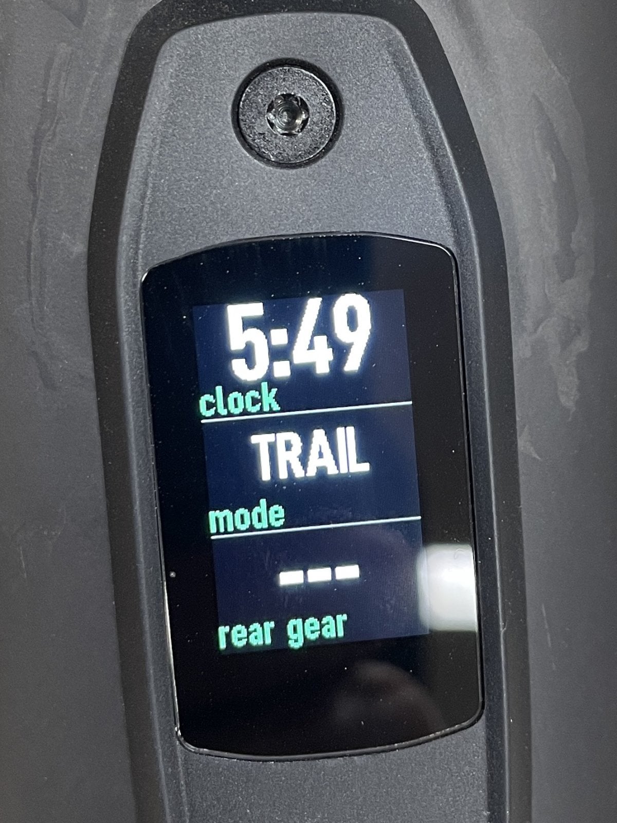

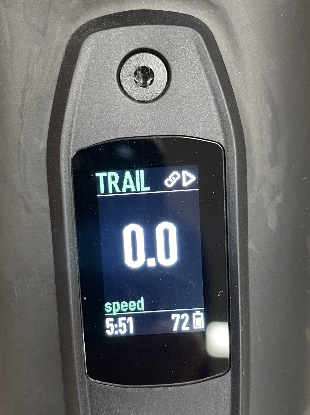

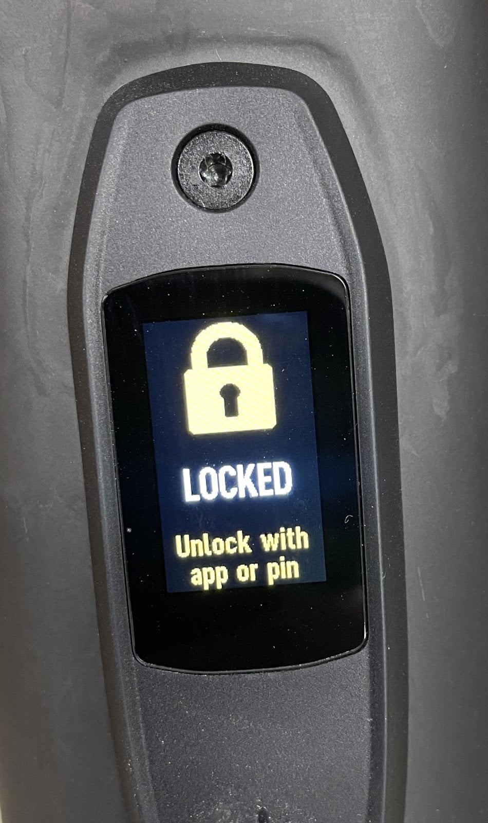

Updated 2022 Levo with Mastermind TCU this morning. Update took around 5 minutes and successfully updated firmware on motor and display . Battery had no update.
Took a 25 mile ride and didn't notice any difference in motor or anything else other than the display.
Display has a small "linked" icon and a little arrow pointing to the right in upper right corner. Not sure what the arrow is referring to.
There is a lock feature which works well so that no one without the assigned PIN which the app provides can activate the bike electronics. You lock and unlock it thru the Mission Control app.
Another feature in Mission Control is your option to custom display your derailleur position and its battery level, obviously only if you have the SRAM AXS system.

“Display has a small "linked" icon and a little arrow pointing to the right in upper right corner. Not sure what the arrow is referring to.”
I read somewhere yesterday what that was but can’t find it. I think it was when you are recording a ride through the app.
