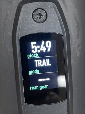

hey how did you get axs on the screen.
Note: this requires MasterMind TCU firmware 31.C.0. or higher and the latest Mission Control version.
Steps to display AXS information on MasterMind unit:
1. Turn on bike
2. Enter setup menu of MasterMind display (keep +/- buttons on remote pressed)
3. Navigate to: Sensors / Pair ANT / Shifting
4. Confirm "Shifting" with F1 remote button
5. Press AXS rear derailleur button once to pair RD to MasterMind TCU
6. Make sure pairing to AXS is confirmed on MasterMind display
7. Open Mission Control and connect to bike
8. Go to TUNE and CUSTOMIZE DISPLAY
9. Create AXS display field to see AXS data on MasterMind display

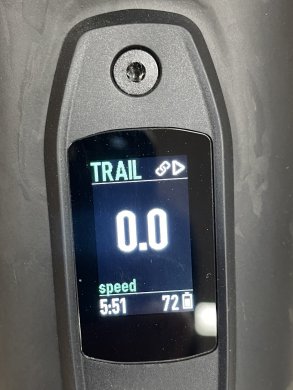

Display has a small "linked" icon and a little arrow pointing to the right in upper right corner. Not sure what the arrow is referring to.

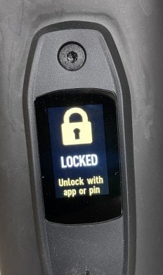

There is a lock feature which works well so that no one without the assigned PIN which the app provides can activate the bike electronics. You lock and unlock it thru the Mission Control app.

“Display has a small "linked" icon and a little arrow pointing to the right in upper right corner. Not sure what the arrow is referring to.”
I read somewhere yesterday what that was but can’t find it. I think it was when you are recording a ride through the app.
