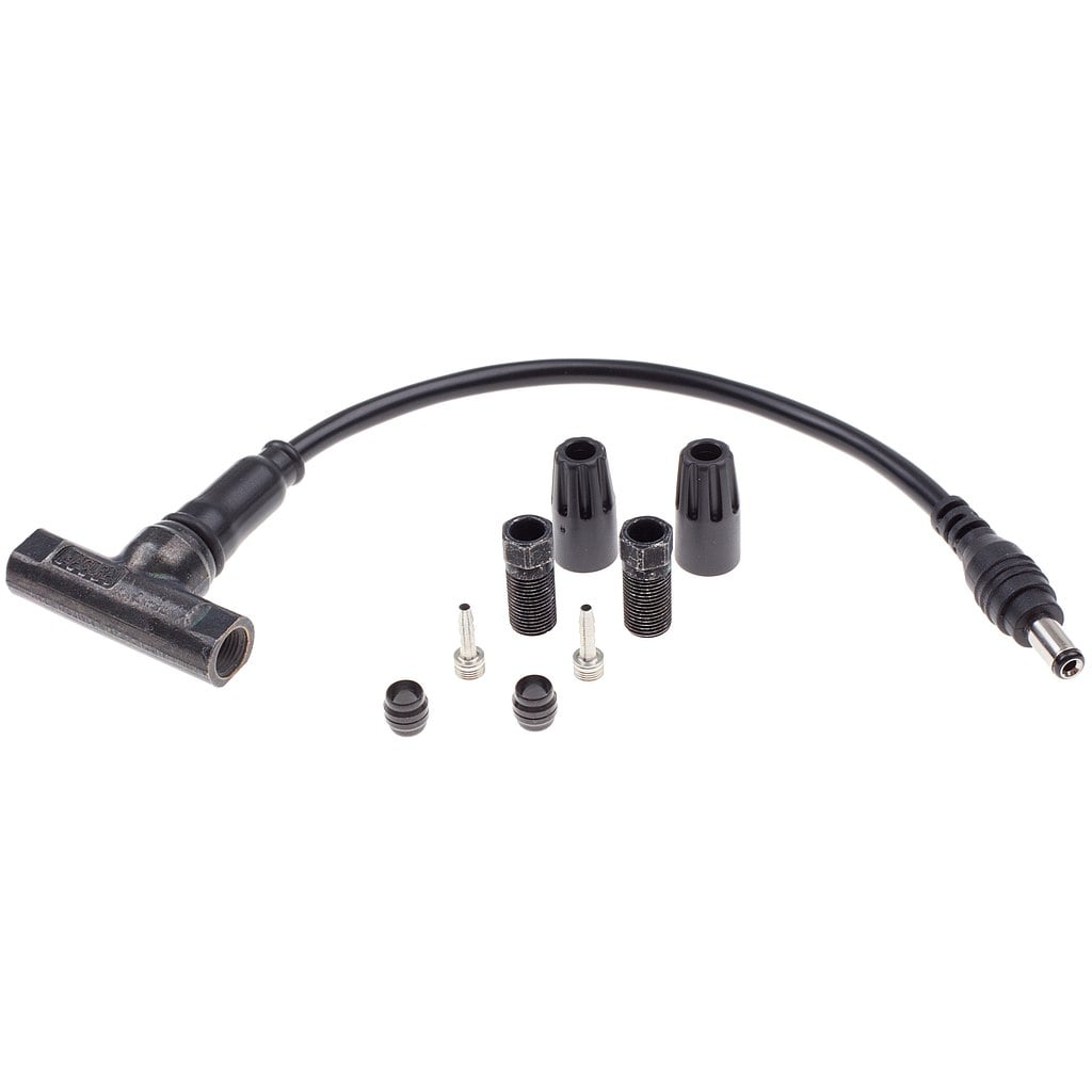

Brake sensor
You can put a switch in the hydrailic brake line. Magura makes them. That is clean and can be mounted anywhere (in the brake line, F+R)
Is it really necessary?

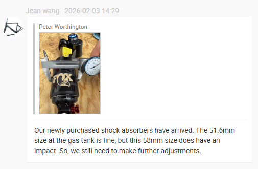

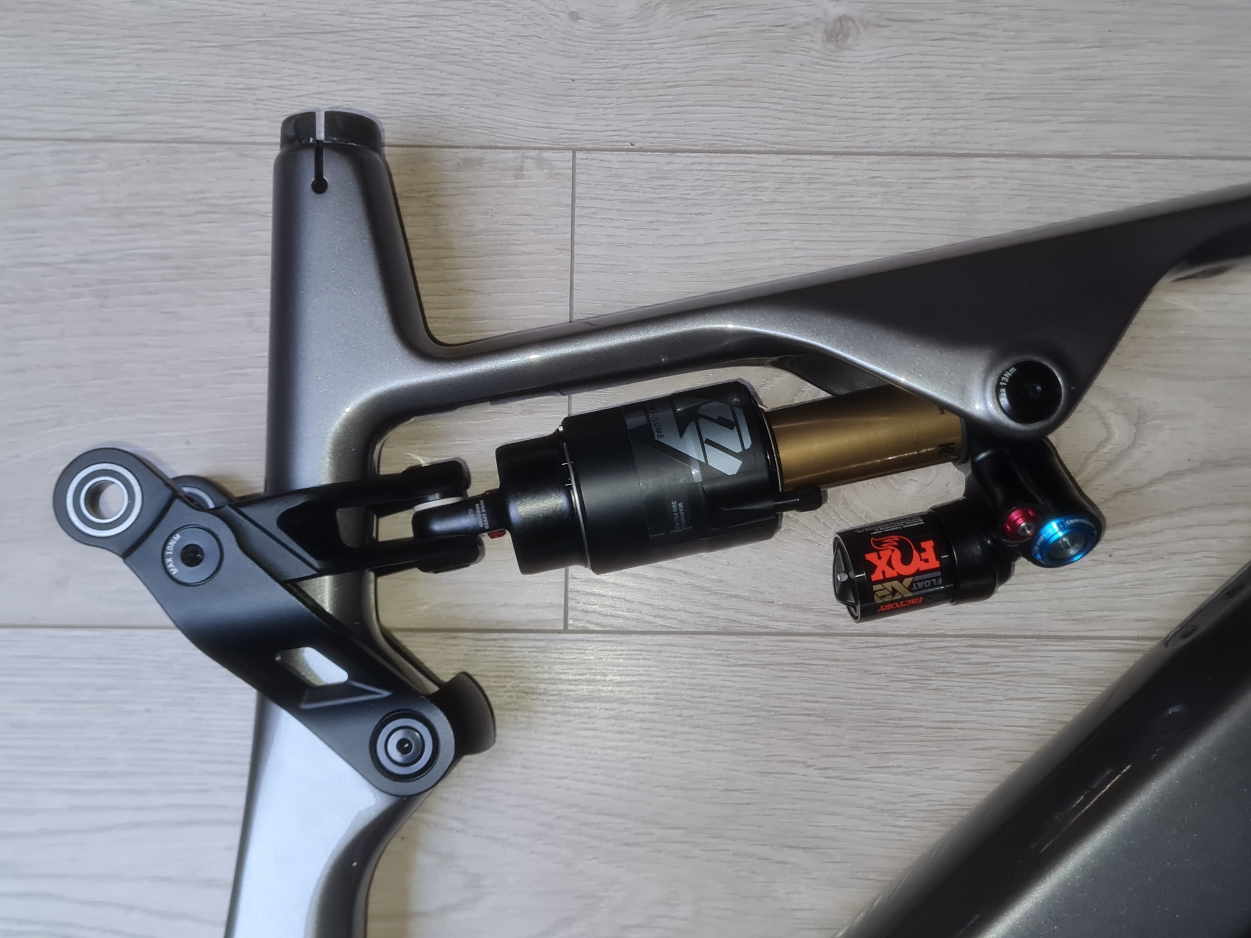

I have been back and forth with Jean about the Linkage, They have it working for the X2 2025 earlier (id imagine every other big shock) I mentioend the 2026 is bigger and provided the below photo from Fox they sent me.
So i guess back to the drawing board.

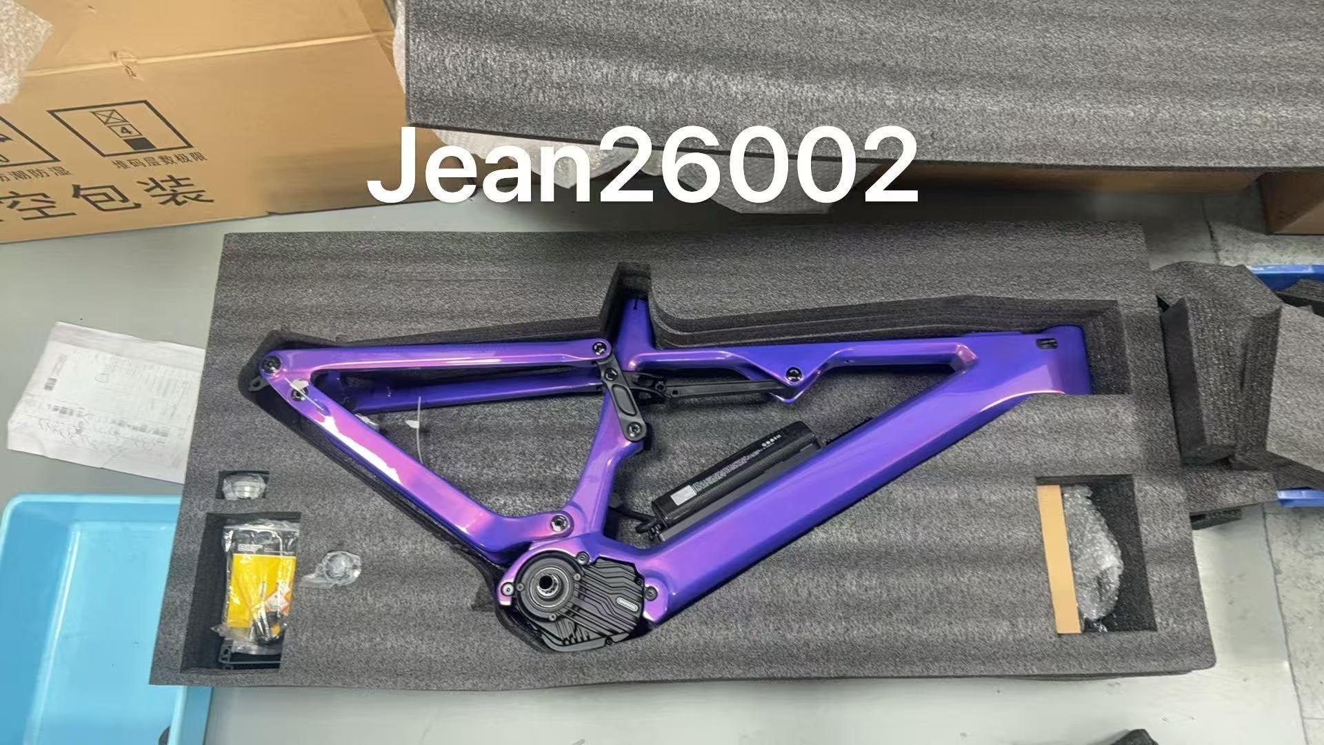

Just measured my (2025?) Float X. Measures 54.4mm. Hope it fits. Jean seems to be sure it will.
My frame is apparently waiting for customs clearance etc so will hopefully be able to give an update soon. Size Large, V3.
When did you order ? I’m still waiting on mine.
Does anyone know what they are doing to accommodate the larger shocks?

I just measured my 22 or 23 Float X2 at 58mm. Still waiting on my large frame so I can't yet comment on fitment

Ahh that's I shame I'm waiting on my frame any day now and I also wanted to use the fox float x2. I have size L what size is your frame?

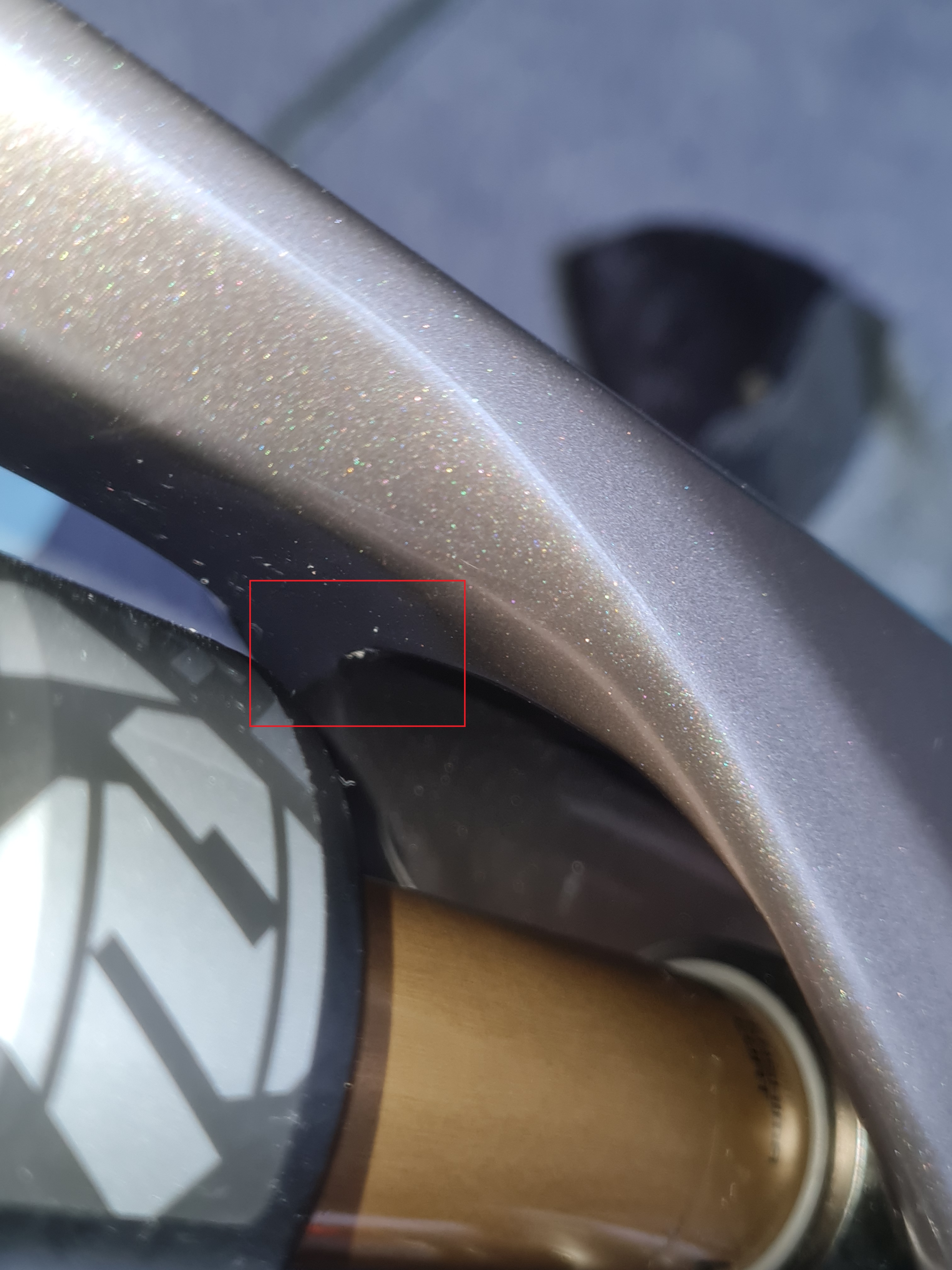

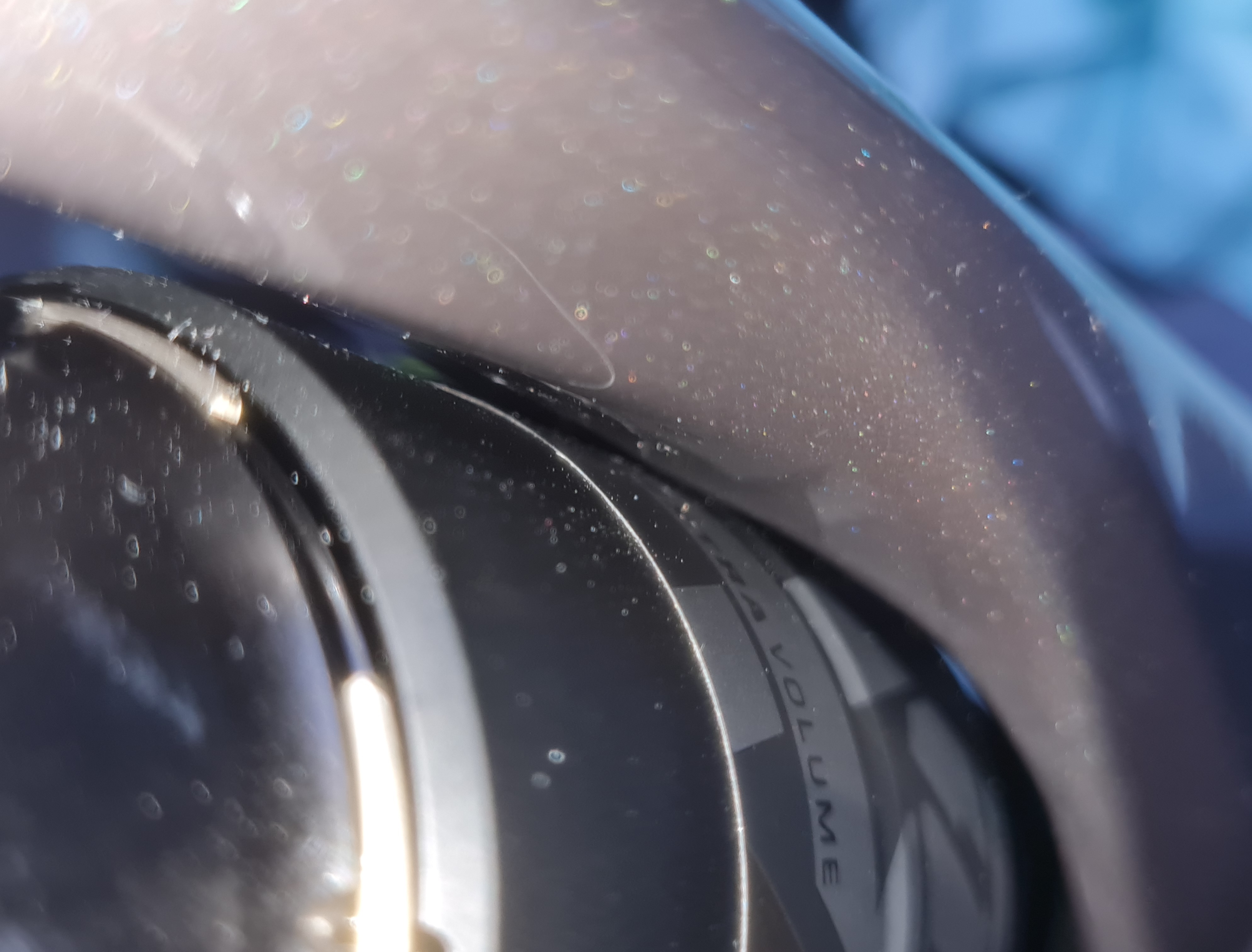

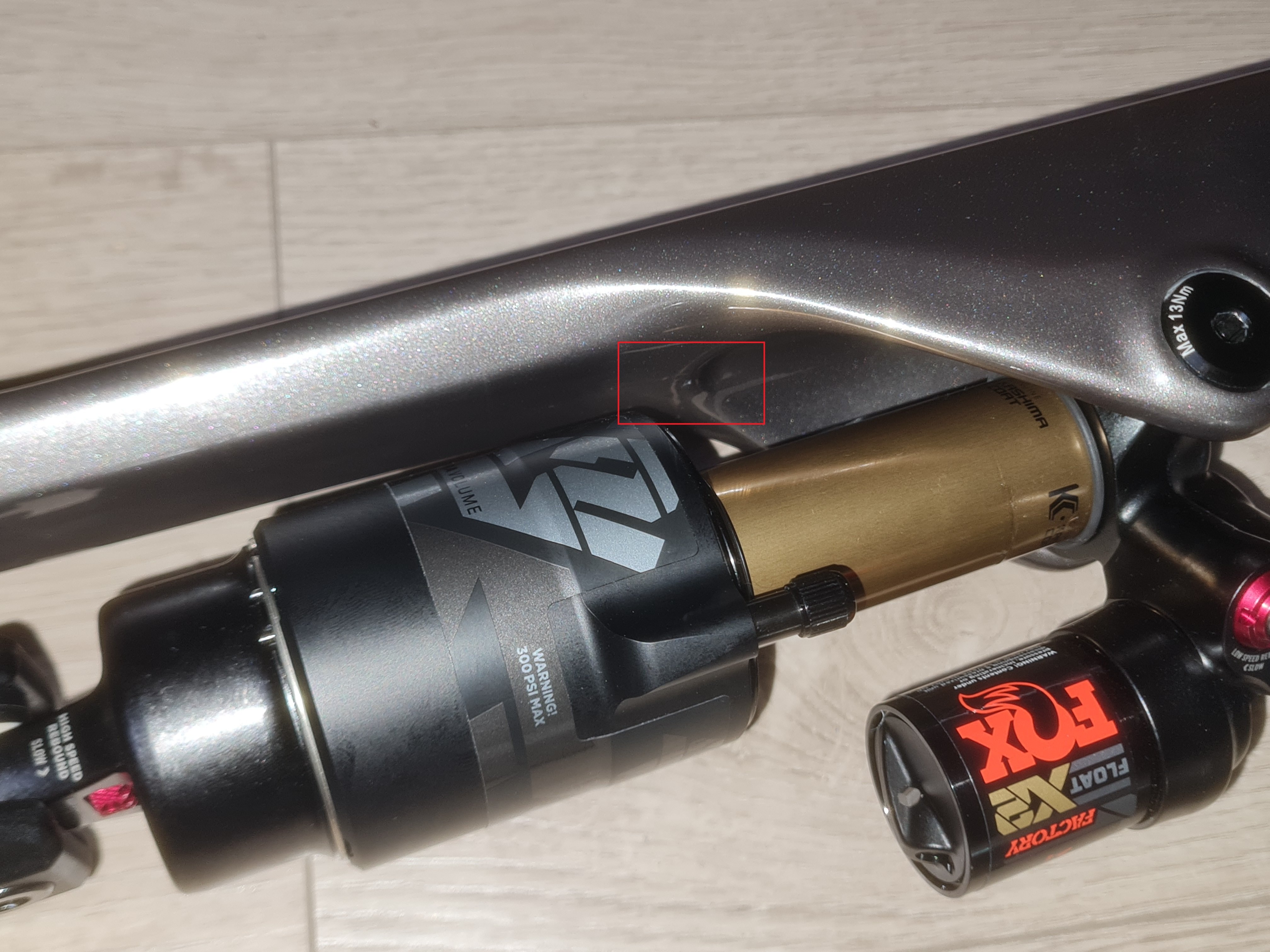

I'm have the same problem with fitting the X2 (205/65) to the frame.
There's a gap the width of a hair.
Where it meets, here's a pointed bulge in the frame.
I'm thinking about grinding this pinted bulge1 mm more gap would improve the situation.
Do you think this is a bad idea?
View attachment 175513 View attachment 175514 View attachment 175515 View attachment 175516
This is the same issue on mine and personally I wouldn't grind it out just in case it affects the integrity of the frame it may be fine but if rather not risk it.
Yeah grinding your frame is the last thing i would think of

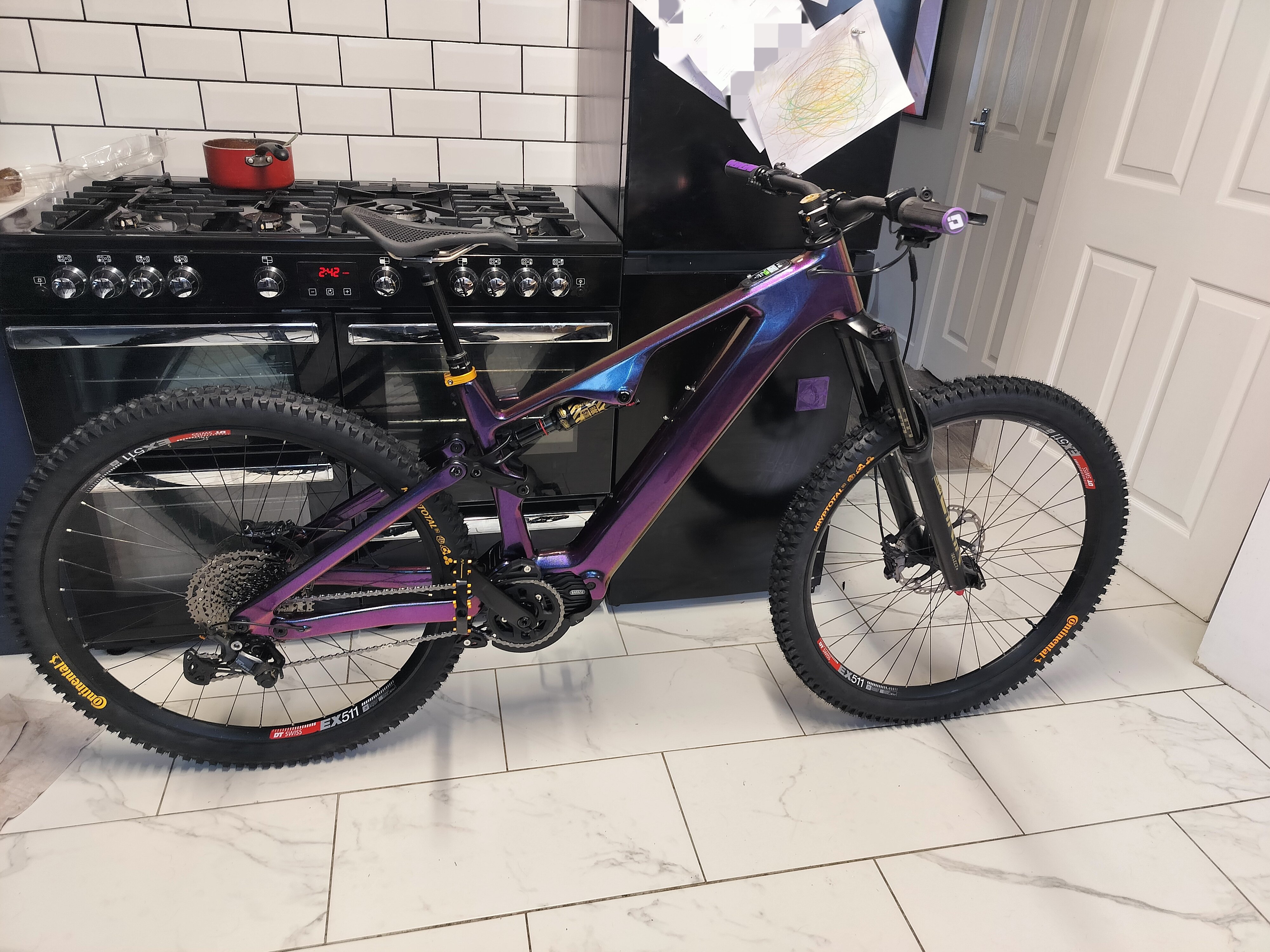

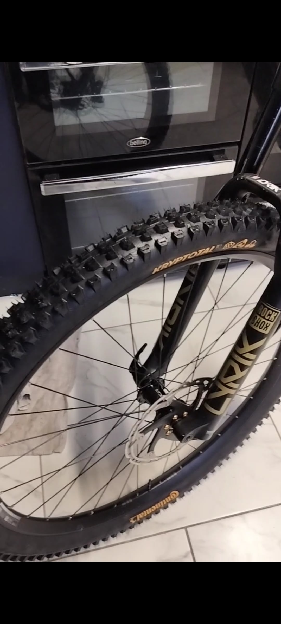

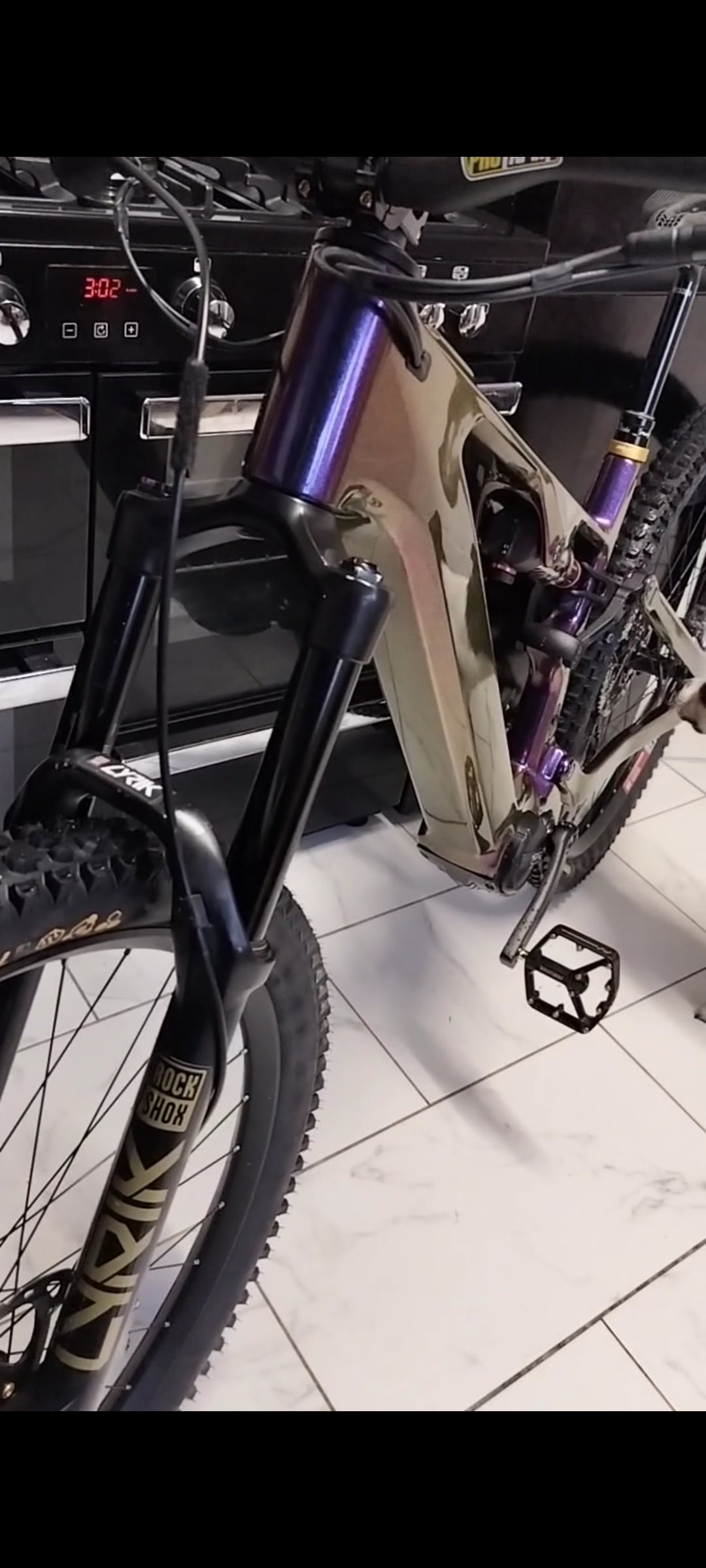

With your rockshox shock or something with a bigger body? Its a clean looking build looks nice :)
It's was with a fox float x2 factory. The rockshox fits perfect. And thanks man I'm pleased with how it turned out

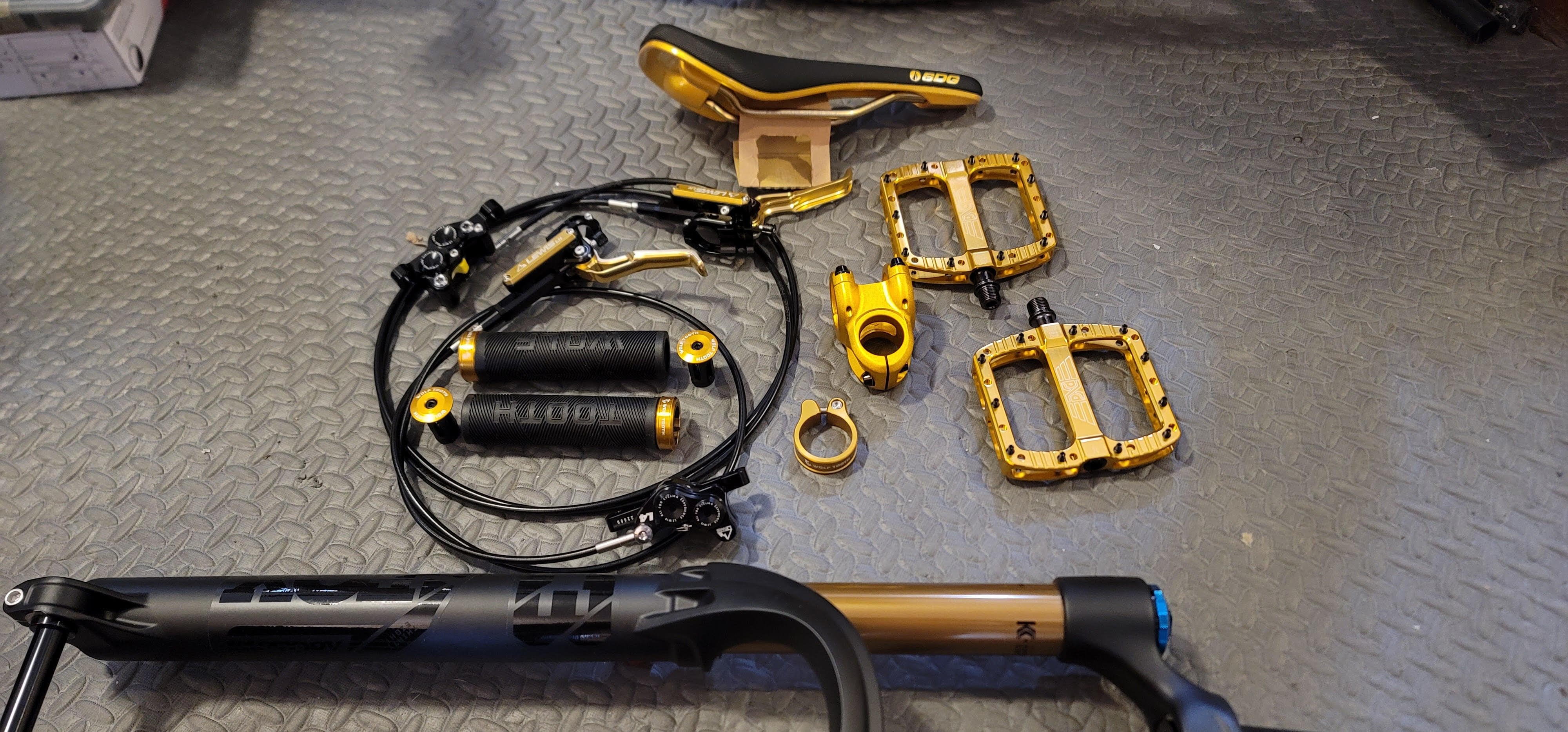

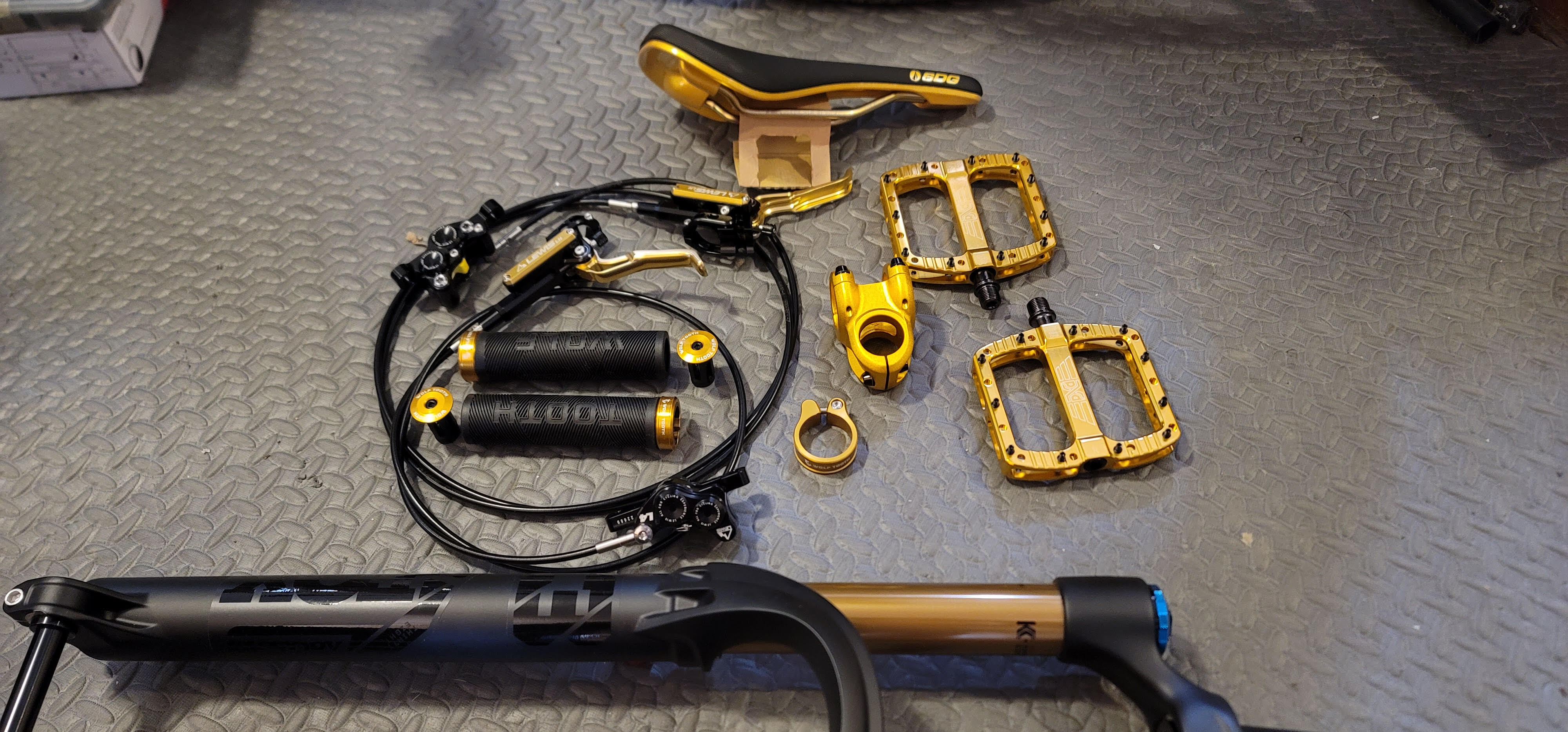

Nice dude I don't think you've overdone it on the gold I plan to add a few more and eventually kashima coated fox suspension and dropper I think the purple and gold go together really well
Its really just the Spank stem that is the worst match. I think I might just bite the bullet and buy the Raceface Kashmoney stem like I was going to originally before cheaping out.

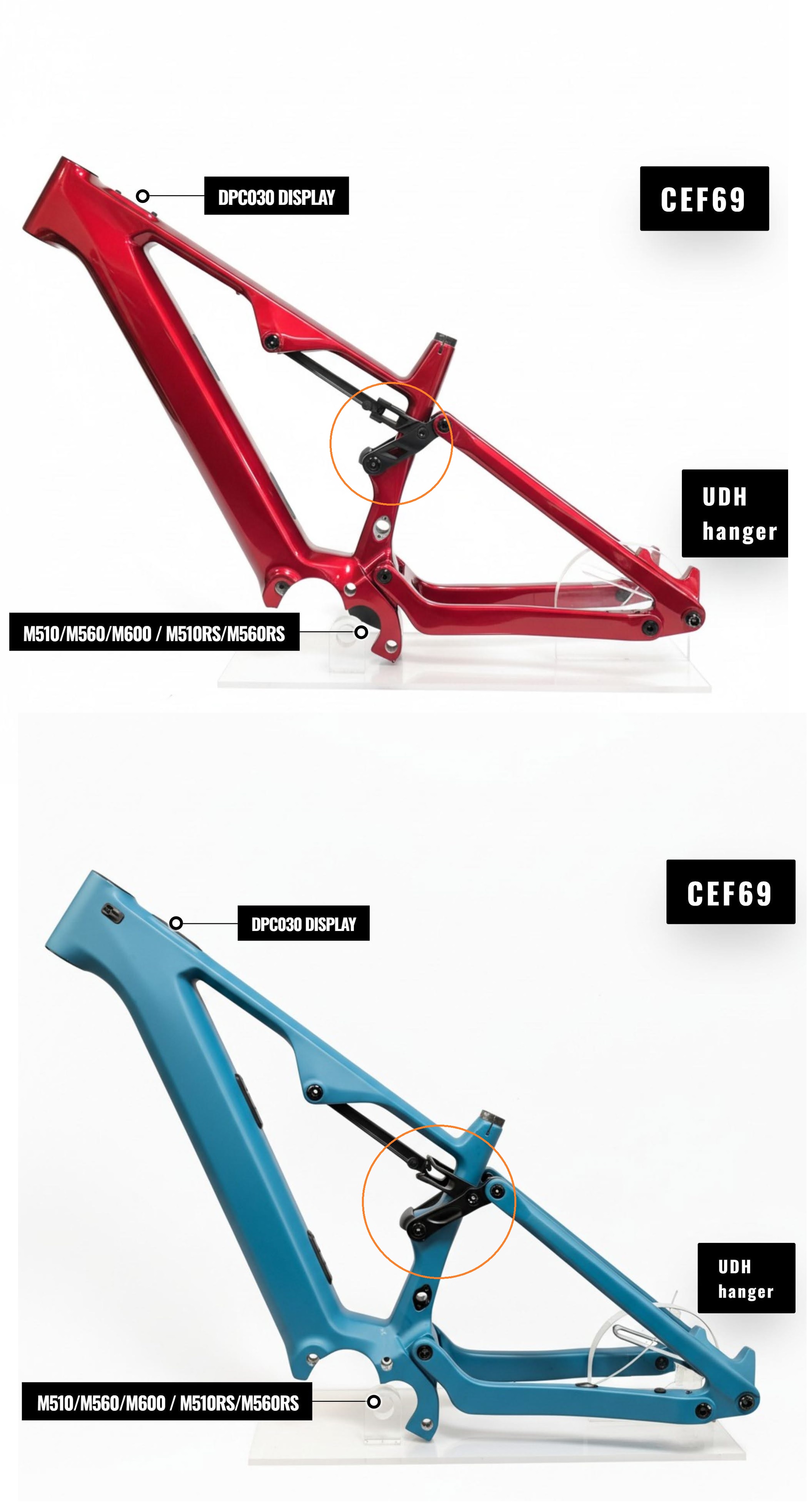

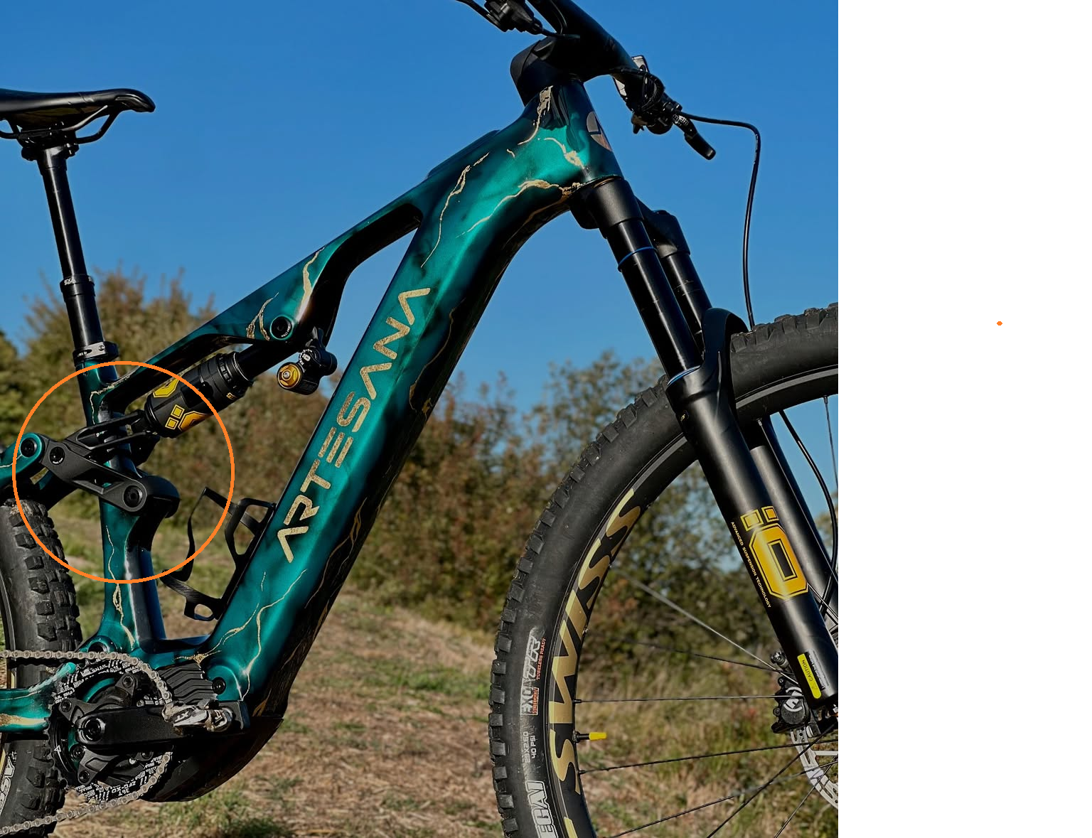

Is this the updated linkage discussed? This linkage and the red frame on Charly's post looks different. I noticed that the bikes that Artesana used with the Ohlins TTX had this similar looking linkage.

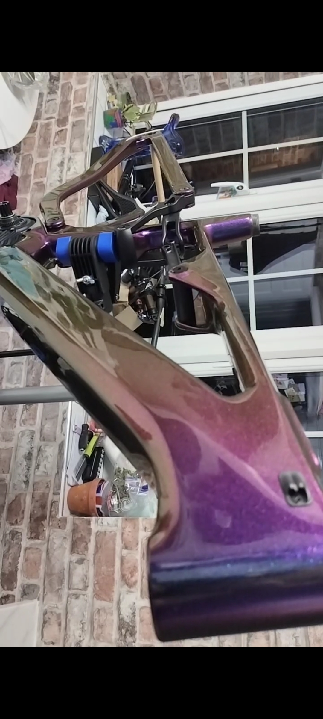

I was wondering the same thing. Going back through to the first few pages of this thread both types are visible so I don't think that is what identifies the updated part?? My build picture(just got today) shows the solid style and I've been waiting for 30+ days to ship after asking them specifically about running a Float X2. I assumed My large frame was waiting on the updated linkage to ship.
You are right, Charly had a few pics with that hollow linkage, jumped the gun there, just didn't see anyone else receive it. On the other hand, I also noticed in your picture, the curvature around the bolt where the yoke attaches to the rocker is facing towards the back. That part looks different, I wonder if that is the update? Possibly positioning the yoke plus shock lower?

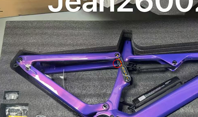

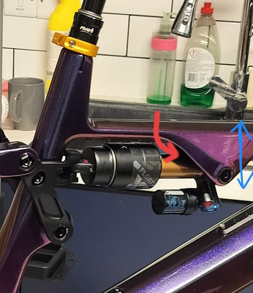

interesting that linkage on charlys pics is certainly different to what I have on my L cef69 frame but I don't think changing that much would fix the issue I'm having with the fox float X2.
See the red arrow this is where it clashes with the frame on the underside of the top tube.
I think if they dropped the trunnion mounting holes for the shock where the blue arrow is maybe 8mm-9mm the the shock would clear perfectly.

Let's be honest: when we designed it, we didn't actually consider the problem of fitting this oversized shock absorber to the frame. The company's design team is currently working on a solution. Before official mass production begins, if any rider needs this shock absorber, please inform our sales staff in advance. We will handle special orders with special attention.
Is it possible to order the updated linkage if we already have a frame?
what are you talking about ?
You posted
You posted this: Let's be honest: when we designed it, we didn't actually consider the problem of fitting this oversized shock absorber to the frame. The company's design team is currently working on a solution. Before official mass production begins, if any rider needs this shock absorber, please inform our sales staff in advance. We will handle special orders with special attention.
Can you clarify what the solution is to accommodate the oversized shock? Will this solution be available to update frames that have already been delivered?
