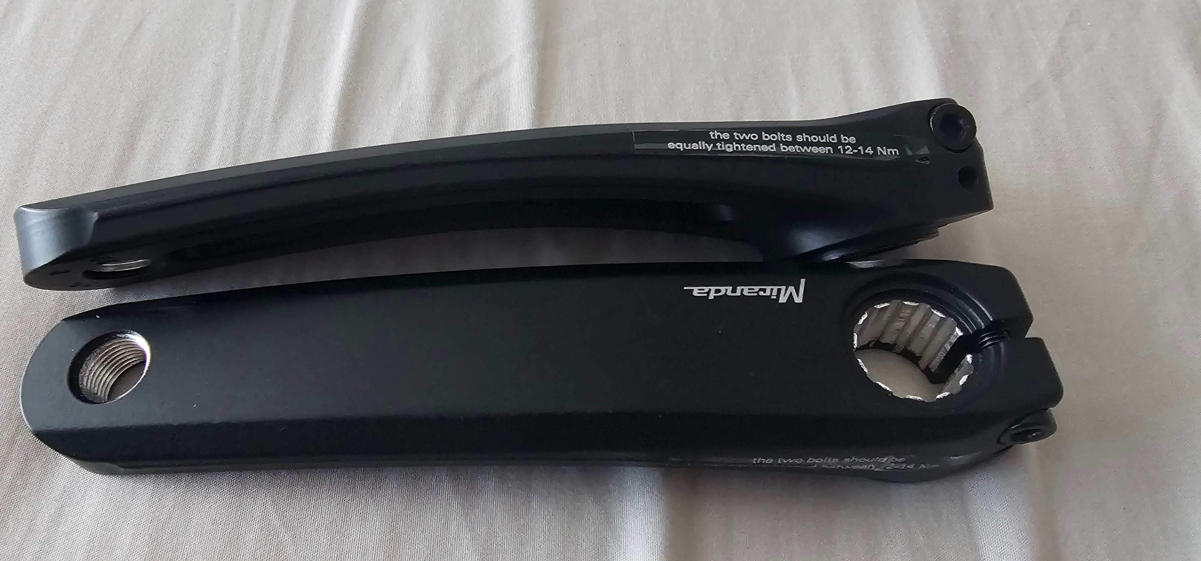

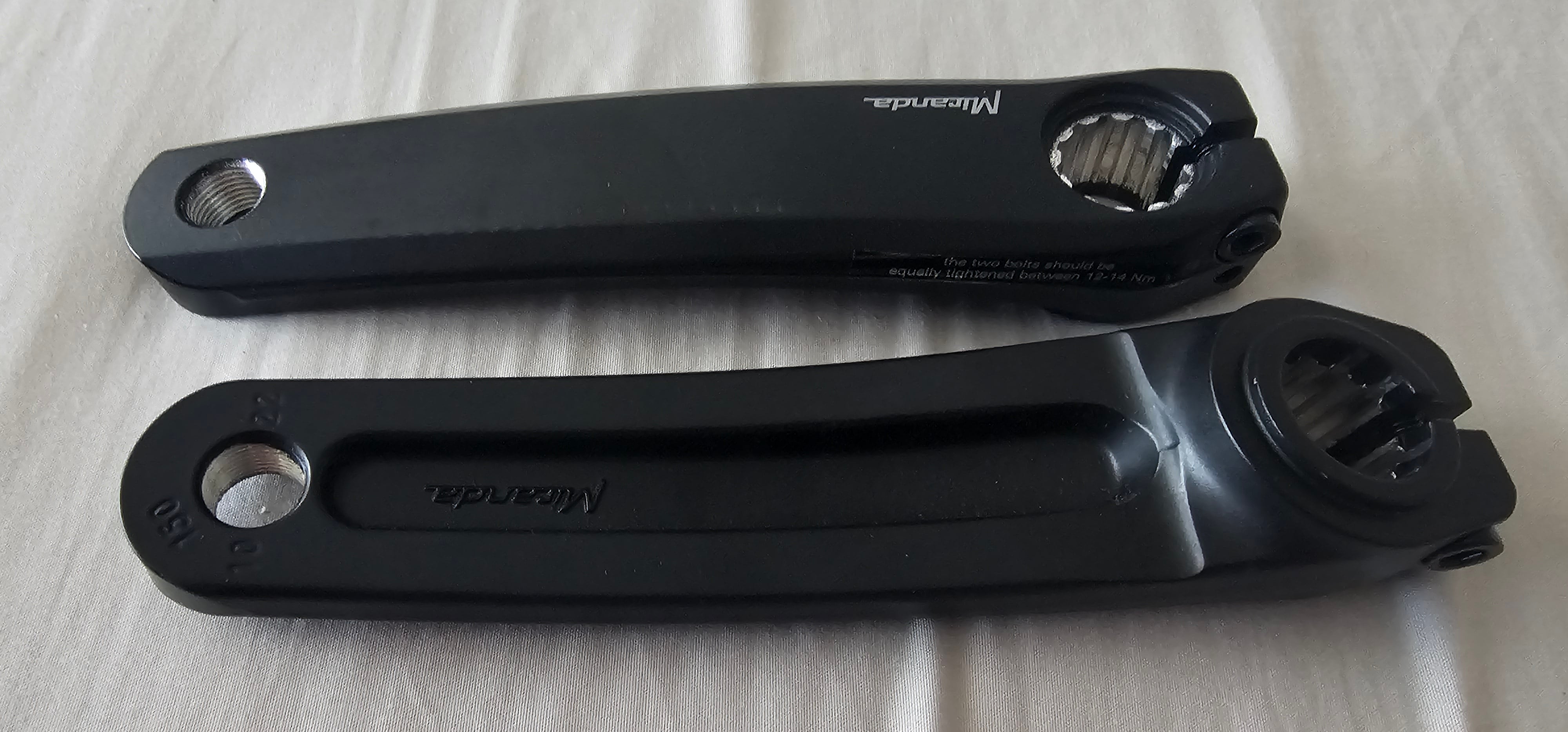

Here are the Miranda 150mm Cranks fit bafang
They are alloy and lite, I'm not to narley so see if they do bend.

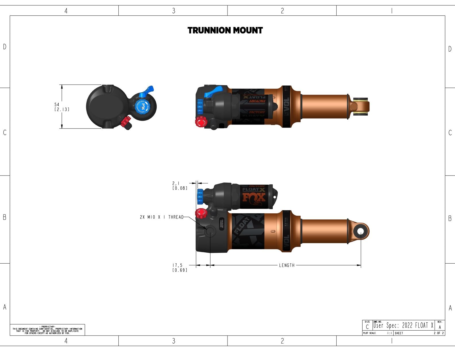

Post Jean a picture of the shock and he can tell you. Frame sizing does not seem to affect the clearance that much. It is more the diameter of the shock that matters. Redesign of linkage is mentioned. This might be your solution.

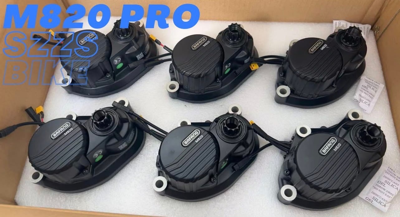

SZZ mention a Bafang M820 PRO model for their CEF50/55 Can’t find anything on it.

Could someone shed a light on the difference of those frames besides the shock position?

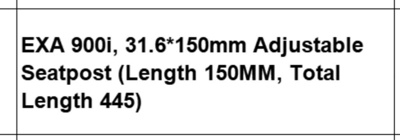

What is the seat clamp diameter, for the CEF-69? I purchased a 34.9mm Wolftooth clamp but am second guessing it. I am also wondering if there are any parts you wouldn't normally think of that are required to build up the bike(I already acquired a shock bushing thanks to this thread)

This is not true. The fox float x will clear no issue on a small. Will be crazy close with medium and will hit on a large.

Jean quoted me a dropper. I asume it is 31.6mm

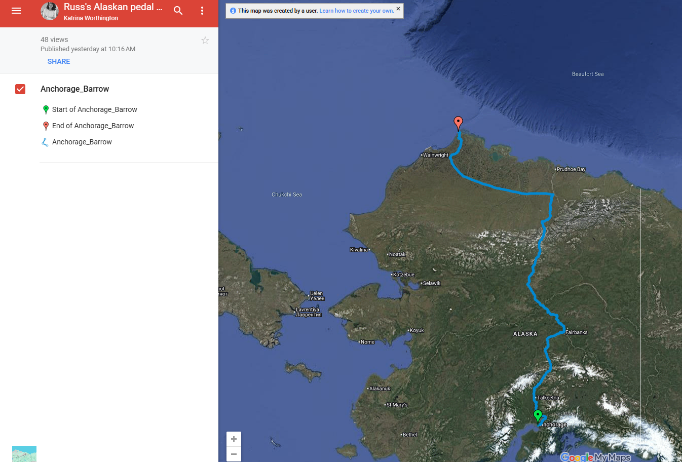

This is got nothing to do with CEF69 but thought i would share as its pretty crazy. My cousin is currently gearing up to ride across alaska.
He works 6 Months in Australia and then travels, He is already only Human to ride all 10 deserts in Australia. he only does it for chase but doenst really post much he's no influncer just does what he loves doing extreme. Below is literly only post he has done and his sister sent me a closed link to see map, no glory
Next time i'll convince him to use my CEF69 but he wouldn't enjoy
Maybe its not crazy iv never been to alaska but not many in their 50s would do this. He's done so many crazy things
