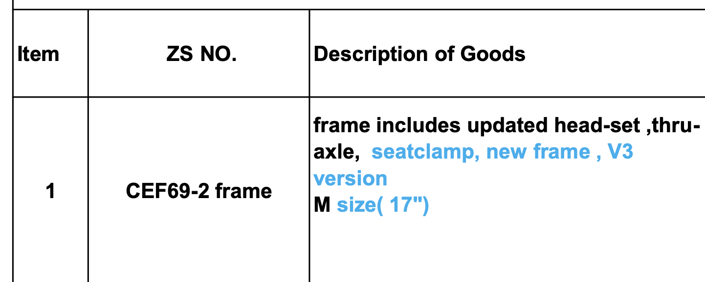

Frame is V3 according to the documents I got from Jean.

Insteresting there is a V3 frame

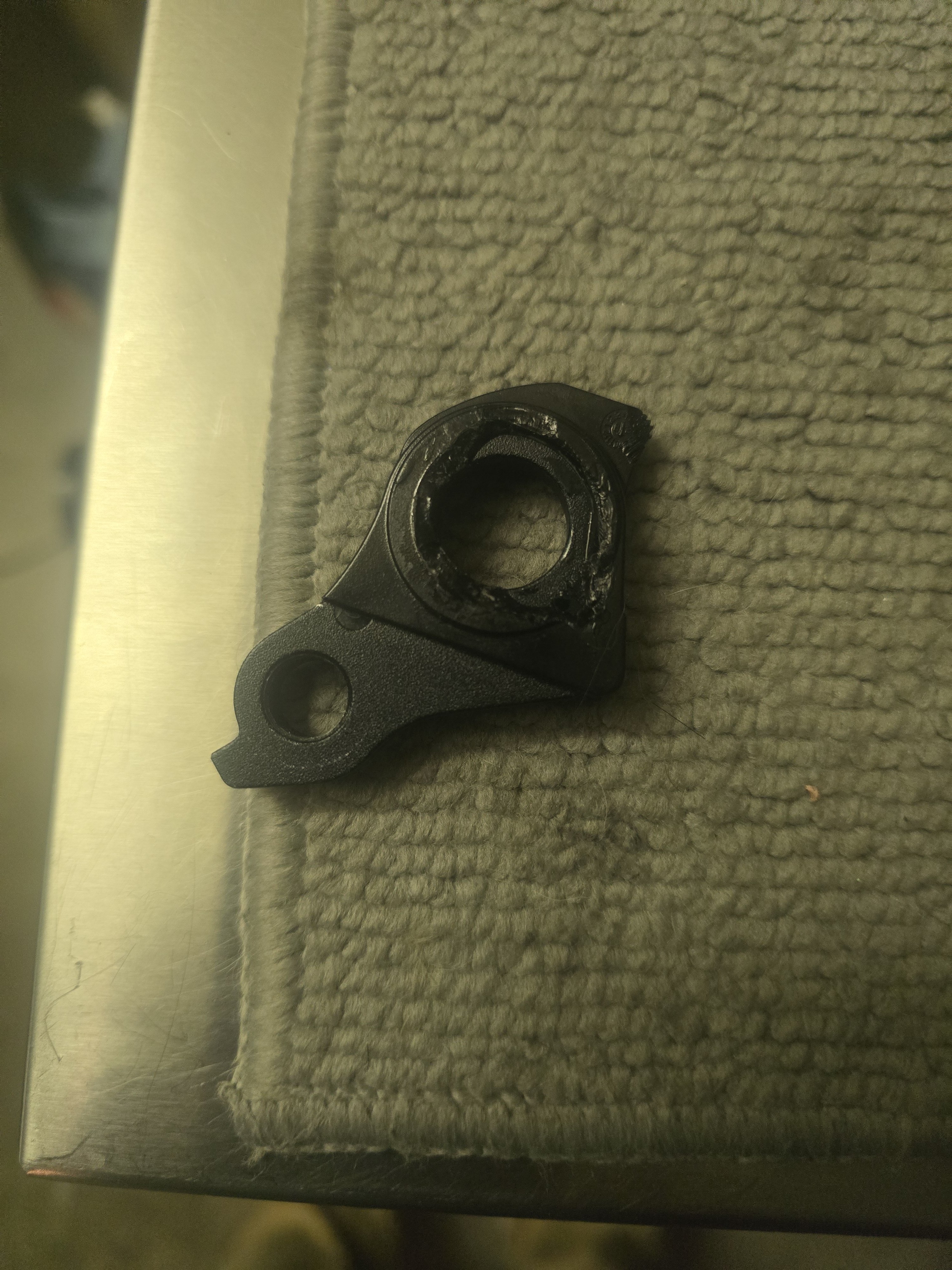

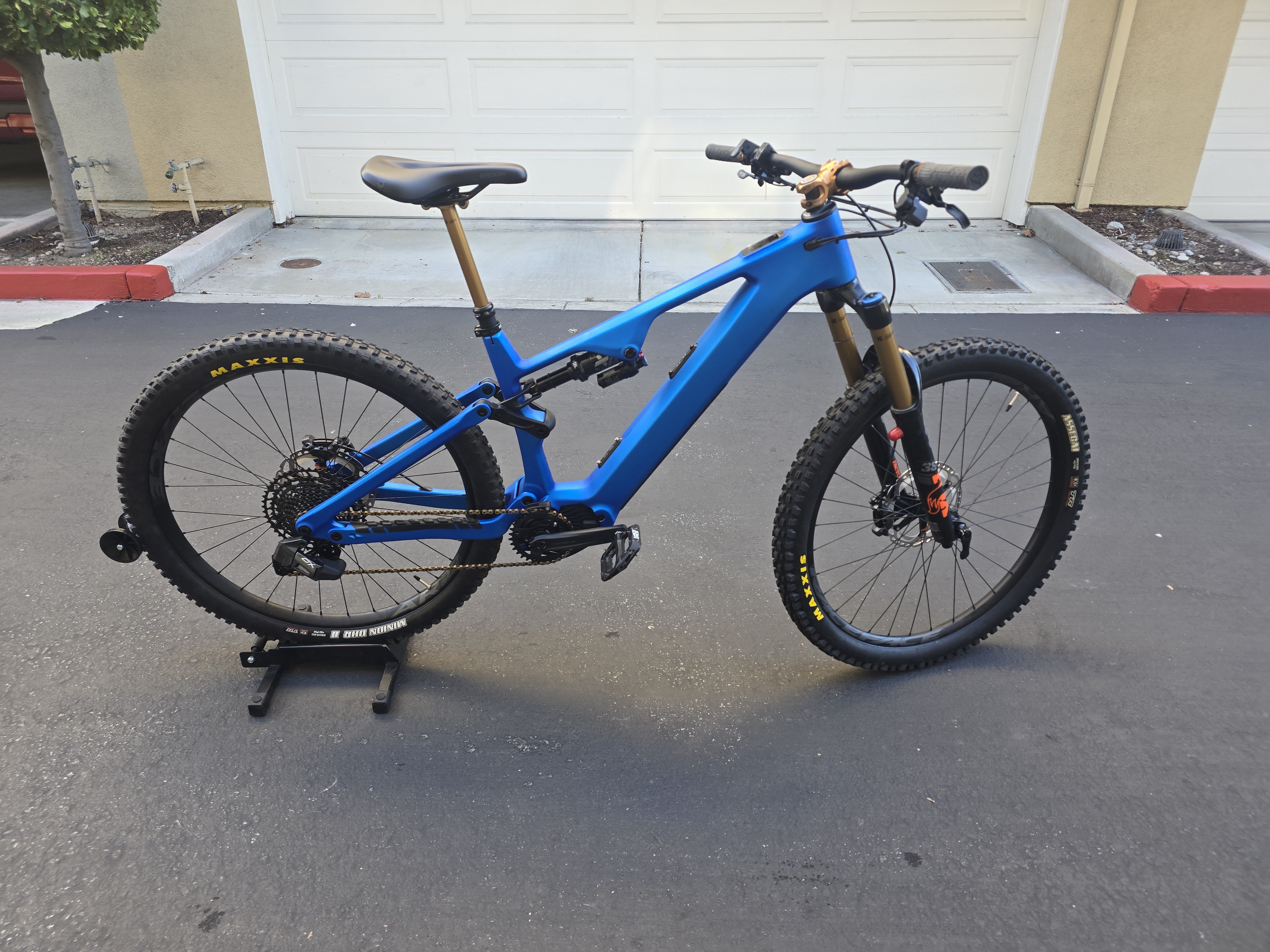

Finished my build. Issues that I had during my build.. had to order a longer xt60 cable, magnetic wheel sensor not lined up, had to use double sided tape. And then today I broke the derailleur hanger just trying to remove my back wheel. Looks like the upper part of the hanger is made of plastic.. Ordered a Zitto hanger for replacement.
sucks to hear about issues albeit minor but build is looking great and not sure if its the lighting but that blue looks particularly good

Was looking at gold stems. What is the one on your bike?
