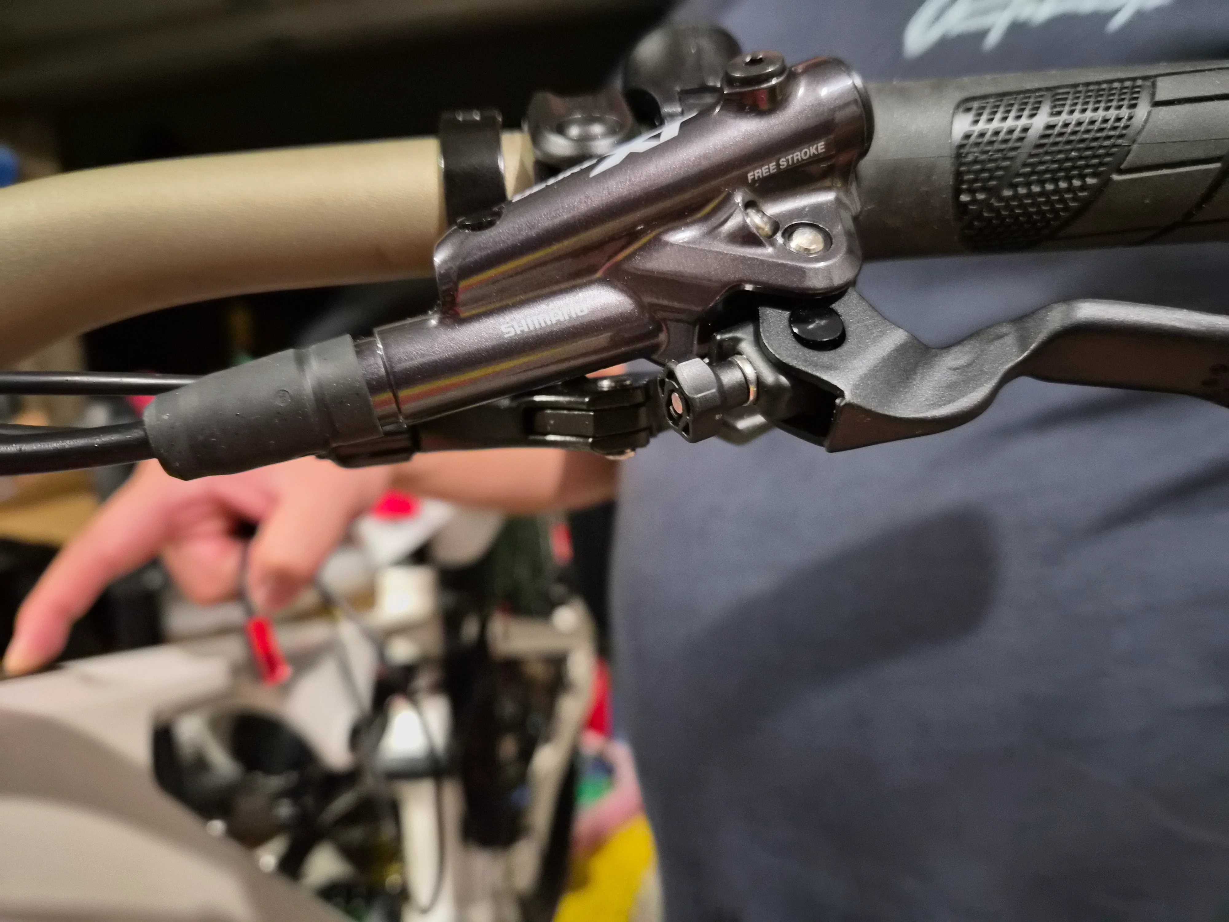

How do you guys manage to fit brake sensor cables?
And how they can be install in this kind of brakes lever?
