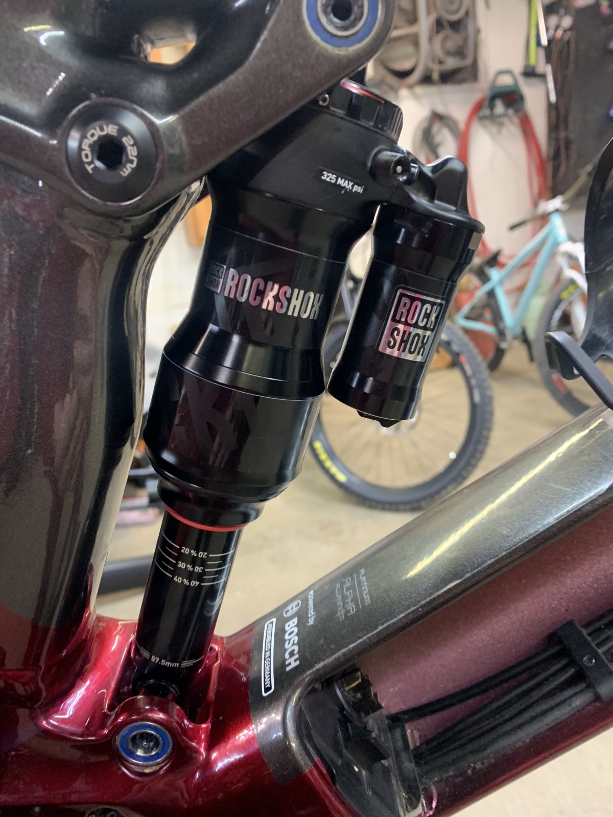

I’m watching with interest. I want to buy a rail, trying to decide between the 9.7 and 9.8, both of which need suspension improvements. Your XL frame fits a super deluxe, but I don’t have a way to know if the super deluxe will fit on a large frame. And if neither the super (9.7) nor the super with thru-shaft (9.8) are adequate for heavy downhill riding, then what’s left? Thanks for posting. Meg Neg might be a good option although for a regular super it doesn’t address the lack of an external reservoir to provide more oil volume and better cooling.

The super fits the xl frame well. I was told that the reservoir will dent the frame on a medium so idk about the large. I was also told from a very well known suspension tuner that the meg neg is awesome. I think the air can will be close but I’m almost positive it will clear the seat tube. Meg neg on a deluxe will surely work on large but not sure about the super If you were near Pittsburgh pa you are welcome to come try it.!!!

orangie thanks for the offer. I’m on the west side, near Monterey CA. I like how you are going after the rear shock on the Rail. I’m coming up with some money to buy an eMTB and the Rail 9.7 seems to hit the “value spot” if there is such a thing. If the rear shock wants replaced on all models there is no reason the buy a higher model. I think on the ebikes the Yari and Lyric fork is the same chassis, different damper. But you don’t get the RC2.1 damper until the $12,000 bike. So the $6500 bike with a $330 damper equalizes the fork. Sell us the frameset already Trek!

Yes. Already did charger 2.1 damper. Much improvement. Drivetrain is awesome,no need to improve there. Carbon bars for trail damping on. I have rail 7 I felt better about alloy and Shimano 12 speed. Now come on summertime

A good base setting with the meg neg is to use the same amount of bands in it as you have tokens in the shock

Why are you guys (considering) changing the shock? What do you want to acheive?

Just experimenting, The super deluxe was a big surprise. Huge improvement, then a suspension tuner told me the meg neg was an awesome upgrade also. So we will see Was told 3 bands seems to be the sweet spot. Started there

The reActive shock on the 9.8 was very nice I thought, great at tracking.
I've got a Rail 7 that I havent ridden yet, got a bunch of snow this weekend. Will be interesting to test the bike without the reActive to se what difference it makes.

Ok. Here’s what I think. No tokens in air side , 3 bands in neg side . Needed 45 psi extra to get sag. Great off the top, Huge mid support, I haven’t been able to bottom it yet. All the rock and log overs I used to hit on , I now clear. Definitely can hold more speed in rough stuff but maybe lost a little comfort. The harder you charge, the better it is. If you ride hard, you will definitely benefit from his.
