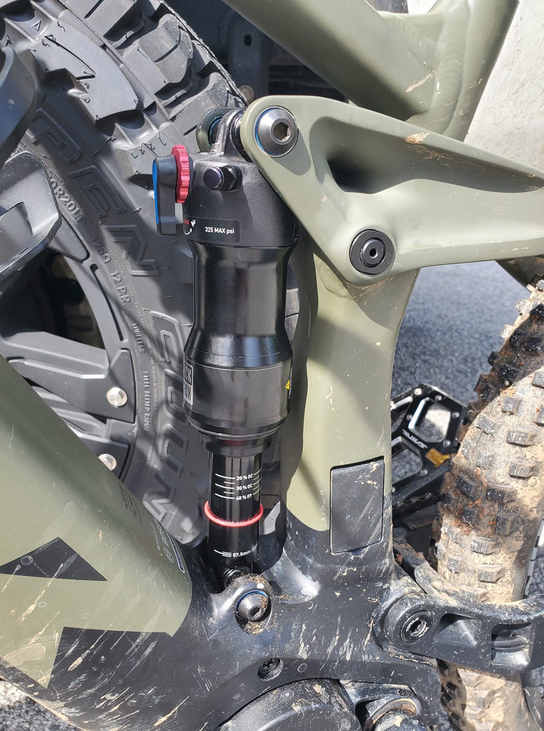

Has anyone fitted a megned to their deluxe shock on a medium alloy rail 7? Abit concerned on if they will catch the seat tube.
Running the correct sag but having trouble with bottoming it out all the time.
Someone put one on a medium 5…
Does your shock have any volume spacers? I'd add one or two before spending money on a MegNeg.
Put a Megneg on my wife's 2022 Trek Rail 5 Medium, plenty of clearance. Removed the two +ve spacers and put in 2 -ve rings. Spot on.
