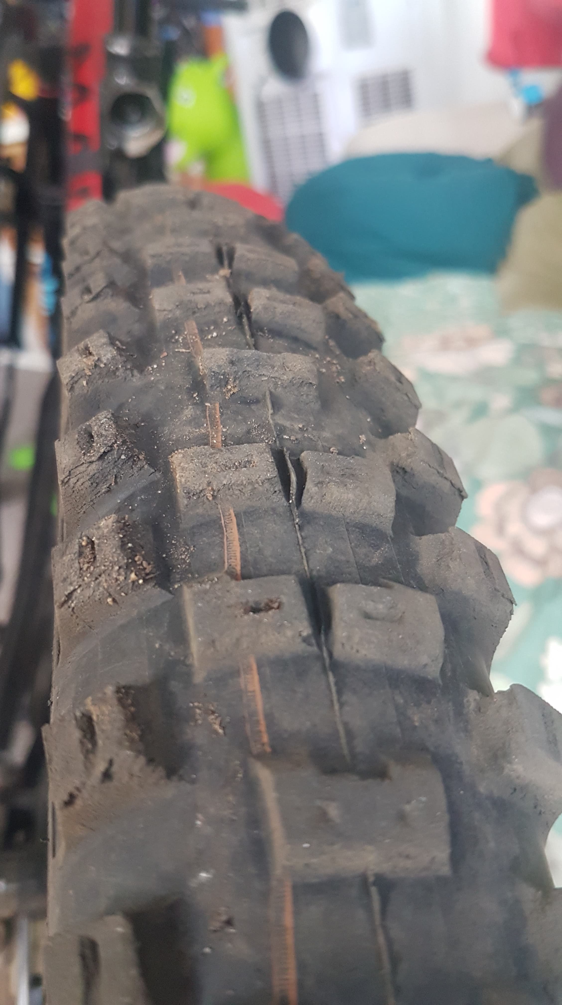

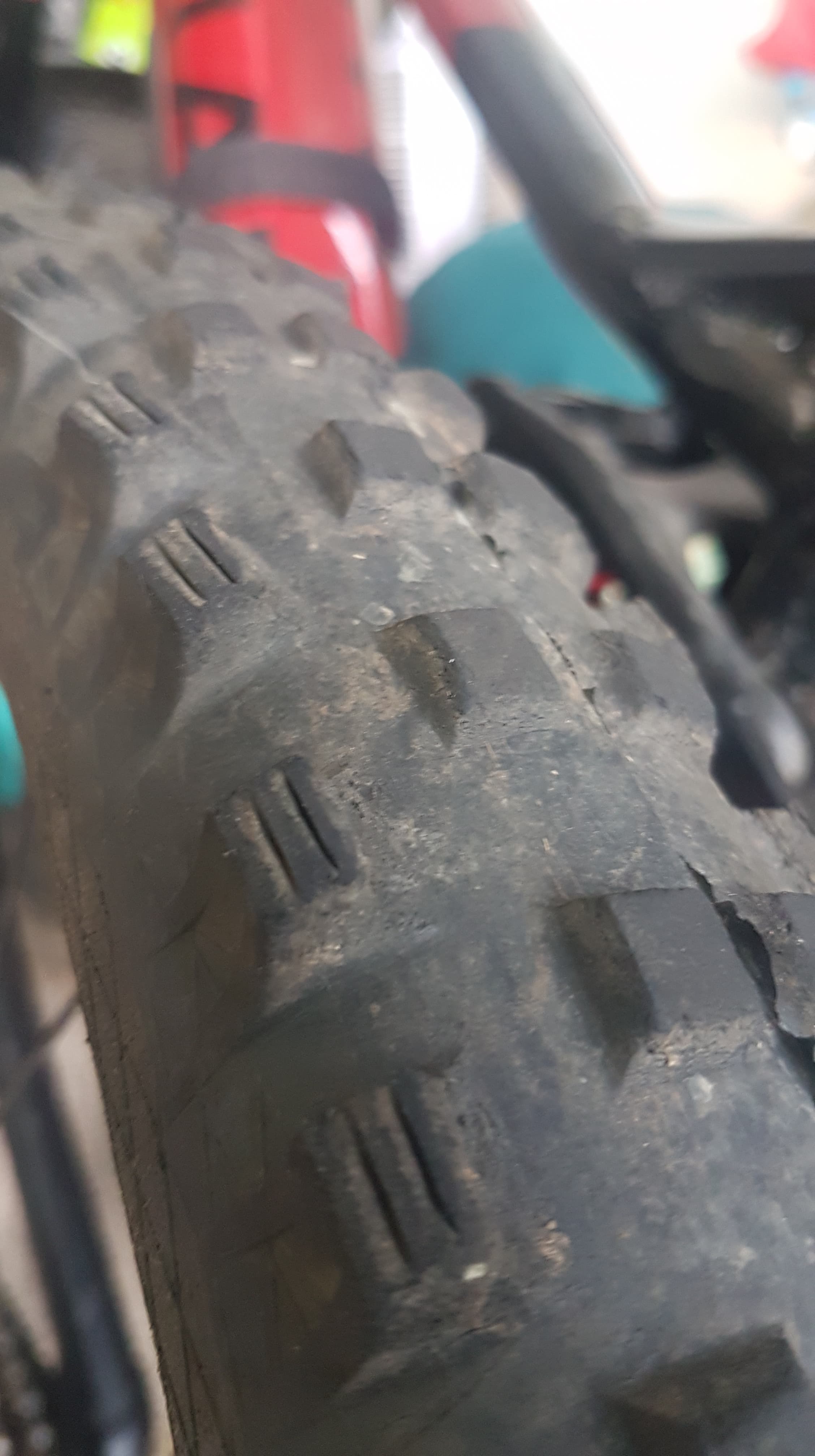

This is the Magic Mary with about 700-800km on it and my Big Betty with about 700-800km on it.
The Magic Mary is worn a bit more being the softer compound. My Big betty still looks pretty aggressive after the distance I've put on it and I haven't felt its been losing traction when riding.
The old stock 2.8 after 2 months was literally floating across the ground and not giving me any bite at all. It felt like I was on ice.

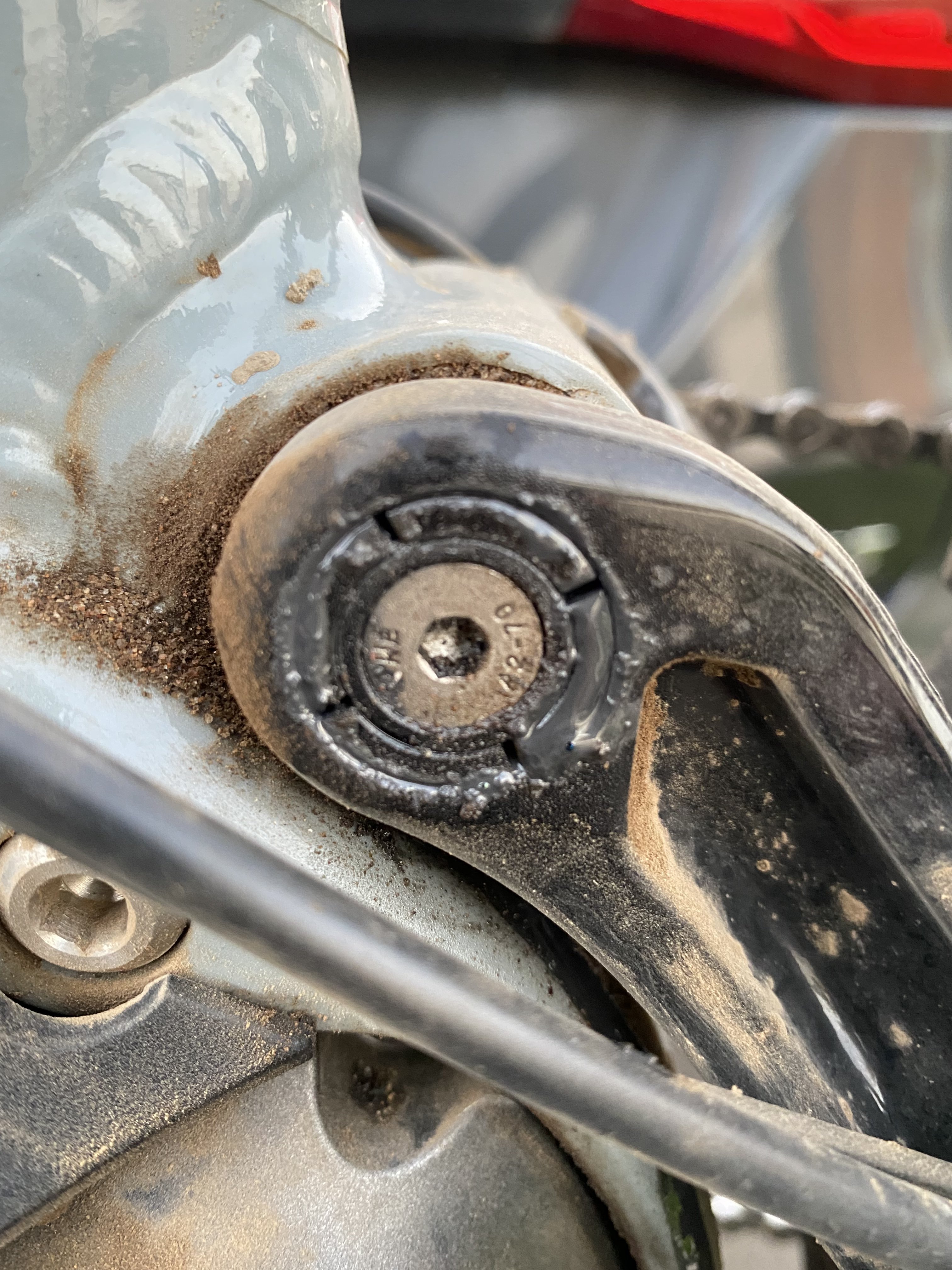

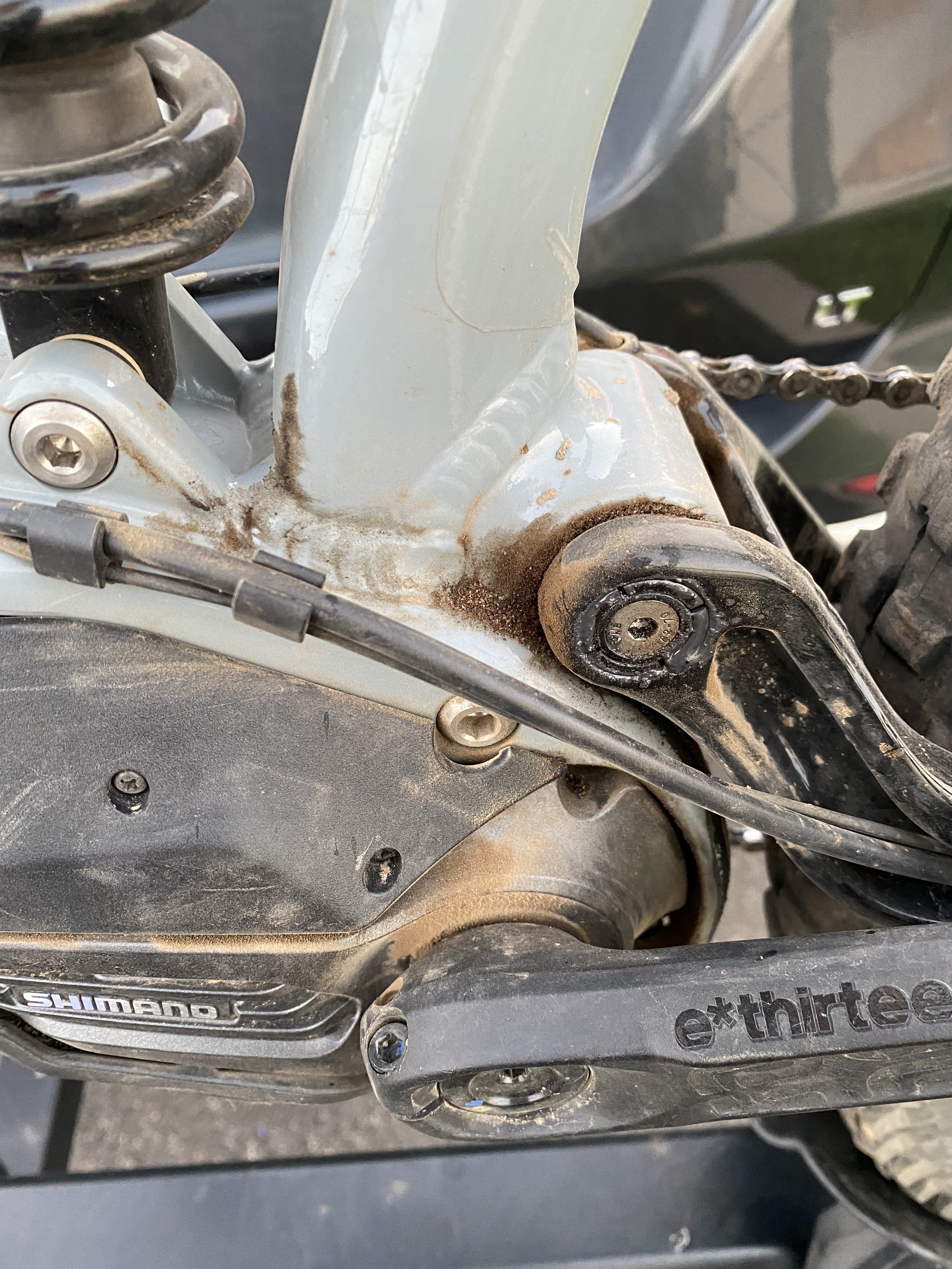

There seems to be some kind of grease noticeably leaking / building up on this suspension bolt. Just started happening around 500 miles. Anyone seen something like this? Bike still seems to be running fine (minus a broken apple nipple on the rear rim), but don’t remember seeing this issue for the last 3-4 months I’ve had the bike and doesn’t seem to be happening on any of the other bolts.
My e2 doesn’t have this but my Santa Cruz tallboy does. Is this an indication of a problem or need for service?
I'd take the bolt off, clean it, feel how the bearing is, re-grease it and see what happens. have you washed it with a hose/low pressure water/high pressure water?
Water might have gotten in and picked up some grease/dirt and being worked out of the bearing.
Yeah I did clean it with a hose recently. That’s probably the what it is now that I think of it. It’s probably a water / grease mix.
