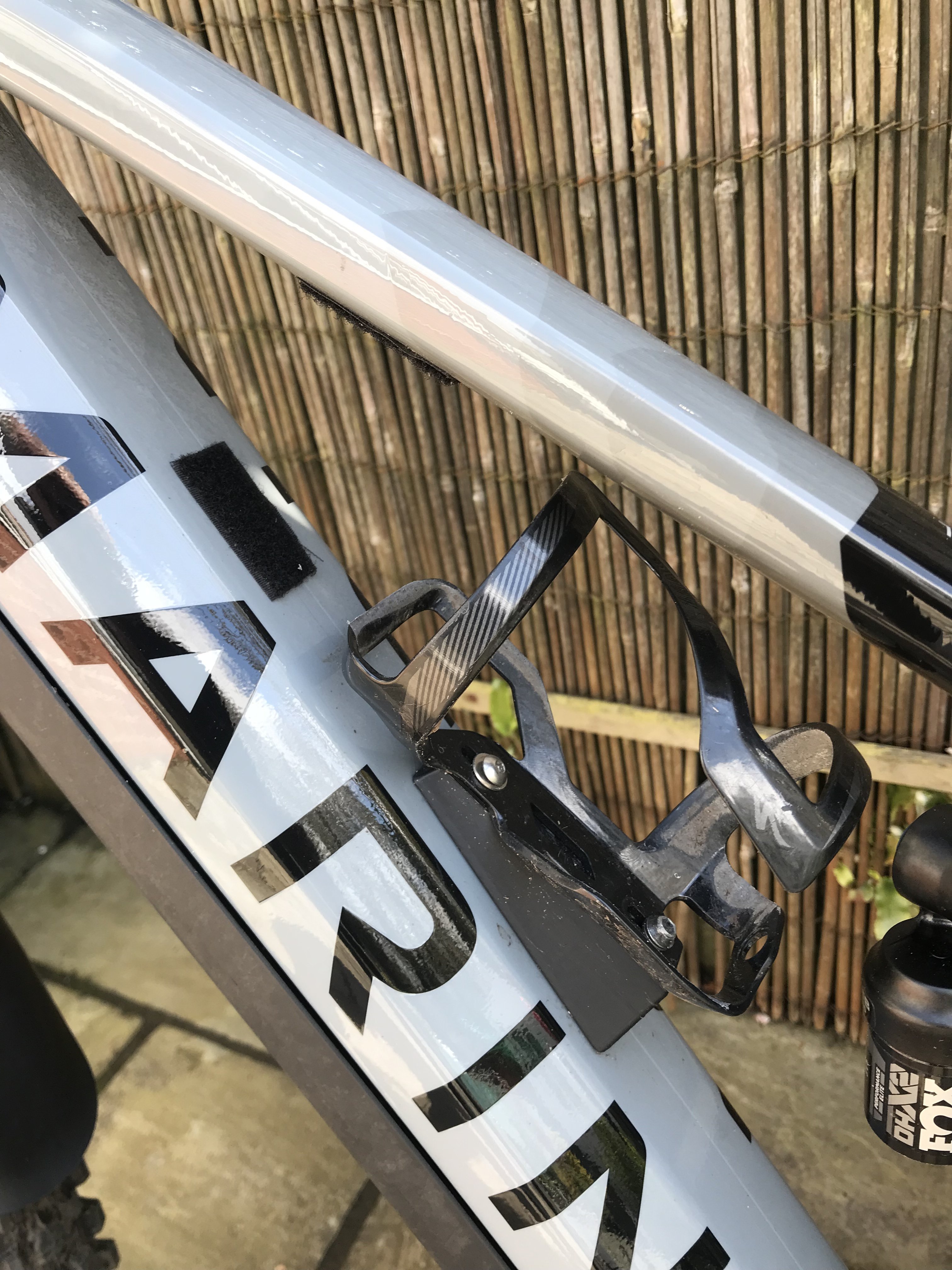

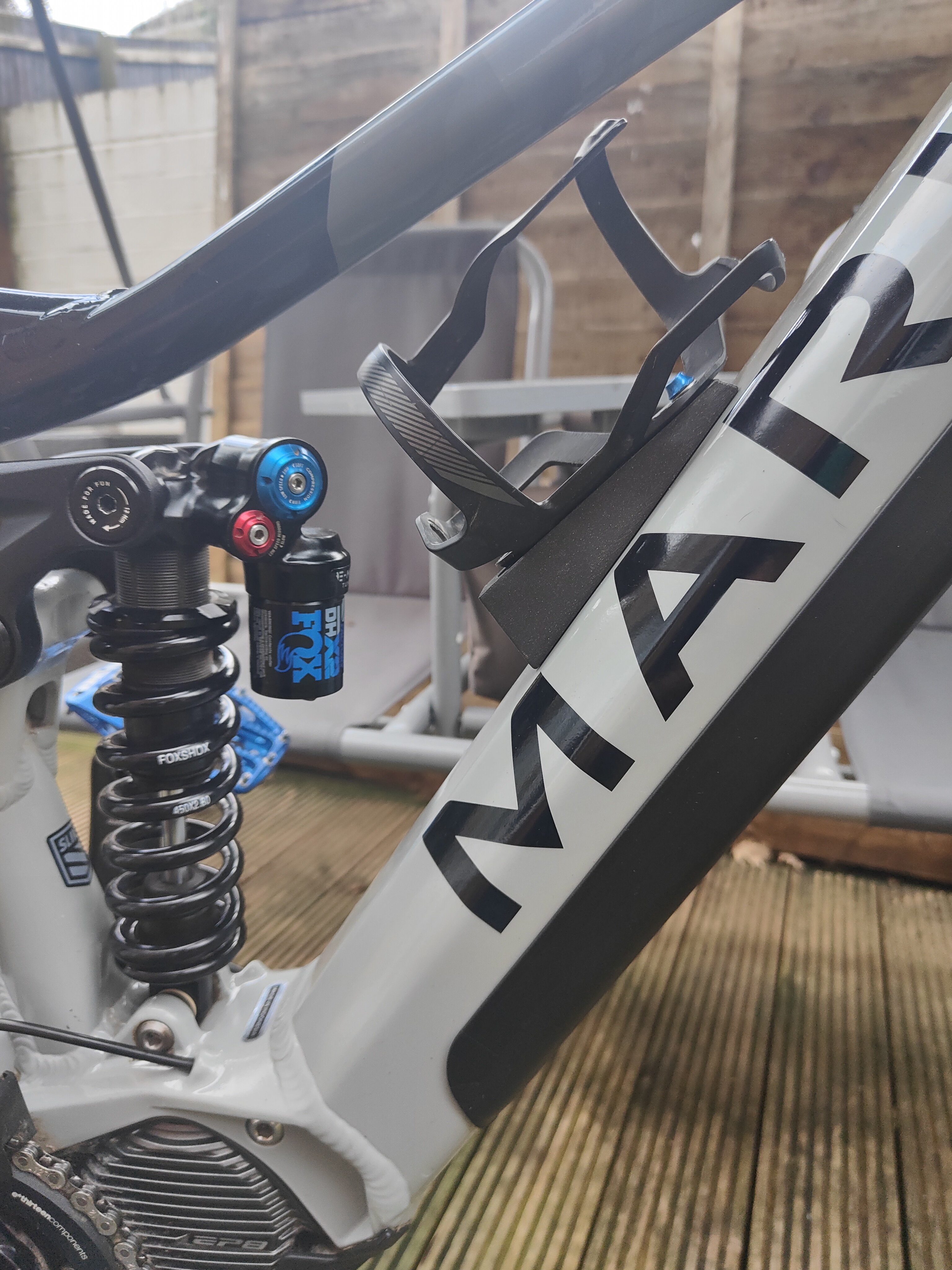

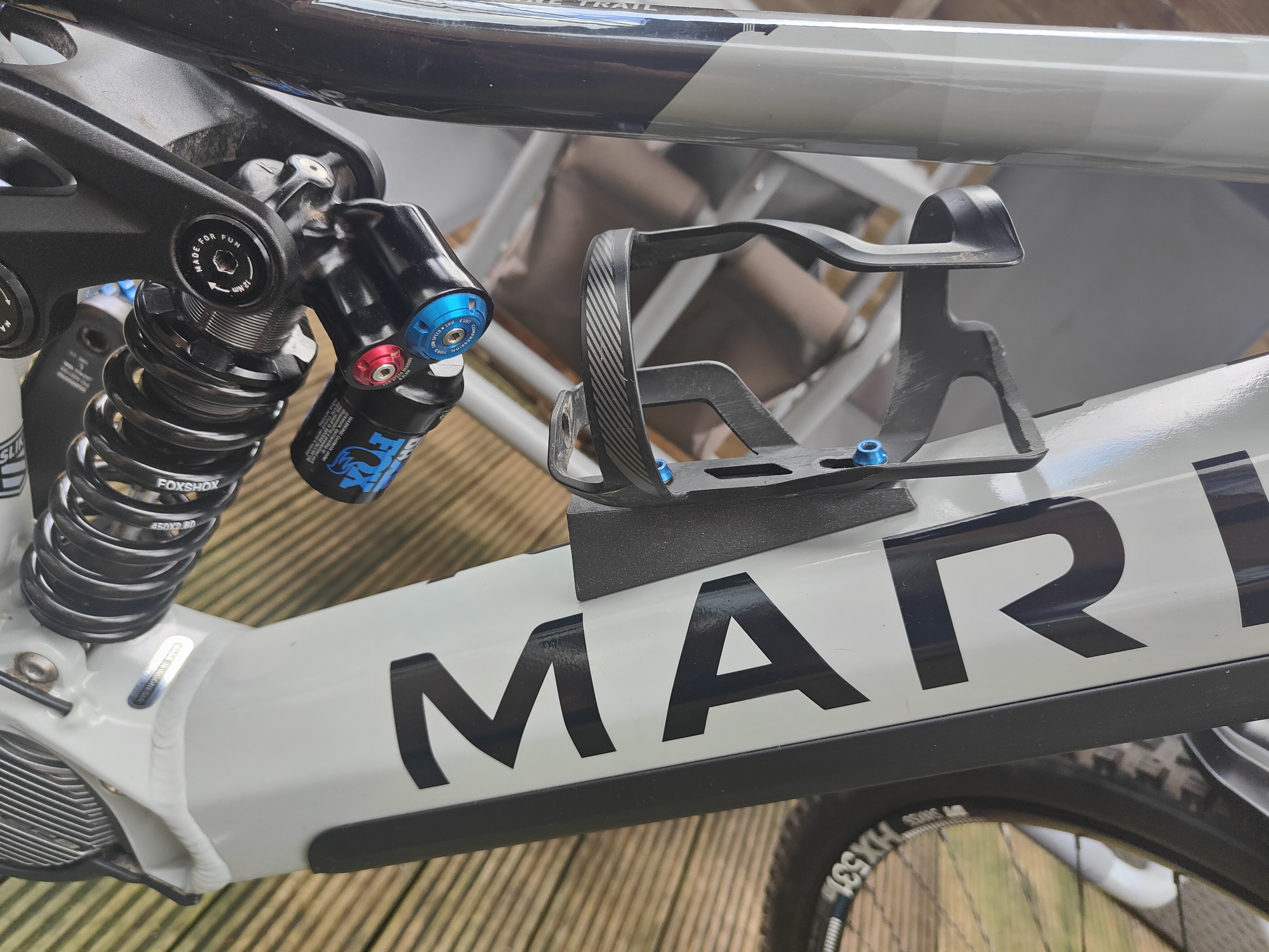

Better picture of the bottle cage adaptor.

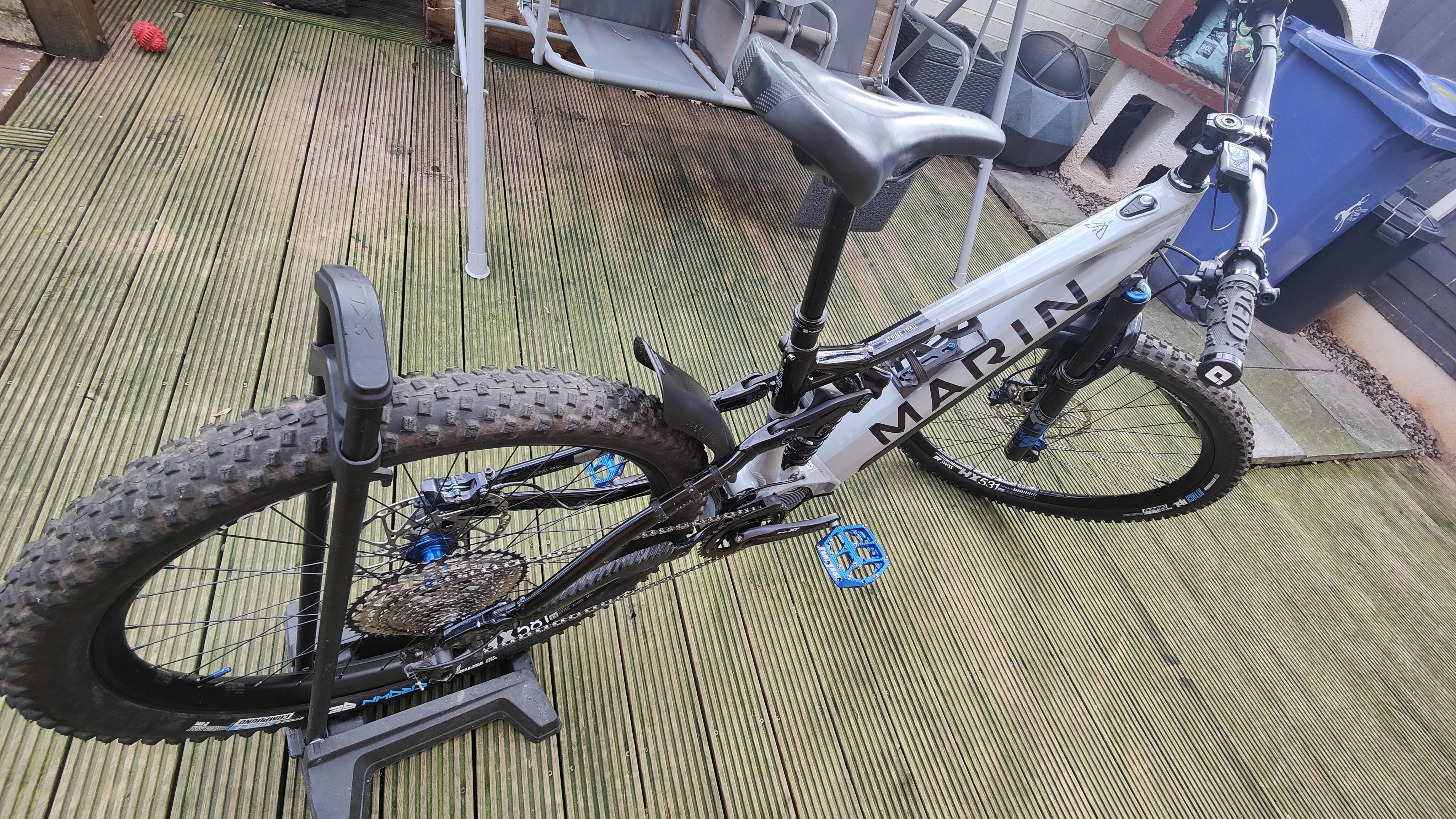

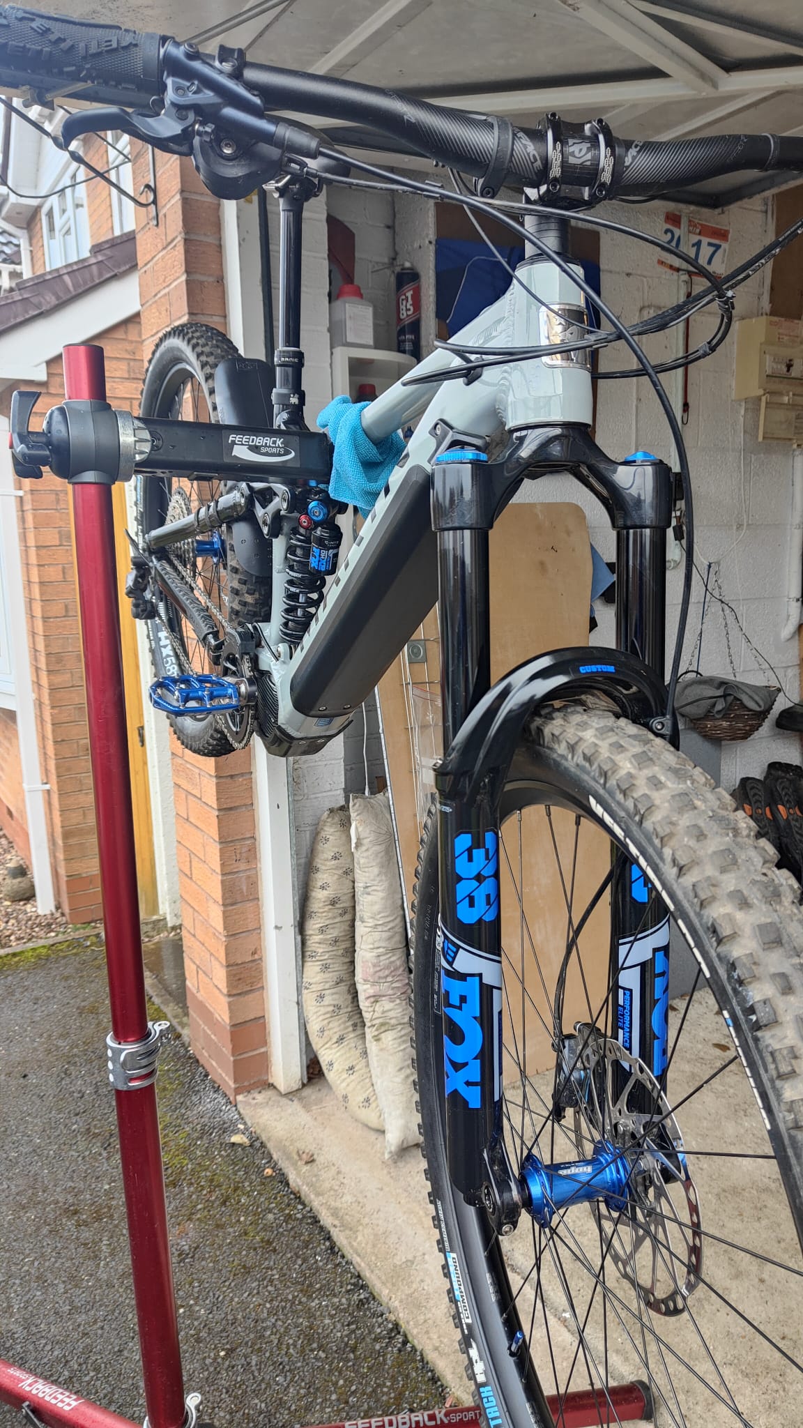

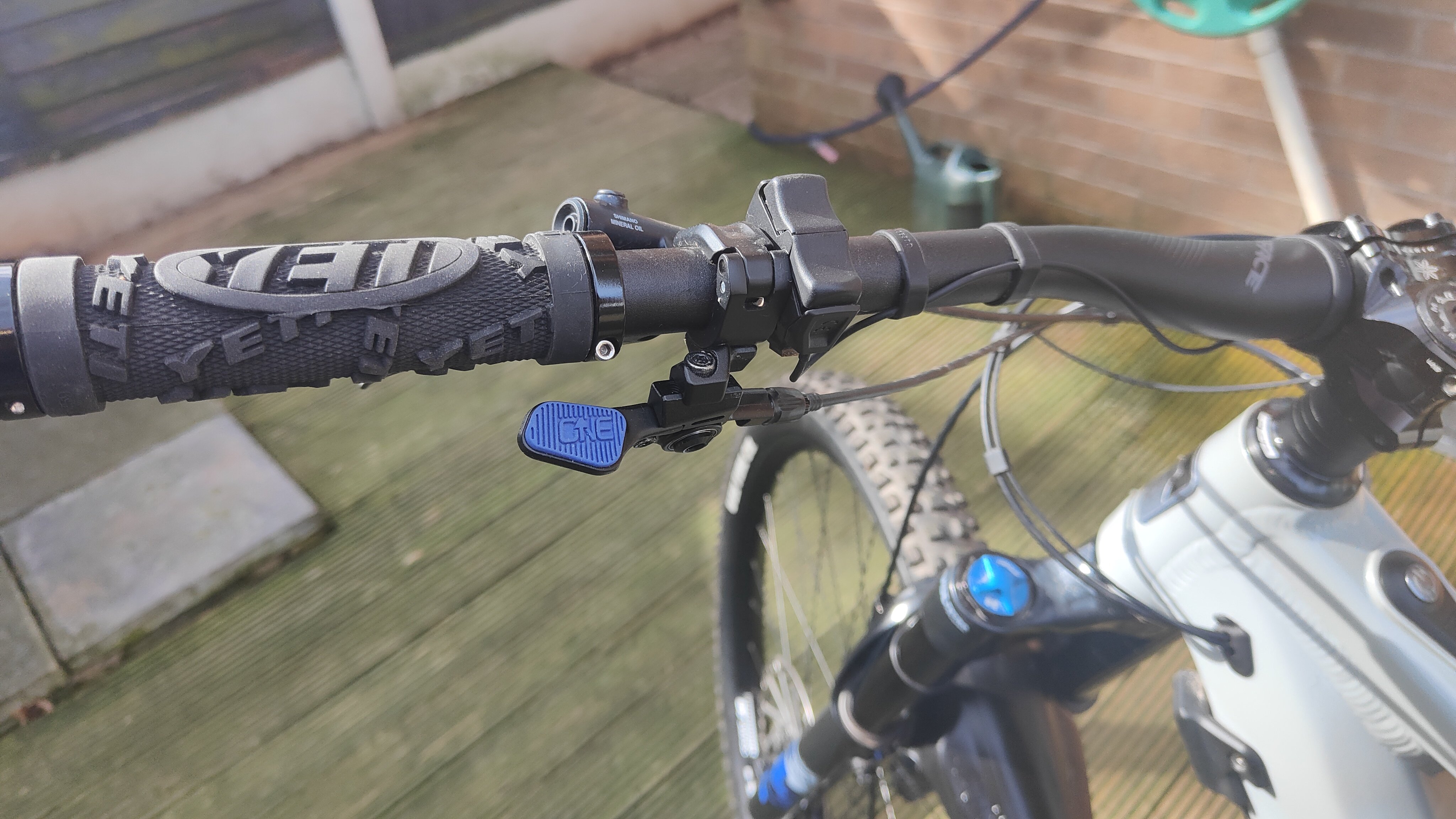

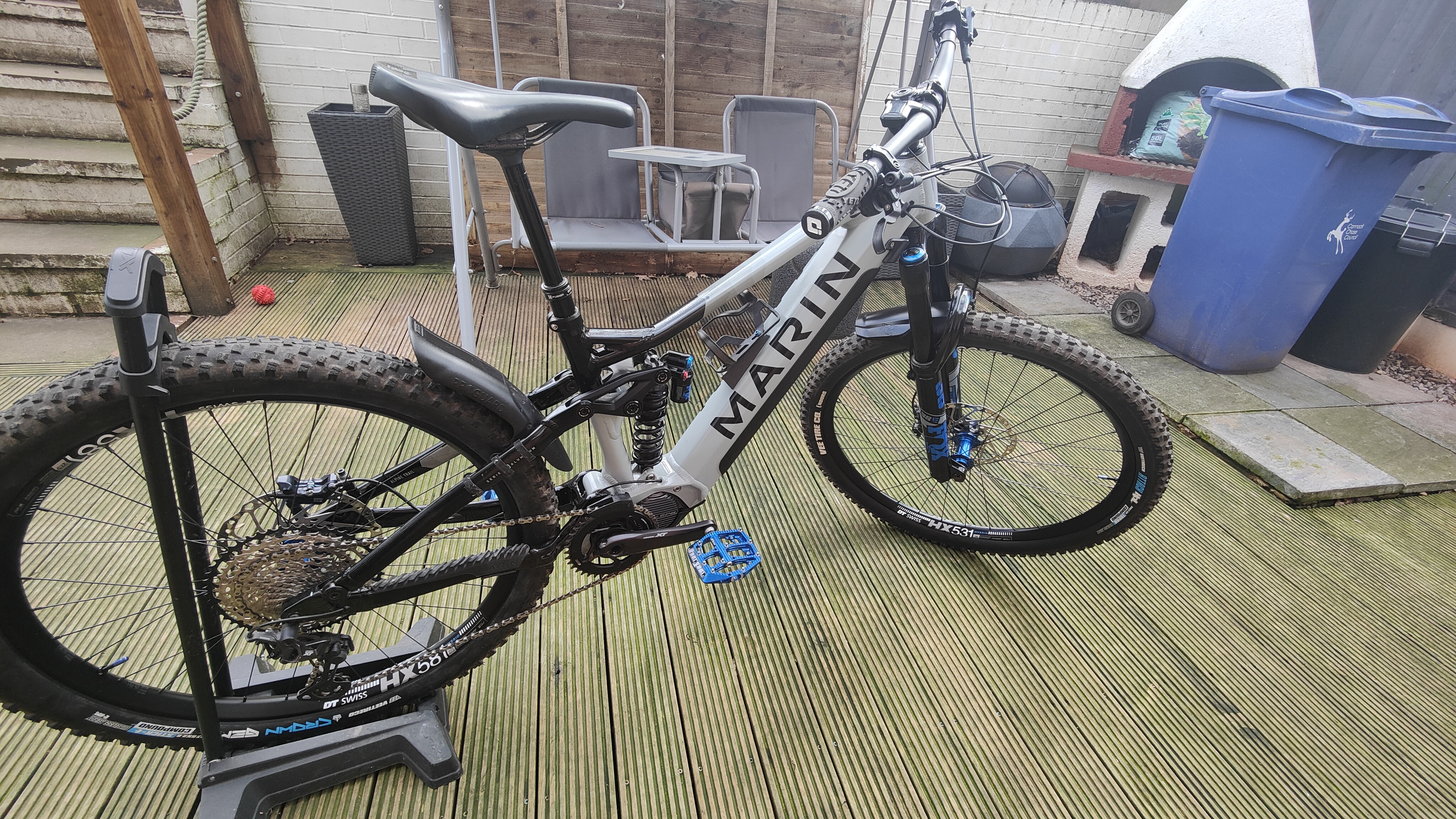

Well while I'm on, the bike is almost 1 year old now, haven't once regretted getting it, slowly making it my own with the blue additions (have the oneup components V3 remote dropper lever coming tomorrow, which with the blue thumb pad will look nice).
For now though...loving it...
Those blue additions look really good! Did you add the DT Swiss rims? What front and rear hubs did you get? Do you like the rims and hubs?
Just got back from the second ride on them - and yes, had them hand built to this spec. The Pro5 hubs just roll forever - I ride the same trails all the time, mostly and I'm finding I'm pedalling much less on the flats and certainly on anything that's even slightly 'down'. It now holds its speed so much better.
Also it feels 'poppier' so it leaves the ground more easily due to the lighter, stiffer rims.
I think I've probably made just about the best upgrade I could have. I didn't think the stock wheelset was too bad, but now having had a couple of rides on the DT swiss and Pro5s'...wow - WHAT a difference.

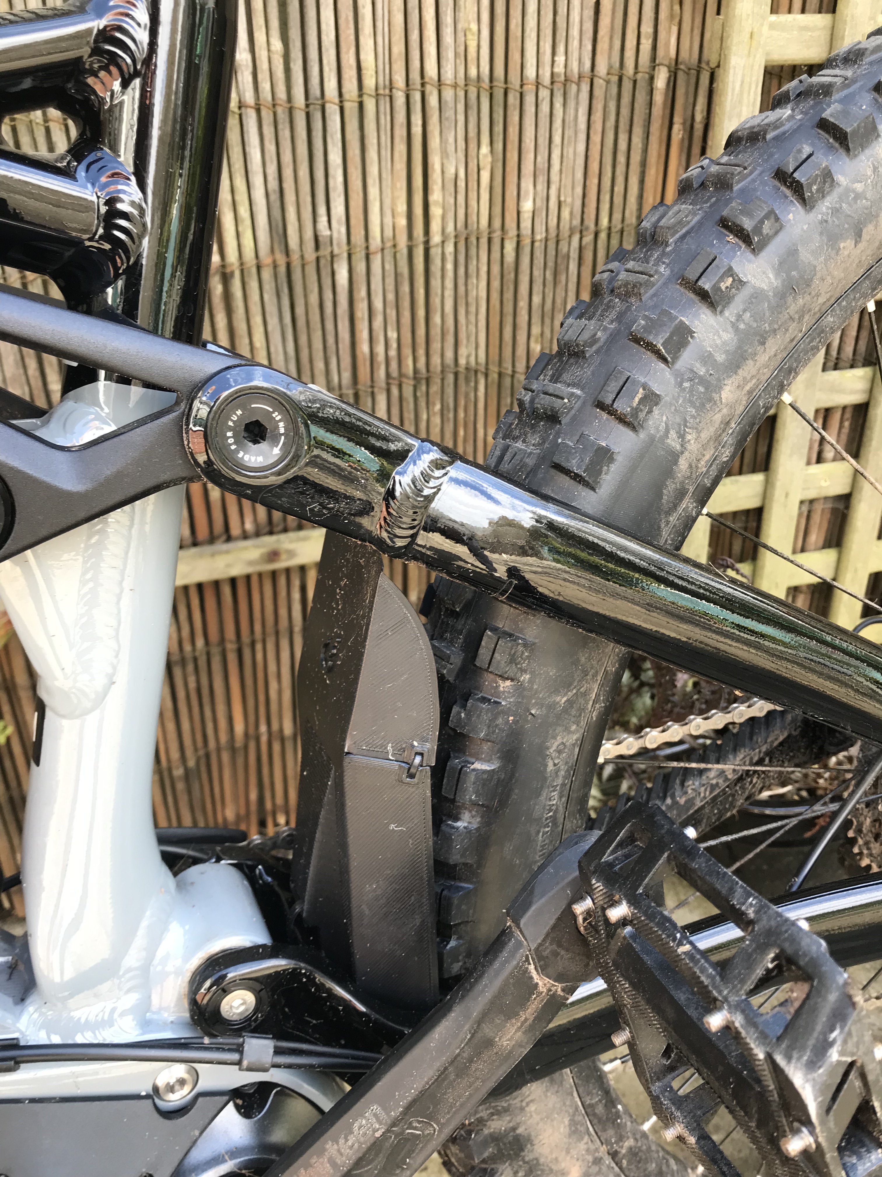

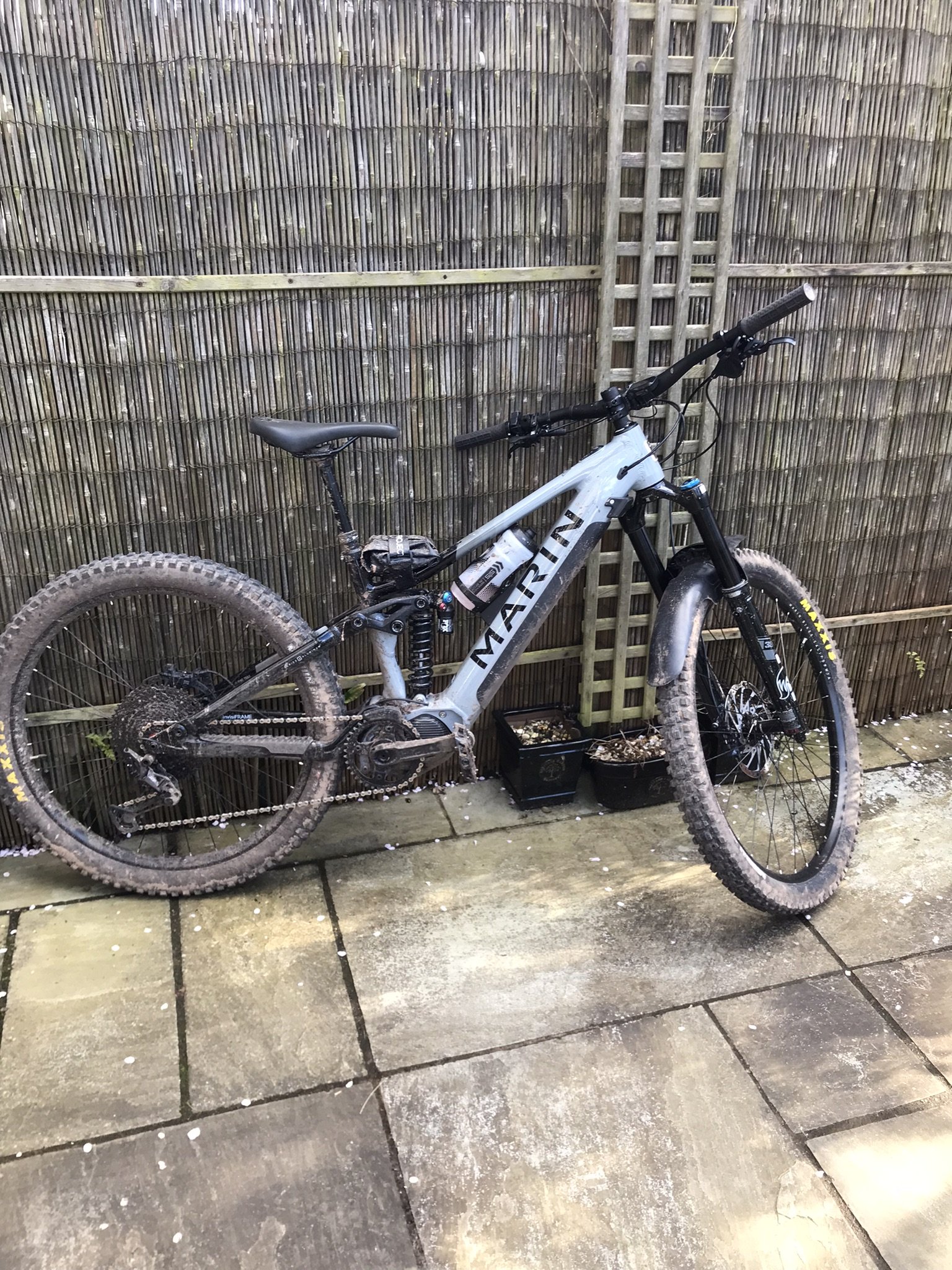

Here’s a few pics of my bike, had a couple of weeks, loving it so far. Added the small rear guard and bottle cage adapter which has worked out ok but I’ve added a couple of pieces of sticky backed Velcro cos there’s not a lot of room for the bottle and I was concerned that if any mud should get between the bottle and the frame it might end up rubbing through the paint plus it should stop any rattling. Think I’ll be looking to replace the 350lb spring cos I’m getting too much sag and have had more pedal strikes than I’ve had for ages. I’m about 83kg geared up and even with 5 or 6 turns of preload I’m getting more sag than I’d like so thinking a 400lb spring would be an improvement. I’ve ordered a 32mm socket to be able to see how many spacers are in the fork and have a play with the setup. Forks feel ok but not as supple as the Lyriks on my regular bike. Oh, another thing the dropper lever is a bit flexy so might replace that at some stage.
I had 4 spacers in mine - taken them all out and it feels much better. Not as supple as the Lyriks were but then again these are much beefier, so probably a trade off. Am happy with them now.

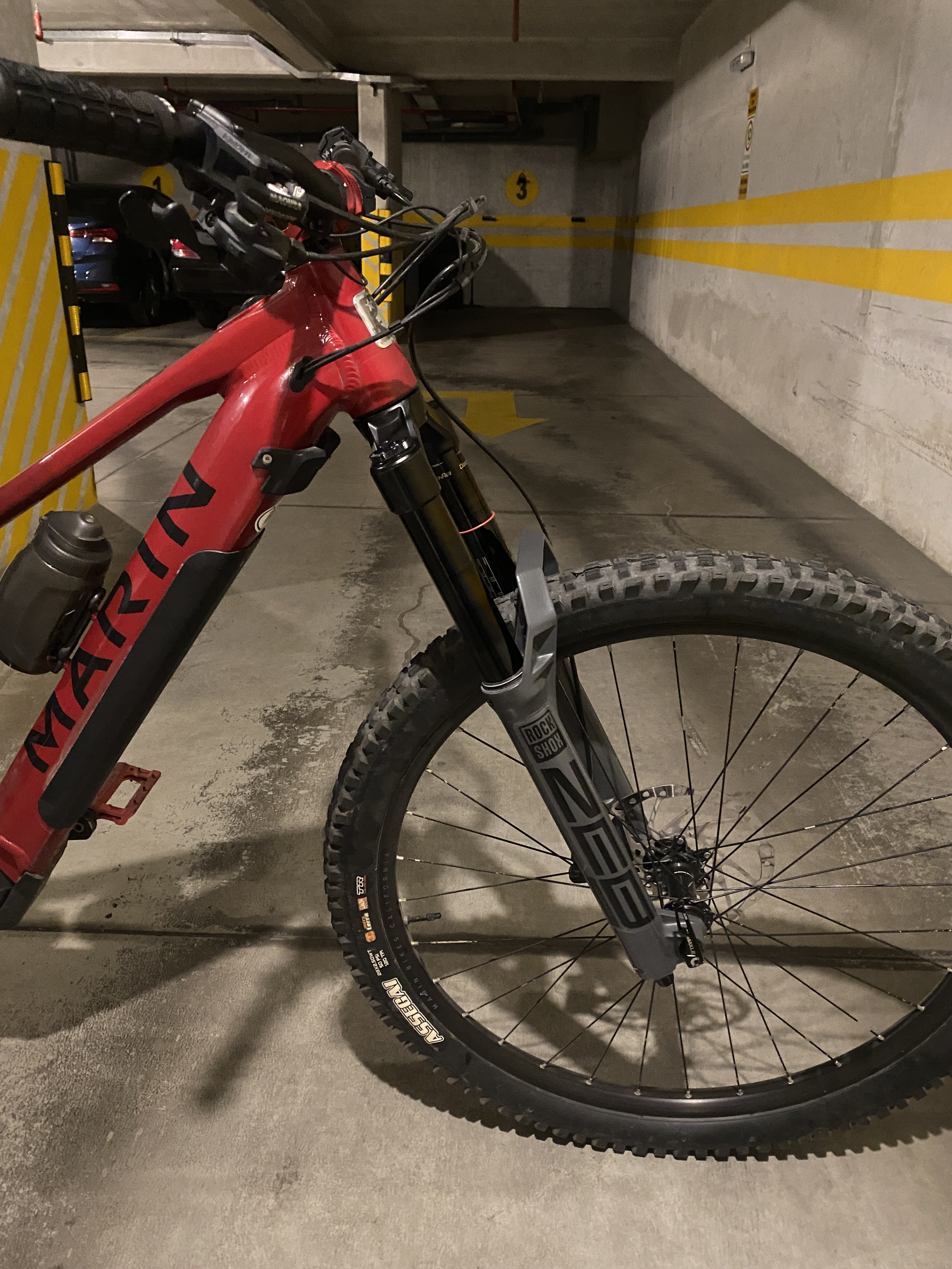

My Marin E2 came stock with a Marin branded rear hub. Anybody know who makes those for Marin? Or if they are made by Marin? Any thoughts on rear hub changes / improvements or on how the Marin hub performs over time?
I've had a new wheelset for the bike DT Swiss hybrid rims on pro 5 hubs. The difference is night and day, to the extent I've even noticed the battery draining less quickly. Also running rimpacts and maxxis instead of the Vees. Nothing wrong with the stock wheelset but obviously it's fairly heavy and doesn't roll as well.

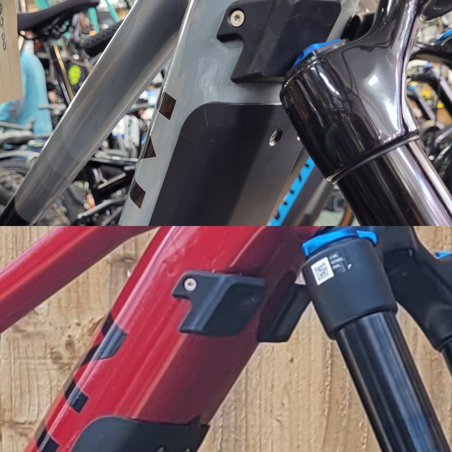

Does anyone know if I would be able to use the battery from an E2 in an E1?
I’d like to know this also 👍
Just been into my local bike shop and they couldn't answer but they had an E2 in medium and I had a look, took a pic. Mine is a large and the distance between the head tube and battery cover is longer than the E2 so I think it's a no, looks like the E2 battery is longer.
Good work - I'd say a definite no there.
Not a chance. The E1 takes the BTE-8035 and the E2 takes the BTE-8036. the BTE-8036 is a physically longer battery.
There is a battery, the BTE-8035L which is a 504wh battery thats just longer, to match the dimensions of the 8036, which Marin SHOULD have used in the E1 so you could easily upgrade the battery.
They didn't do this and the E1 is machined specifically for the 8035. This makes no sense as they need to have a separate manufacturing process for identical frames. You can see the battery on the E2 sits closer to the headtube than on the E1.
