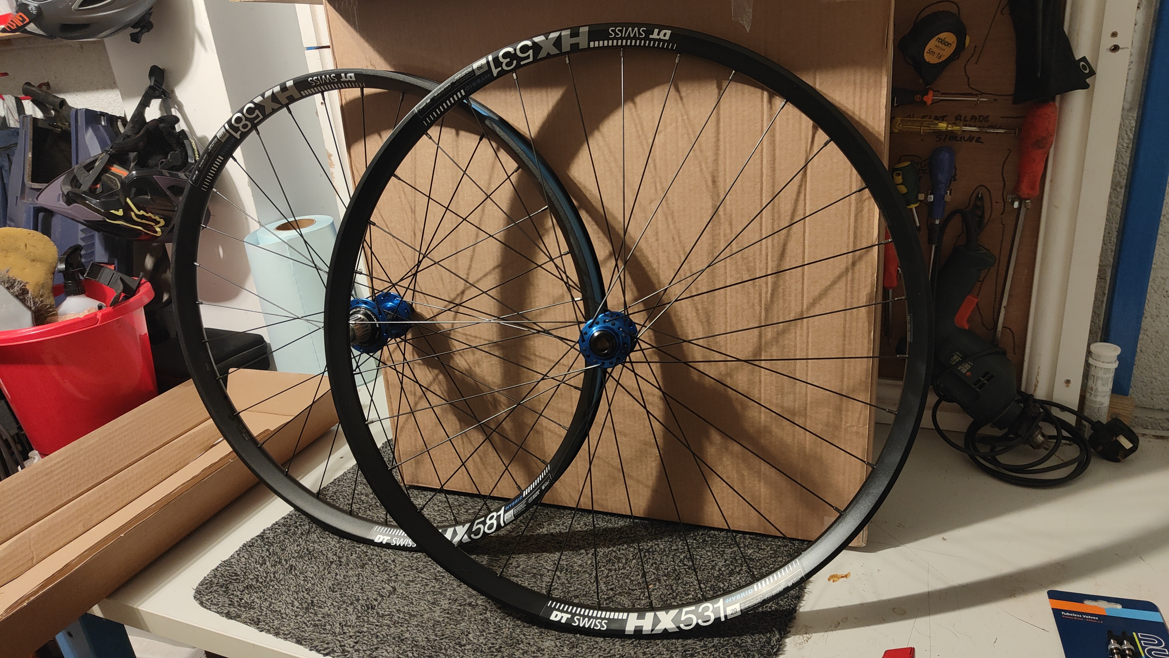

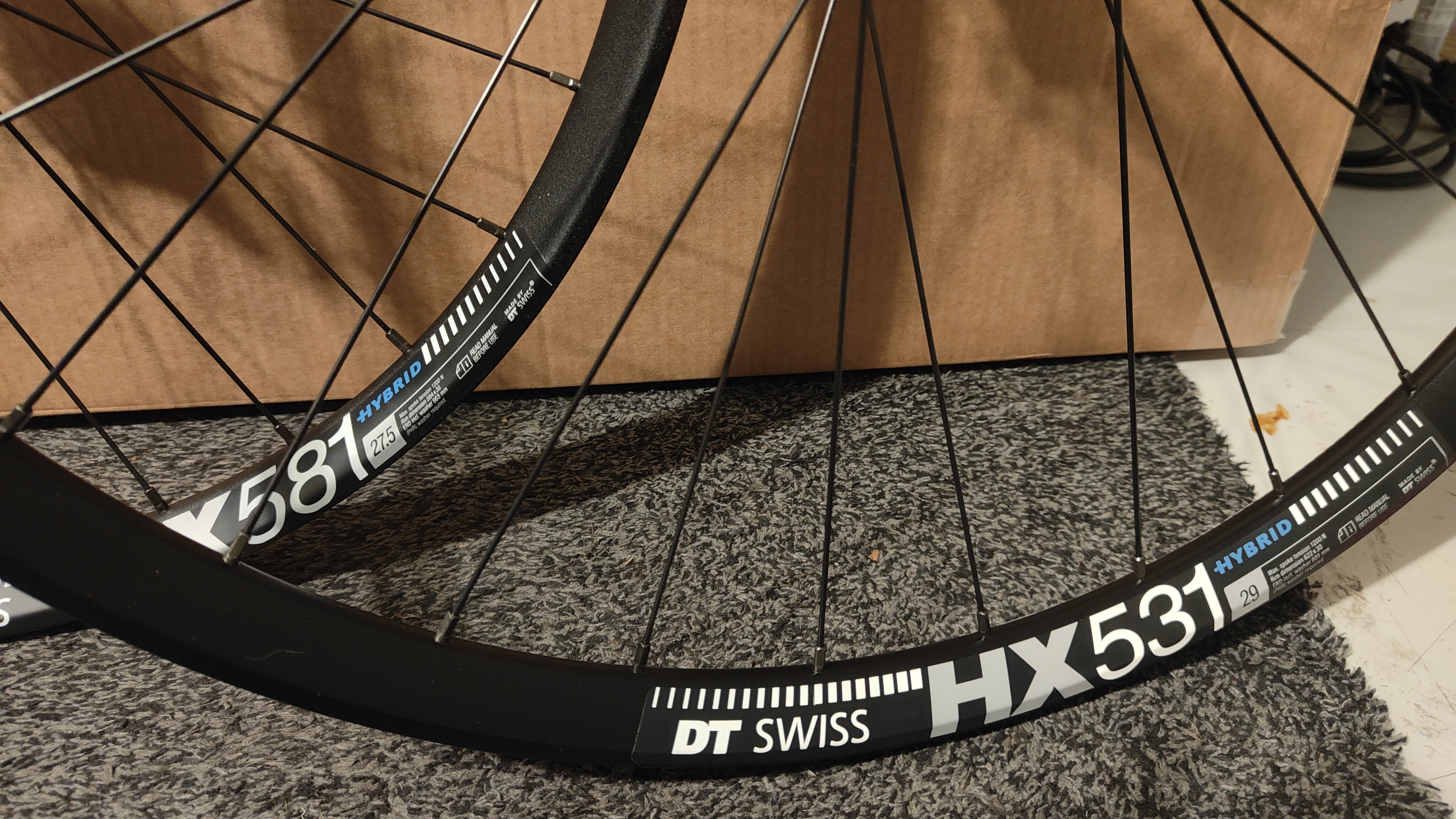

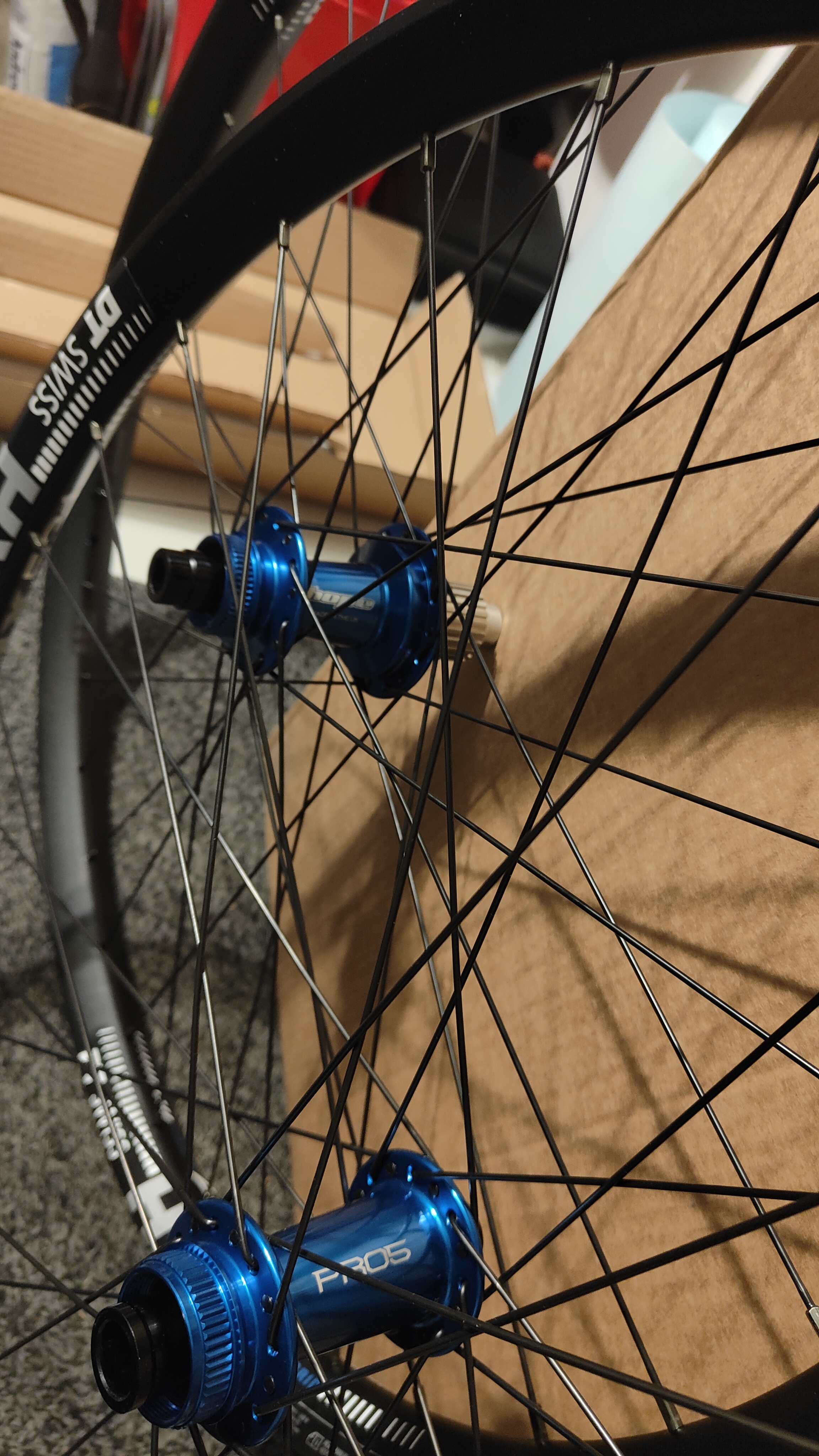

Just a little heads up for any UK owners on here. Have a new custom wheelset on the way. I was going to keep the originals and maybe use them in winter, but then realised I can't be arsed switching over, so if anyone wants a spare set of the stock wheels, make me an offer.
They'll be going in the sales page eventually.

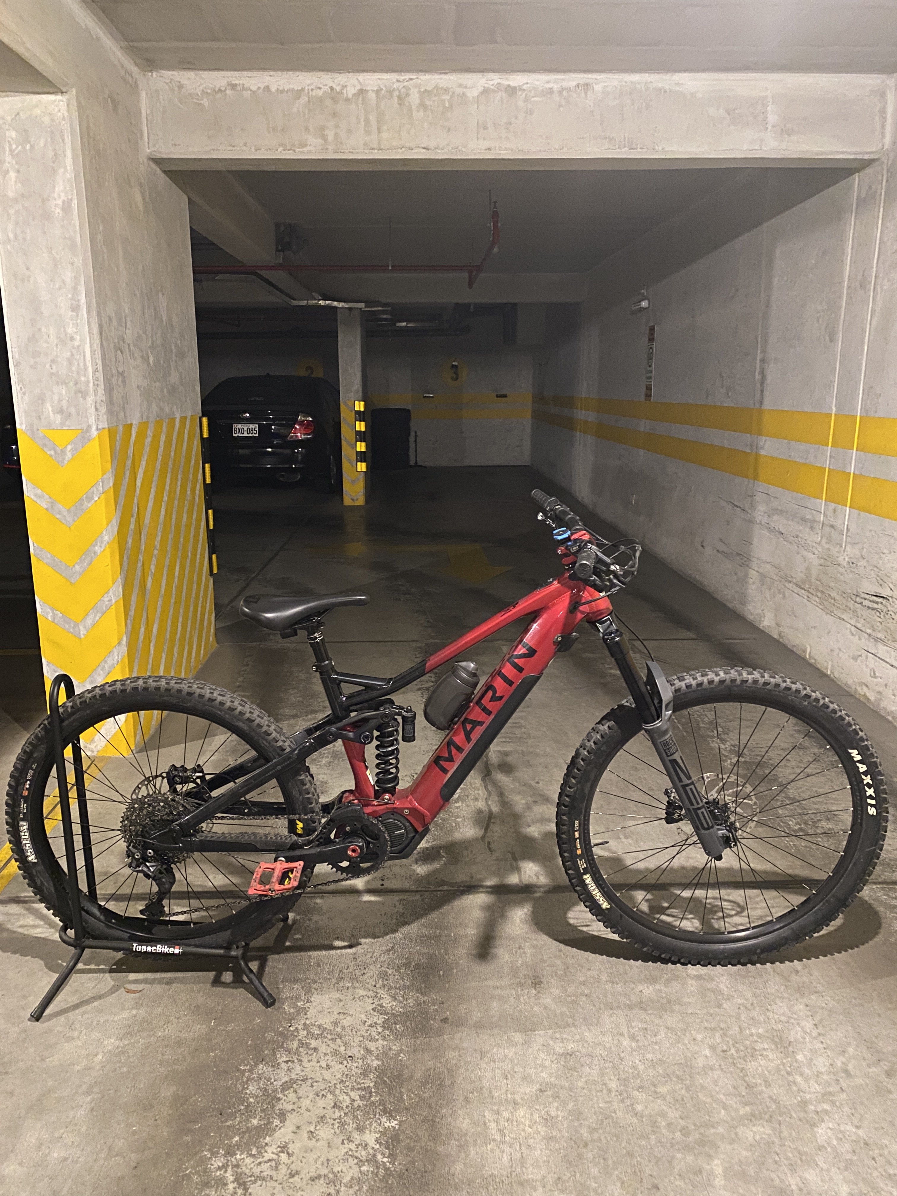

It’s been a while, tomorrow I’ll go to my local trail after a few months (around 7).

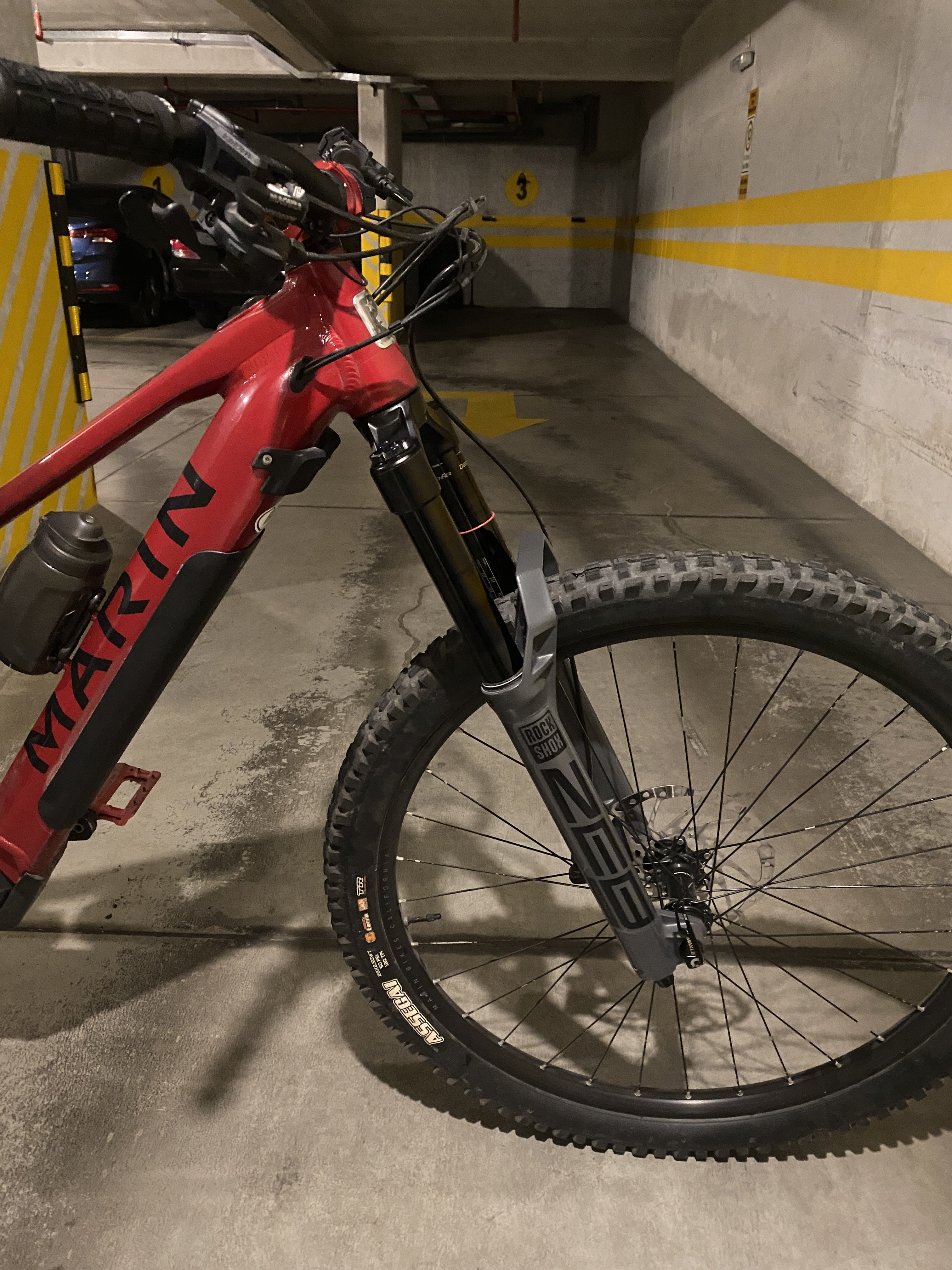

Just finished setting up a new suspension to my E1: Zeb Ultimate 170mm, looks great, hope it feel awesome.

I've seen someone go full 29er, not anyone go the other way, as you say the longer travel should mean you aren't messing with the geo. Let us know how it rides. Just ordered a new wheelset for mine, did briefly consider full 29er but stuck with mullet as I love how it rides and didn't want to mess with it with an expensive wheelset I might not like.
The Zeb looks great. So 10mm extra travel? If you are coming off 35's to those Zeb 38's you'll feel a huge difference, great upgrade.
Yep ditched the 35. Went to my local trail today, I felt so rusty. Never the less, instantly felt a massive improvement with the new fork.

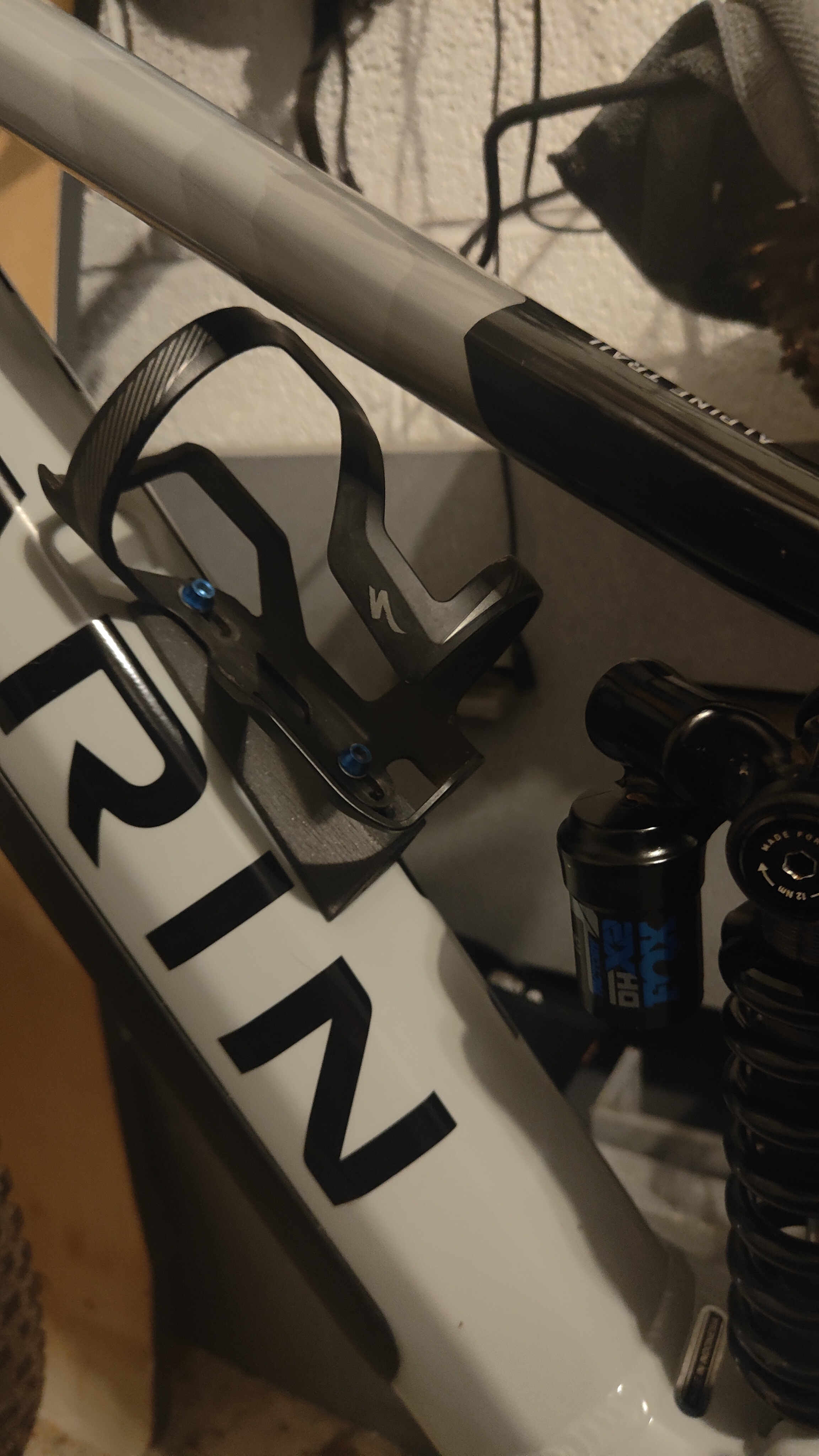

What bottle cage/bottle are people running? I like the fabric cageless bottle but I think it'll only fit the little one, just wondering if anyone has a better option
I'm using a fidlock 450ml bottle with holder, fit is perfect on a Large.
I'm awaiting delivery of a 3D printed adaptor someone is doing that allows you to fit a 620ml bottle on a medium frame - only cost £18. I'll report back on if it works or not.

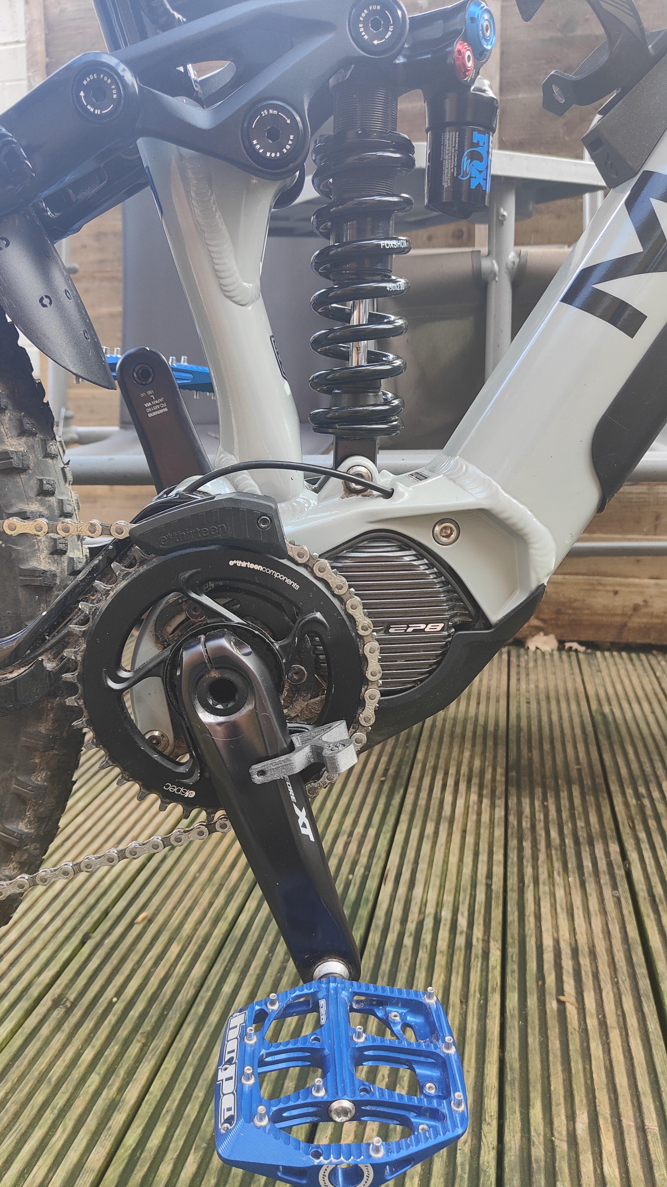

New to EMTB and have an E1, I noticed a rattle when costing down rough ground, after some investigation and making sure everything was tight, I've narrowed it down to somewhere around the motor, when the bike is stationary you can put pressure on and off by hand on the pedals and hear a rattle, is this normal or should I take it back to the shop and get them to investigate?
Are the bearings in your pedals loose?
Don't think so as brand new, its definitely coming from somewhere around the motor, almost like cable rattle, I've had the battery out to see if it was there but it not.
Pull your cable tight feom under the battery. Its a 2 handed job. Pull from the headtube outside the bike and feed it from under the battery. Probably the dropper cable.
Update on rattle, tried Pete-e1's suggestion and no luck. This is a video of the rattle.

So after a load of research it seems its a standard rattle on the ep8 motors and some of the m7000/m8000. Shimano know all about it and says its fine and nothing to worry about basically!
I checked my motor. It moves freely when back pedalling. when cranking forward and backward like you were, I don't have anything like you have happening. It's probably time to contact your dealer/bike shop or Shimano.
From what I've read I am unlikely to get anywhere with the shop as shimano say its nothing to worry about.
What I can't understand or find out is what it actually is making the noise and why do some have it and others not.
If you have a strange noise coming from your bike, then it needs to be fixed by the shop/dealer. It comes down to your consumer rights. Products not working as expected, not of a quality you'd expect for the price, fit for their intended purpose etc.
The fact its nothing to worry about according to Shimano means nothing. If you have a bike that makes a noise that other bikes do not make, there is a problem. The bike wasn't intended to make that noise. If you like, I can take a video of my bike not making the noise that you can use to show them how your bike should sound.
What country are you in?
I'm too late then! Was changing my wheels today and tested the cranks and same noise as yours, yet it's never bothered me when riding in fact didn't know it was there, something to do with the motor clutch? Anyway I'm assuming that that is the infamous EP8 rattle when going down rough trails?

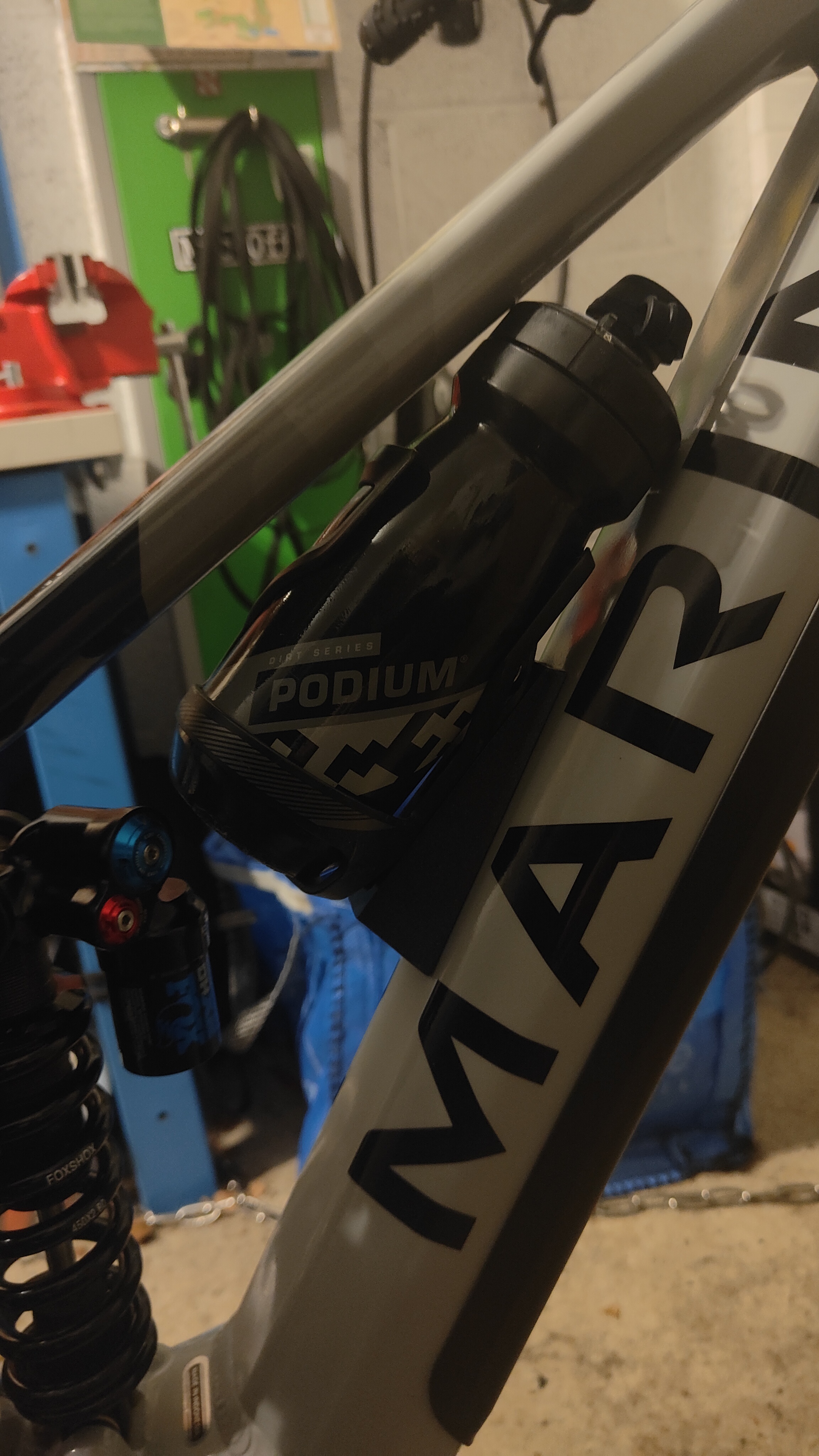

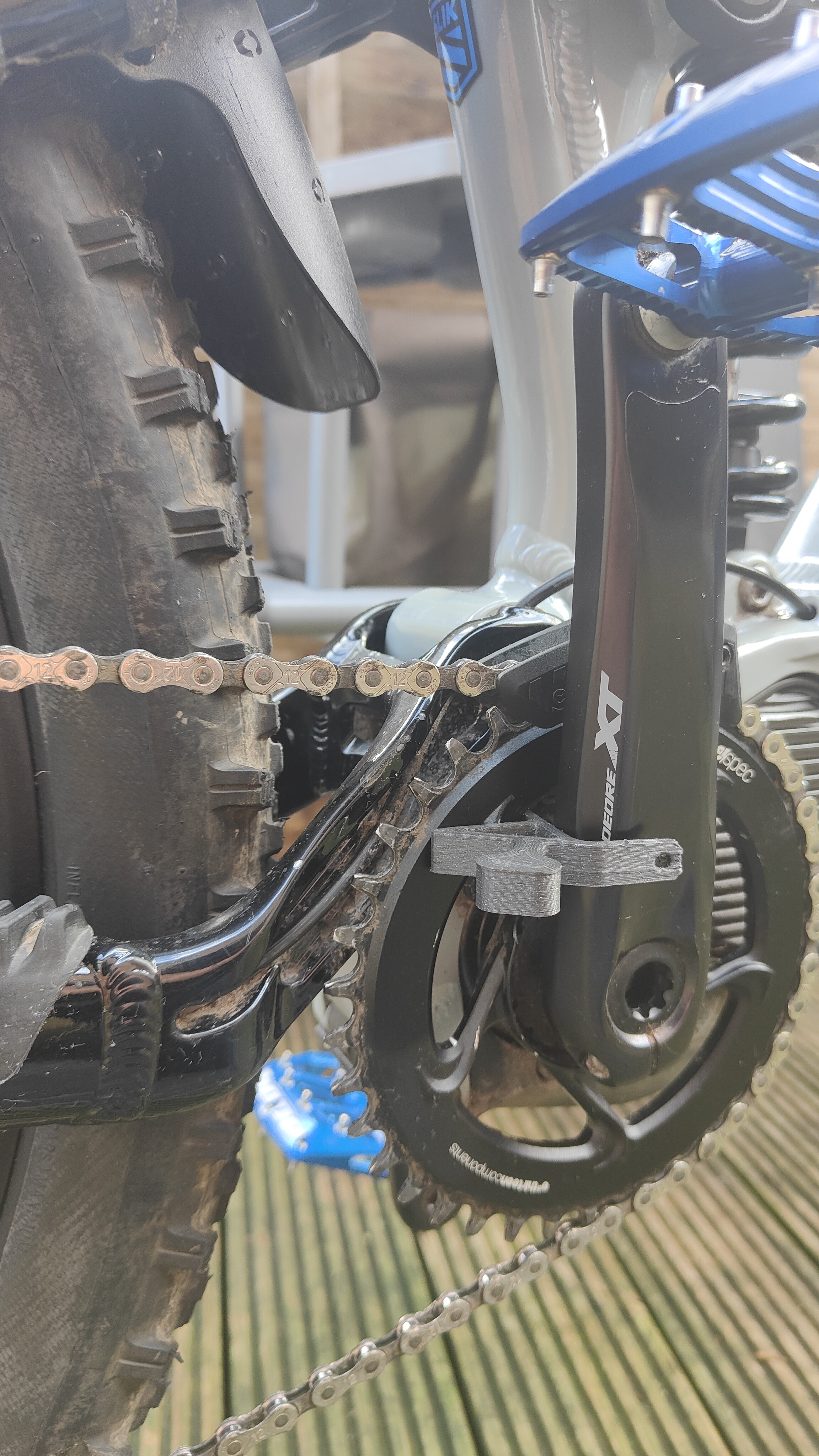

Right, this needs bigging up, big style. Bought this from someone who had the same problem as me with the shock wearing a hole in his water bottle so he designed and 3D printed this so's you can fit a 625ml bottle to the medium frame with loads of clearance. For £20 it's brilliant, fitted today. He even included free a really nift gadget so you can lube your chain by pedalling the drive train backwards. Top notch!
