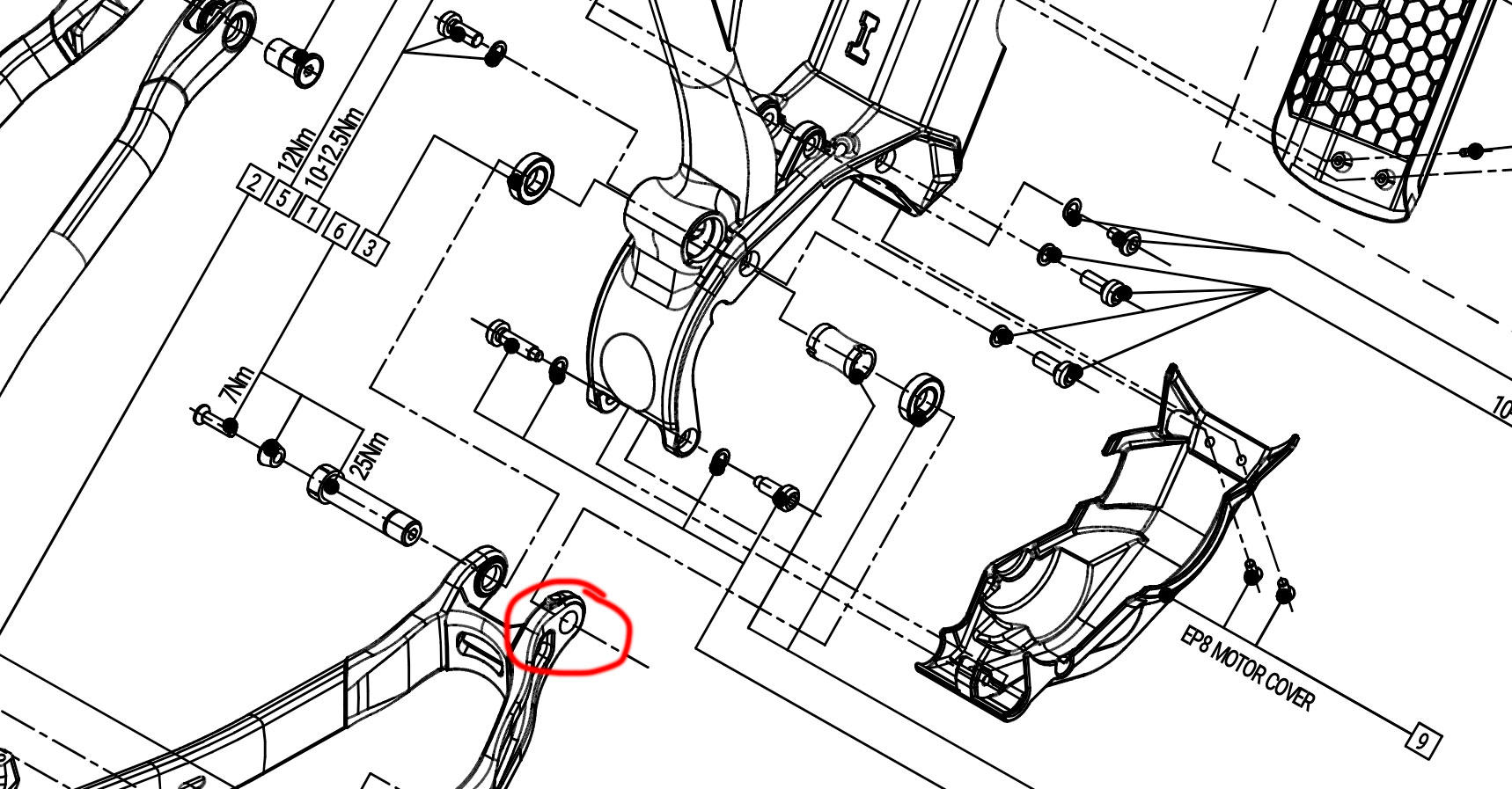

Should there be a threaded cap of some sort on the circled side of the chainstay pivot? The opposite side says torque to 7Nm but what does it screw in to. I think I might have a threaded cap gone walkies whilst out riding.
Hi Cleggy,
the screw (7Nm) is just used to secure the axle and is screwed into the axle. Its purpose is to slightly expand the head of the axle (with the help of the small cone shaped washer) to make sure the axle doesn't start rotating when the suspension is active. The axle bolt itself is torqued with 25Nm into (probably) some sort of insert in the chainstay (your red circle). From the outside it is covered by the chain guide so I am pretty confident that there is nothing missing. When there is some piece missing you will see the chainstay wobble around. Quite some time ago the 7Nm screw was loose on my bike and the axle had started to move outwards. Even though it was still in place you could see the rear triangle moving when I pressed sideways against the rea main pivot.
Cheers, Tom

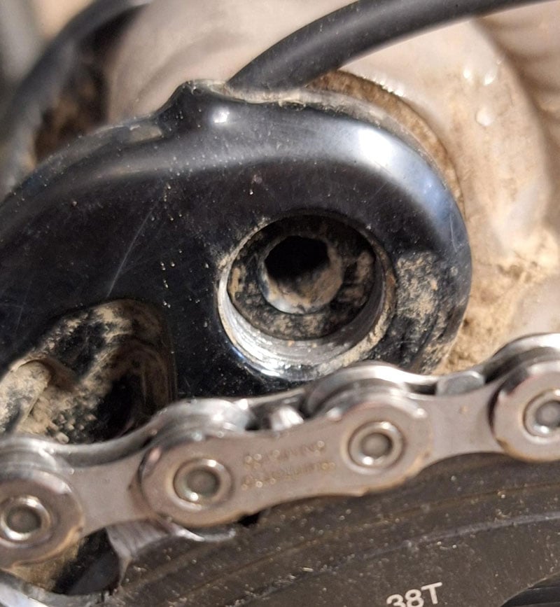

Thanks Tom, so this is a pic of the red circled side post-ride, pre-wash.
All ok?
Still looks weird to me like its threaded and nothing threaded in to the "gap"
You are right, this looks a bit odd. But it seems to me as if there is some kind of thread in the inner silver surface.
Can you still torque the axle (with the 7Nm screw and the conical washer removed)?
