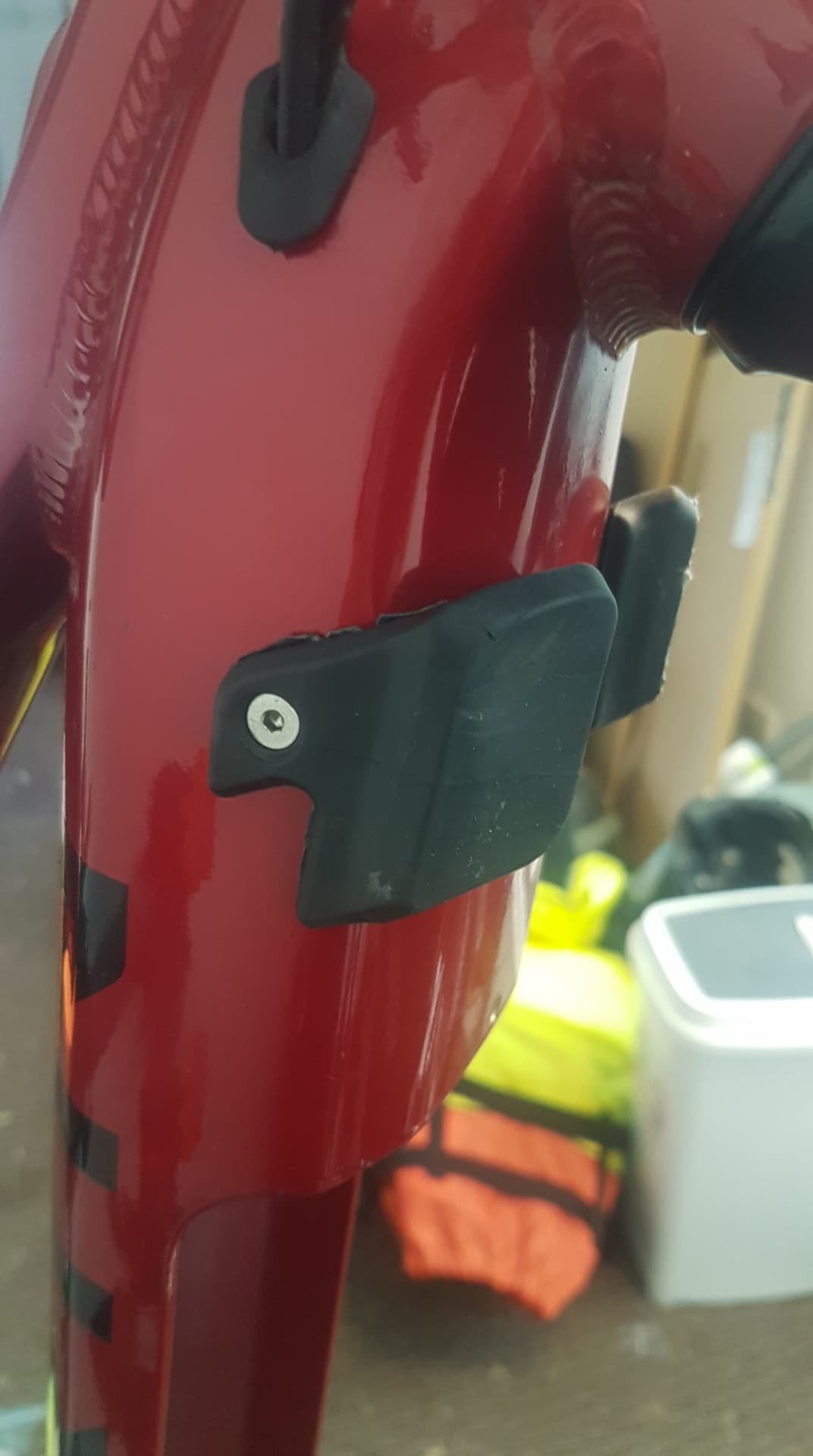

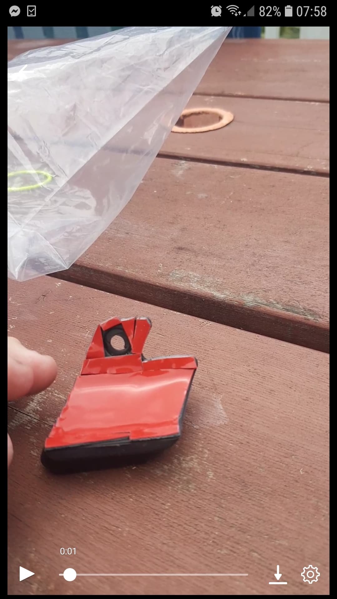

Has anyone has the bump stops (to protect the frame from the fork) come off? One of mine came off my E2 after transporting in a pickup truck and I was wondering if anyone knew what kind of glue to use?

Sorry hasn't happened to me (yet) I'd be tempted to use gorilla double sided sticky tape? Not gonna do the paintwork any favours if you take it off but whose gonna see it?

I literally replaced mine yesterday. Mine moved/came off a a long time ago and Bikeonline sent me out some mastic tape (industrial double sided tape) to stick them back on until they had replacement bump stops in stock, which they sent out to me.
Before yesterday I had Duct tape wrapped around the downtube to keep them in place. The original adhesive got ripped off the bump stops.
I cleaned all the adhesive from the frame and the back of the bump stop, cut and placed the mastic tape on the back of the old bump stop and put it back on the bike and put the retaining screw in place.
The replacement bump stops they sent me have the double sided tape pre cut to the right size/shape on them. I'll keep them for late if these ones happen to split or tear off.
I've been thinking of wrapping an old tube around them to offer a bit more protection as well. Not had time to do it though.
