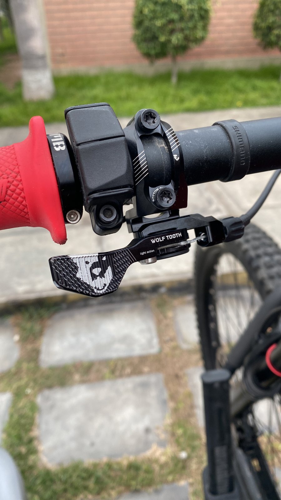

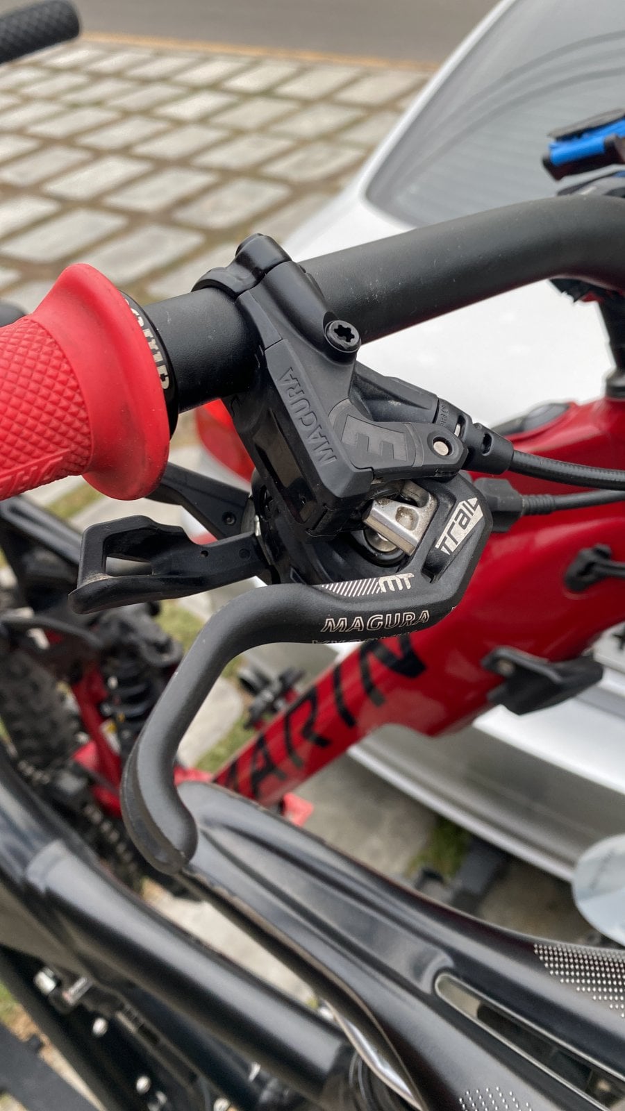

Ok got the Magura’s tested and they work amazing. Even having 2 pots rear + 4 pots front, still feels better than Shimano’s budget 4 pots rear + front.
Next I’ll be upgrading front rotor to 220, I’ll kee rear with 203 (I’ve read somewhere 220 at the rear gives problems).
I also got a Wolf Tooth dropper lever, which feels much nicer.
All brake levers, shifter and dropper lever are mounted with a single clamp on each side, cockpit looks much cleaner.

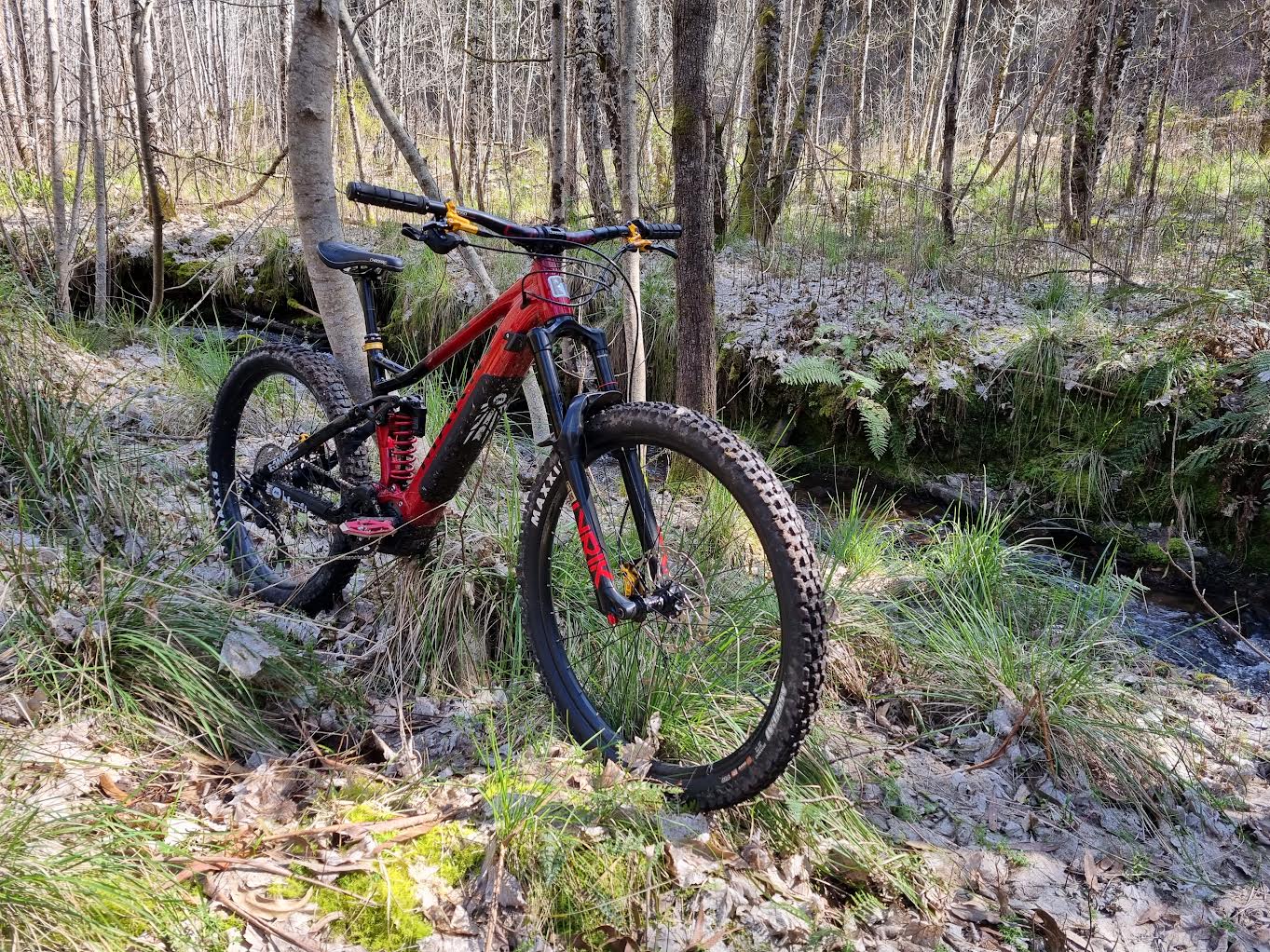

Been following this thread for a while so thought I may as well join the conversation. Here is my 2022 Alpine Trail E1 with a few mods.
Got rid of the fork like most as the Gold 35 are pretty average and picked up the Lyriks used for a good price but may need to increase the rise on my bars as the steerer was cut a bit shorter than I would have liked.
This was the first ride trying a 450lb spring and I feel like I am halfway in between but will give it some more time.
Just changed to a 200mm Fox transfer dropper which fits the large frame slammed. A 200mm dropper really should have come as standard on the large frame.
The gold brakes were the only ones in stock at the time for a reasonable price so don't judge the bling too harshly, kept the stock rotors and despite needing the shop to route the cable around the motor after I lost the end of it, they were pretty much plug and play.
Overall loving the bike and being more confident to join rides that I would have avoided on an acoustic bike due to fitness.
Frame – Marin Alpine Trail E1 – Large
System and Battery – Shimano STEPS E7000 and 504wh battery
Rear shock – RockShox Super Deluxe Coil R, 450lb spring
Front shock/fork – Rockshox Lyrik Select 170mm
Handlebars – Chromag Fubars OSX 35, 25mm rise
Stem – Chromag HiFi V2 35mm
Grips – Oury lockon
Saddle – Chromag Trailmaster DT
Seatpost – Fox Transfer 200mm
Dropper Remote – Wolftooth light action
Brake – Formula Cura 4
Cranks – Marin 165mm
Chainguide -Marin 38T (thinking of changing to a 36T)
Pedals – Spank Spike
Rear derailleur - Deore
Rear shifter -Deore
Cassette – Deore 10-speed 11-46T
Wheels – Marin stock
Tyres – Front, Maxxis Assegai 29x2.5, Rear Maxxis Minion DHR II 27.5x2.8
