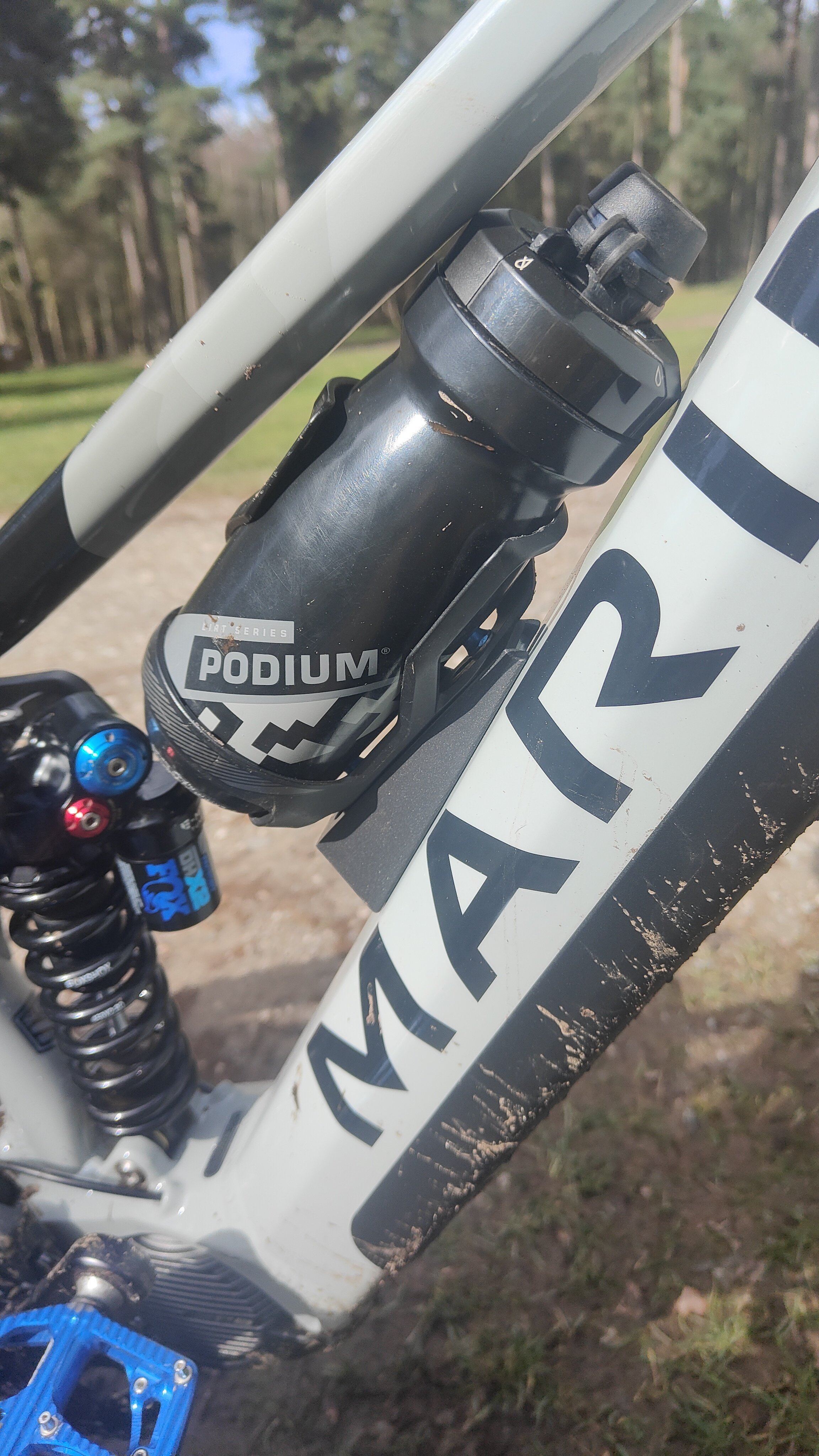

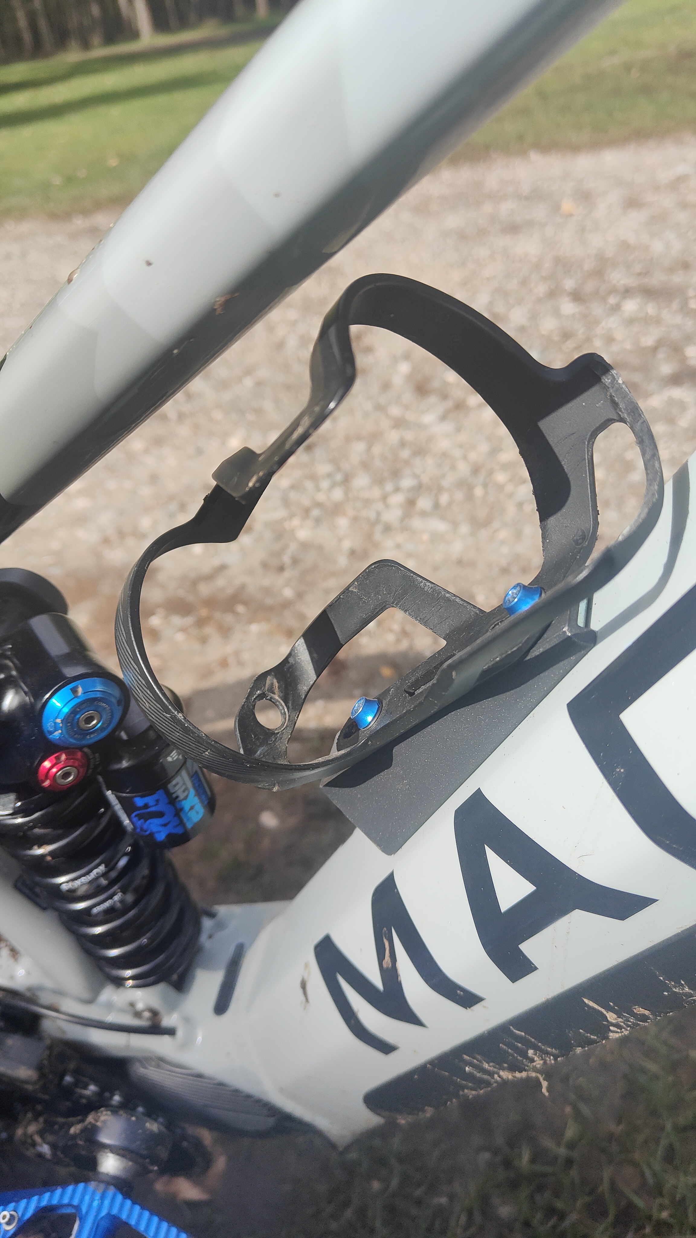

Hi folks. First post on here, just got my E2 last week. Only 2 rides so far but loving it.
Can anyone help me with bottle and cage ideas on a Small frame? I've skimmed through most of this thread and nobody seems to ride a small. I've emailed the guys that make that 3d printed shim to see what they say, hopefully someone has a proven solution.

Fairly sure the lad at Cycle Solutions will sort you out. I've got the 3D printed adaptor on mine (a medium) and there is loads of wriggle room.

Cheers. What brand of bottle and cage are you using? I've offered up a couple of my bottles, a 650ml and a 500ml and there's almost no room at all.

A specialized side loading cage and a Camelback podium 650ml bottle 👍
I did file down the inner lip on the spesh bottle cage to make a better fit but as it is only plastic was a 2 minute job. I know it looks tight but there is loads of adjustment on the slots where the cage is bolted on, I have it as high as it will go to make sure it clears the shock, I could have it a bit lower than it is if I wanted.
View attachment 122478 View attachment 122479
Cool, cheers. What size frame?

Howdy. I've given up on the bottle, there just isn't enough space in a small frame. Got a good deal on a low-rider camelbak so I'll be going back to that for long days out.
