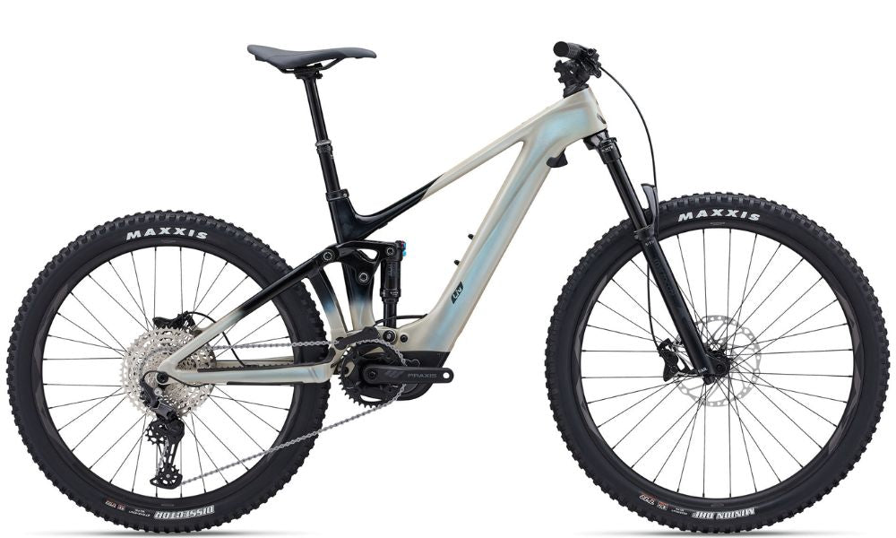

We tried a mullet 2024 giant intrigue in size xs and she found that bike a lot better fit and turn in was better for her.
But that bike was 21kg and only had a 400wh battery. Its low spec parts, its already out of date motor wise, too heavy with a battery too small.
What else is out there in teny tiny mullet full power bikes. That meet 20kg 600wh battery spec.

Hi @Plummet I live in NZ and the bike you are describing is the Cannondale Moterra SL. It's 19.3kg in size small and meets all your requirements.
Bonus that it's also on sale, and from personal experience rides well for what it is too.

You are right that is pretty damn close on to my spec. Mullet, sub 20kg, 600wh battery 85nm torque, 150/160mm. Plus its a bunch cheaper than the others. A fully stacked Cannondale Moterra SL is $14k and lower spec models starting from $10k V base model SC vala around $14k plus the base.
The other option is the transition regulator. But ideally id have a the CX regulator built like an sx regulator. Both Vala and regulator would require expensive buying and selling of parts to get the right parts mix on top of the $14k initial buy price.
I think im going to bypass all 29ers and stick to mullet and bikes i'd need to convert to make into the bike i want. Ie, I dont want to by an extremely expensive bike then have to buy and sell shit to get to the spec i want.
So I think the Cannondale is currently winning the race.
