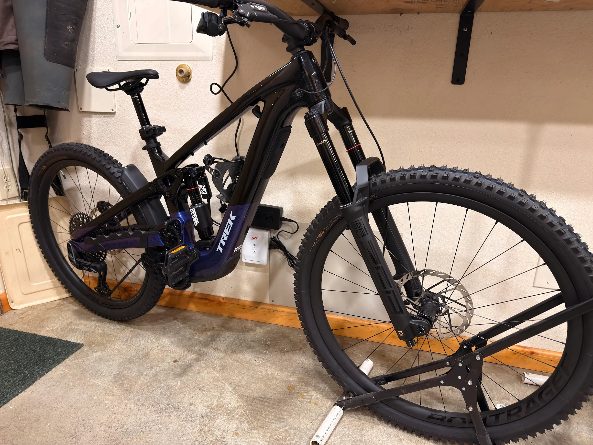

Bought a slash+ shimano build, primarily for the frame. I've only kept the frame, grips (new ones on the way), shifter, derailleur, chain, crankarms, chainring. Might swap the drivetrain later, I'm running a sram cassette.
Frame: SLash+
Battery: 360wh
Shock: Ohlins ttx22m/Fox Float X/Vivid (I have all 3, the weight above was with the Float x, but I plan to run the ttx22m)
Fork: Mezzer Pro
Stem: Anvl swage (but I'm switching to an i9 - tweaking reach)
Bars: One Up 50mm rise (I normally run 35mm, but I'm trying to get closer to my madonna stack/reach)
Grips: Stock bonty - but I normally ride PNW Loam - so those are going on when my set comes in.
Brakes: Lewis LH4 with the shimano 203mm rt66
Tires: Magic Mary Radial front and rear, gravity rear, trail front
Shifter: Shimano M8100
Derailleur: Shimano M8100
Cassette: Sram xg-1295 10-50t
Wheelset: One up hubs, pillar bladed spokes, alloy nipples, carbonfan rims - I've build similar wheels on all my bikes. I ride in santa cruz pretty dang hard and I've only cracked one of these rims so far (but I don't think anything would have survived what I did - and they had 1200 miles on them at that point). Total weight about 1600g for this set.
Dropper: 210mm one up
Saddle: ryet carbon - seems comfortable so far - the only intentionally 'light' part of the bike
Pedals: tatze link - pretty light, forgot about this. They were spares off a bike I sold.

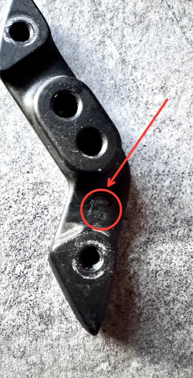

On my Slash+ I wanted to try installing a 29" rear wheel. So I tried buying the lower link used to mount the shock to the frame, the one officially made for the non-electric Slash with a 29" rear wheel.
The link arrived and it works perfectly on the Slash+ as well. I was even able to keep the rear mudguard installed, with about a 10 mm clearance from it with a 29x2.40 rear wheel.

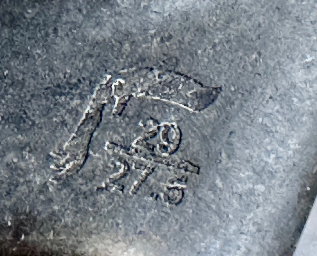

However, when I removed the original Slash+ link, I noticed that on the inside it has “27.5/29” stamped on it, as if the same link—maybe mounted in reverse—could also work with a 29" wheel.
Does anyone know more about this?
PS: according to official TREK manual/documentation, installing a 29" rear wheel is not bossible, neither with a spare part nor with the original link...
I don't think it's reversable. I assume it just means for a bike with a 27.5 rear and a 29 front. A full 29er version would be stamped with 29/29.
Did you happen to compress the suspension with the 29" wheel and shock removed? (of course, you'd have to measure to figure out where the shock would actually bottom out)
I've noticed this bike can bottom out pretty violently. Not a problem with proper shock tuning, clearance checks and gentle shake-down rides....
