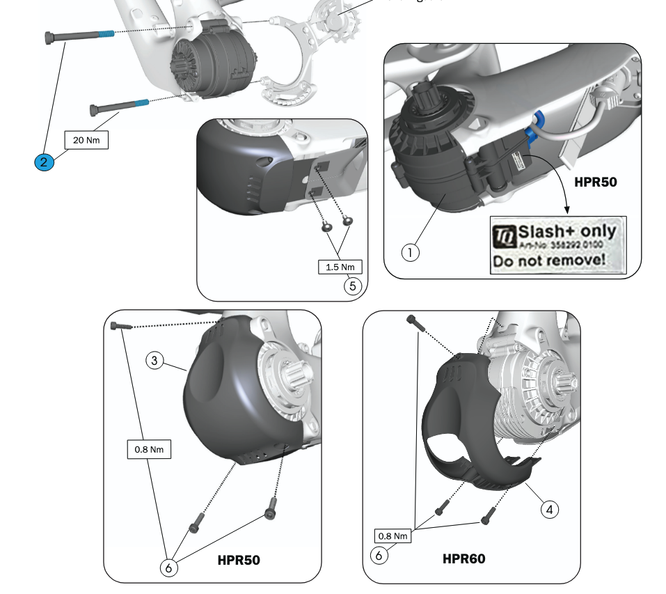

TQ claims they fixed the thermal limiting with the new 60nm motor cooling fins..but that is TBD.
I had some initial concerns that the cooling fins were not going to be present on the updated Slash+ as the photography of the new bikes doesn't seem to show them.
But having spotted this in the Fuel+ video from Trek, I guessed it must have been a subtle change for the Slash+ to expose them. And yes, it looks Trek have revised the Slash+ Service Manual with what looks like a new motor cover that seems to expose them - so here's hoping that they do the trick.
On that note… does anyone actually know for sure why the HPR50 had a Slash+/HP specific variant?
Haven’t seen anything similar for the HPR60… yet.
Allegedly specific tuning to do with the fact it has a high pivot, iirc.

Nice idea, but somewhat flawed.
- You can't buy the HP variant of the HPR60 that TQ have 'designed' for the Slash+ yet.
- Even if you could it would likely cost £1.5k if the current one is anything to go by.
- You'd need a Trek dealer to activate it, although not a problem when you can only buy the motor from them.
- You'll 'only' get 300W of power and you'll need the updated HPR60 motor cover as well.
Yes, there are some excellent deals on the older-gen Slash+ but none warrant buying the bike and then a new motor - the maths doesn't really work.
Best you could hope for is to get a deal on a V1 Slash+ and break the HPR50 at some point in the 2-years of warranty and then have Trek give you a new HPR60 instead. That was my plan, anyway.

I disagree. There are HPR60's listed for sale, as low as $900usd, just no stock (yet).
The plastic hpr50 motor cover could be easily modified, nothing special there.
More likely that once the current stock of HPR50s & Slash+'s are sold out, and Trek has sold enough Fuel+s, trek will list the full power HPR60 (HP version) and related Slash+ small parts for aftermarket sale, or at least sell them through dealers.
This is not a parts compatibility issue, just an embargo. Once TQ/trek sees potential revenue through aftermarket sales, why wouldn't they sell things they already make? It's just a question of how long we have to wait.
There is also the possibility of just buying the cooling fins, sticking them on the HPR50 and DIY modifying the battery cover. If that reduces the thermal limiting of the HPR50, it could be a big upgrade.
Edit: Looks like they are available
And the possibility that Trek will eventually offer full power HPR60s as warranty motors, once the initial demand quiets down.
And they aren't the HP version, which is supposedly what the Slash+ needs. So you can't equate the HPR60 you listed to something we have no idea of the pricing for, but we can guess that it will be in line with what they sell now.
Which is $1,150 or £1,599.
