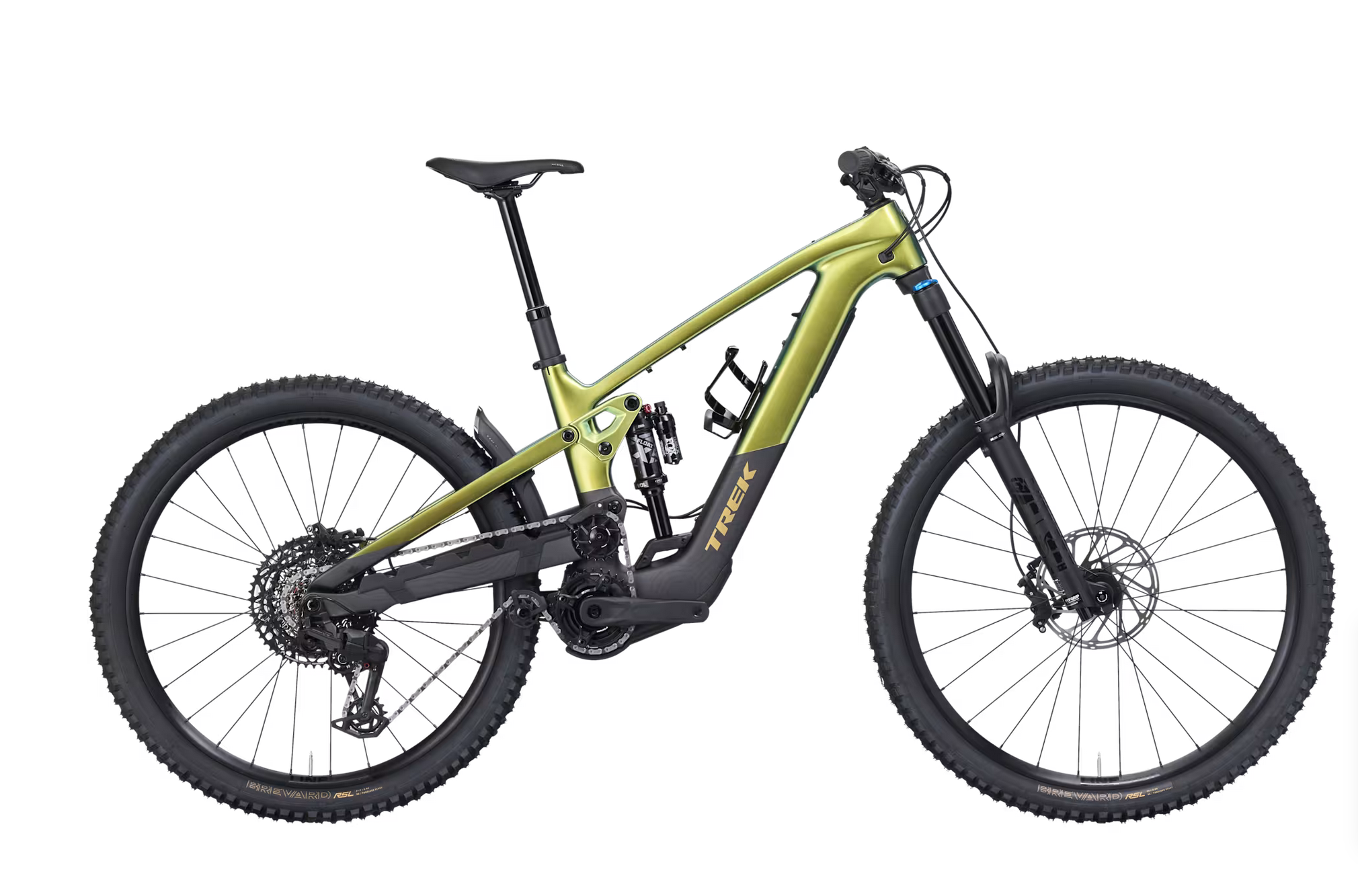

Trek Slash 9.9 X0 AXS T-Type Gen 6 Matte Chameleon Green /Dark Web 2026
€ 8,999 for the 9.9
Trek Slash+ 9.7 2026
€ 6,999 for the 9.7

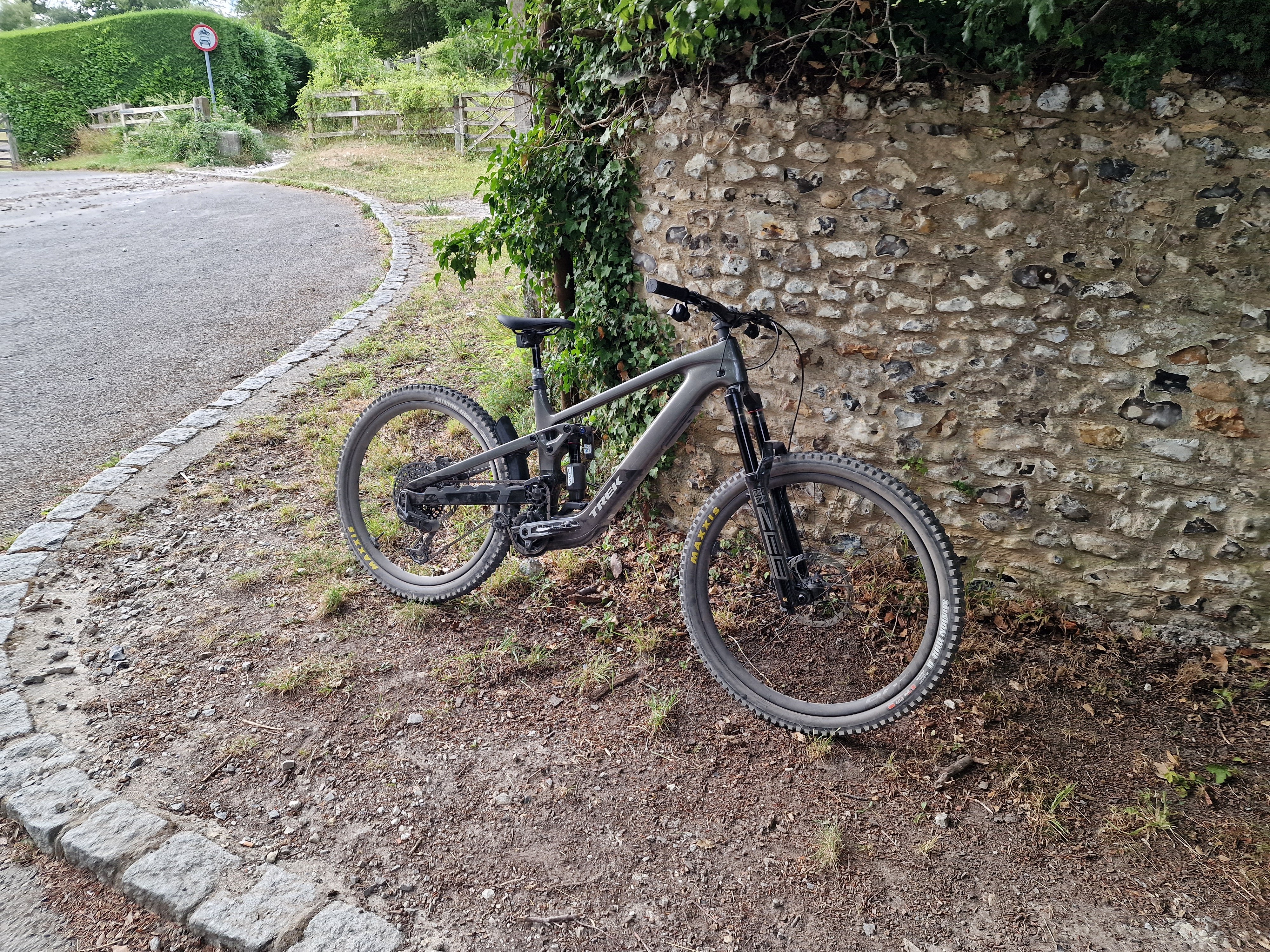

First ride after a quick setup. Oddly, I've gelled with it right away, it's everything I wanted it to be. Even the suspension tune feels 95% there at the recommended pressures and settings.
Some of the steeper climbs are a real effort now which is what I wanted.
The way the rear end grows is really awesome under deep sag, and yet nice and maneuverable when trying to dart around tighter stuff.

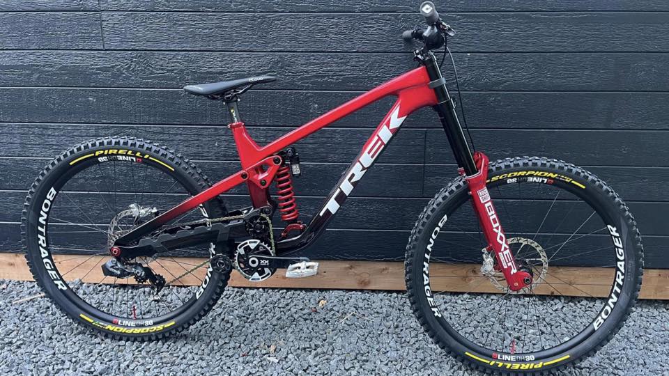

Saw this on the regular slash fb group, but apparently it’s a custom 190/190mm travel Gen 6 Slash with custom rocker/lower linkages and dual crown fork.
Not super relevant but kind of neat. Suppose it would be technically possible with the Slash+.

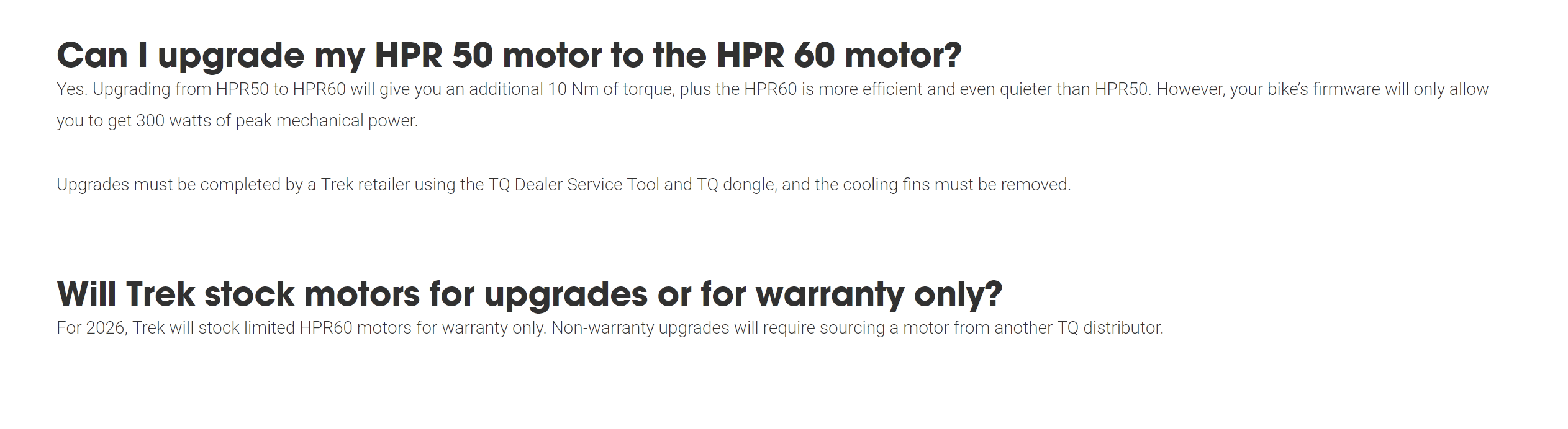

I have bad news and good news to report. After 3 months the HPR50 in my Slash+ started making bad scratchy noises at 280 miles and will be replaced under warranty. Unfortunately Trek has no stock of HPR50 available and it could take a couple months to restock.
Now the good news, Trek can replace my broken HPR50 with an HPR60 for an upcharge of $550. So I gladly said yes to that option! It will unfortunately still take a couple months, eta end of October, but I’m ecstatic that I will get the upgrade!
I don’t know any details beyond that, not sure if I’ll have the HPR60 cooling fins or not. I’m in Arizona in the US if anyone is wondering.
Yes they have under the motor
Sorry I wasn’t clear. The HPR60 can be mounted in place of the HPR50 if you remove the cooling fins, because some frames and motor covers do not have a hole for the cooling fins.
Now if Trek has already created a new Slash+ motor cover with hole, and will provide one for my bike, then they can leave the cooling fins on.
If they do not have that part available yet, then my bike will have to keep the old motor cover and cooling fins will need to be removed.
Personally I would push back against that upcharge, if they haven't got any HPR50's in stock that shouldn't be your problem and they shouldn't be up-charging you to fulfill their warranty obligations if they have HPR60's available.
I know for NZ/AU Trek has stated that they will be stocking HPR60's for warranty purposes from 2026 onwards. I wouldn't be ok with having to pay for a warranty motor when the original is only 3 months old, even if it's an upgrade.

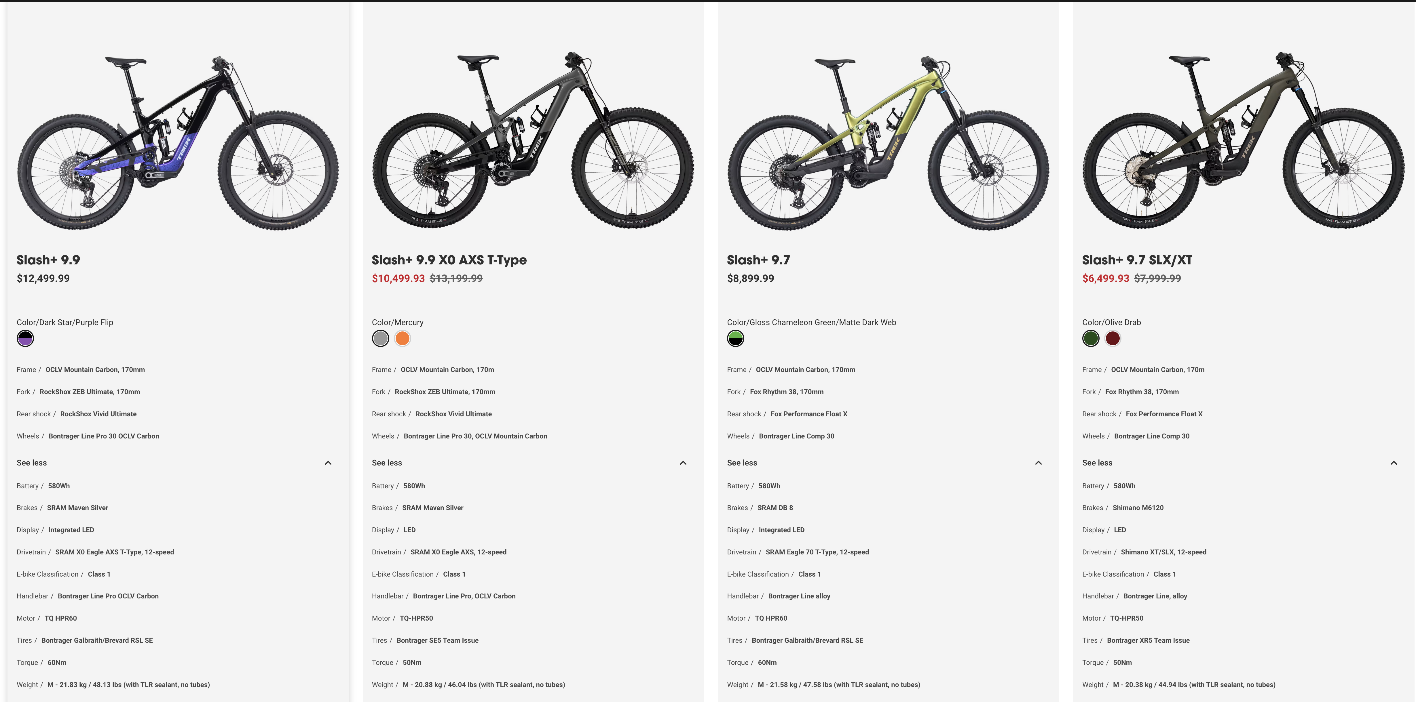

Looks like the 2026 Slash+ with the HPR60 has quietly been released in some markets.
Spec has been shuffled around a bit on the 9.7, Shimano brakes & drivetrain have been swapped out for Transmission 70 and DB8 brakes.
2026 Slash+ 9.7
2026 Slash+9.9
They only have one photo of each in the product pages though. I am curious to see how the HPR60 cooling fins have been integrated.

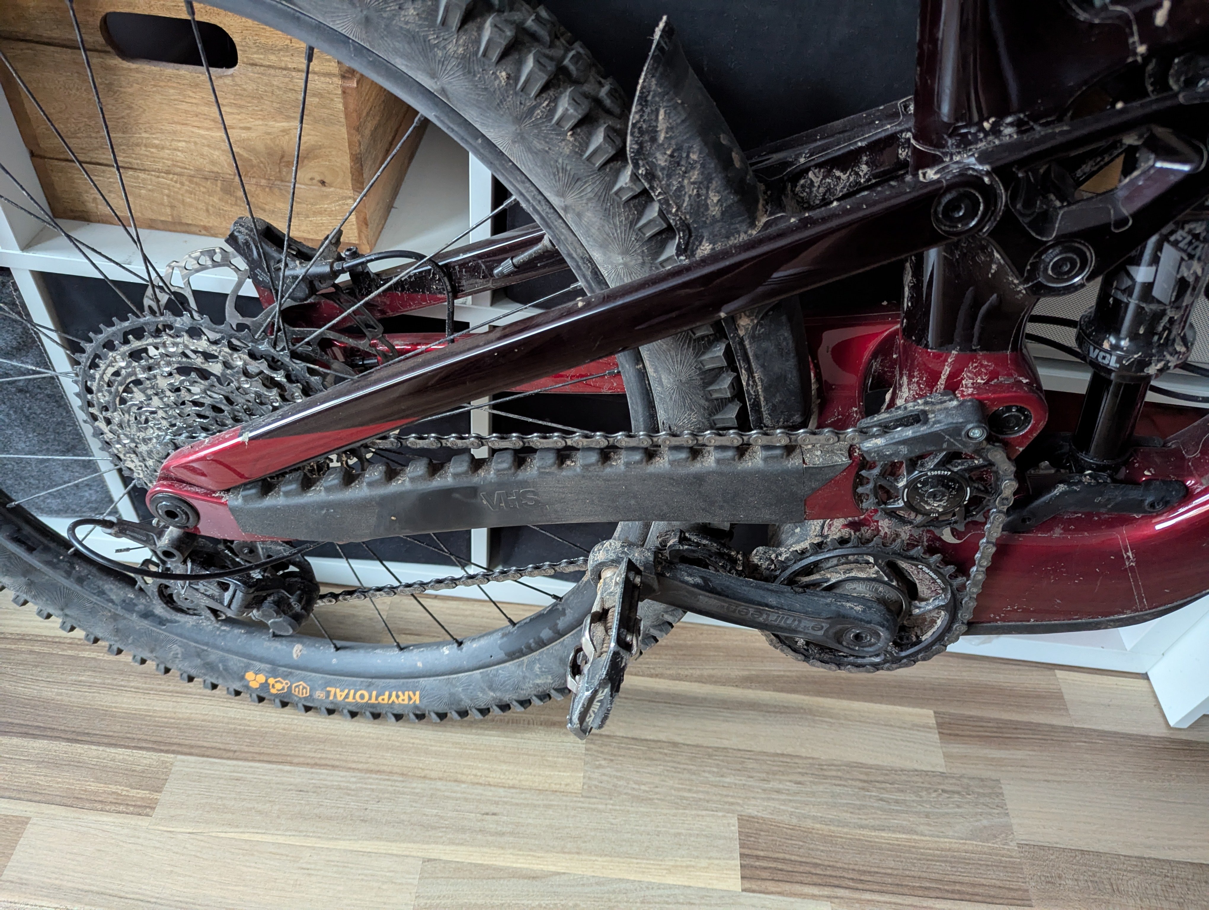

I've recently started riding the Slash+ in the 9.7 version. It's a great bike—exactly the complement to the Fullpower I was looking for. But. This thing makes a hell of a noise on the trail. So here's my question: has anyone else experienced this with the bike? Everywhere I read, people say the bike is supposed to be absolutely quiet. Not mine.
It started on the very first ride with a crazy amount of noise. The cause turned out to be the lower screw that holds the battery—it wasn't properly tightened. Either I messed it up myself, or the screw was inserted crookedly at the factory, which damaged the thread and made it unusable. So the screw wasn’t fully tightened, and the battery had play in the downtube. I quickly fixed the issue by buying a new lower cover with a fresh thread. Thought that would solve it. It didn’t.
The bike still makes noise whenever the trail gets rough. Then I noticed the derailleur hanger wasn’t properly tightened. Fixed that too—still no improvement. Now I’ve found that the bike is almost quiet when the chain is on the largest cog in the back. But obviously, you can’t ride trails like that. I’ve now ordered some VHS slapper tape, but I’m not convinced that’s the solution. The noises don’t always sound like chain slap. Sometimes it sounds like something heavy moving inside the frame.
I’ve checked all bolts and screws with a torque wrench—they’re all fine. Anyone have any ideas or maybe experienced the same issue?

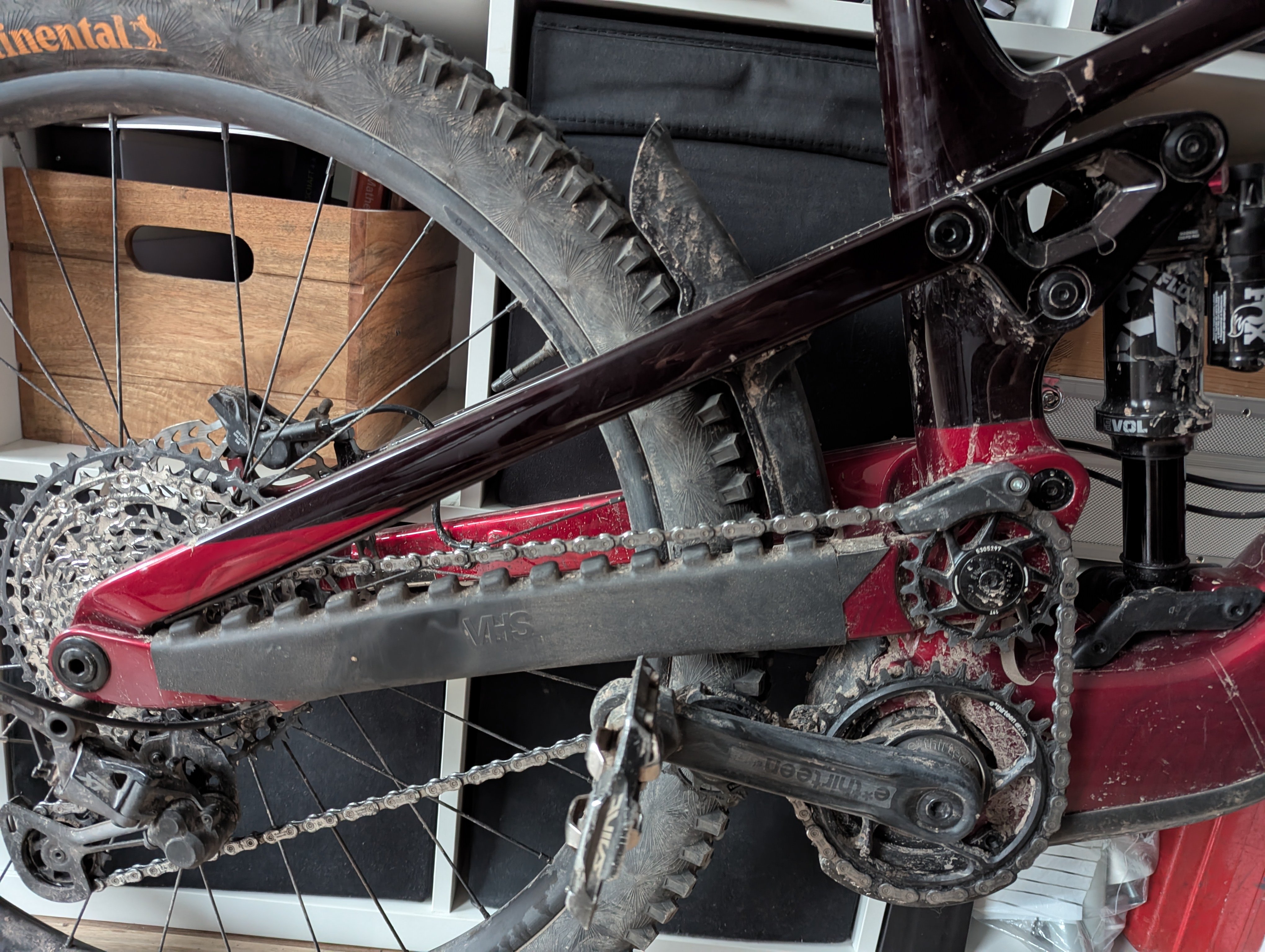

Yep my 9.7 was also crazy noisy on chattery trails.
The main noise was the cables are loose and rattle inside the downtube. They sit loosely inside a tunnel/channel in the downtube. I used foam sleeves to solve that.
I also used an STFU chain guard, which helped some. VHS tape should work fine too.
I did check my battery bolts inside and outside, and the battery bracket bolts seemed a little loose, but probably didn’t cause any noise.
I wrapped and zip-tied the internal cables at the display and the cables between motor and battery.
I still have a loud single clack noise on deep hard compressions that I’m trying to diagnose.
I’ve got my bike very quiet now, but it’s taken a lot more work than any other bike I’ve owned.
Mine's still running silent and has gotten a lot of vert in this summer. Bikes never come silent, I usually rebuild them almost completely 2-3x to get them that way.

  • adjusted the motor compensation bolts, applied anti-sieze to the motor bolts and locktite to the threads on the chainguide assembly. Need a high quality T55 to do this, those bolts are cheese. Also anti-size on the crank/axle interface and locktite on the crank bolts.
  • Locktite on stem bolts, carbon paste on steerer tubes
  • STFU (or VHS) tape does help a lot with this bike
  • I find SRAM transmission to have much less chain slap than other drivetrains. Also learned to make absolutely sure that the axle is loose everytime you're torquing a transmission derailer to 35nm, and this needs to be rechecked periodically.
  • I've had a few brakes where I had to manually re-bend the pad return springs to get them to not rattle
  • Rockshox is definitely quieter than fox
  • The bolts on the top of the downtube, tighten up a plastic cable retainer piece inside. If you have cable rattle I'd start by checking those.
  • I've heard that loud crack at bottom out, only when running air shocks in the linear setting (even regardless of HBO on the Vivid Air). Adding volume spacers seems to have fixed that, and also made the bike more poppy, given the same sag.
  • foam block or zip ties to eliminate cable rattle under the display
The chain slaps the rear midguard too. I added rubber tape to mine.
VHS tape also quietened it down.
All manner of stuff was loose on my bike when new too, id whip round the whole thing with a torque wrench.

The only thing that I would like to check with you as well, is how the upgrade to the 60 works. You've posted here that the motor would not reach full power even if replaced. Is that true ?
As what's interesting Trek listed on their website the same thing regarding the motor for the Fuel+ and the 2026 Slash+ :
correct - when a new hpr60 motor is installed, the motor will not operate until it is "activated" by the dealer service tool software, during the activation process the software asks for the serial number of the bike that it is being fitted to, and then looks up against a database, if that serial number previously had an hpr50 motor, then the software limits the new hpr60 motor to 300w maximum.
you still get 60nm torque which is a noticable increase, along with better efficiency (+15% to 20%) , less likelihood to overheat and reduce power, plus it is slightly quieter than the hpr50.
