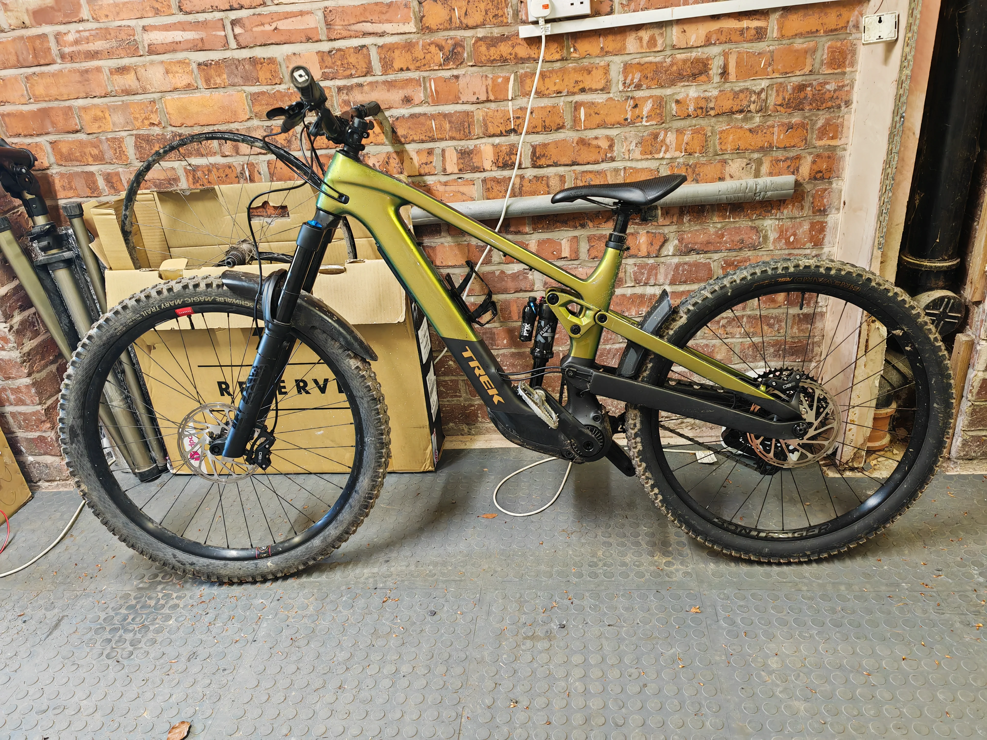

Apologies for the none scenic garage shot.
It now has hope tech 4 v4 brakes fitted
