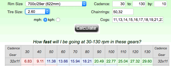

While I can appreciate that the speed box can help to break your 25km/h barrier raising it to a more reasonable 35kmh and as you suggest beyond. However I do have an issue with the beyond part based on the mechanical advantage of the gear ratio's and cadence necessary to go 55km/h with a typical mtb drivetrain which for the sake of argument is generally 32/11 for the highest gear range.
According to this:
in order to sustain 55km/h the cranks would have to be spinning at 130rpm which is hamster wheel territory. This doesn't factor in air resistance that multiplies exponentially at speeds above 35km/h.
Not calling out the OP but ever curious, as to even Speed Pedelecs, how they get to the 45km/h limit and their ability to stay there without the proper gear ratio's to allow for effective human input at the crank's to help it out.
I know this because I have 1000w front hub motor bikes, with no PAS allowing me to pedal in whatever gear I want, legal here in OR where I live as the Class Laws have not been adopted here, that will average 55km/h, not legal, until the battery depletes, which @ 30 wh/mi doesn't take long. I use Schlumpf High Speed drives that have a 2.25/1 overdrive that with my 27t (x 2.25/1)/11t gear ratio is almost twice what a stock eMTB has. At 55km/h the motor is maxed out wattage wise and in the almost 160" gear I am still able to be in sync with it at a comfortable 90rpm cadence.

Focus Jam2 6.8 Nine : Highest gear : 34/10. With 29 inch wheels the bike goes 7.87 meters with one complete rotation.
One rotation/second gives me 60 x 60 x 7.87 meters = 28,33 km/h
two rotations/second ==> +/- 56 km/h.
The transmission efficiency in turbo mode = +/- 340%
rider + bicycle weight = 108 kg
Watts required from rider : 237

Two rotations per second = 120 rpm.
At a cadence of 120 rpm, I think I'd be buying a motorbike. Basically for doing 55km/hr or more, you're really looking at a motorbike. Why not just buy one?
