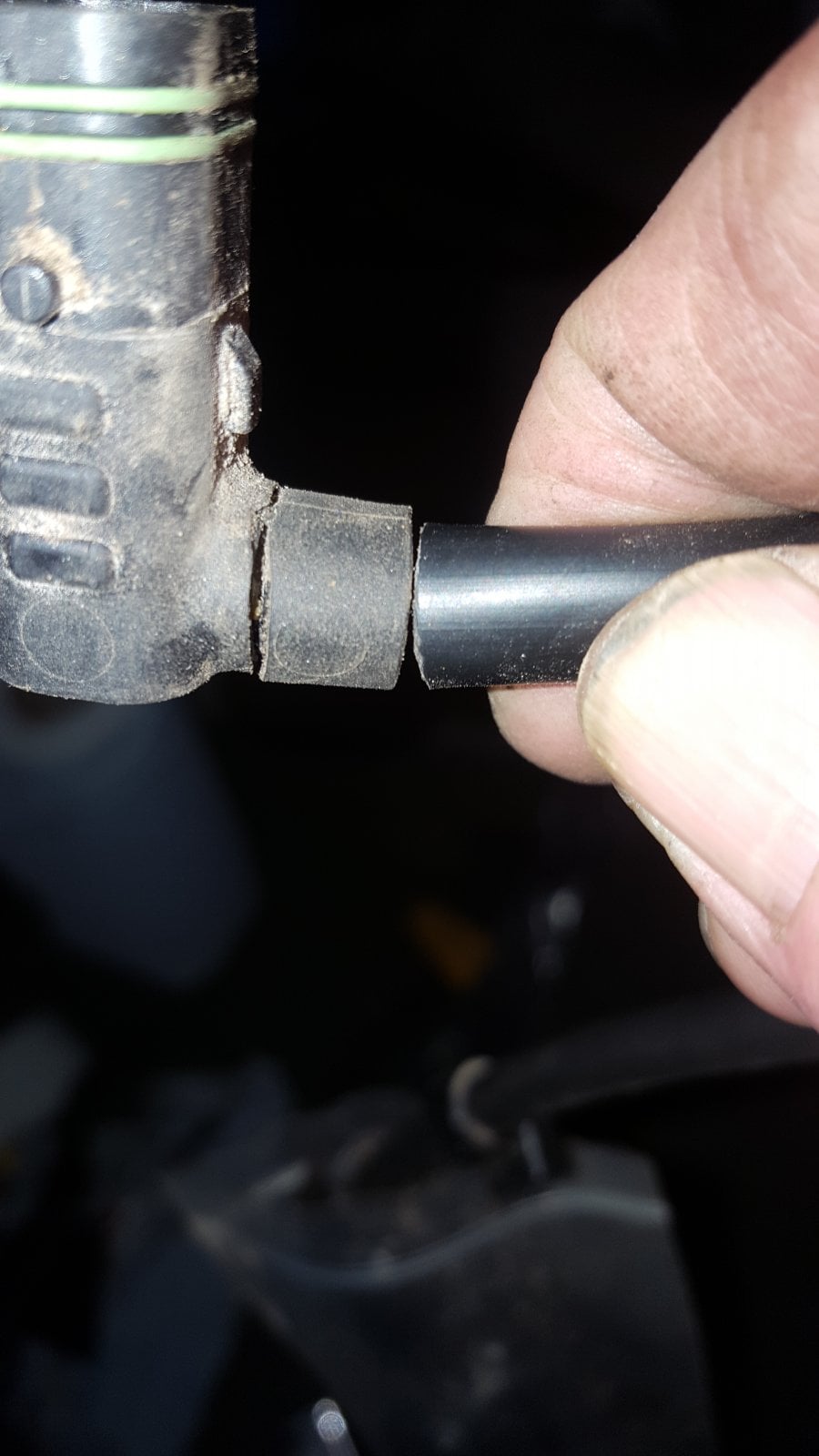

I ordered a new cable despite having no problems. Just as well I did. This is what found when I took the cover off to inspect.
My mate bought his bike a month later than me in may2019. He also has had no problems and the bikes have done almost the same rides and mileage. I suggested he check his cable. His had just started to crack. Neither of us has had problems probably because we do not use a hose to wash the bikes. We do ride in very wet and muddy condition though. So even with a cracked cable wet rides seem not to cause a problem....washing probably will. We clean our bikes by allowing them to mostly dry off and then use a brush...finally a damp cloth. We also both store our bikes indoors.

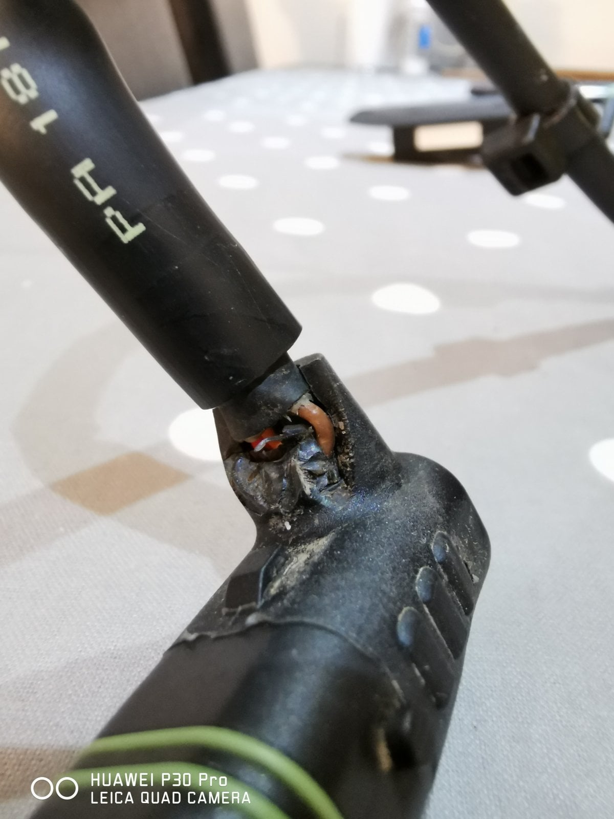

Well after 5 months trouble free riding my bike turned off 25k from home !! and once home I found this ... not happy at all !
When I found my motor cable cap had split ( it had not got to the stage of snapping off) I took a look at what could have caused it. The way in which that version of the cable was installed was for the cable coming from the motor end plug to be pushed immediately into the void to the right of the connection and then brought over the top of that loop of cable to go towards the battery connection. That meant the rubberised "d" part of the motor plug was under some pressure from the cable. The loop of cable in that void, created by redirecting the cable back towards the battery, was unsupported and therefore free to vibrate with the movement of the bike over rough ground. I believe it is that pressure on the cap that caused it to crack. The water seal of the cable is at the point the outer cable sheath enters the "d" section. Any break/crack beyond that would allow water ingress, and/or eventually fracture one of the wires within it. I think even with that version of the cable if the loop was supported perhaps by surrounding it with motofoam, it would not end up breaking the motor connector. The new cable significantly reduces the weight and inflexibility of the loop since the outer sheath is completely removed in that section. In addition the installation of the loop is now reversed such that the cable exiting the motor plug is kept straight and on top of the loop rather than behind it. Furthermore the water seal is now hard up against the main section of the motor plug. Hopefully that resolves the problem.
I have the latest cable version fitted now but since on my original cable the motor plug was at the stage of being cracked but not yet snapped, I have repaired the crack with Aquasure ( a flexible product used for neoprene repairs but with many other uses) and will further modify it by removing a large section of the outer sheath and re wrapping it. It will then serve as a spare for me or others who experience problems.
Cool, good to know. Do we have a conclusive idea of what's happening to the cable? This picture makes it seem like the cable melted?
No its not melted its just the rubber has deteriorated and crumbled mate
