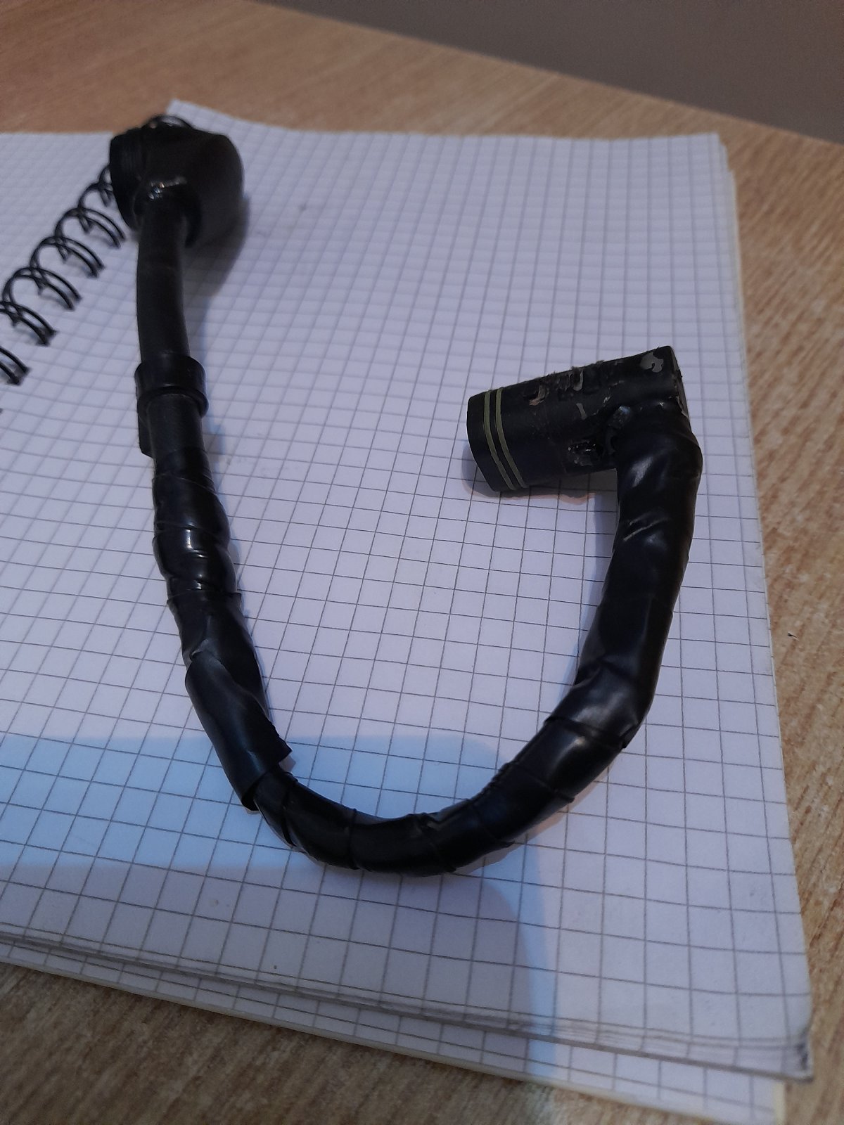

FWIW, my V2 cable split as Mikerb states, which led to the dead bike syndrome. I cleaned the cable thoroughly, then wrapped it with electrician's tape (not sure about the UK term) wound as tightly as I could make it. No more dead bike after a wash or a stream crossing.

I replaced mine before it had a chance to cause problems. I kept my original cable and stripped off a section of the outer casing to create a more flexible cable. I cover the exposed wires with amalgamating tape plus a protective layer of insulating tape. I then used Aquasure to create good seals between the cable casing and the terminals at each end.

to avoid any confusion the a bove is what I did to repair/improve the V2 cable which I keep as a spare. I have had the V3 cable installed without any additional mods to it for over 18 months and no issues.
