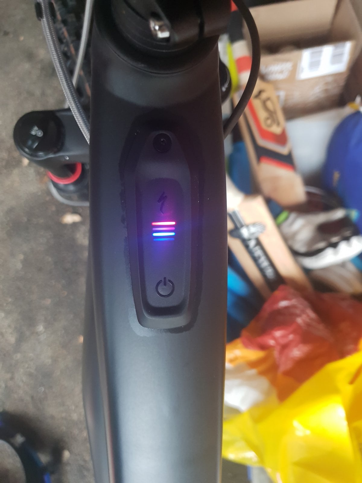

To add to this thread, I had several issues yesterday (after having the new cable fitted) with the attached error light showing on the Control Unit which led to the motor not engaging. I had to remove and re-fit the charge point cap each time to get it to work properly.
Took it out on a 26 mile ride with no problems whatsoever but its yet another niggle with the power that doesn't inspire confidence.
Please post up if anyone has had or is having anything similar to the below. (y)
Please post up if anyone has had or is having anything similar to the below. (y) View attachment 9216
Let’s hope that was a one off!!

So not great feedback on the error light.....I'm being told this is now down to yet another cable that needs to be replaced.....a sensor cable!! and I'm not the first to have this problem (yet again)
Starting to seem ridiculous to be honest and I'm not overly convinced as the problems seems to get a short term fix by slight movements to the power cable when replacing the charge point cap but this is a new cable so who knows.
Chris at Berks Cycles says he has a meeting with Specialized on Wednesday to discuss the problems and get some answers but in the meantime I am faced with a 3rd trip back to get a fix.
