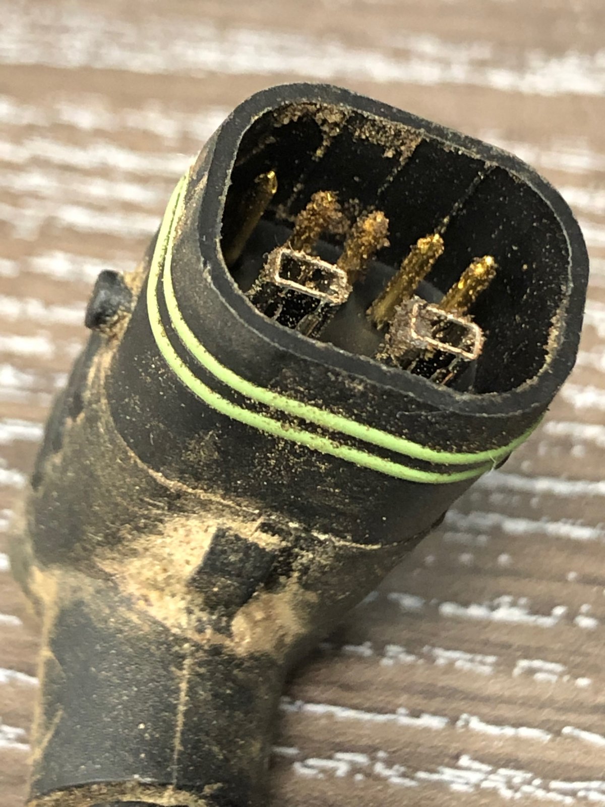

An insight from our initial investigations, the UK team received this power cable yesterday - returned as a warranty failure :censored:. This is an exception, but worth calling out - as you can see there is mud/grit all over the pins - aside from this however there was no fault at all when tested. (They even cut the cable in a number of places to test)
No blame, we don't know the whole story with this return - but we do see these accidental compounding of issues where people unused to electrical components attempt service. What likely happened is that the bike had a genuine issue, the motor connector was removed to inspect without doing some elementary cleaning of the area first. Then the cable was plugged back into the motor but got dirty on the way back into the socket. This now causes even more problems, because mud/grit is now pushed inside the motor socket as well and the original fault becomes much harder to troubleshoot. We all want to avoid these scenarios.
Advice: These bikes will get wet and dirty inside and out, which is no problem. The bike is IP56 rated when all connectors are properly in place, hence the most likely source of any short circuit or water ingress is always the battery charge port with magnetic Rosenberger connector that gets regularly removed to charge the bike. Owners should check and clean this plug and socket regularly with a brush, cloth and compressed air if necessary. When you wash your bike, don't disconnect or remove the battery (& please don't jet-wash) - make sure that the power cable stays fully in place and simply keep this area clean with a brush & cloth. If you absolutely have to remove any cable (really this is something trained retail mechanics should be doing) then before removing any IP rated electrical connections/cables, clean the immediate area using a brush, cloth and compressed air if necessary. Only remove the connectors when you are confident you can remake the connection without introducing mud/grit back in.
Helpful to know: at bike production we use a specific corrosion block on key electrical connections (should not need to be repeated) often using a little vaseline on the outside of the plug around the rubber o-rings (you can see two in the picture). This ensures that the o-rings slide into the socket without rolling out of position. The role of these o-rings is to ensure the IP-rating of the connection, hence any dirt in the socket that you accidentally get in there must be completely removed using compressed air before putting the clean plug back in. If you lose or damage an O-Ring or blanking plug, contact your retailer and don't use the bike until resolved.
