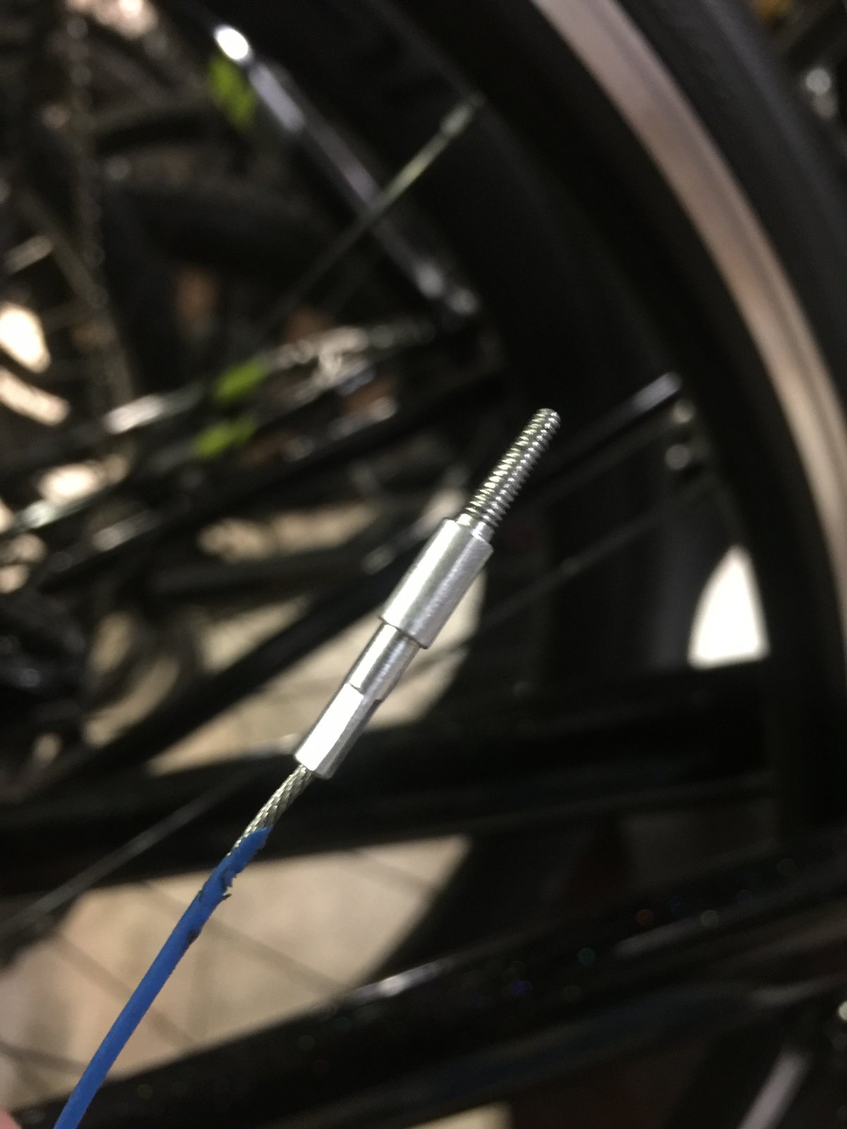

I use the Park Tools internal cable routing kit and pull the hose backwards through the frame. Make sure to loosen the cable clamps in the sidearm next to the shock. Usually I remove the shock to get easier access to the clamp bolts.
Then I just hook the barbed ended cable into the new hose and pull it forward through the frame.
This barbed cable is one of my favorite tools

Cool haven't seen one of those before. Yes forgot to mention about removing the shock. It makes it a lot easier as i was also routing a dropper post cable as well.
