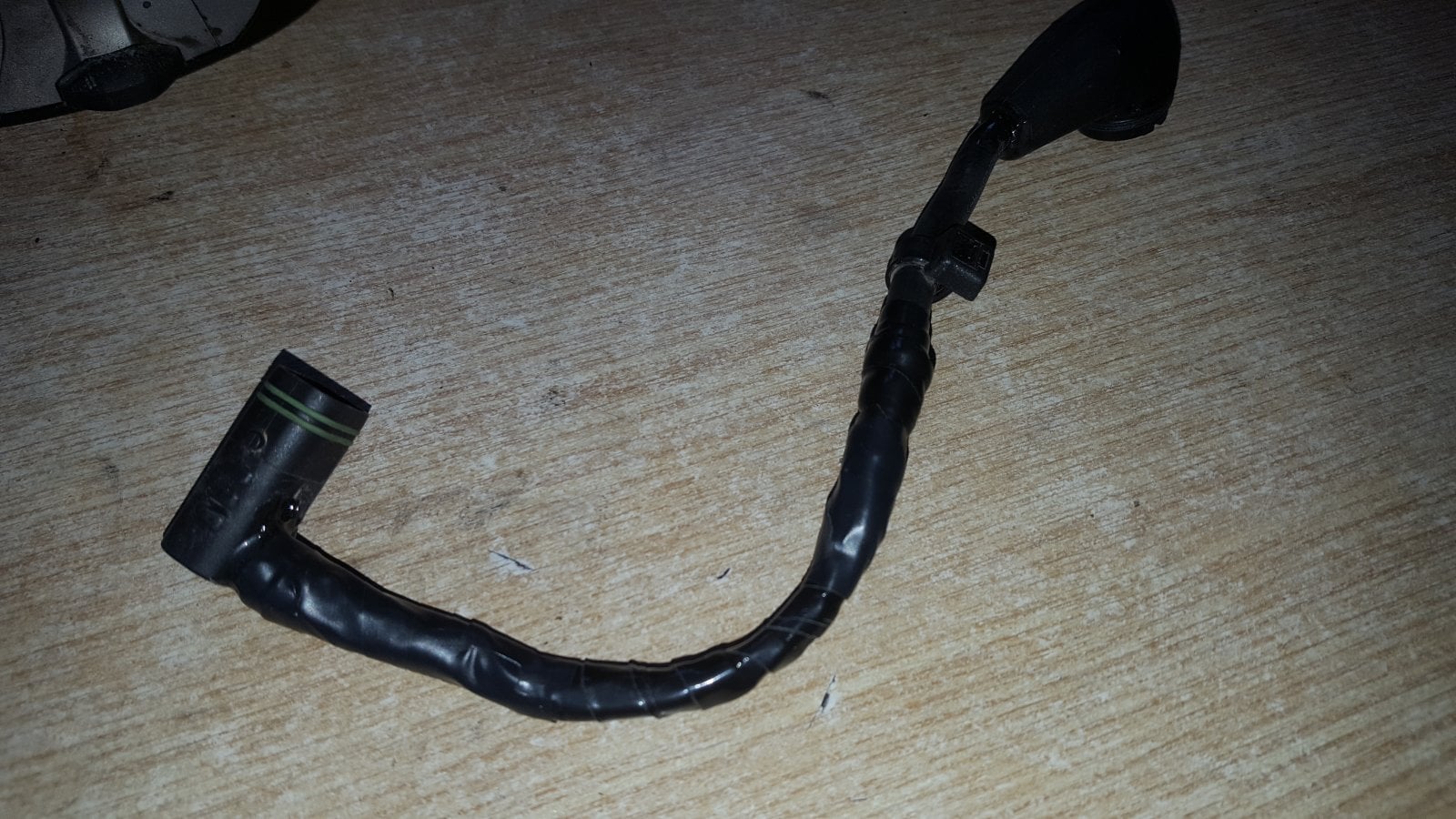

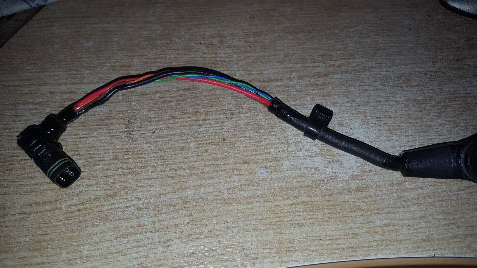

Having replaced my cable with new version....and yes the original had started to crack....I decided to repair and modify the original to act as a spare. I have repaired the crack with Aquasure and stripped off the flexible section of cable cover plus more of the cable outer sheath. I have also used more Aquasure to seal all cable exit and entry points. The pic shows the modified cable at that stage. The bare wires now only need protection from abrasion so that section will be taped with amalgamating tape which will stil leave it flexible.
I plan to do something similar to my original cable to keep as a spare!
Taped....amalgamating tape plus a bit of insulating tape on the ends. Amalgamating tape takes about 24 hours to mould to itself so I will pre shape the cable meanwhile such that the bend when installed it mostly pre formed.

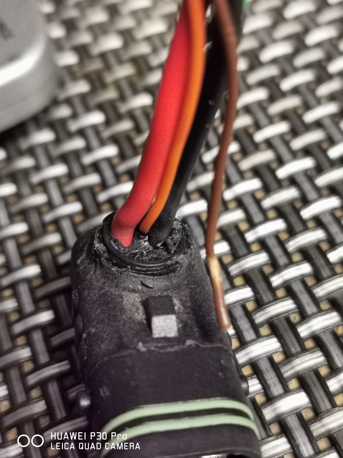

What is the thin brown wire? mines actually become detached when I checked when mine buggered
I have never seen a wiring diagram but my guess is that 2 thicker guage wires are the main high voltage circuit for the motor and the smaller guage wires are the low voltage feed to the pcb.

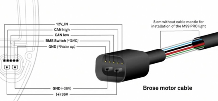

The brown is not shown on the diagram but you could do a continuity check and find out easy enough. This diagram is for the early level plug but it’s more than likely the pin designations are the same
I doubt you can do a continuity check. Those connections will terminate on the mtor pcb and could be switched on transistors before connecting on to the plug from the Tcu. Just solder it up and wrap until you can get a replacement cable.
Thats the problem tho Mike, it has become detached but there will no way it can be re-attached without cutting right back at the base then it'll be to weak.
This lead it now a spare as I was sent a warranty replacement but I'd still like to get it serviceable
