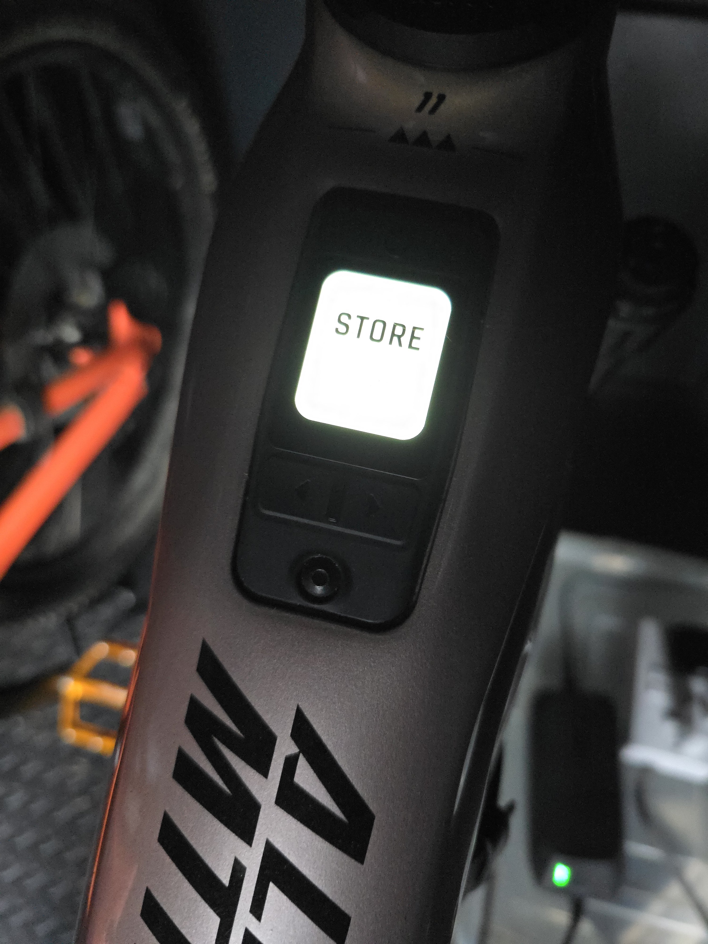

So asked the bike shop what the difference is between store and normal and..... Thanks to Rich at ebikesussex.com
Menu–Charge
The charge indicator appears as soon as the charger is connected to the e-bike. Use the plus/minus button to select
the charging mode (NORM, FAST, STORE) and save it by pressing the rocker switch. The Long Life mode can be
switched on or off with the light button.
Charging mode Description
NORM(Normal)
Normal charging
FAST (Fast)
Fast charging
STORE(Storage)
Storage mode
If the battery is not going to be used for an extended period of time, we recommend
storage mode «Storage» and an optimum storage temperature between 5 and 15°C.
In Storagemode,the battery is charged to about 60% which allows the battery to bridge
the time until it is reused as gently as possible.
Long Life
Slightly less capacity is available if the battery is used in LONG LIFE mode. Ontheother
hand, the battery retains its capacity for longer. The LONG LIFE mode is available for
both normal and fast charging. In LONG LIFE mode, the battery is charged to about
80%
