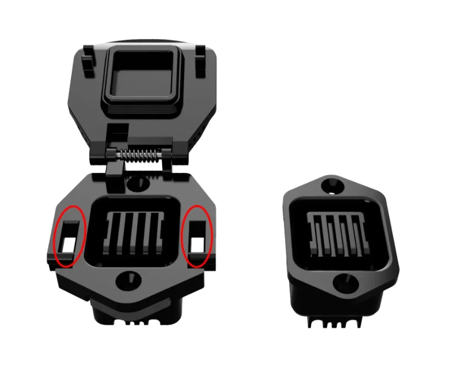

Its on the Fit website, to fit pinion MGUs
Fit Bat buddypack. 240W 48v. Product code 501631 459 euros
Available May 2026 ( not April, my mistake )

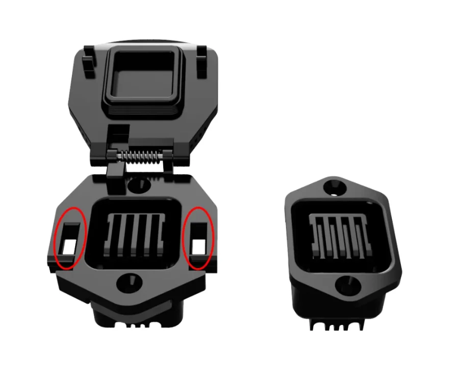

Oh dash.... doesnt fit the haibike as don't have the square hole either side of the charging port.
From the web site.....
Note: You can tell if the Buddypack has compatibility with any e-bike model by looking at the indentations on the charging port (see picture 2).
Compatible socket seems to be available. 501772 or 550080. You would have to check if compatible with your frame

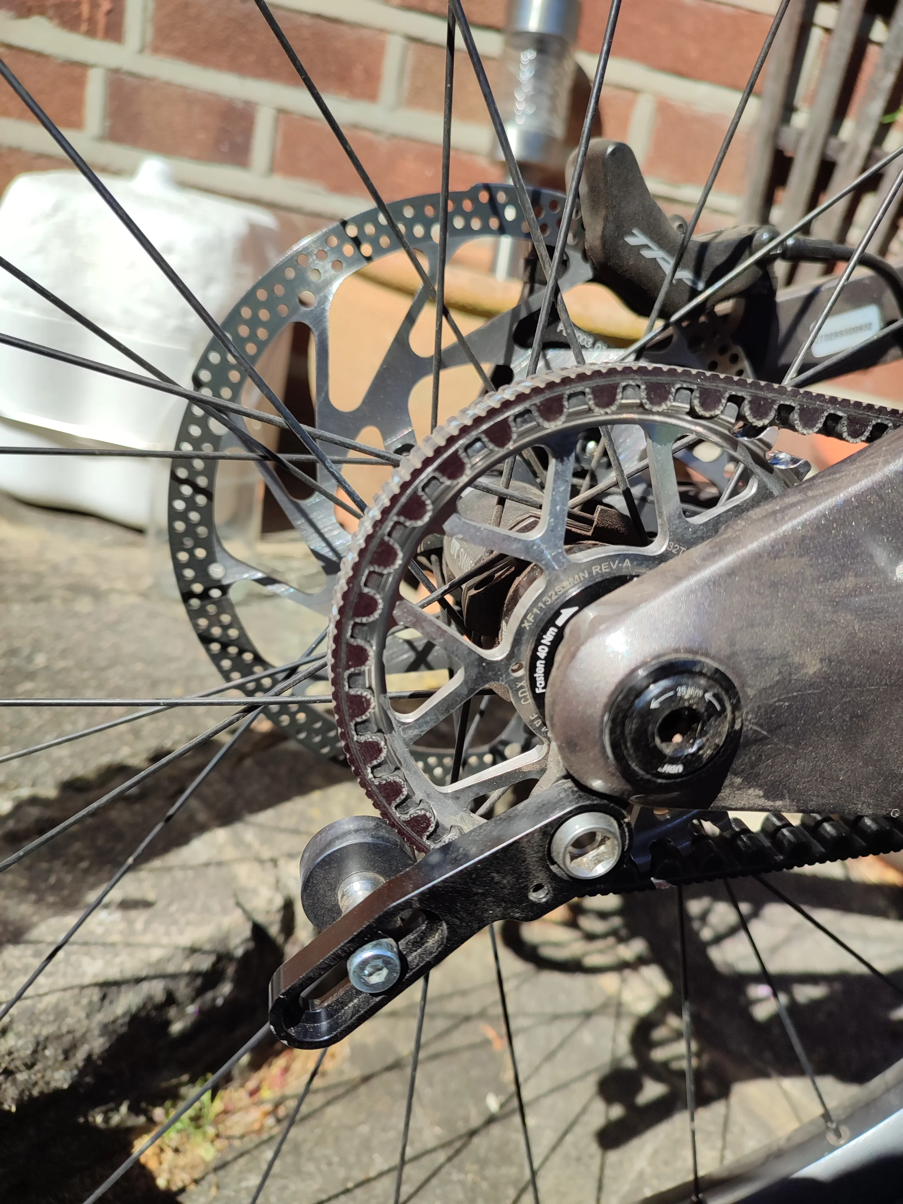

A bit of advice required in relation to the small wheel that sits below the carbon belt at the back. Somebody on todays ride noticed that it was not touching the belt and response from FB group was that there should be a 2mm gap between the wheel and the belt i.e. not touching the belt. Also it was suggested that the position of the wheel support arm should be straighter pointing down rather than the backward angle as shown in mine. I cannot find any useful official information so just looking for a consensus of opinion.

Yes, the snubber wheel should sit 2mm off the belt. It should not touch the belt as that will wear the belt and snap.
It should also be around 6 o'clock position. There is a pin on the arm that looks and feels it should sit to the left of 6 o’clock but actually it’s the opposite and sits to the right - hope that makes sense.
Shout with any queries.

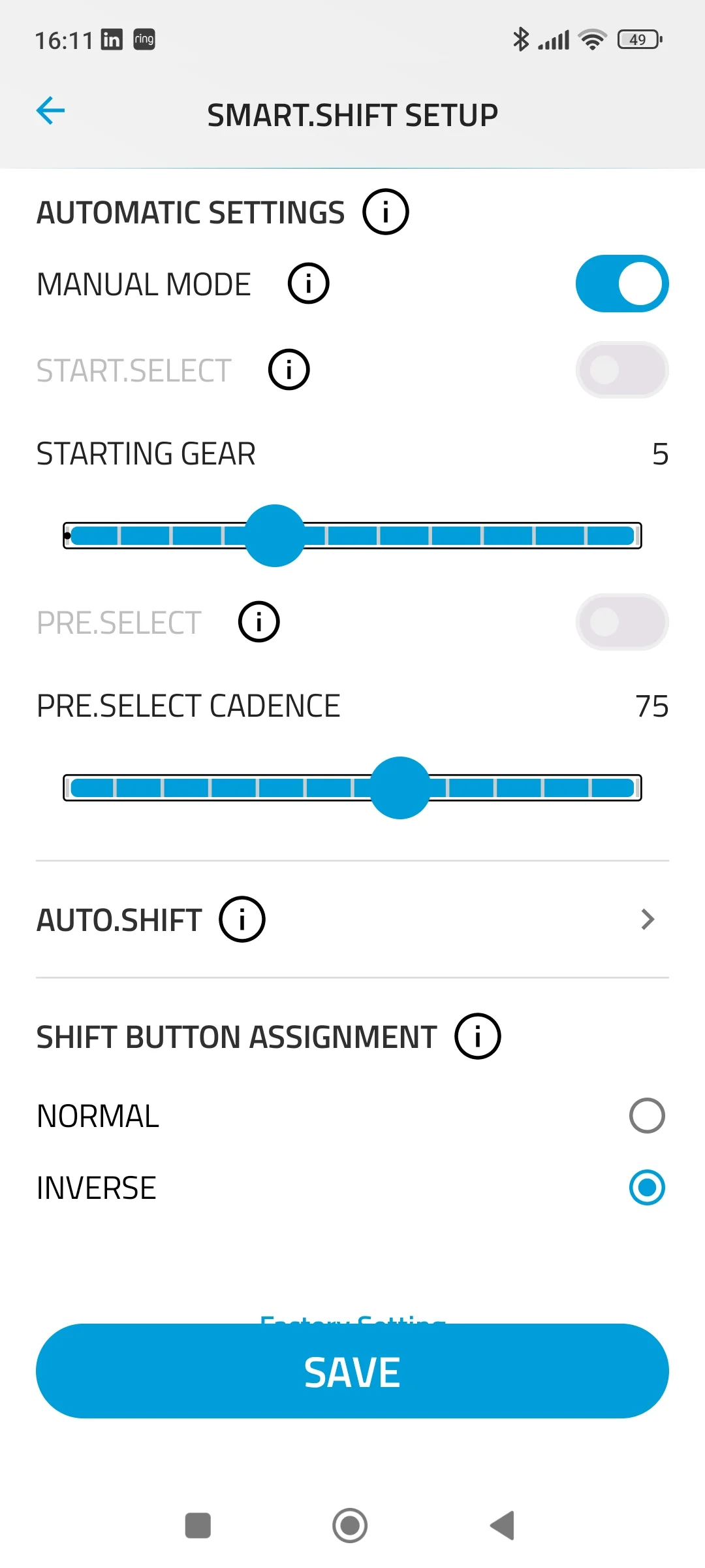

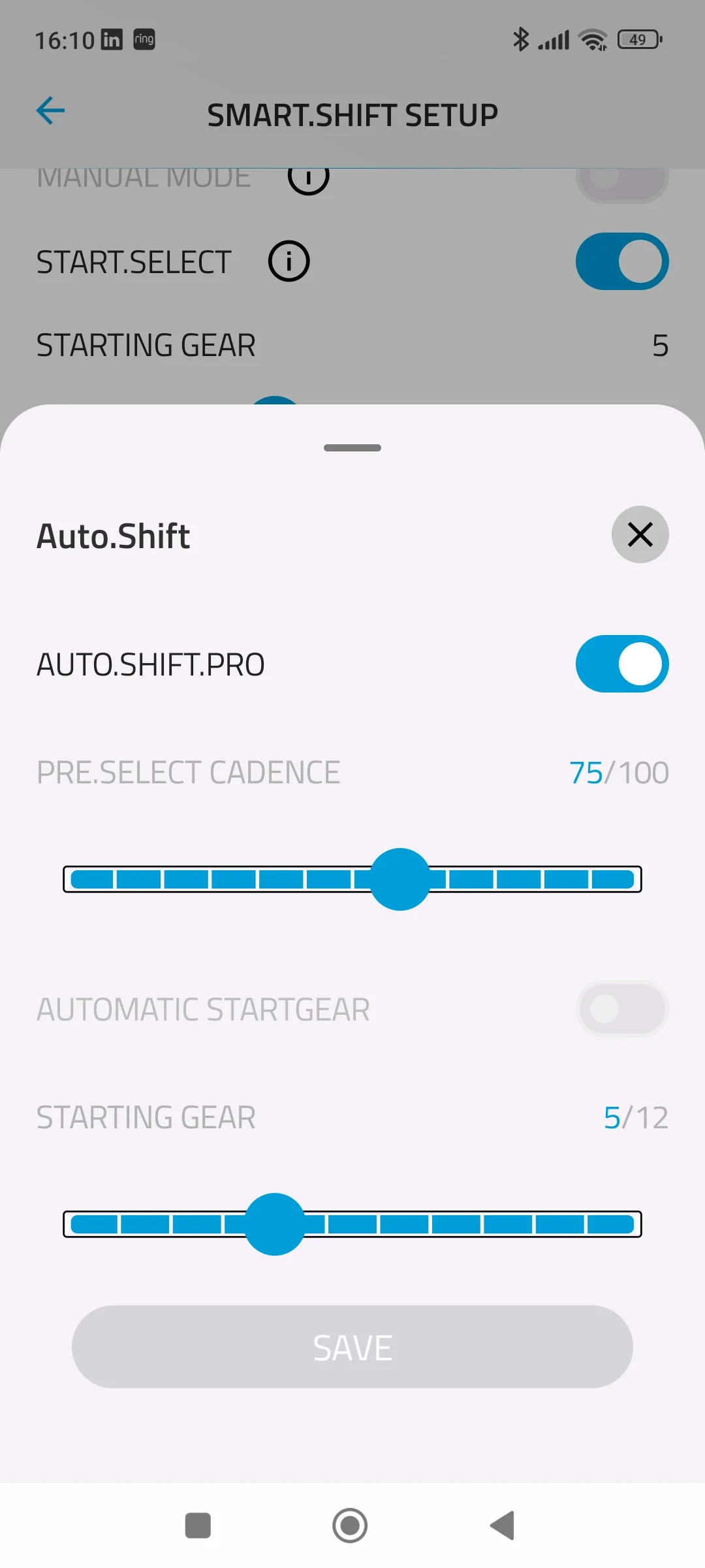

Navigated my way through MGU settings to try out the automatic gear change function but cannot get the damn thing to work even though I appear to have pressed all the right buttons. I have shown how it looks in manual and once I selected automatic but it has no effect when I ride the bike.
I did find a useful tip from Gemini on how to Force-Activate the Auto Mode by switching the bike on, press and hold the front lever of the right hand gear triggers for exactly 2 seconds which results in A+ appearing on the integrated Master Node Display on the bike. Not tested this yet but will later in the week.
Any suggestions why I cannot get the control app to actually control my bike?
Personally I don't use the feature but yeah just hold the gear change lever down to turn it on and off.

I've always set the auto up in the app (I don't use but did have a play!!) and then press and hold lever and activates. It is pretty cool when riding road but useless on a climb, after all, it cant see in to the future!!

I'm pretty sure the 80% thing is having the app open when the big is charging and pressing the left or right buttons on the bike screen. That changes the charge mode but also upsets the app.

Don't intend using automatic when out riding the trails but am interested to see how it operates. This bloody app is just so un-user friendly in my eyes.
