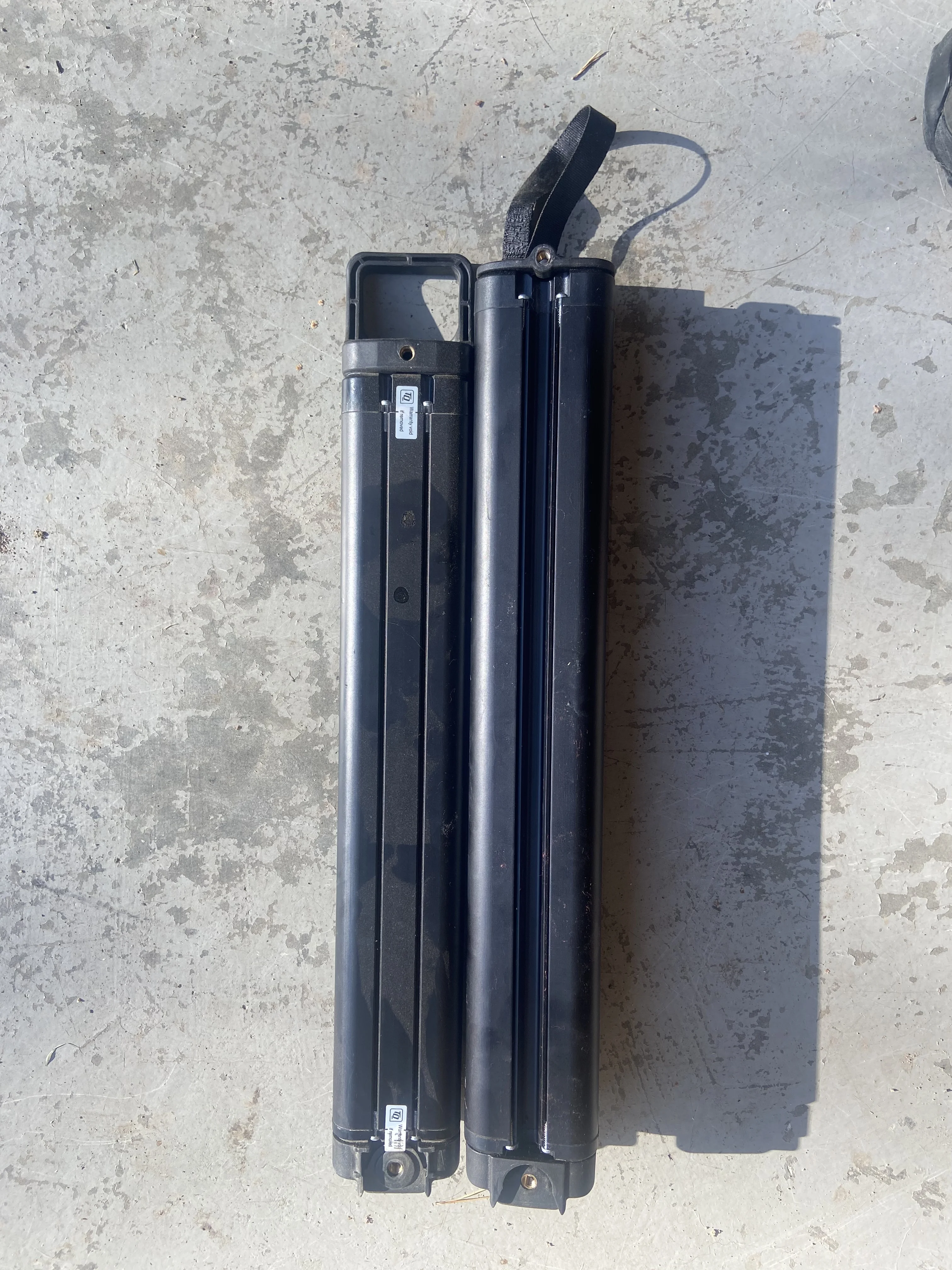

Must be some amazing trek engineering as the 360 is rectangle and from what I have seen the 580 looks like it has 5 sides with a distinct triangle profile on one side?

look at the fuel+/serviceMANUAL p22/28 you have the description of the adapateurs yo have to order with the tq 360W battery

Old picture, 360wh (L), 580wh (R), doesn’t show the profiles but you can see the length/widths.

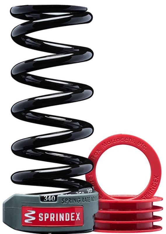

Try one of these too, gives some adjustment on spring rate…
Essayez aussi l'un de ces modèles, il permet de régler le raideur du ressort…
Oui, je connais Sprindex, je l'ai installé sur mes 3 derniers vélos. I ve order second hand springs ( 350 and 400) before ordering the sprindex one
