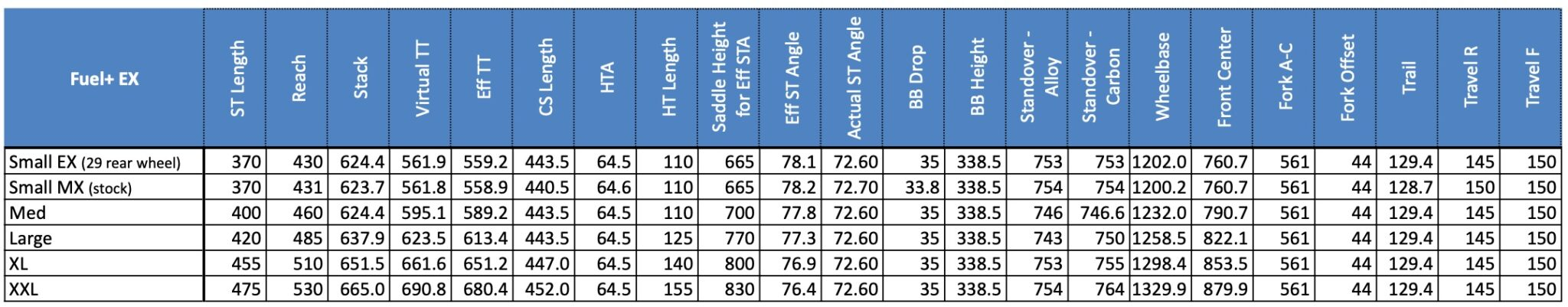

One question I have, and maybe my reading comprehension is lacking, but is the small EX capable of, and supported in, running 29 rear with a linkage (and wheel, duh) change?
Secondly, I'm wondering why a 38/160 Fox factory fork isn't in the customization offerings in the US? They do offer 38/170 for the MX, but no 38 for the EX at all, and where 170 might be leggy.
I can understand your confusion about the rear wheel size for a small EX. It's not clear in the specs. It looks like the LX version can take the 29er in all sizes, and it obviously shares the same frame as the EX, but the LX linkage allows longer travel so maybe there's more room for a bigger wheel for a size S in that version? I think you'd have to ask a dealer to be sure. Regarding the 38 fork, I think the lower travel EX is intended to be lighter and more trail-oriented, so the 38 would be considered too heavy and overkill for that.

Why does my size Small EX have an MX rocker link?​
Size Small Fuel EX and Fuel+ EX models will come with a 29” front wheel, 27.5” rear wheel, 205x60 shock, and 150mm of travel front and rear. The difference between size S EX and size S MX is that MX bikes will come with 160mm forks and are only available as complete bikes in the 9.8, or 9.9 models.
Our rider research has shown that most size S riders prefer a 27.5” rear wheel for a more proportional fit, and more back-wheel-to-body clearance on jumps and descents. Since most common bike-in-a-box (non-P1) Fuel and Fuel+ models will be sold as Fuel EX, we chose to build the size S with the MX rocker link and LSM so that these riders will get the most-commonly preferred setup right out of the box, without having to buy the parts to make the swap to MX themselves.
Size S riders who prefer 29” front and rear wheels can swap the rocker link and LSM and their rear wheel for a full 29er Fuel EX or Fuel+ EX. Or they can also get a size S Fuel LX or Fuel+ LX with 29” wheels right out of the box through the Project One program.
Any size frame can be built in any of the three configurations

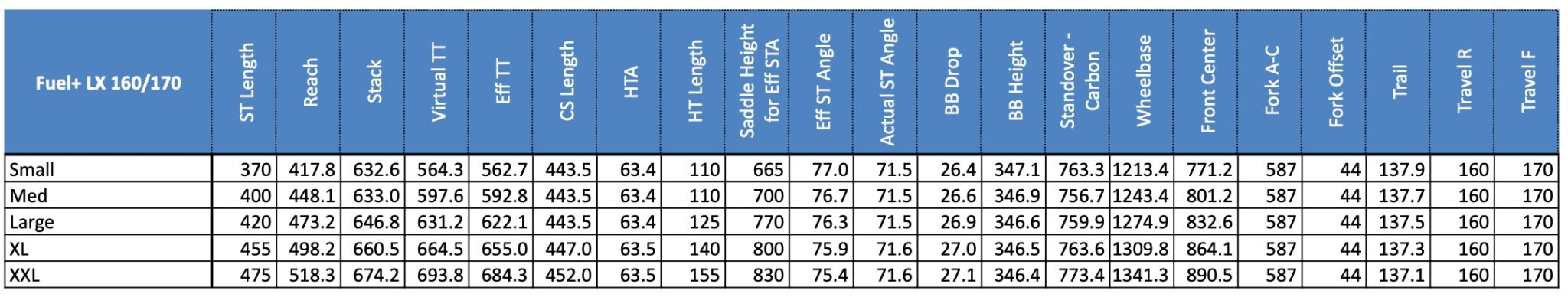

I'm considering this bike in the LX set up. What size do you ride ? And how tall are you? I'm inbetween a L, XL with 187 CM tall and 89 cm inseam. The reach for the Large is 473 CM and my current bike has 480 CM reach. Does the high stack influence the shorter reach ?
I ride mostly natural, twisty enduro trails. I'm also going tot go with the X2 airshock.
I'm 183cm and having test-ridden an L it's the right size for me, but I'd be thinking about a +5mm reach adjust headset as an possible option were I to go for a Fuel+ in the LX setup so that's something you might want to consider.
I wish their configuration 'menu' gave some indication how reach was affected in each variant, but it's a good starting point to see what you can do with the combination of links, rocker and wheel size to get different travel numbers, but crucially the progression rates.

Is this what you're looking for?

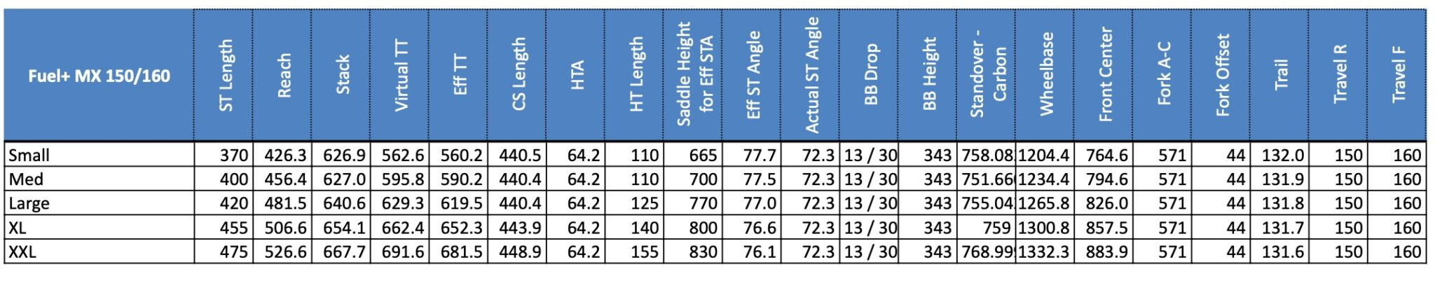

No, I want the details from the file I linked above (also here) to include the reach numbers as well.
There must be easily 10 if not 15 variants of head angle in that table, all of which will have some effect on reach, be that subtle or not. I'd just like to know what all the numbers are.
Likely won't stop me buying one as it ticks all my boxes, but I like to know stuff!
