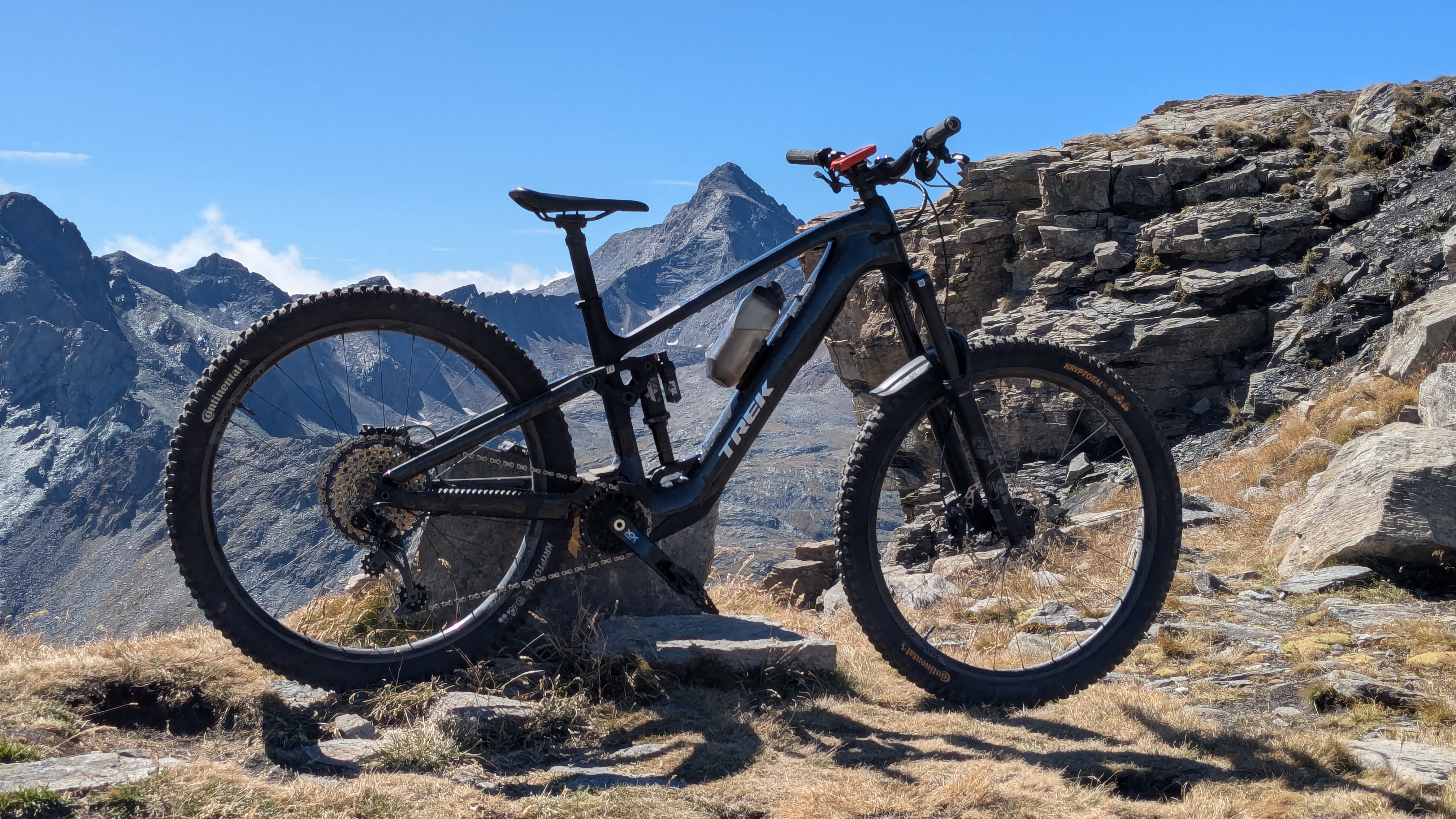

Riding the customized Fuel+ 9.7 now for 400km and 12k meter down.
The EX with 150mm front from a Fox38 Perf. Elite is highly capable while still being playful and agile. Morge than happy with it
Stock weight was 20,2kilo in size large but wheels came without tubes or milk.
I could trigger instant-buy any bike of that kind ... with at leat a Maxon air S and 600 Wh battery. LT option, ofc.
BTW, this bike looks damn good !

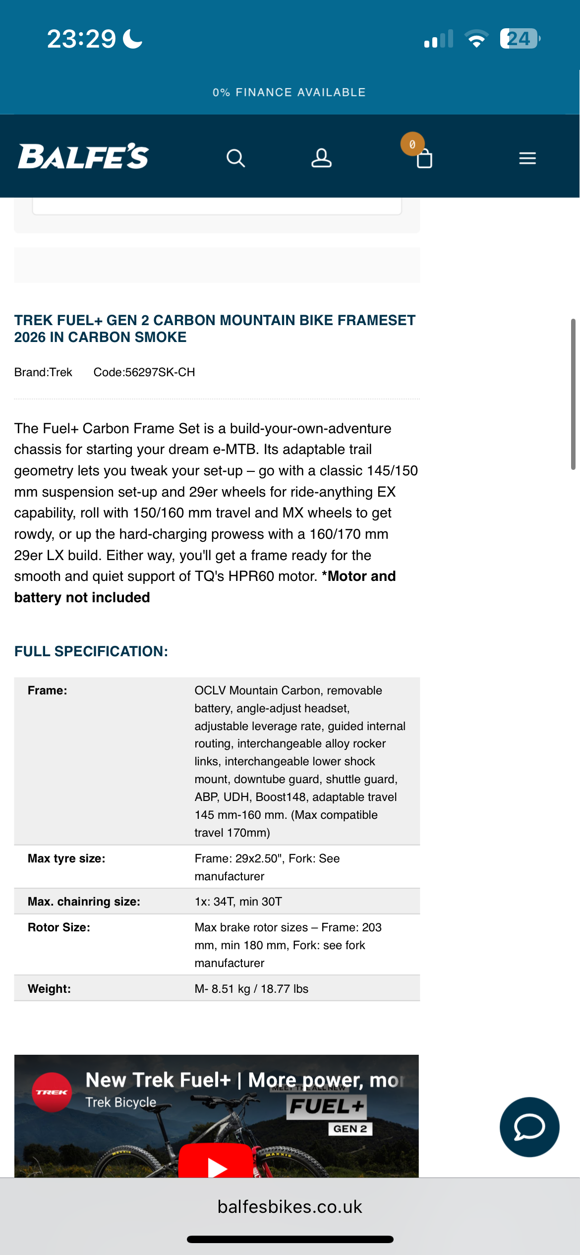

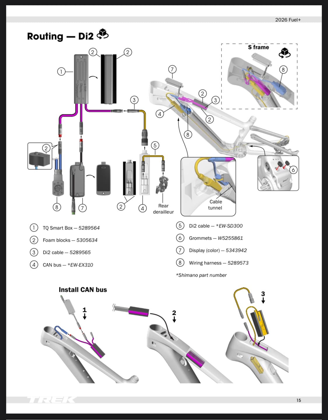

Does anyone know if the Di2 shifter/derailer option will be integrated with the bike battery or a separate?

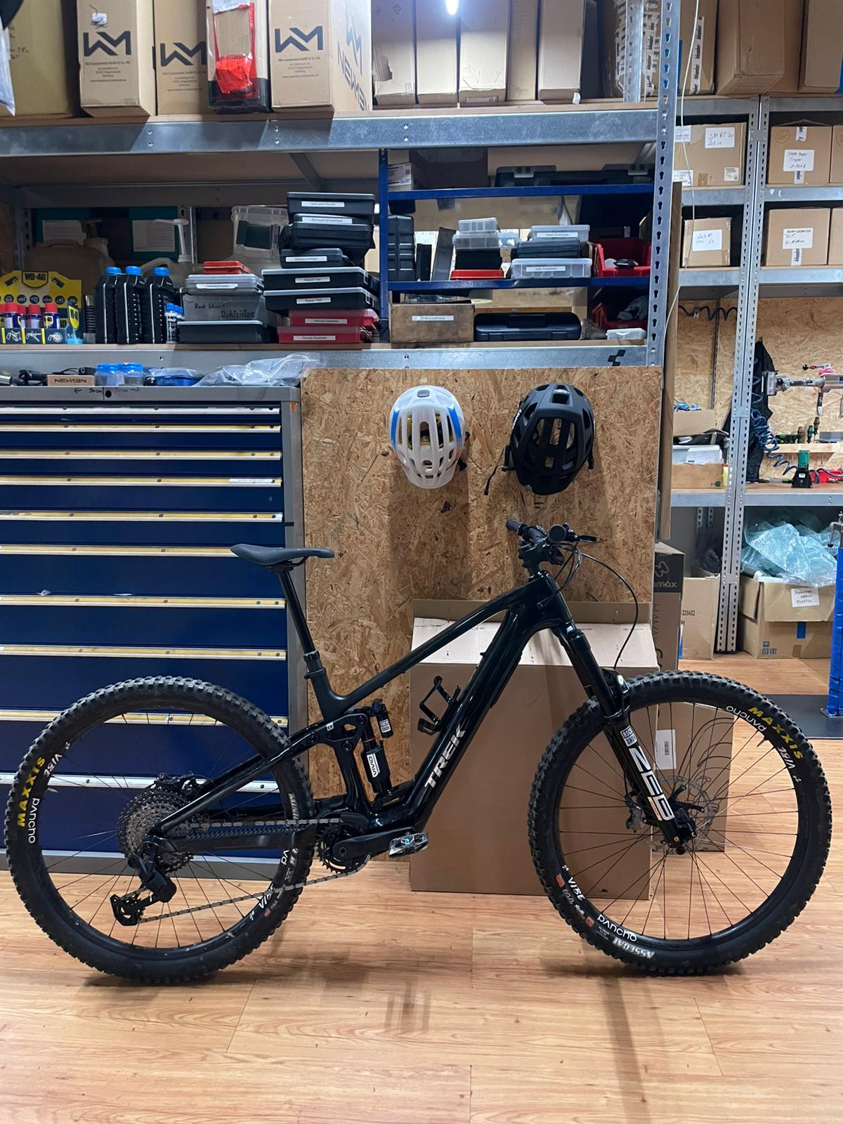

did anyone try the fuel+ ex with a 205/65 shock and 160mm fork?
i ordered a 9.7 ex and got a 160mm zeb for cheap. will try an 205/65 vivid to match the fork.
for me it looks like the ideal setup for my riding (rooty singletrails at home, some bikepark visits each season)
Being able to easily change shock stroke is one of the appealing features of the Float X and the reason I purchased the 9.7 model.
It’s also easy to upgrade that stock shock from Performance Series to Performance Elite spec by just adding the adjustable LSC assembly kit.
I had a 36 Factory eMTB 160mm fork on hand so I was happy to stay with FOX for my build.
