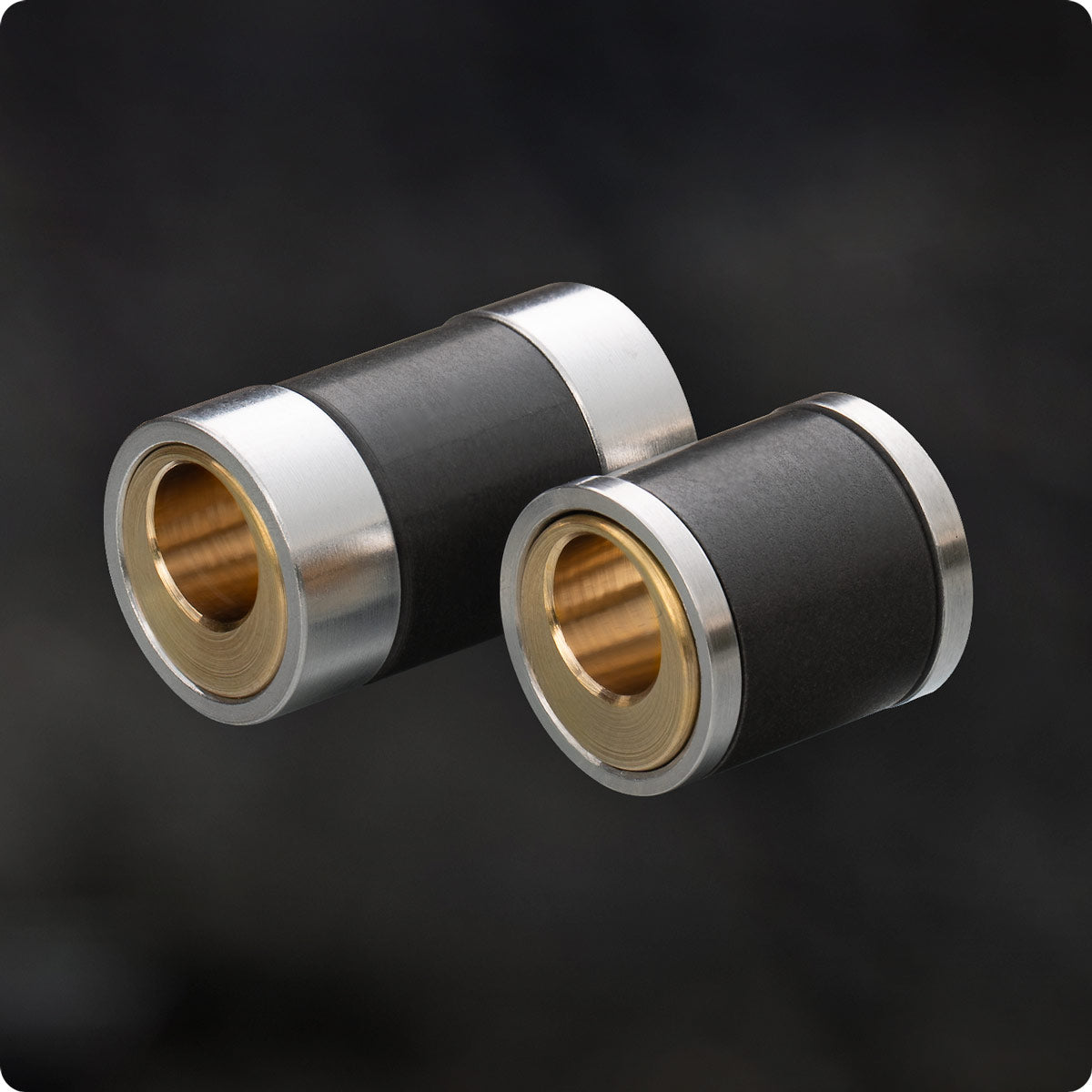

I'm looking into trying an EXT Storia on a conversion to a 160/160 mullet on my medium Rise. I think I need the 216/63.5 mm (8.5x2.5) EXT and plan to use these offset bushings:
Anyone hear of anybody having problems with EXT on the Rise?

I have tried various coil shocks on my medium rise and the wife’s (H30 and a M20) and the only ones that worked were those that could take a fox sls spring as it’s a few mm smaller in diameter. I have used a DHX rc4 shortened to 210x58 and also a DHX Rc4 at 216x63 with 2x 2mm offset bushes (both pointing away to give 212x63) and also a cane creek db inline (upside down to keep the shaft as supported as possible)

I've actually ran single offset bushings on several bikes w/ bushing reversed to lengthen/steepen bike. None of them rotated into slackened position after years of use. I recently did this on my Rise at the lower shock mount when I went back to the stock shock but kept my front end over forked. This kept the geo similar to the bike w/ 216x63 installed. Just checked and bushing is still in the same orientation after 500+ miles.

I'd like to increase the rear travel to 150mm and rise the back to steepen the angle by 0.5°. Do I understand correctly that I need to get a cascade link (to increase the travel) and put a reverse offset bushing (to rise the back)?
