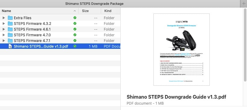

Oh... but there are step-by-step instructions for iOS/Android: :p

Ok, I've just had another look about and checked all the PDF's from emax and shimano and downloaded the Zips.
I can't find what you have anywhere ??
ssdg-jpg.24373
Nothing with a complete filesystem with all the firmwares and a pdf downgrade guide ??
