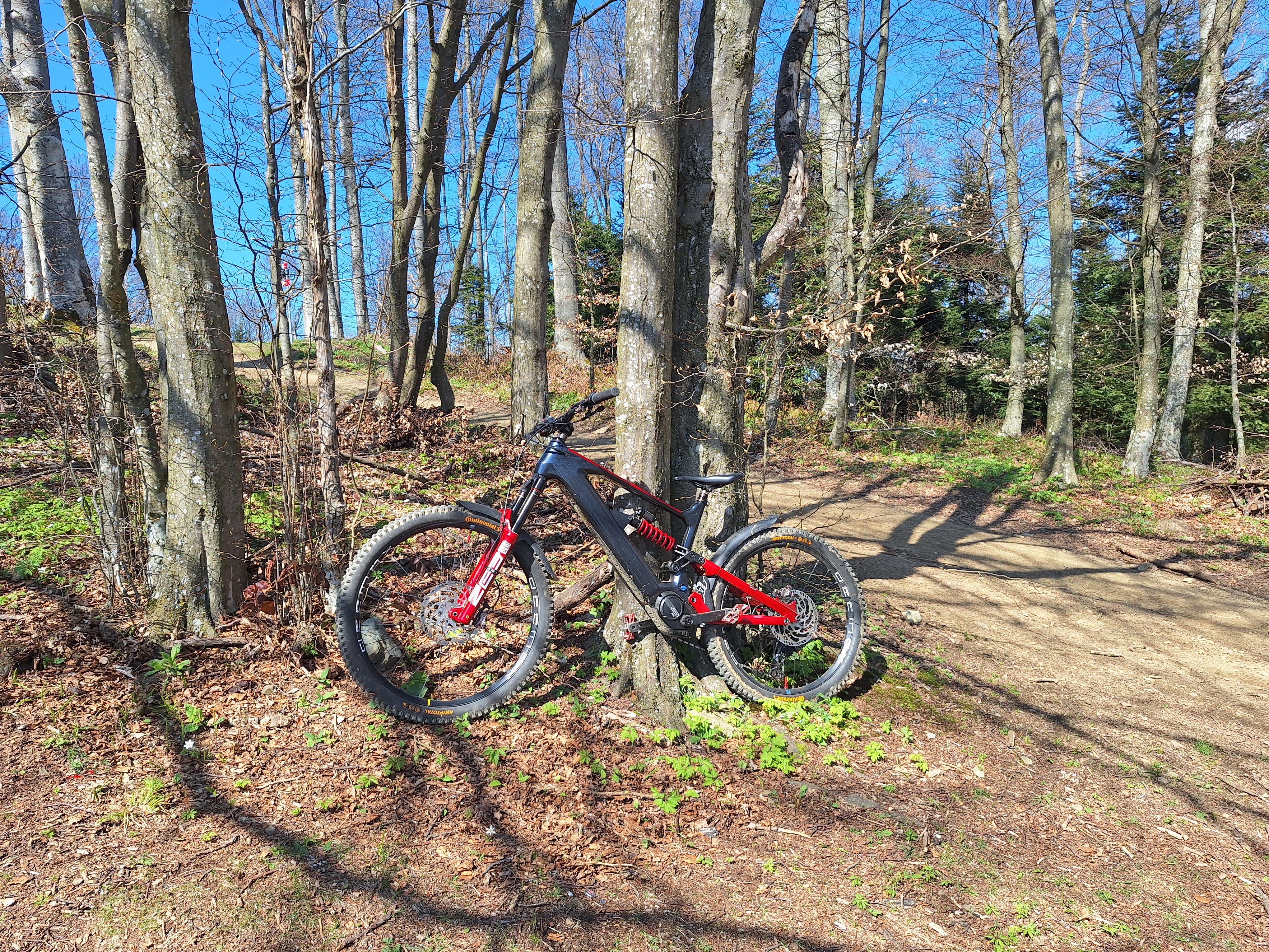

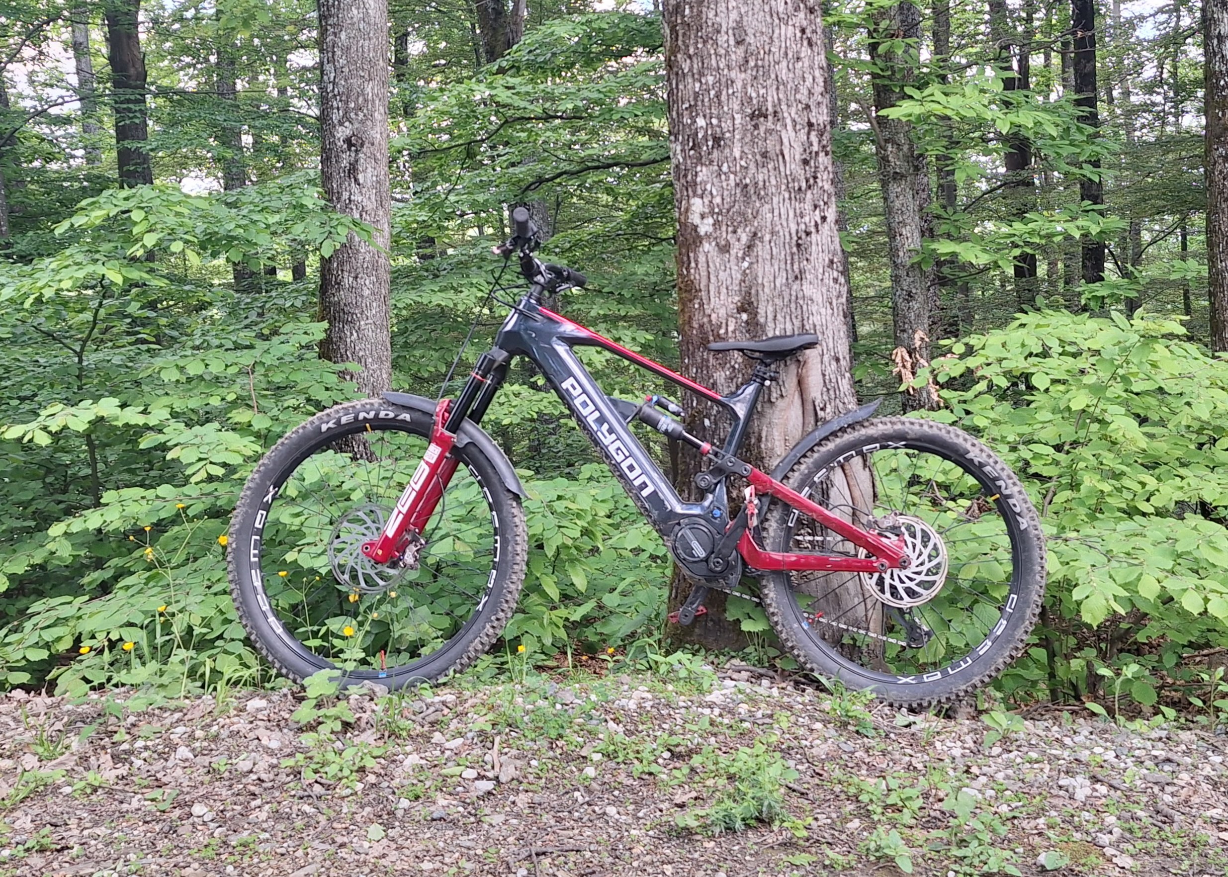

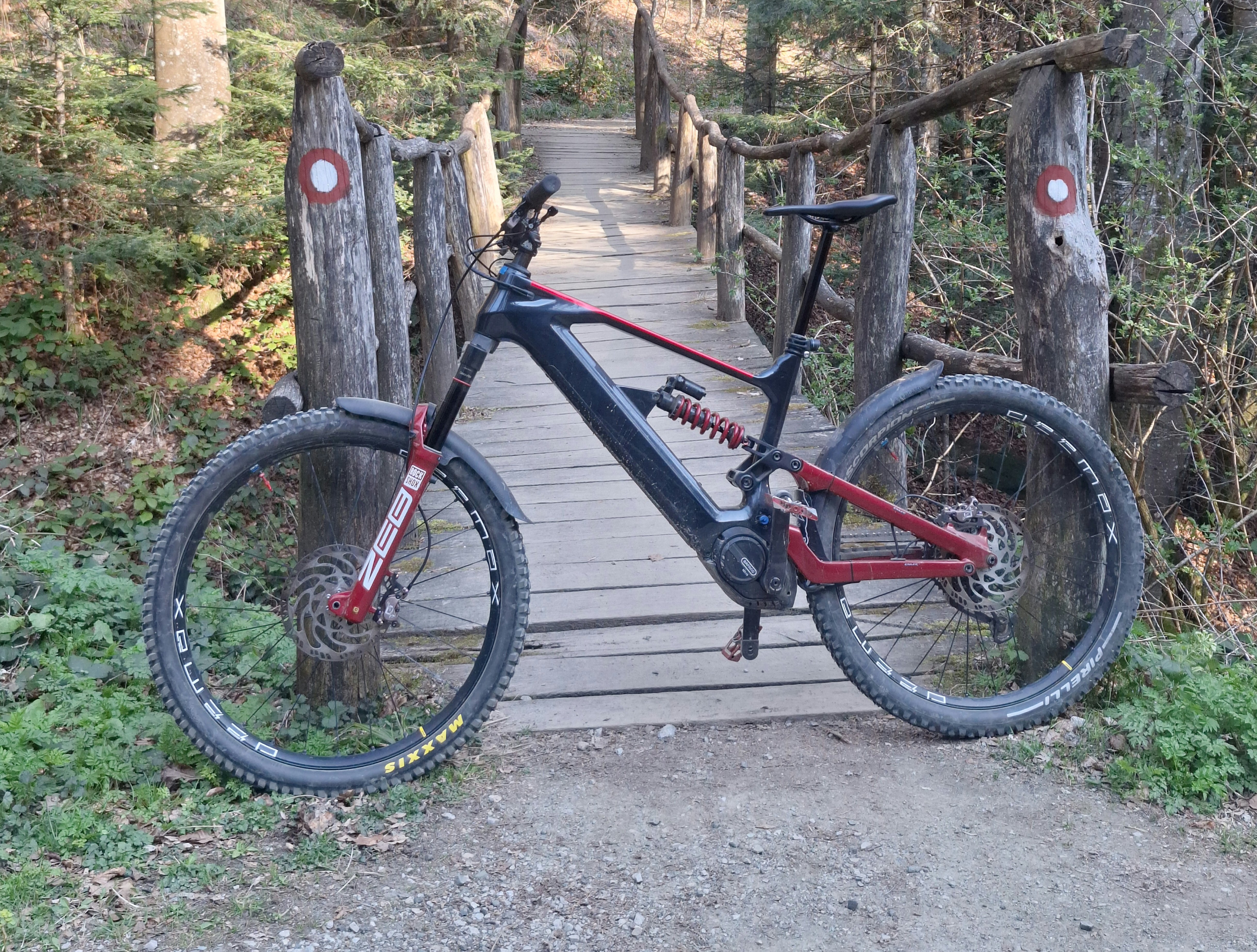

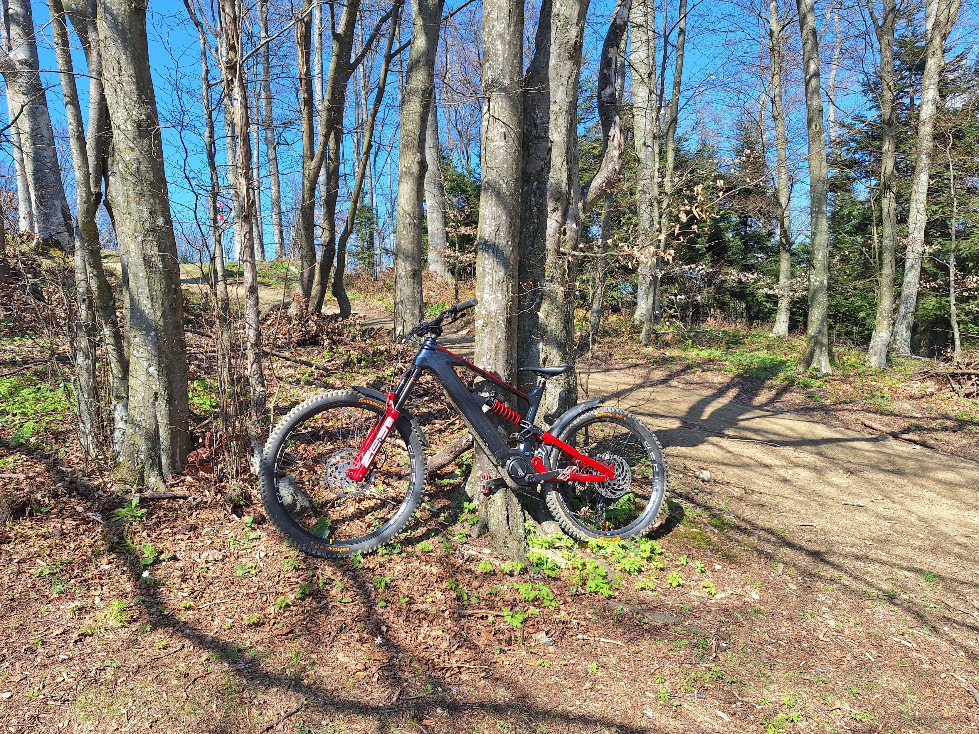

I gave in again and did a diy project. there is no greater joy than assembling my own ebike.
although it is not financially profitable but it is a cure for a crazy head😂😂😂.
here is a picture, components visible 11s 3p battery, 36v M510 motor. currently trying out the K1BBR combo and different firmware.
has anyone tried the 36v fw? which is the best?
yesterday I was on a test ride on an uphill I managed to see 780-790W on the screen in B mode.

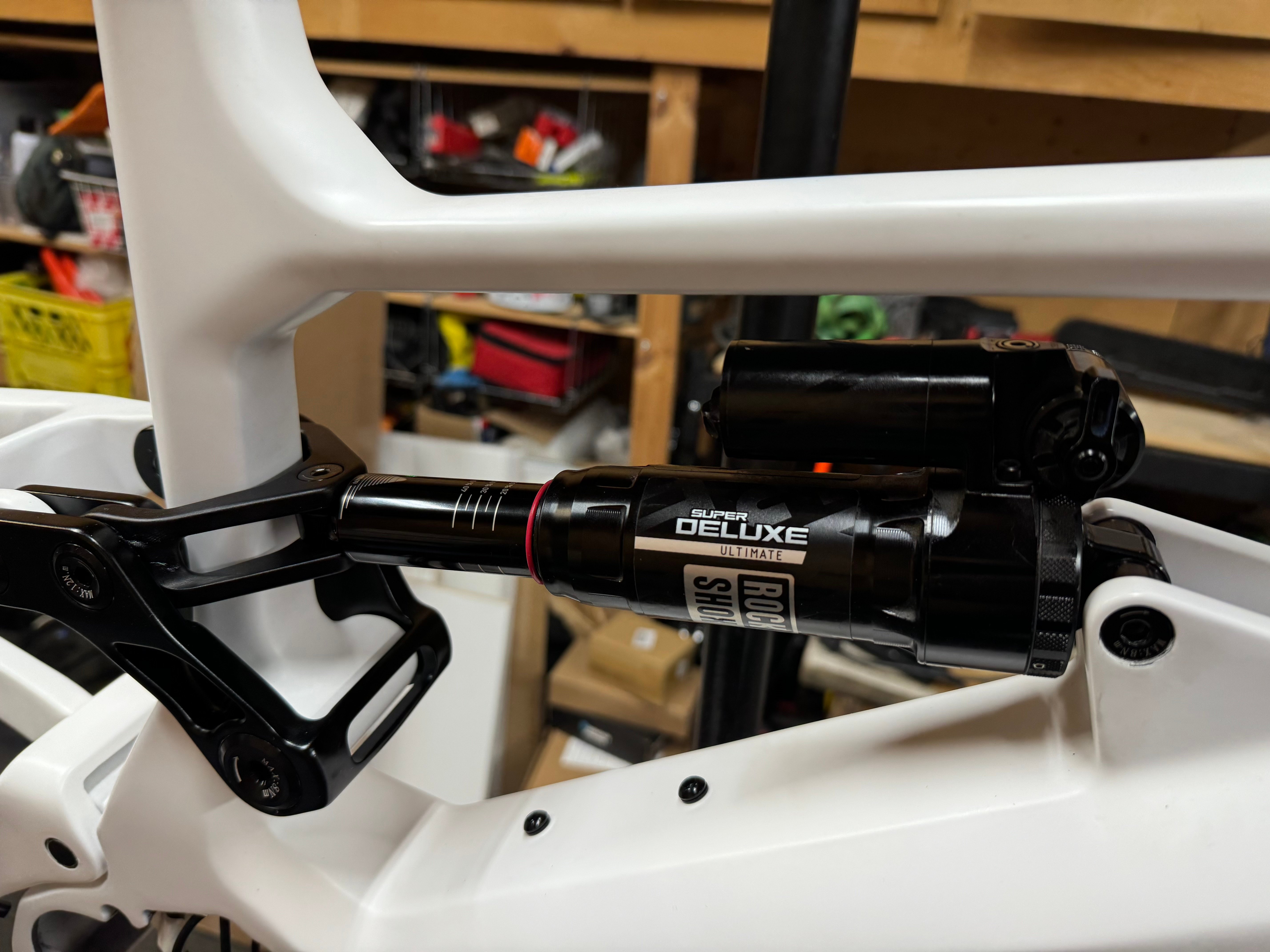

Hi guys, as I’ve understood you can’t put 230x65 without yoke modification. The travel is 191mm. Can someone tell me what would be the travel with 230x62.5 (hopefully this would fit just fine) and 230x60 repspectivelly? I’m reading ambiguous statements where someone says the real travel with 230x60 is 155mm only and dengfu says it’s 170mm. I have fox factory 38 170mm fork so do you think it’s better to fit with 230x62.5 or 230x260? Thanks.
This should help. They show 191mm rear travel with a 230x65. If you go frame by frame you can see it showing 184mm rear travel at exactly 62.5mm shock compression.
I don’t see why a 230x65 would fit any differently than a 230x62.5; they have identical lengths when extended. One would just have an additional 2.5mm of travel, no?
Thanks for response. Yes, all shocks have the same size when extended but problem might be at full compression. Some people posted a pictures of yoke with 230x65 shock installed touching the seat posts. That could be a problem. So I want to decide what would fit better with my fork 230x62.5 or 230x60. If 230x6 would give 171mm travel then probably is a better fit?
If I were you I’d just do the 62.5 then to be safe. I know I’ve seen people talk about issues with a 65 but didn’t know what the issue was, that makes sense now that you say it. I was stuck with my short 210x55 because I had bought it for an LCE971 frame, so I used the longer yoke and haven’t had any issues with the ~155mm of rear travel it provides.
But now I’m not sure and even more confused because I found one facebook post where guys showed bikes with vivid shocks installed and actually it was a very tight fit with shocked uncompressed! This I don’t understand because dengfu recommended shock is 230x60. But how is that it looks bad in extended position?? eye to eye is same 230… Dengfu Frame Ebike Owner's Group | Is anyone running a ROCKSHOX VIVID ULTIMATE rear shock on their E82 | Facebook
