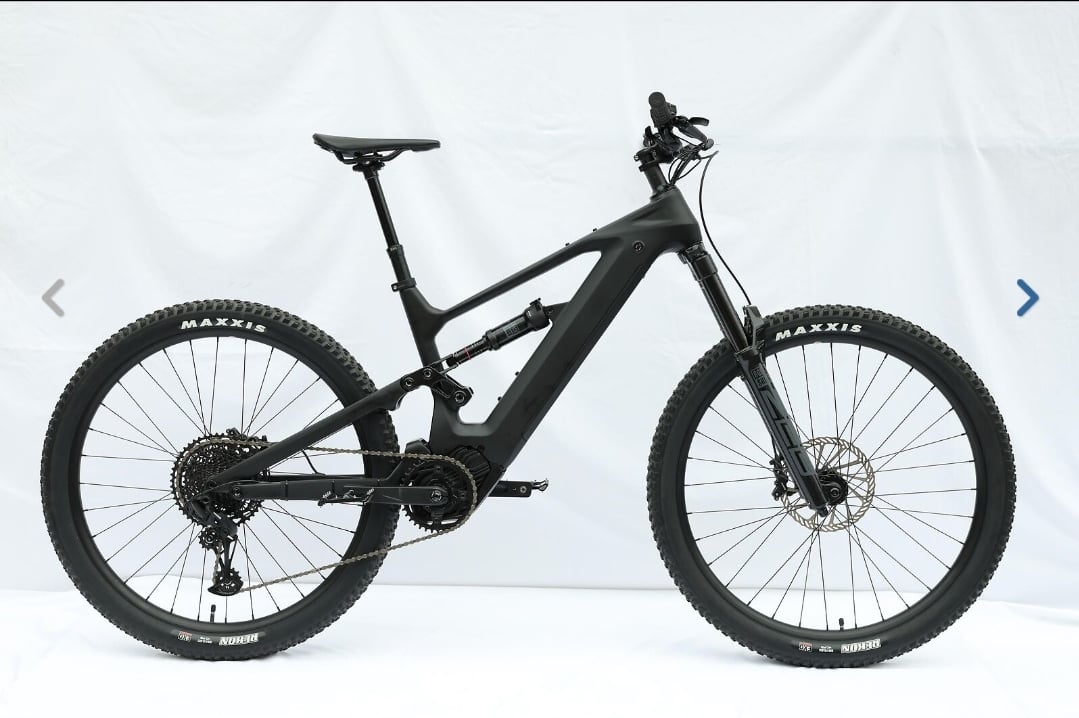

E82 is the successor for the E10 and E22 as far as I know.
Sadly only size M 17" currently. Have not yet been listed on dengfu website but they have it listed on aliexpress via dengfu store and ebay via carbon-cycle.
They will list it on the webpage after they come back from the holiday.
I asked about size L 19" frame and was told maybe in the future. Lets hope it's soon.

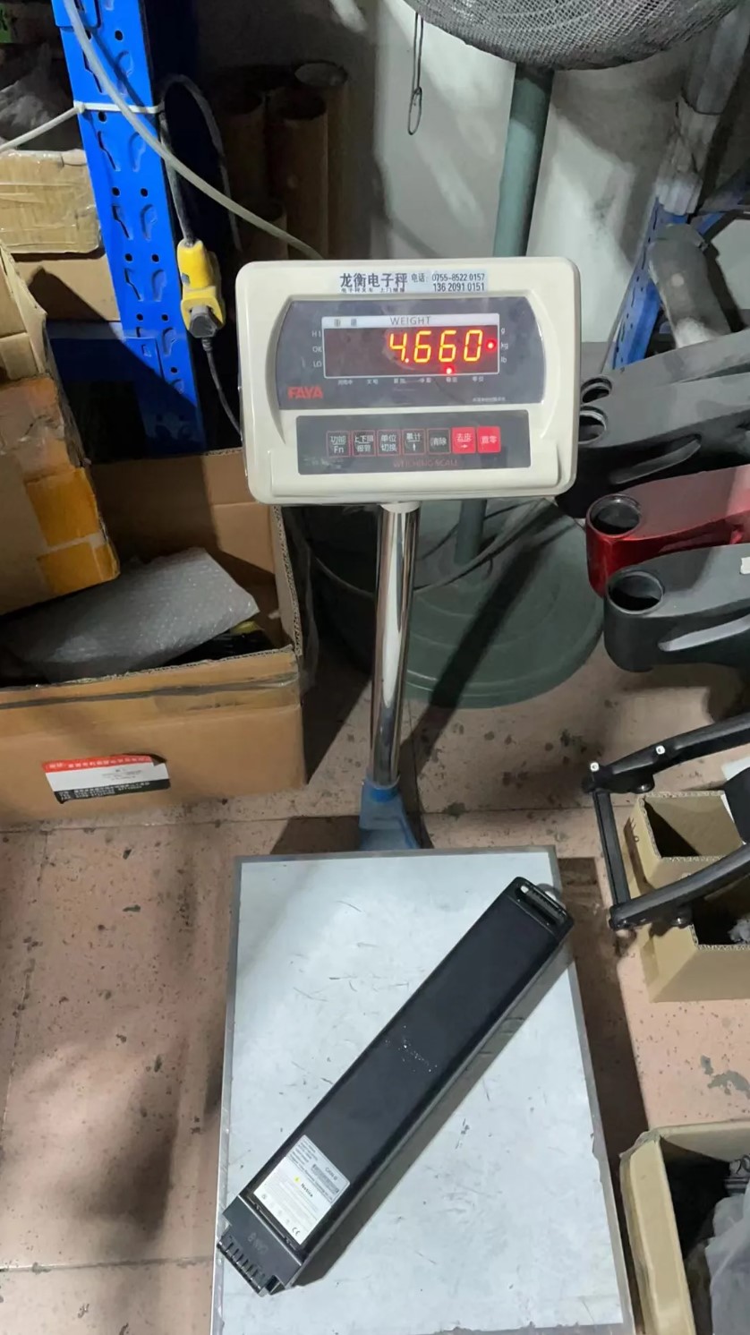

417
Russia
What is the weight of this frame? The description again indicates the encrypted weight of the frame
iscander13
Oct 11, 2021
179
56
earth
Actually, I don't see any reason why this frame will weigh significantly more/less than the e10.

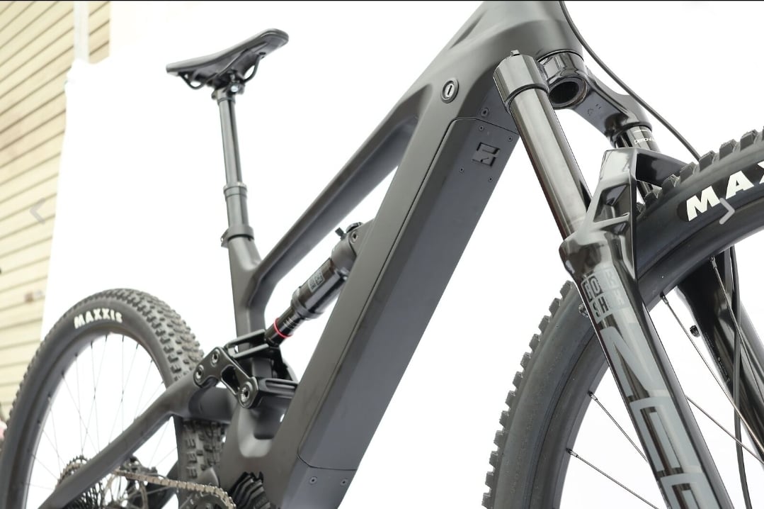

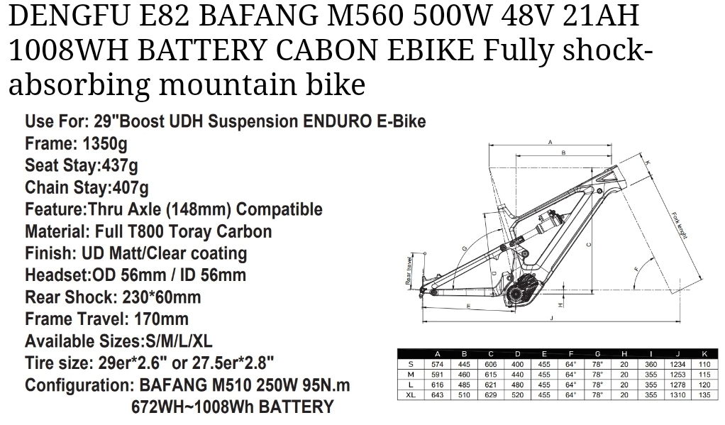

And besides the headset cable routing I don’t like the very steep seat angle. Size L has same reach value as E10 at 485 mm, but toptube lengt is 40 mm shorter!!!

434
Bratislava
Add the weight for linkages, bearings, axles, bolts, battery mounts and cover. Then You have the frame weight. My E10 size L was closed to 4kg if I remember that correctly…
Yep, exactly 4kg with battery holders and everything.
I guess it will be cca the same weight with E82. They can save some grams on battery holders.
That battery cover is unlucky, shame they did not change it. I would also welcome one hex bolt for battery retention instead of that bloody key lock.

2194 . Do you think this is true? E69 has the same numbers, and the stroke is 170.
From what I can source on E69 numbers are no where near the same.
Type: E-MTB 29ER BAFANG E69
Material Full carbon fiber T800
Weave: UD
Size 15.5''/17.5''/19''
Weight: 3465g+40g Size (17")
Headset-top: 52mm
Headset-down: 52mm
Brake model: Disc brake(180mm)
SeatPost: Φ31.6 mm
MaximumTyre 29*2.6
Rear Axle Shaft: 12*148mm Thru Axle
Shock Absorber Length: 190mm (Eye to Eye Length)
Shock Absorber Travel: 51mm
Front Spacing Travel: 160mm
Rear Spacing Travel: 150mm
BATTERY: Bafang BT F311.840.C (48V-17.5AH)
Voltage: 48V
Capacity! 17.5AH
Energy: 840WH
MOTOR: BAFANG M510/M500/M600
Warranty 2 Years
I got this answer from dengfu.
车架和它所有配件称出来接近3.5KG,照片有点糊还是不发了。
The frame and all its accessories weigh close to 3.5KG. The photo is a bit blurry, so I won’t post it.

I received a reply from Dengfu. The weight of the E82 frame assembly with a lid is 3500g. CEF49 weighs 3000g without a battery cover.

Yes, but what do you think about the geometry and desing choises of both of these? 😁
The 2024 frame has less weight, better geometry. The suspension has a stroke of 170mm. I don't see any point in buying a frame from the old model years.

Yeah, I guess the E82 has better geo for enduro riding with 170/150mm travel and LCE971 for trail since it's 150/150mm travel. E82 has bigger battery though. E82 has no size large yet sadly.. :/
