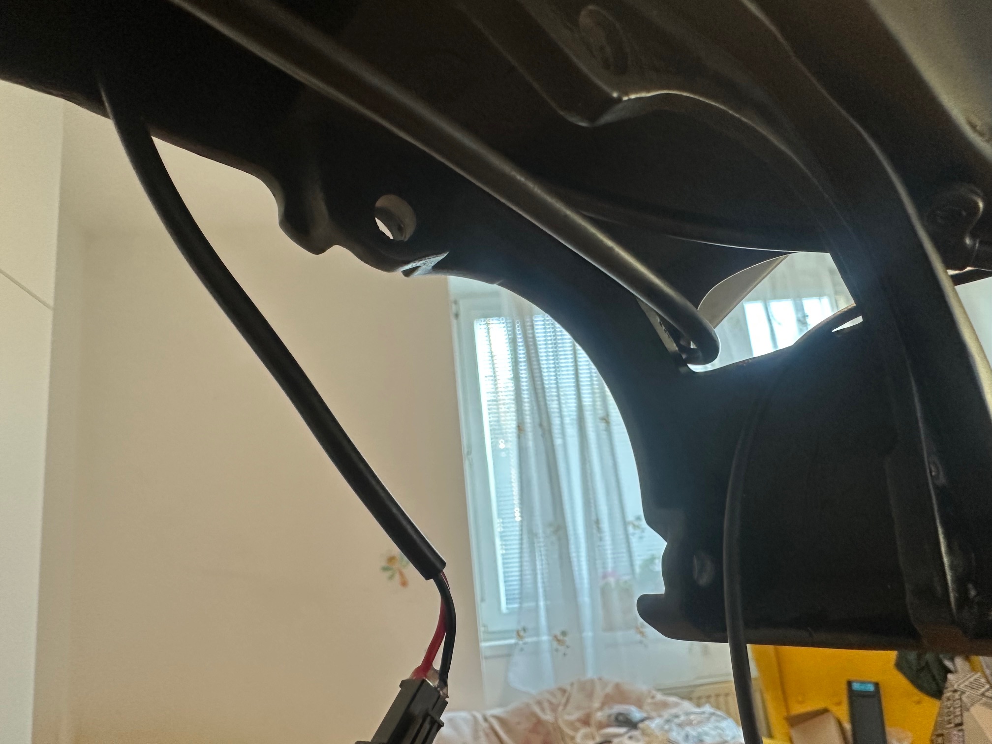

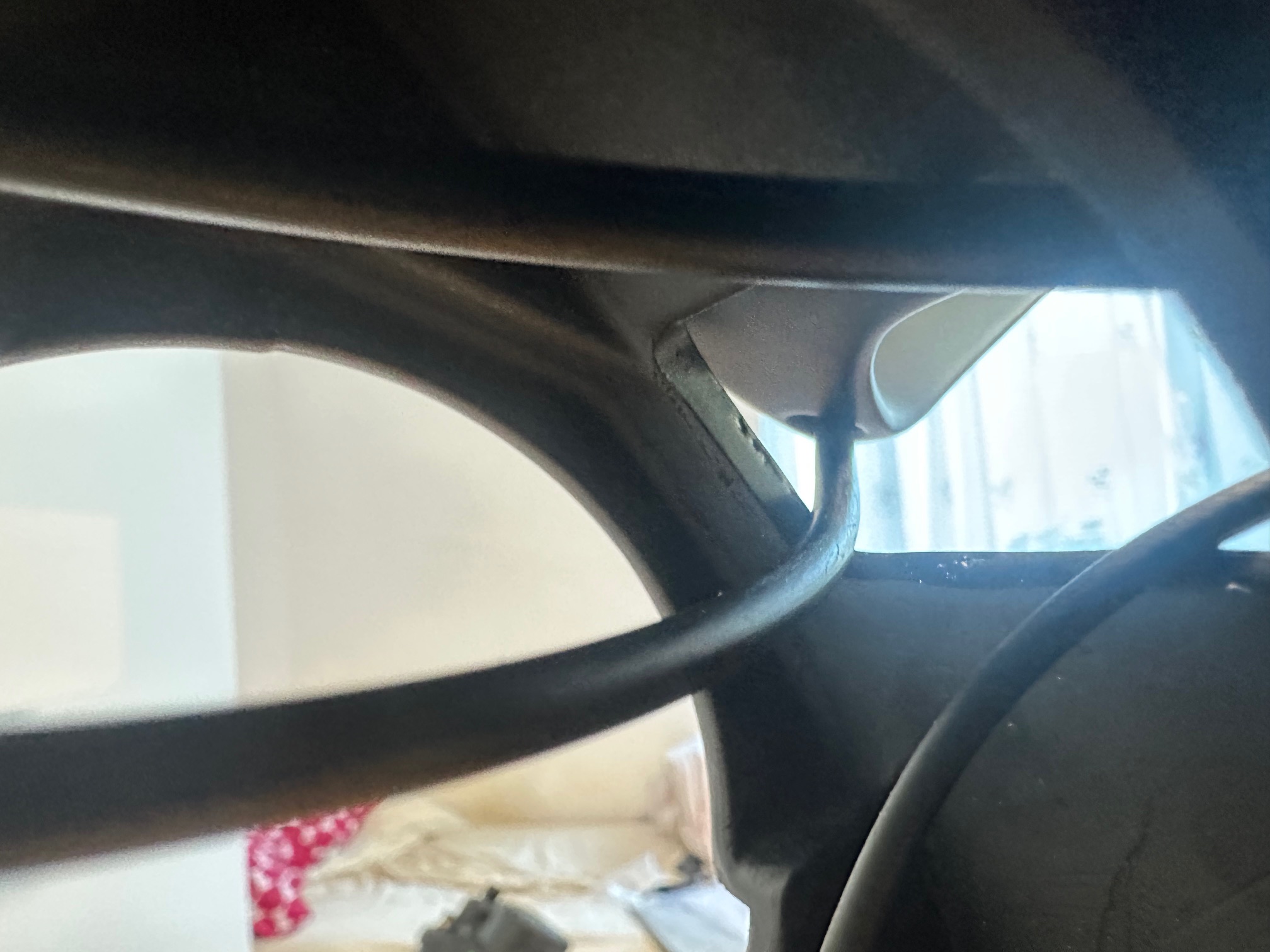

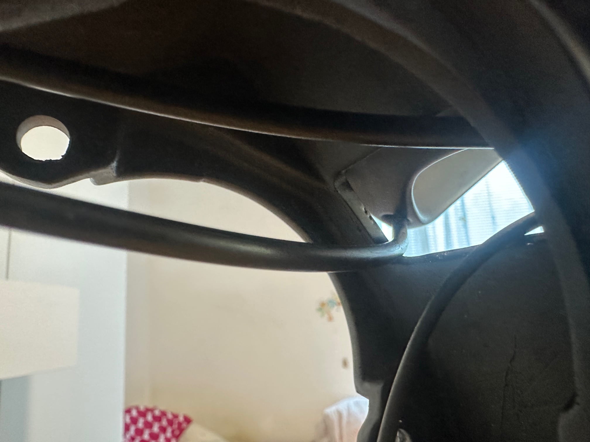

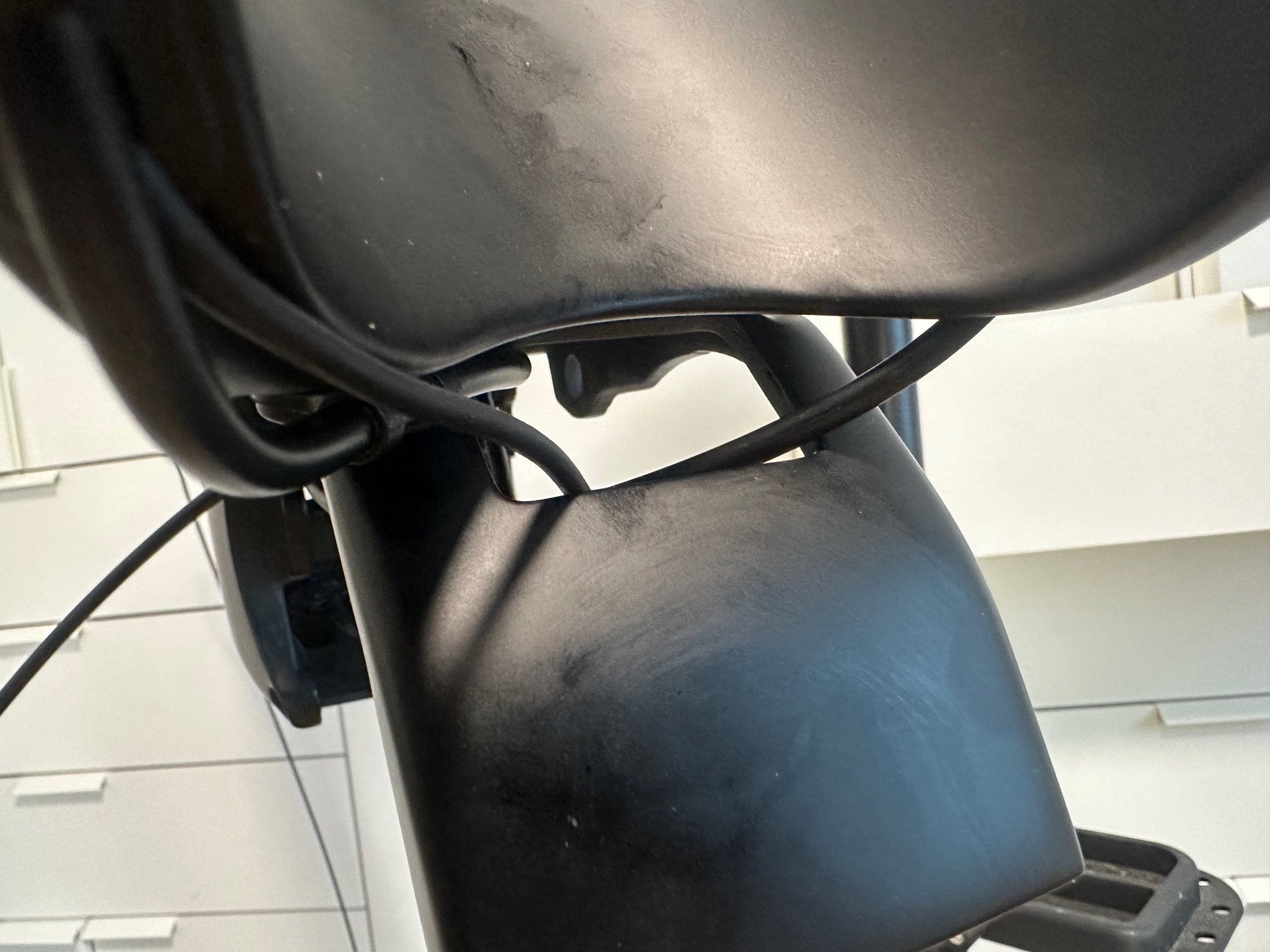

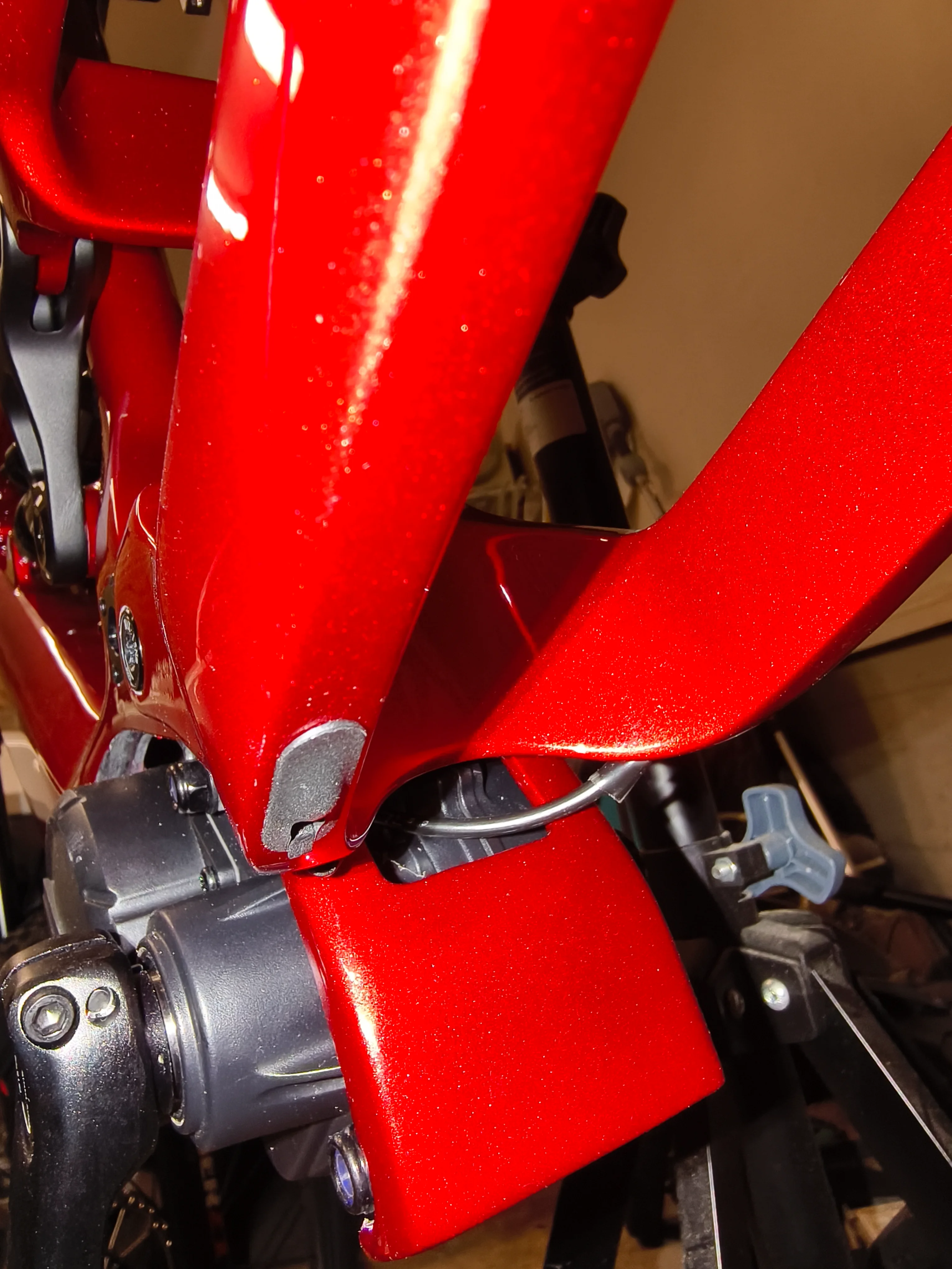

Hello guys, how do you route shifter cable ? I guess this design is not good since the hose is pretty tight against that frame opening and I believe it will rub there pretty bad. Any idea ?
I used a wireless drivetrain but I figured it would just go the same route of the brake hose on the other side of the rear triangle.
Yes same way but there is a little eye bracket or what is it so hose goes there and it's routed better. I've connected the motor and it slightly paused that shifting hose a bit so it seems it does not touch but let's see on a ride. Maybe I will have to buy wireless later but this design is not good imo.
I got my frame last month, just found exactly the same issue. I plan to add two layers of heat shink tube to fix the rubbing issue.
Leave there a loop. You can go 5 cm down with the hose and turn back.
best thing i found is to set the cable length while the rear frame is all the way up (longest position) i do this without shock and just put a tywrap
also when you set the engine in it takes some of the slack out the hoses so give it a bit extra
after doing all the cables and hoses check if if goes up and down smoothly, if not you will break the cables like i did before all this with my speed sensor
