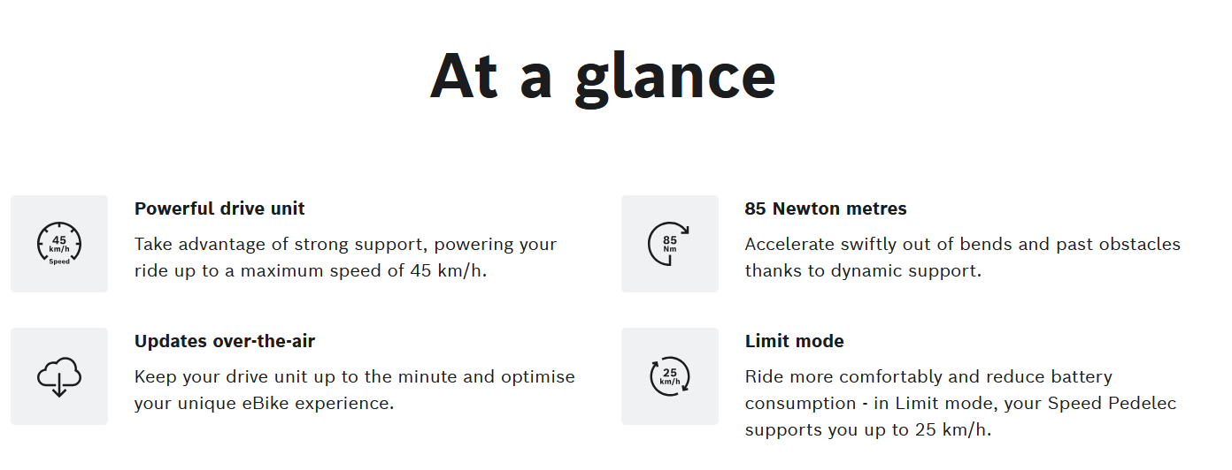

The Bosch website states the Performance Line Speed goes 45kmh. I wish we would have simple options to unlock that speed. Its annoying. Cars or motorbikes can go faster than the Speed Limit but the motors are not soft locked to the legal limit of 70mph. I don't know why ebikes motors are treated differently.

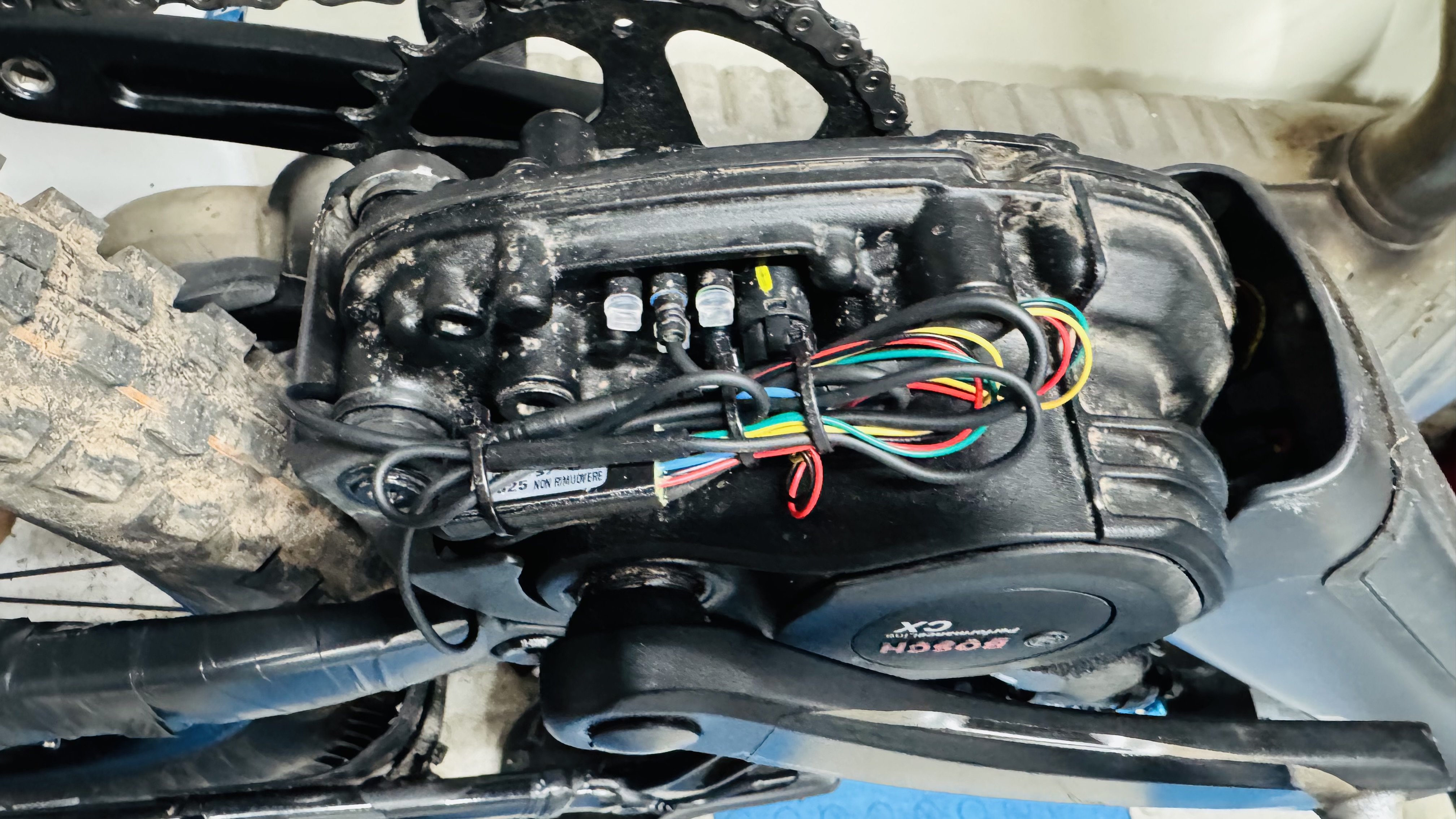

I installed the bikespeed RS last night on my bike.
Delivery was quick from Germany but I had to pay an extra £36 for the import duty. So total price was around £210.
Very simple to install. Could do it in 10 mins now I've done it once. Just need to work out wire routing from the spoke magnet into the motor.
Had a scare when I first turned the bike on as it wouldn't register the motor - but I left it for a bit and after trying various fixes - (starting the bike with a bit of pedal / holding the power and mode buttons for 8 secs) it kicked into life and is operable whilst riding using the combo keys to turn it or off using my mode selector.
Now it just works immediately when I turn the bike on so hopefully won't have to worry about that issue again.
Took it for a ride and it worked perfectly. Need to properly test it later this afternoon but the difference is amazing from stock. The feeling of not riding into treacle at 15mph is so good...
I'll give more feedback later but for now it seems like an excellent solution - especially with the algorithm beating software (lets see if it actually works as promised).

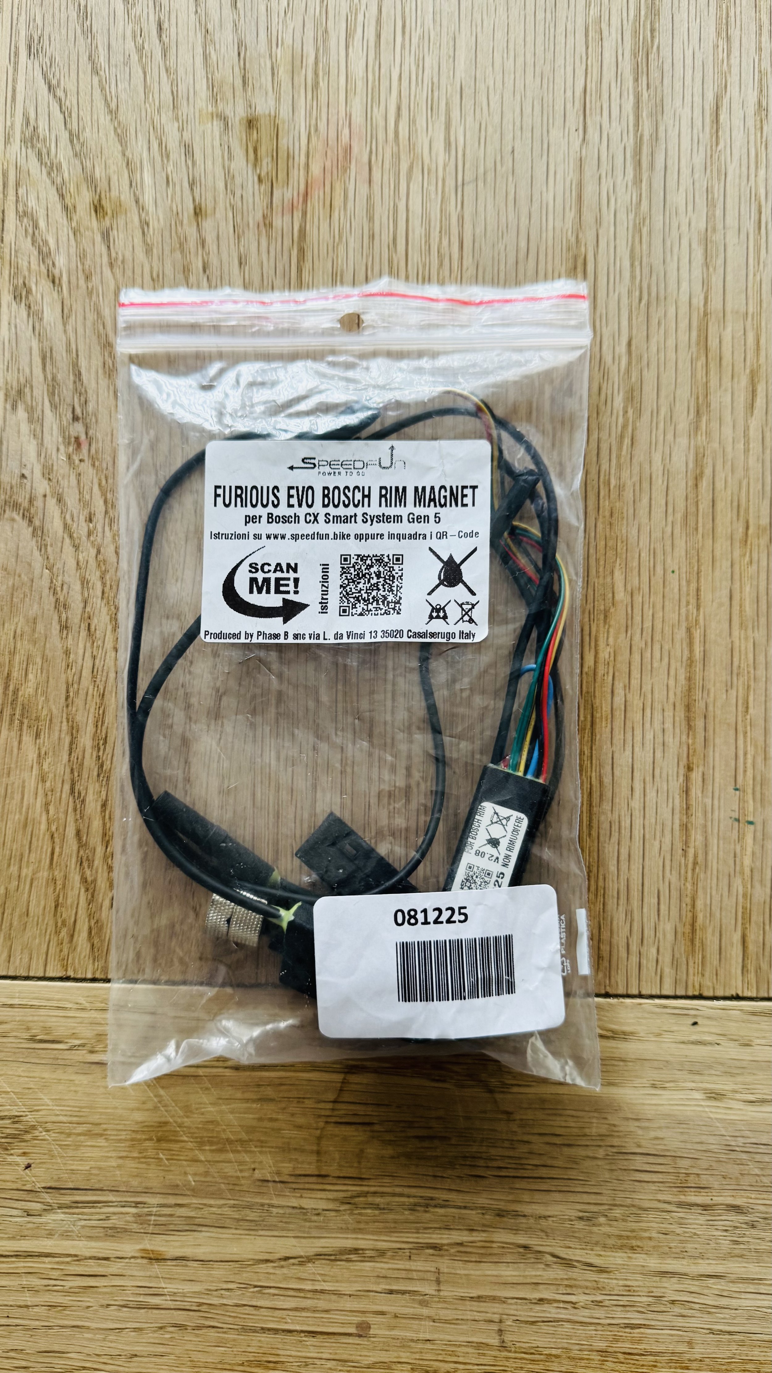

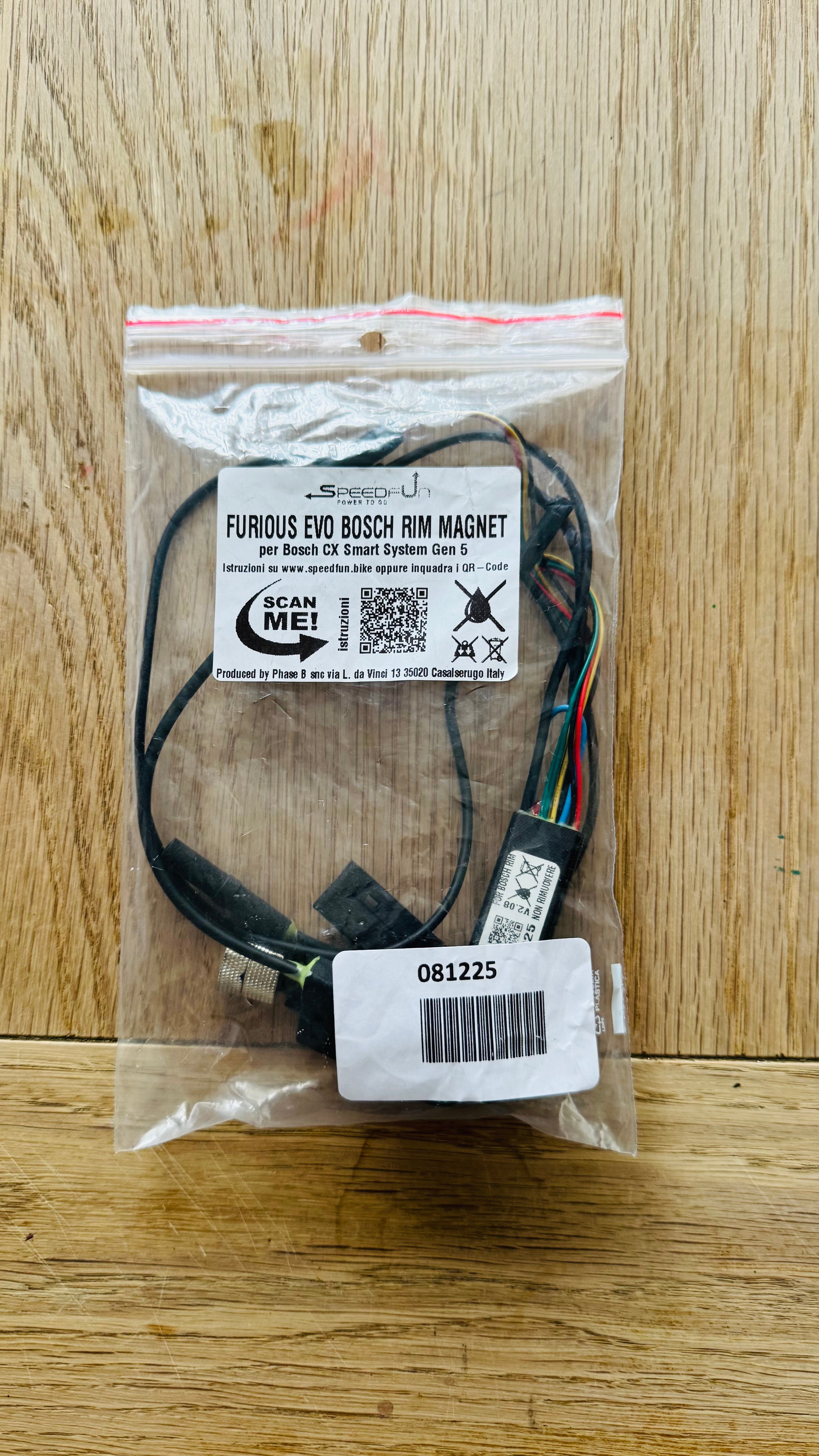

I’ve wasted 14 hours of my life messing with a speedfun gen 5 evo kit,did everything possible including going way and beyond to prove the fact it was not working for my particular bike by having the replacement sensor on a flipping bit of wood 300mm past the rear axle..as they kept saying it’s needs to be futher away from the Bosch internal sensor,it would either work for a min over 25kph then get the orange light on controller or would just hit the 25 an restrict..currently trying to get my money back from the supplier
Damn - so annoying.
