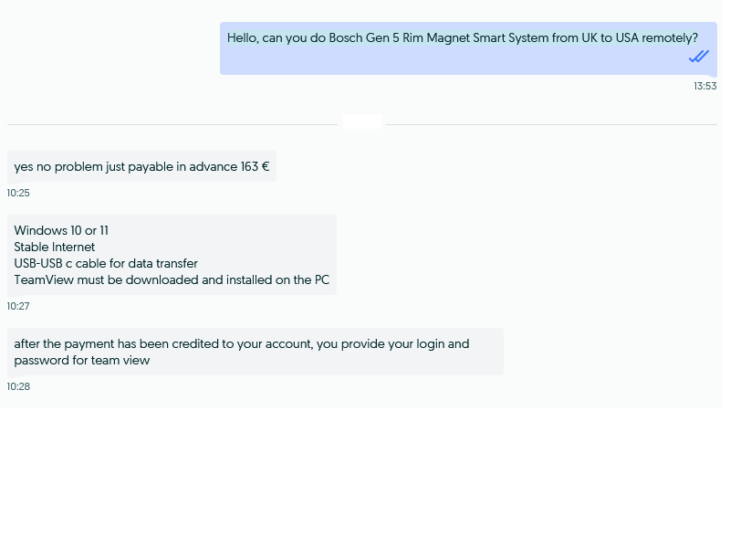

Does this work with Gen 5 Smart System Rim Magnet? I see you have Gen 4? Do you have a rim magnet?
Yes I have rim magnet, but gen 4. I don’t known :(
Thanks. I've contacted the guy to see what he says. Would be ideal as an interim measure. Might even be enough.
I've given up with my bikespeed.de chip as I can't risk going into limp mode miles from home.
I'm not willing to risk paying this to a Polish guy on a Polish site with no guarantees - but if I find a UK seller I will definetly go ahead. Good to know it can be done.

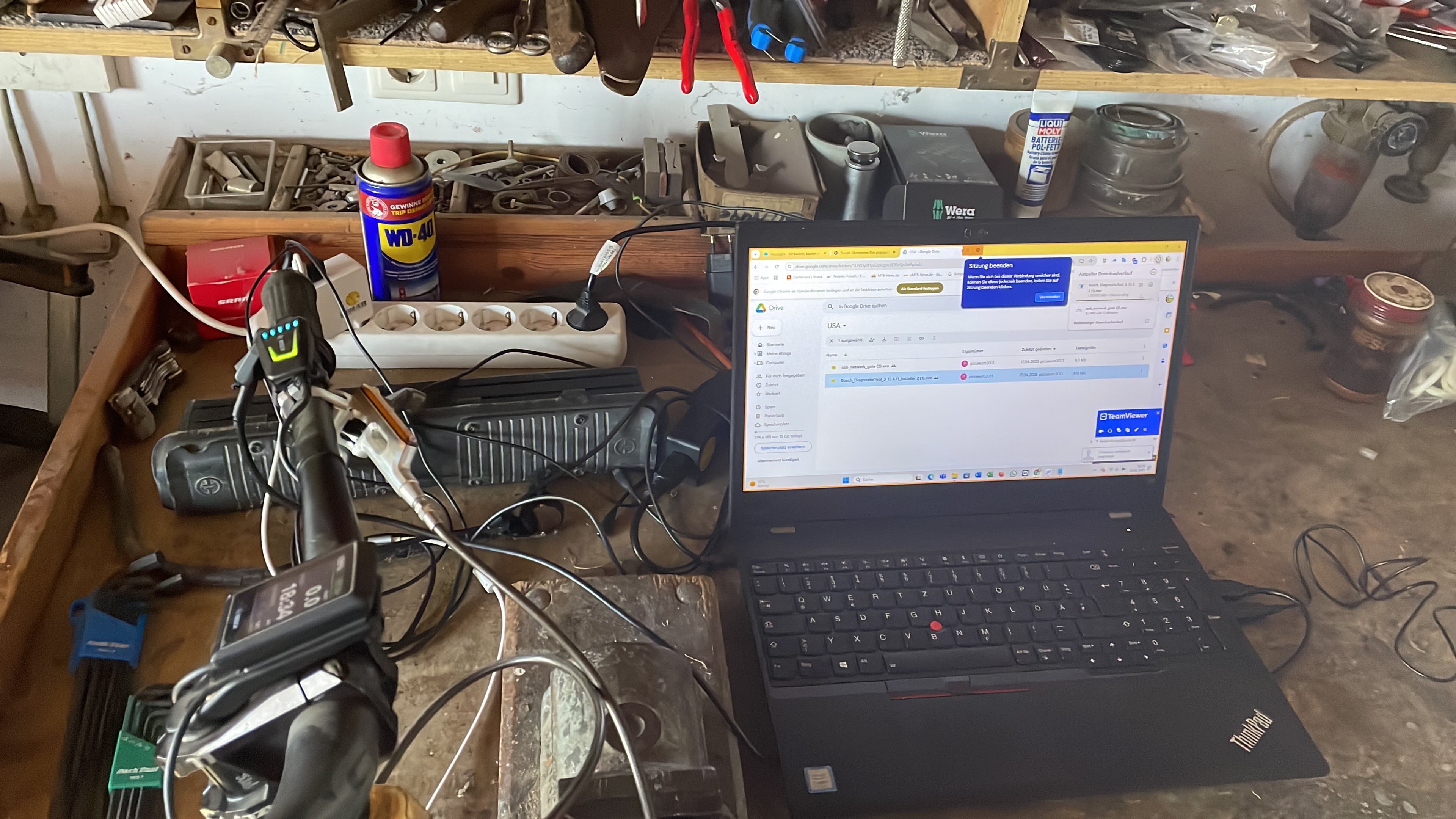

Yes, after installation of the us container
That's great that you got this done. So the guy is trustworthy then.
Did you see what software he used to flash the motor?
What happens if you wanted to revert back for warranty to original software? Will he charge you full price again?
he used the Bosch_DiagnosticTool_3_13.6.11 and a Cube container with the US version for flashing.
Changed some settings. I assume that he has an OEM registration
That's great, please test it for a while and let me know after a few hundred kilometers how it works.
Is it okay to use the flow app?
Did he give you the recommendation not to update the new software?
I was in for a warranty inspection after changing the software to US. You don't lose your warranty. They told me that it doesn't affect the warranty. The only thing is that you can't update it yourself from the app, because the software will go back to European. They can update it in the service and it will still be US.
