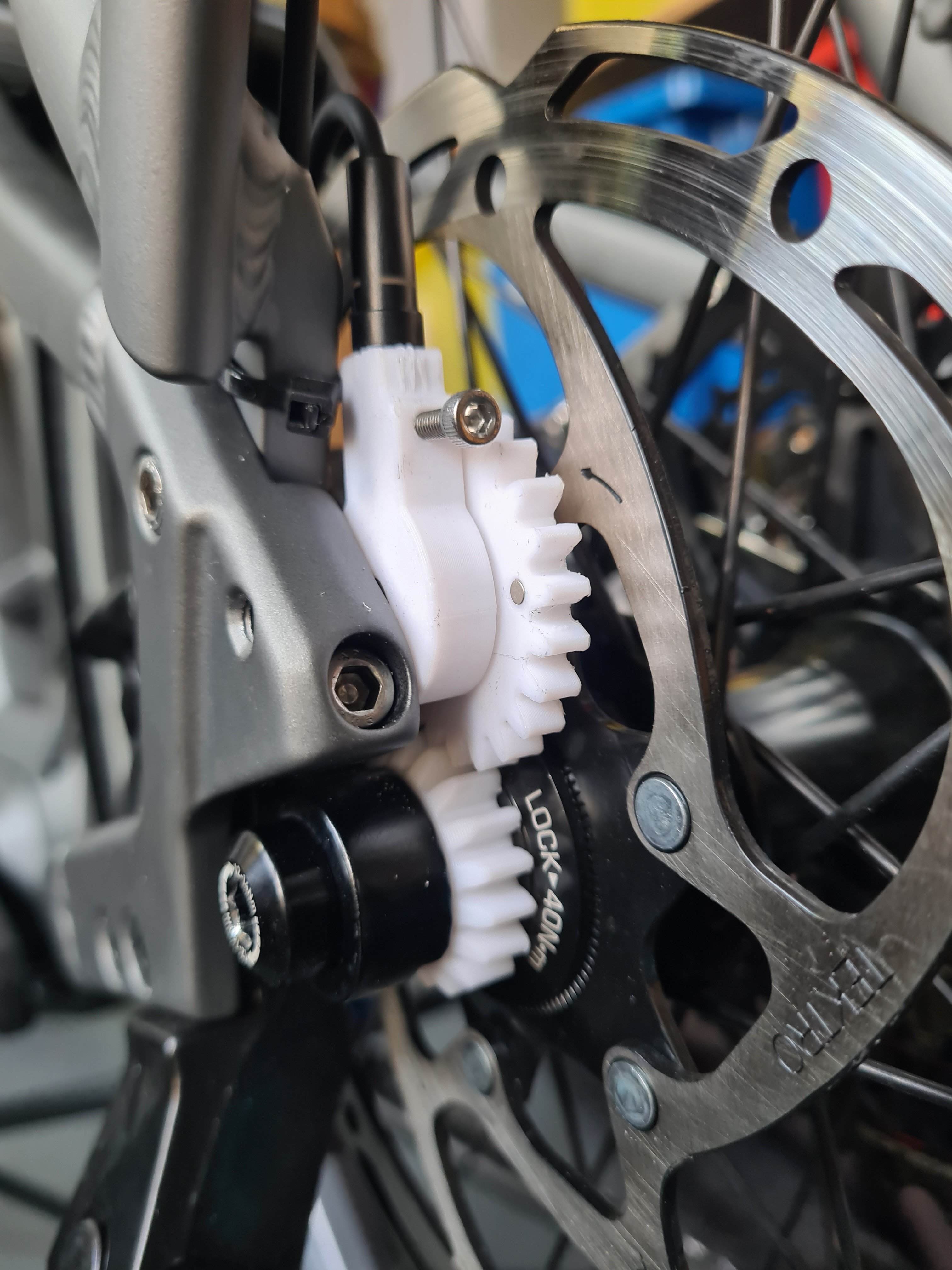

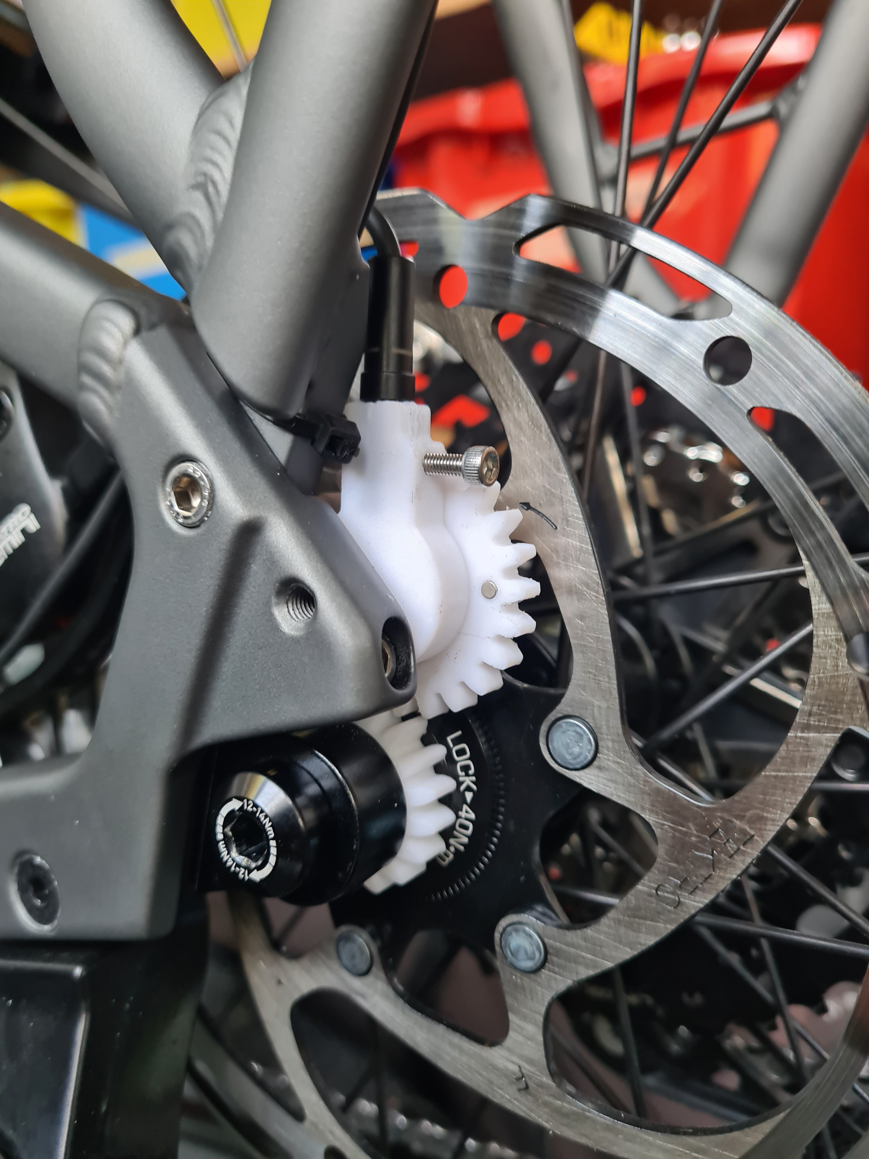

Here's my go at getting some more speed out of my bike. I'm based in Australia so 25kmhr limit. This modification takes it up 32kmhr
