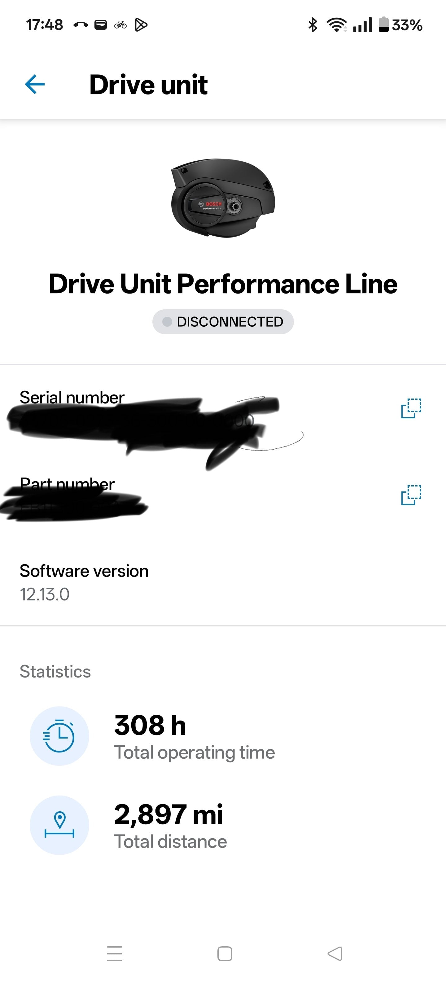

Update on My ride I've done 1000 miles with no error.
I've had my bike 13 months and 3kmiles in total
I mostly use it 17.4mph And 19.4mph depends on wind. Feels great
i always crank it up to 24mph on My last mile

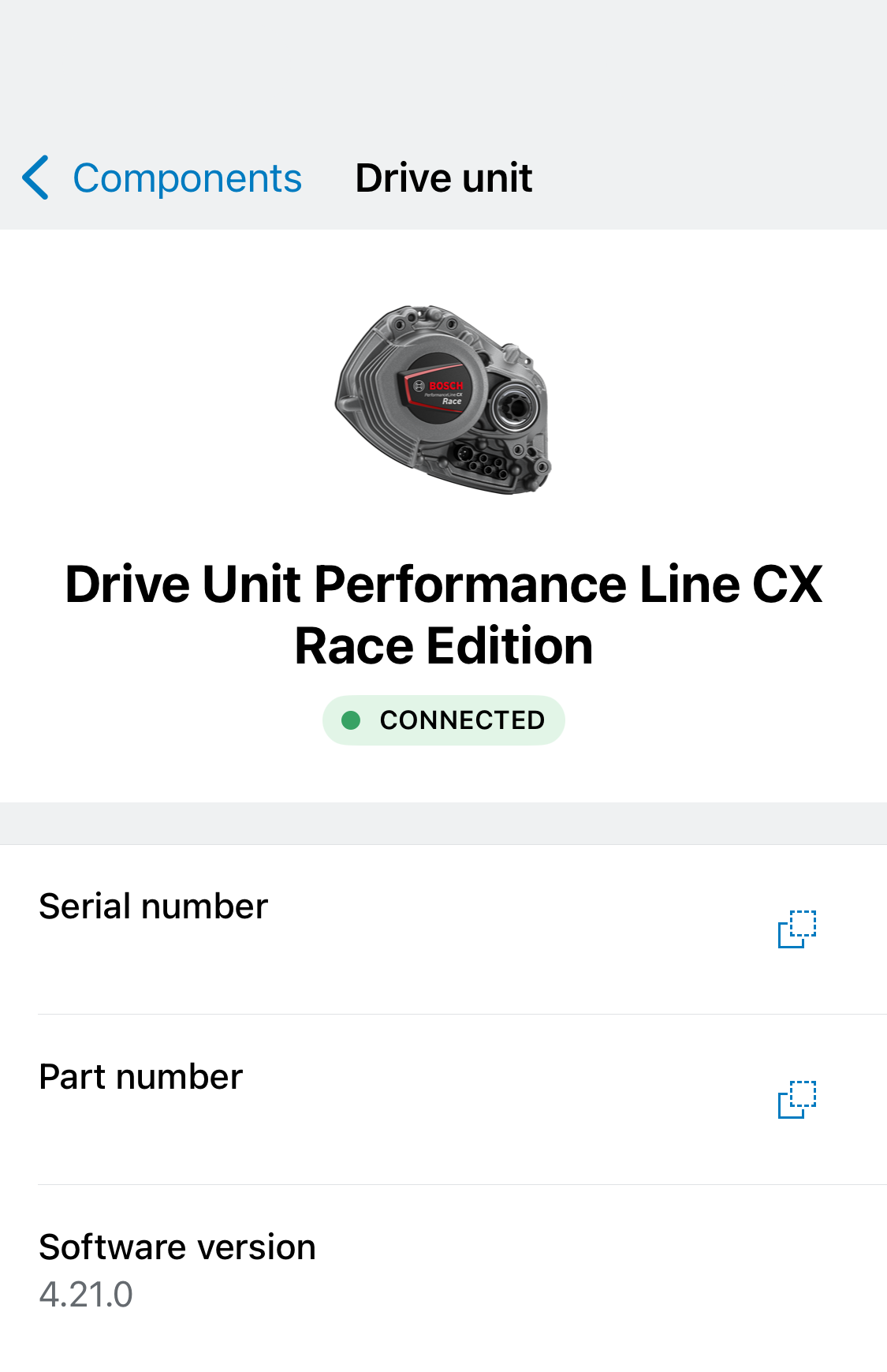

Hi everyone. Happy new year.
New member here with new eMTB in the United Kingdom.
I'm looking to derestrict my eMTB. Happy to keep the derestrict to a maximum speed of 25 Mph/40 Kph if that keeps me below the error codes potentially being activated.
Bike is a 2023 model that's been sat in the LBS since August 2023 by the looks of things.
Motor is a Bosch Gen 4 Performace Line CX Race edition with Rim Magnet sensor.
Just checked my firmware on my new eMTB. Looks like it hasnt been updated (not sure if this is good or bad).
My questions are as follows:
1. Should I update the firmware if im going to derestrict OR leave firmware on the current version as per the attached pic?
2. What are the PROs of updating the firmware from current version to latest version?
3. What are the CONs of updating the firmware from the current version to latest version?
4. Which derestrict is the safest bet to go for at the moment considering the type of motor and speed sensor I have (Happy to keep the derestrict to a maximum speed of 25 Mph/40 Kph if that keeps me below the error codes potentially being activated.)?
Thanks in advance.

If you can, ask or find a dealer that is willing to activate the reed-switch sensor of the motor.
Being able to tune the riding modes is a plus, I don’t know at what version they implemented that?

1. better not, not before someone else dit sacrify himself to test
2. there is a version that enable you to finetune the predefined assistance modes (mine origianally did not had that option)
3. not able to use existing "tuners", Bosh is putting quite some efford in trying to discover "cheating". So using their app (gps) is not a good idea ...
4. as said, if you can get rid of the rim magnet, ie, enabling the traditional reed-switch (bike dealer), you will have much more options
