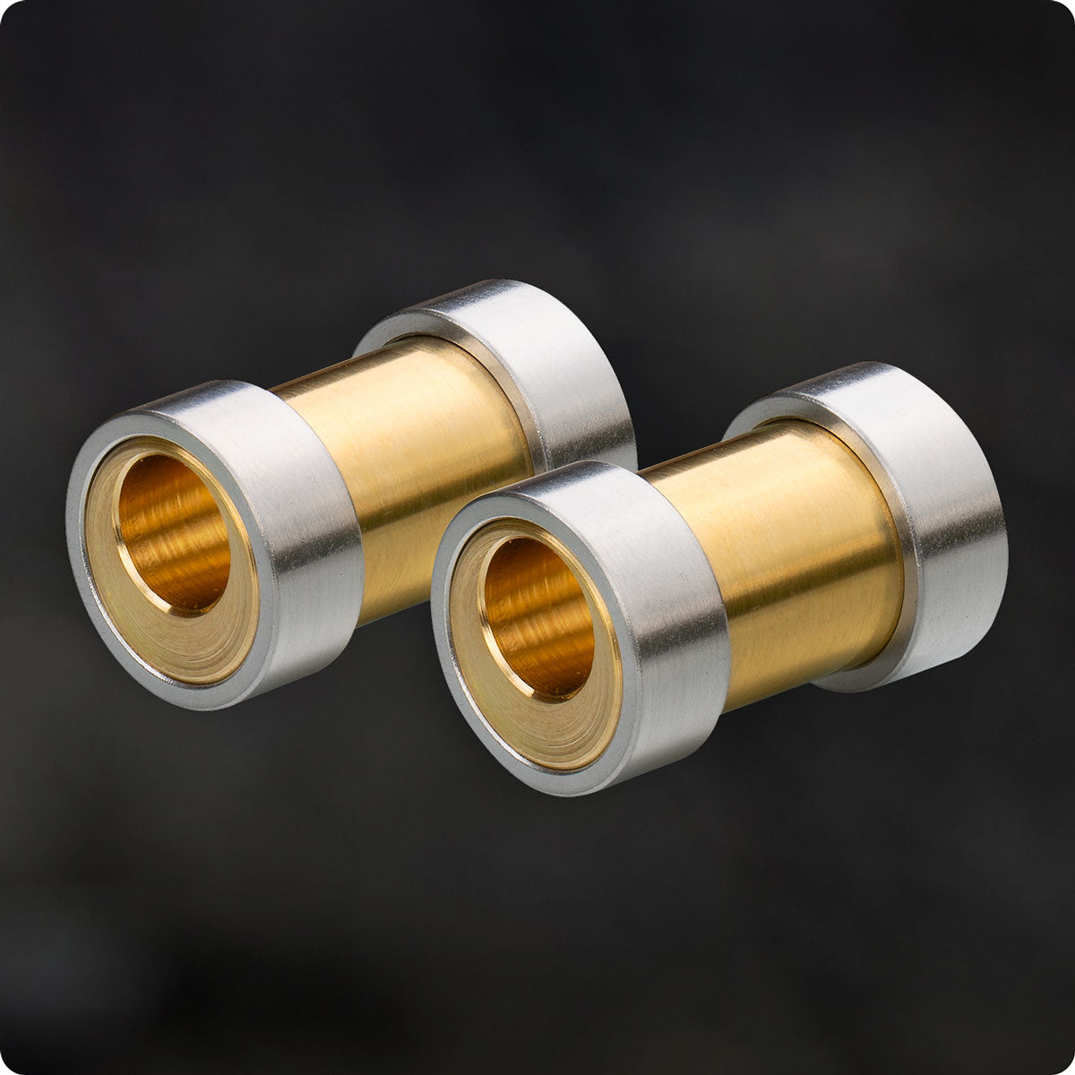

The bushings from Offset only have 2 mm offset using 8 mm bolt diameter at the E10 frame. 3 mm offset is only available for bushings with 6 mm bolt diameter. Be careful if You use 2 mm offset bushings on both sides. The reduced shock length of 216 - 4 = 212 mm will result in a fully compressed length of 212 - 63 = 149 mm only. The rear triangle may crash into the seattube in case of a hard impact landing. I measured it, I tested it with no air in the shock. I decided not to take the risk, used only 1 offset bushing, and reworked the yoke accordingly.

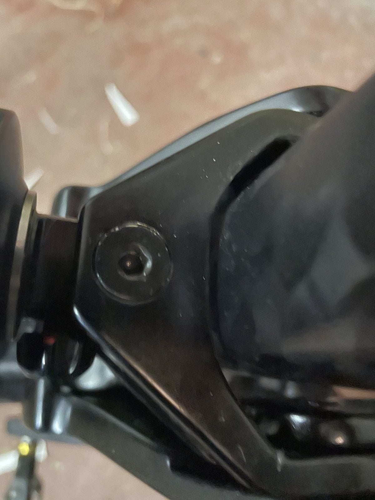

How much material did you remove from the yoke? Any noticeable effect on its strength? Maybe some flex during pedalling?
I milled away appr. 2-3 mm on the upper yoke plate only. There is absolutely no effect on strength of the yoke. The whole design of the linkage is beefy and stiff, You will see once You have the frame in Your hands!
Is it possible that you could take a picture so i could see how much clearance you have thank you
Here You are, it‘s appr. 2-3 mm.

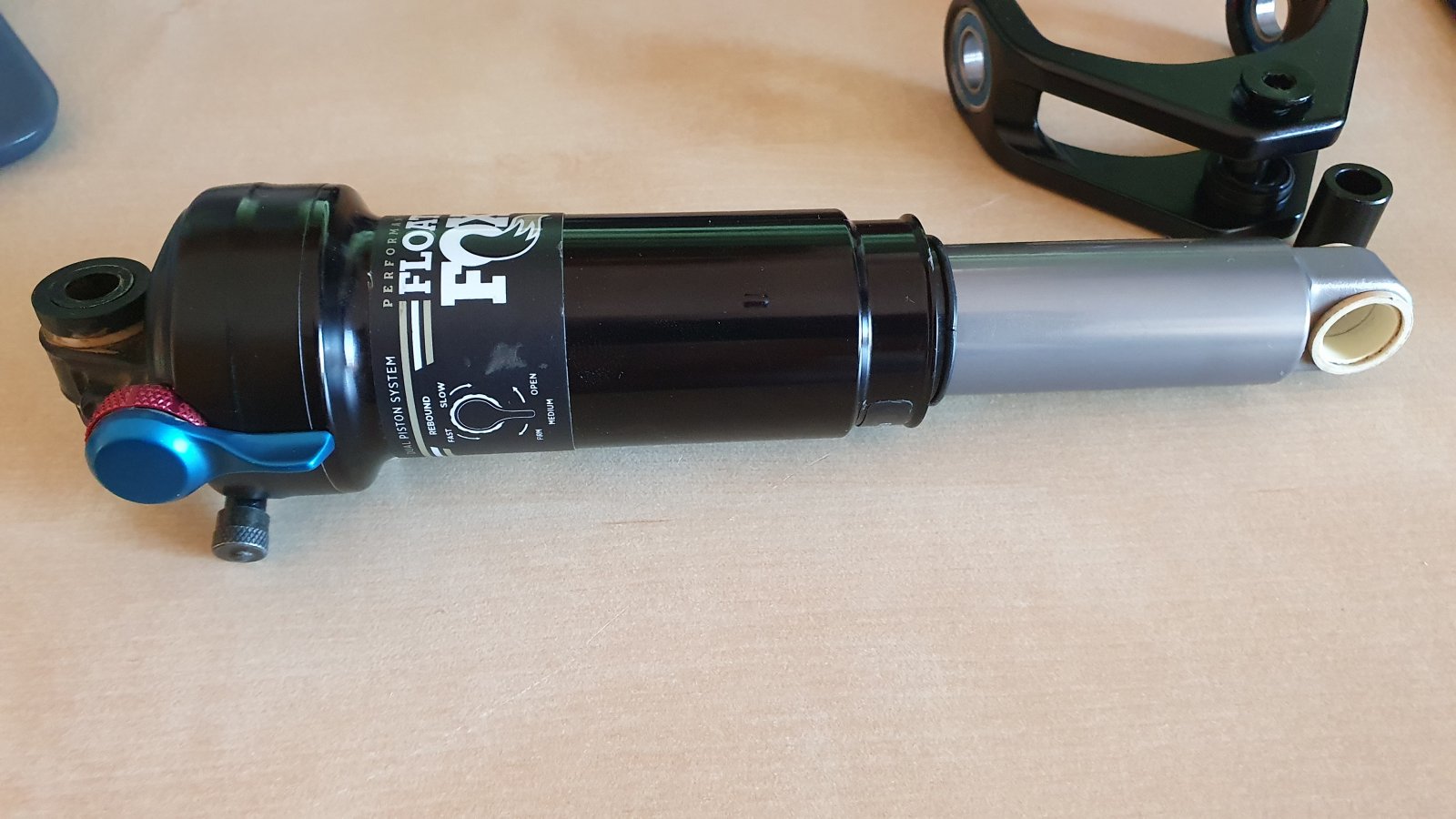

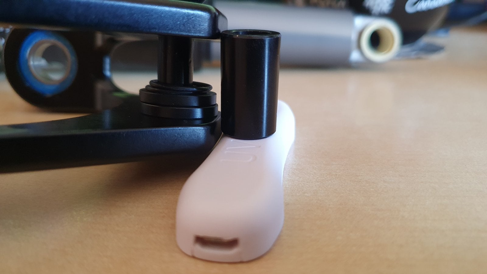

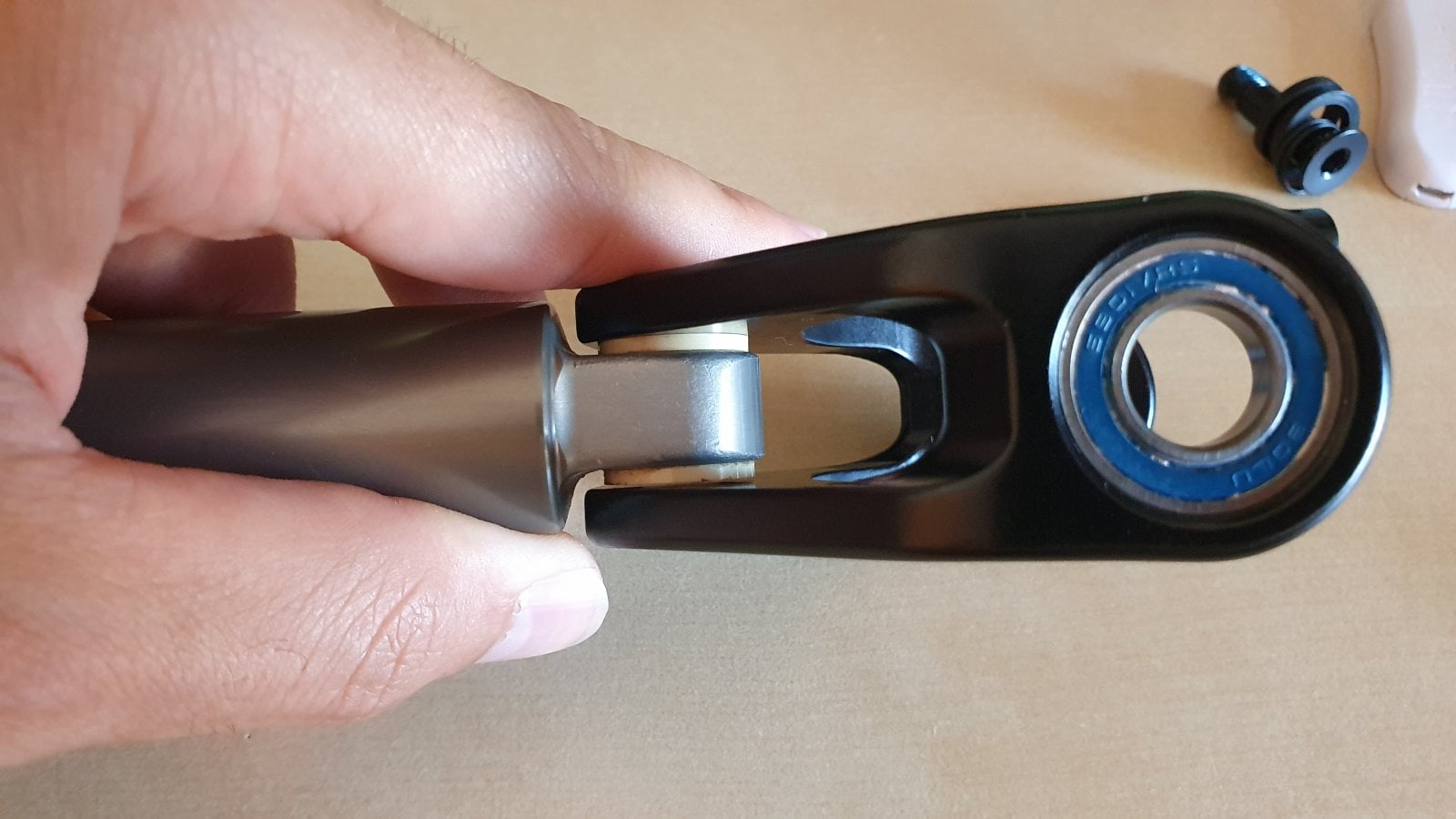

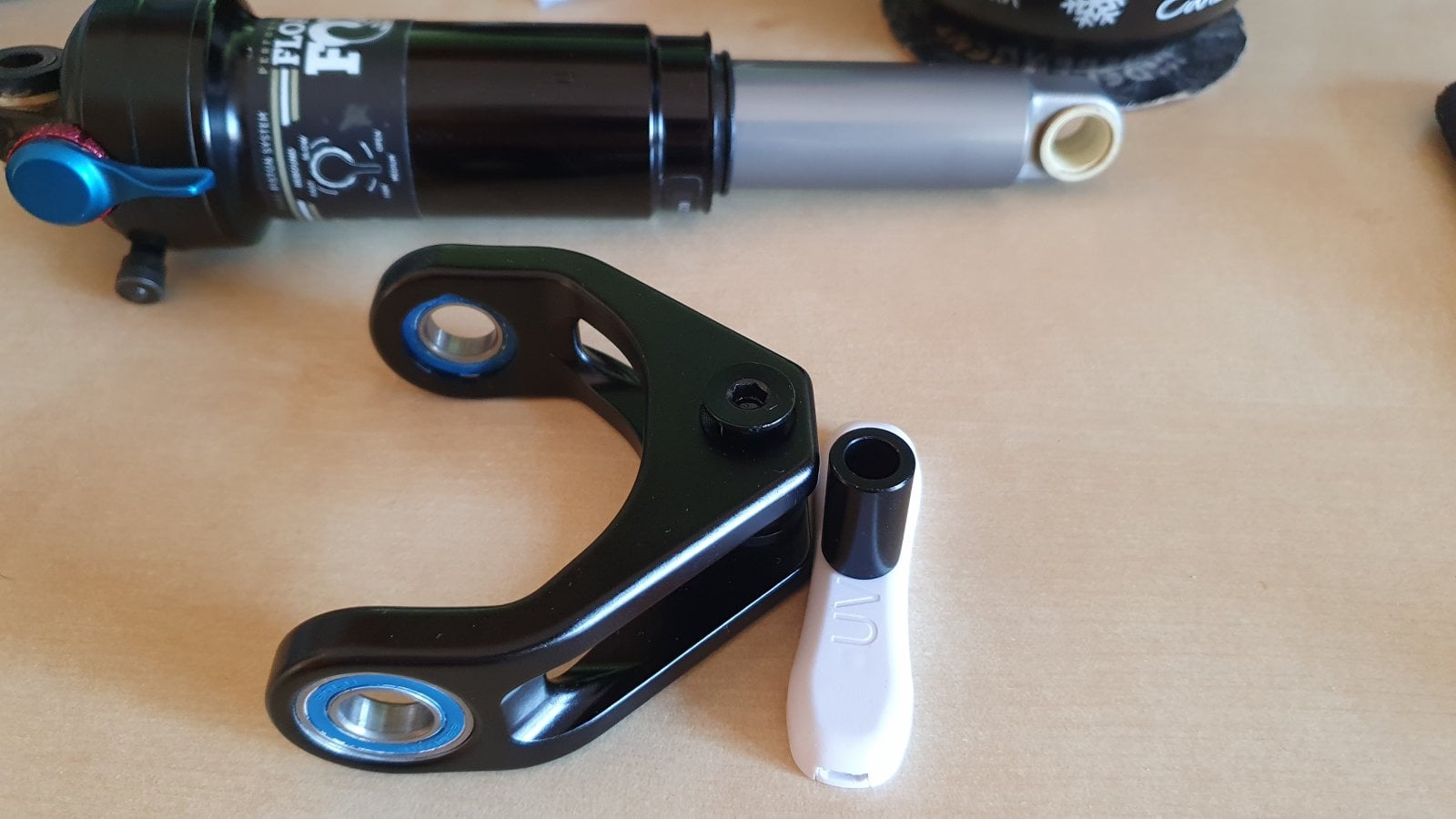

Hi ! another one trying to mount a 216x63 shock on the frame. I've read with one offset bushing and removing about 3mm of yoke it is possible. Has anyone tried just remove about 6mm of yoke?
I also have one more question. In case I use my old bushing, I need to remove part of it also to leave it at 16mm length, but the white part of the shock should be removed too?
Hope anyone can enlighten me.
Thanks!
I would cut (using a lathe) the black bushing down to 16.5 mm (not 16!) and keep the inner white bushing if it is not worn. Looks like there is a small groovo on each side in the white bushing for a small O-Ring. If possible, use this with a matching O-Ring to seal the inner bushing. If there is a gap remaining between the white bushing and the Yoke, use shims to fill it.
