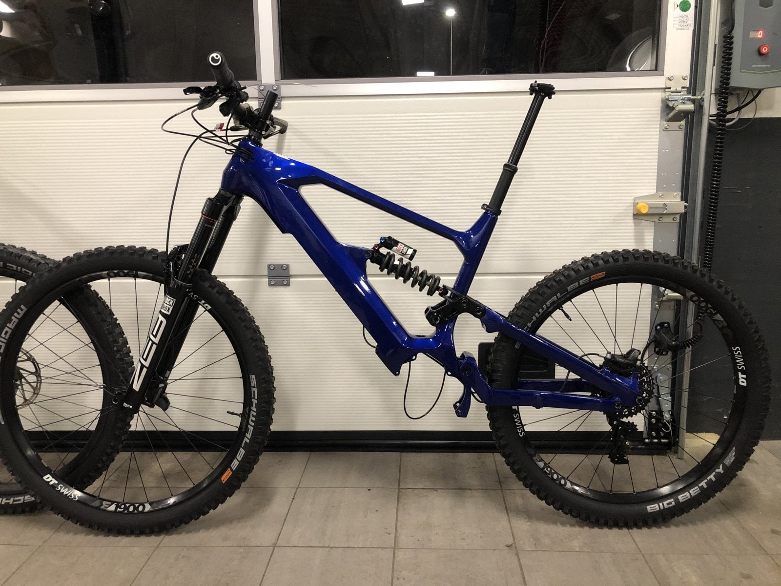

Without riding the E10 it's difficult to know what fork length will work best. With this in mind I just ordered a 29" 180mm Manitou Mezzer Fork, 44mm offset. According to reviews it's stiffer & lighter than a Lyric, with more sensitivity than a Zeb. But the key point is the travel can be changed from 180mm to 140mm in 10mm increments by inserting supplied spacer tokens (need to remove lower legs).

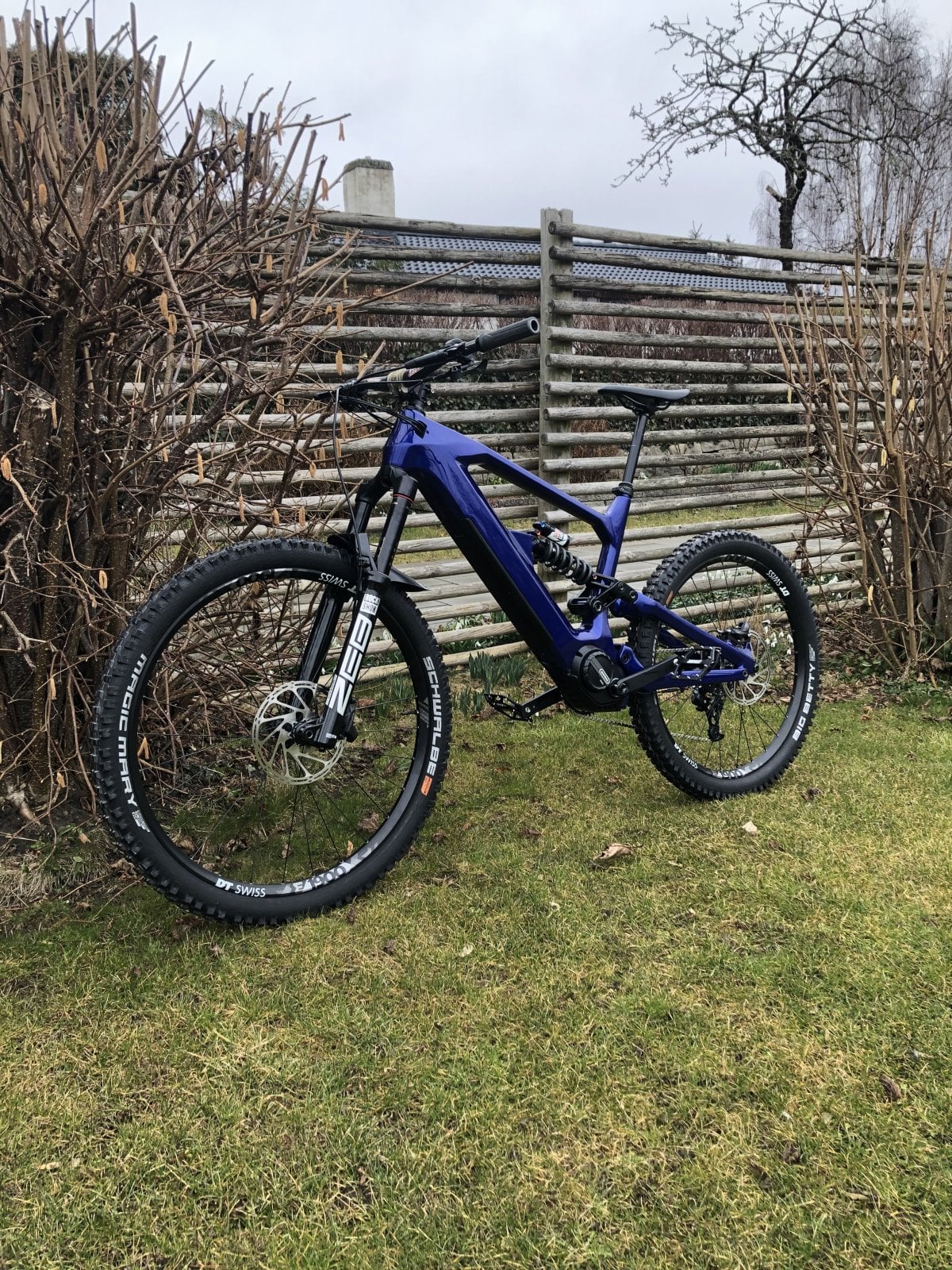

first night finished and I reached really far, I hope to drive this weekend

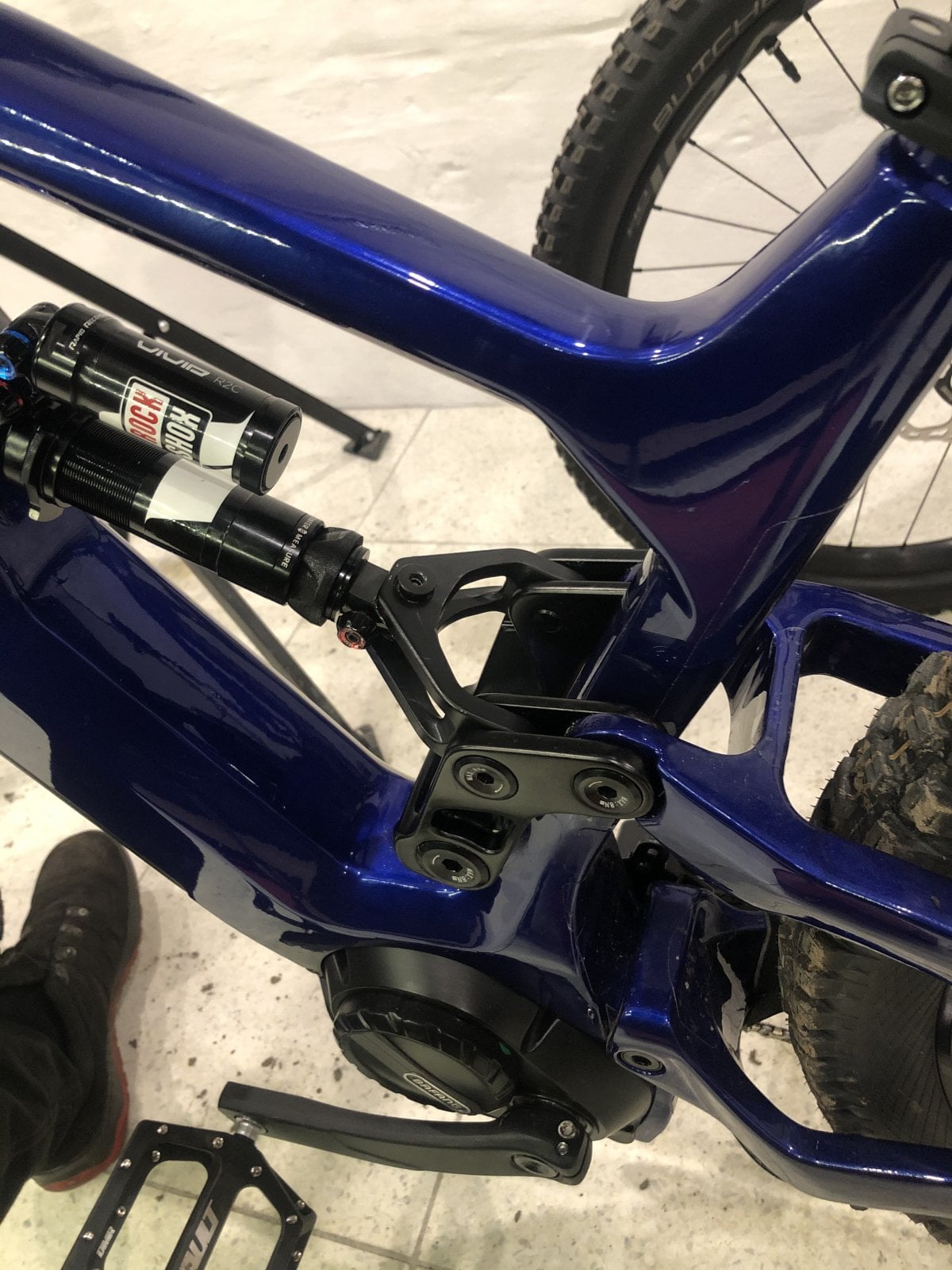

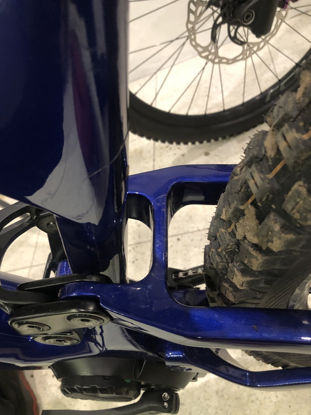

you need to remove about 4mm of material from your yoke otherwise the 6mm longer shock length will hit the seattube
Did You use Offset bushings? Can You estimate, if You use Offset bushings to shorten the shock length by 2/4 mm, if the tire or the rear triangle crossbar will hit the seattube? Thanks!
I'm going on a longer trip on it this weekend, so I can answer a little more about what it's like to drive. I have chosen it with an M600
Strange, you have more space than with my 215x60 ? do you have really 153 mm between the 2 fixation axles when shock is fully compressed ?

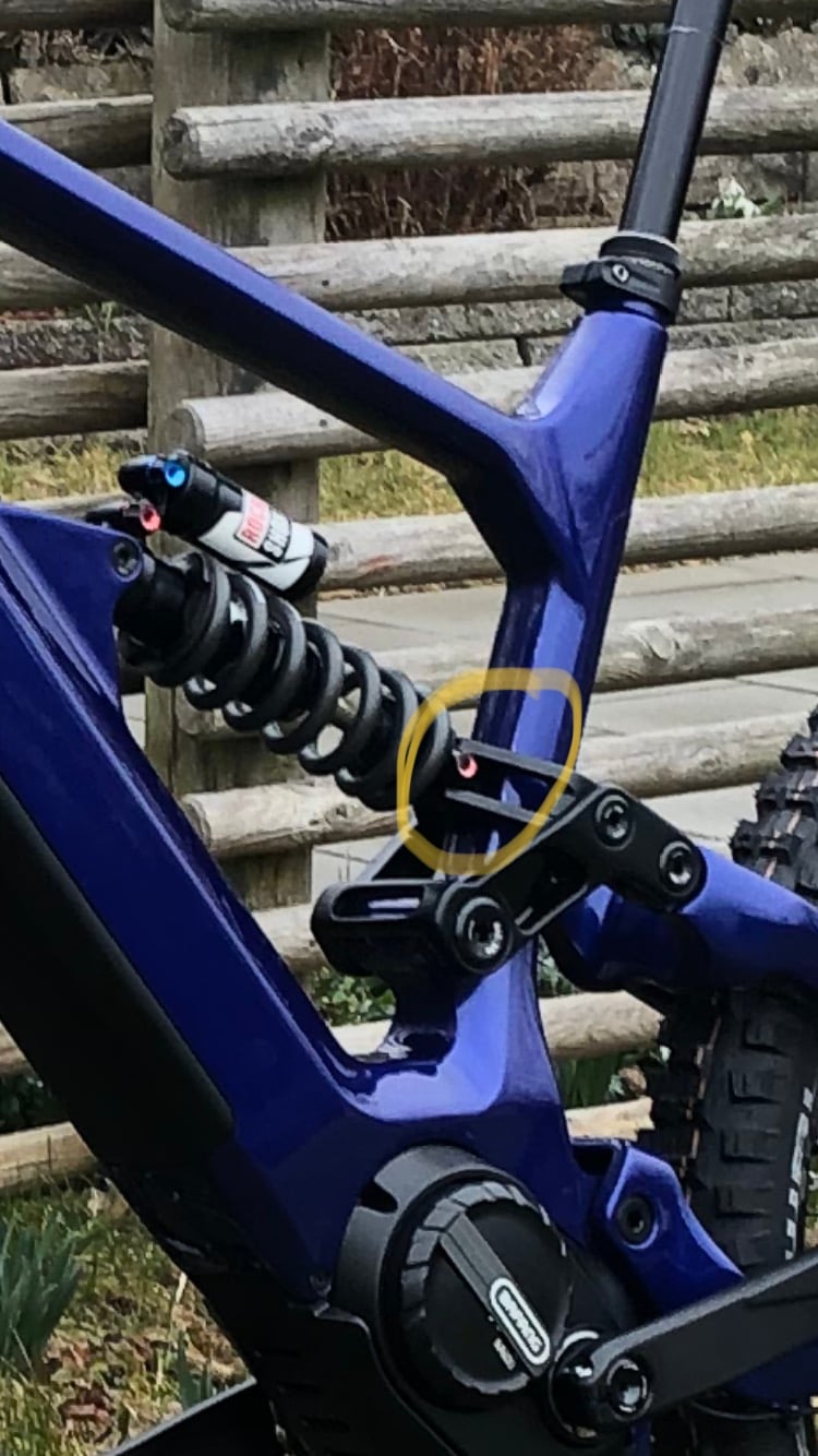

I think you are not fully compressed, you are in contact with the rubber compression stop.
hmm many I can pus som more mm out of it but I have remove the spring holder under the bumper stop an it is also a few mm think
Oh, be carefull! The rubber block will also nearly fully compress when You do a jump, may be the crossbar will hit the seattube. Do

the rubber is 12mm thick and

Did You measure the compressed length of the shock? I dont think the rubber will be compressed to zero, but at least half of the 12 mm I would asume. Considering this, at 2.5 : 1 ratio, it would mean that the addtional rear wheel travel is about 15mm.
