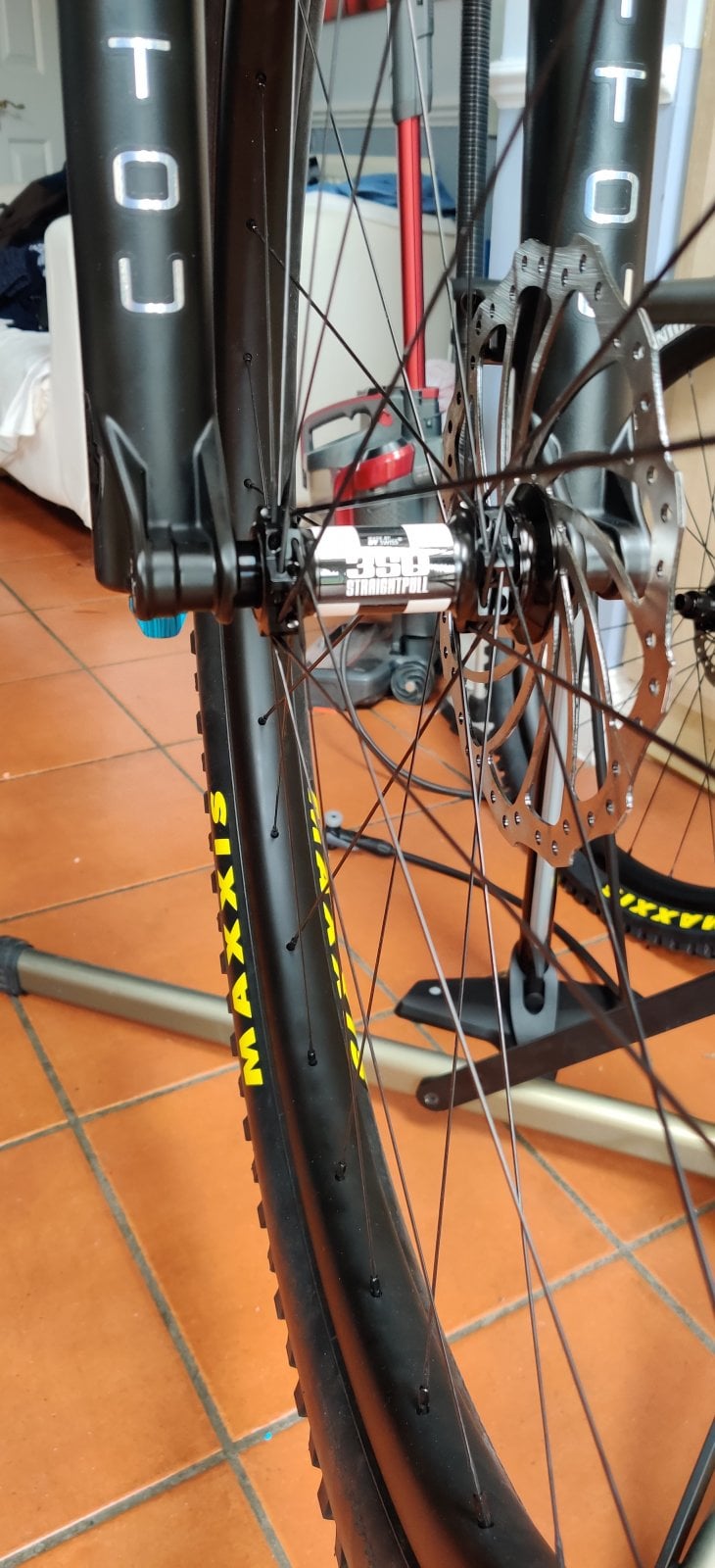

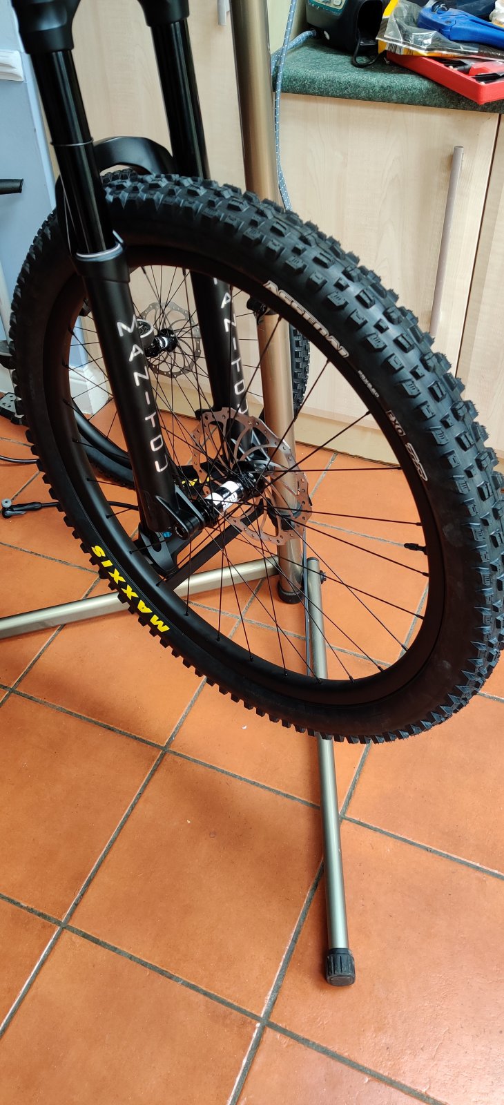

My Carbonal 29 asymetric carbon rims with Sapim CX Ray spokes and DT 350 hubs have arrived, $780 USD inc shipping, very nicely finished. I already have a similar Carbonal non-boost set for 4 years and I've never had to touch them apart from occasionally add grease to rear hub freewheel star ratchet.
I still have a long wait for the E10 frame, motor and battery, apparently shipping at end of April, I ordered 1st March. I heard Dengfu can no longer get the large 840 wh batteries and are only accepting orders for smaller 600wh capacity now. I'm hoping to receive the larger 840Wh batteries since these are what I ordered (I ordered an extra spare too). Has anyone who recently received a frame set able to comment on battery size now shipping?

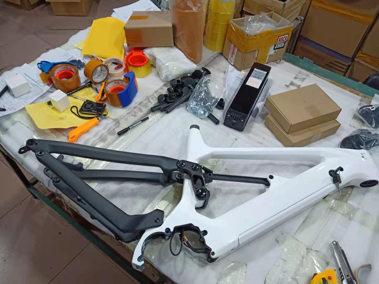

I just received my battery with 840 wh recently. I ordered back on 15th january. Still waiting for my motor (on the way) and frameset finally should be shipped next week (took longer because of custom frame color - wanted the triangle in white). Long time waiting till now but seems to get here even before my rock shox rear shok I ordered over 2 months ago ?
Puschtrale
Jan 19, 2021
220
166
Dobbiaco
Hi guys, maybe someone can tell me if i would be able to fit the RockShox Super Deluxe select + from a Santa Cruz Hightower Carbon with 210 x 55 mm? I am waiting already 9 weeks for the Rock Shox Super Deluxe Ultimate RCT Debon Air 210 x 55 mm to come and would now like to know if i can swap to the Super Deluxe select +. Are both shocks metric? Can I use the shock bushings with both shocks?
PS. Picture was send by Melody ;-). It is on the way now :)

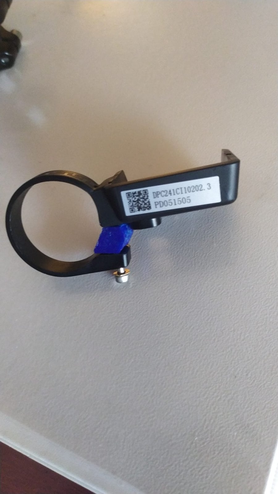

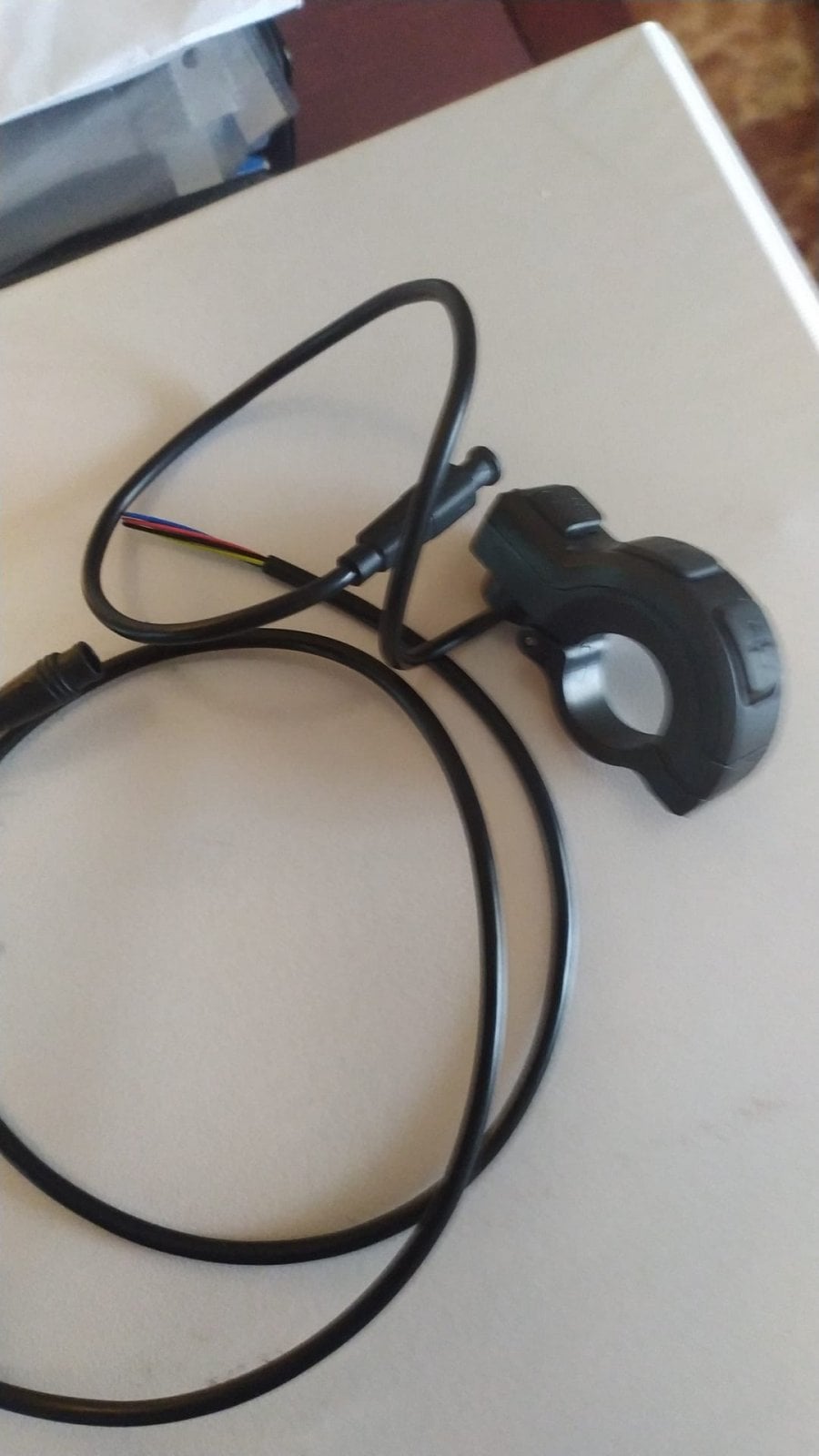

I received my M500 Motor today, Battery expected by end of this month, frame by end of this month / beginning of May. I did some assembly trials with the cockpit, and I found that the cable from the +/- unit to the monitor ist long enough to fit my 780mm bar. The only problem is, that the monitor clamp is not fitting to the 35 diameter bar. Do You have the same problem, and how did You solve it?

Hi, I've been following you guys and your build opinions etc, I was going to build my own but to save time I'm considering buying the complete bike and modify as I go. Has anybody else bought the full bike?

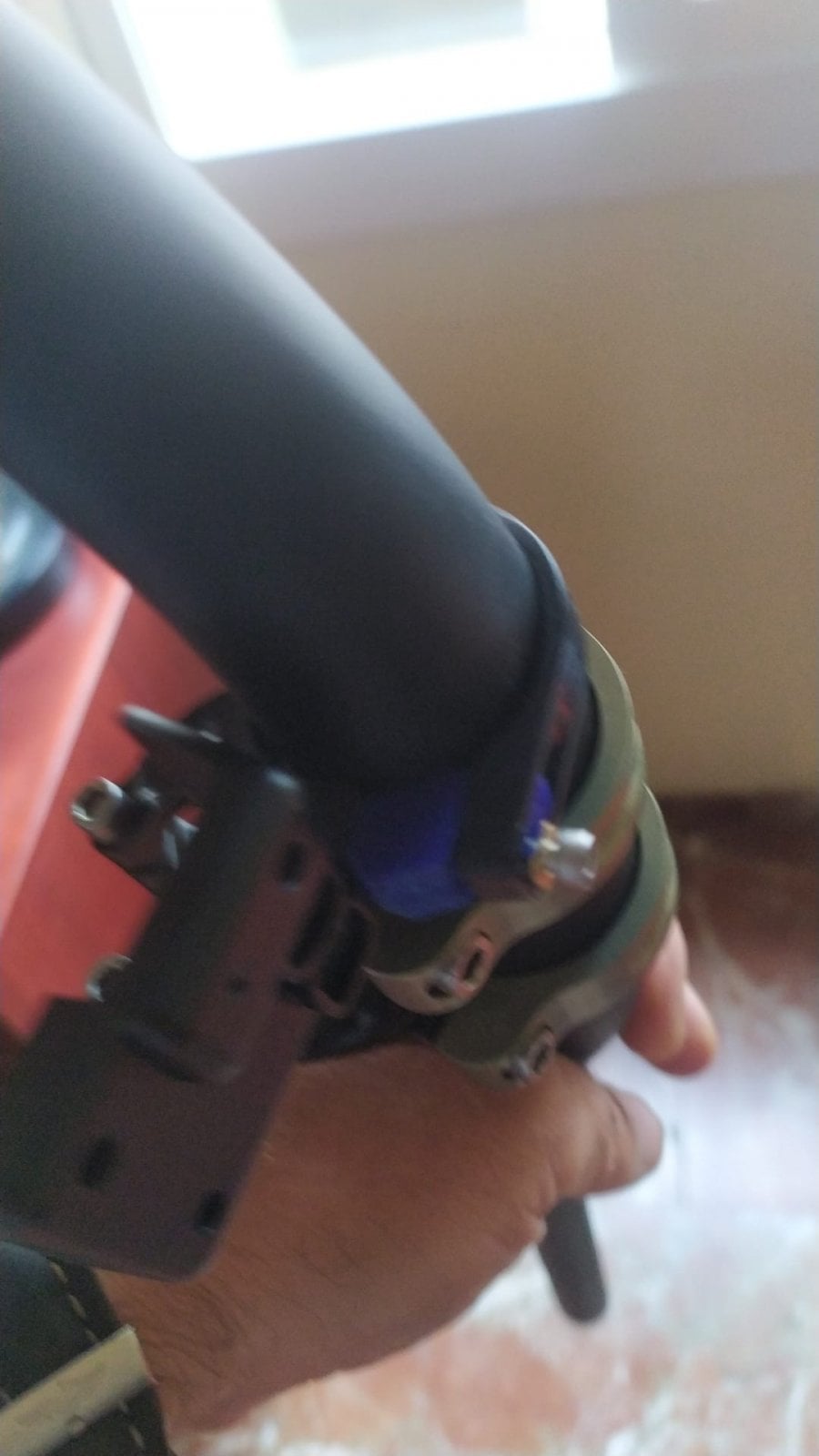

[QUOTE = "thaeber, publicación: 289217, miembro: 15200"]
Recibí mi motor M500 hoy, la batería se espera para fines de este mes, el marco para fines de este mes / principios de mayo. Hice algunas pruebas de montaje con la cabina y descubrí que el cable de la unidad +/- al monitor es lo suficientemente largo para encajar en mi barra de 780 mm. El único problema es que la abrazadera del monitor no encaja en la barra de 35 diámetros. ¿Tiene el mismo problema y cómo lo resolvió?
[/CITA]

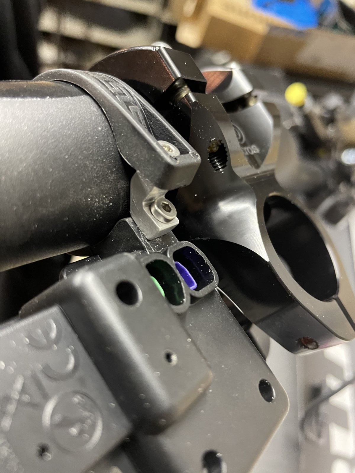

Problema 1
Con una impresora 3D
Problema 2:

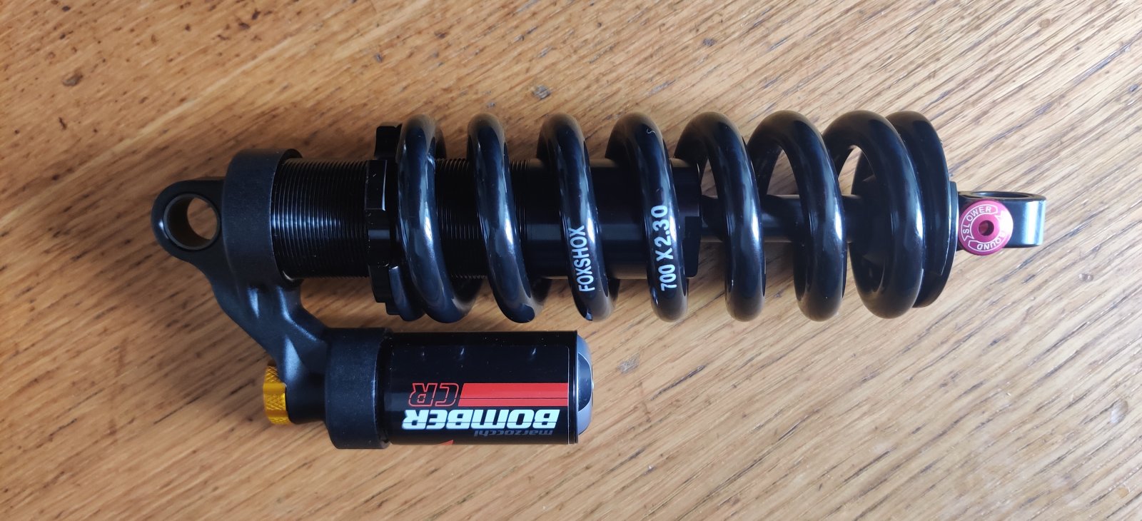

Unfortunately my weight has ballooned in lock down to 100kg+ and I'd rather not buy any scales to find out exactly how much above 100kg!
In the past I've used air shocks, but at this weight I'm concerned about blowing seals with an air shock and found a good deal on a used Marzocchi Bomber CR 210 x 55 and also found a monster 700lb spring.
I saw that some of you are using coil shocks, what is your experience with coil on the E10 frame?

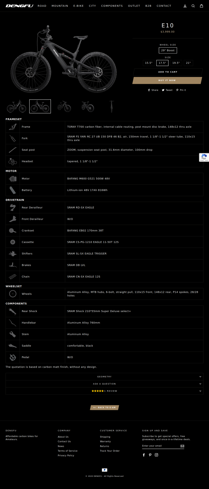

Found a copy of the missing Dengfu E-AM (E10) page on my computer (date 24-Dec-2020).
