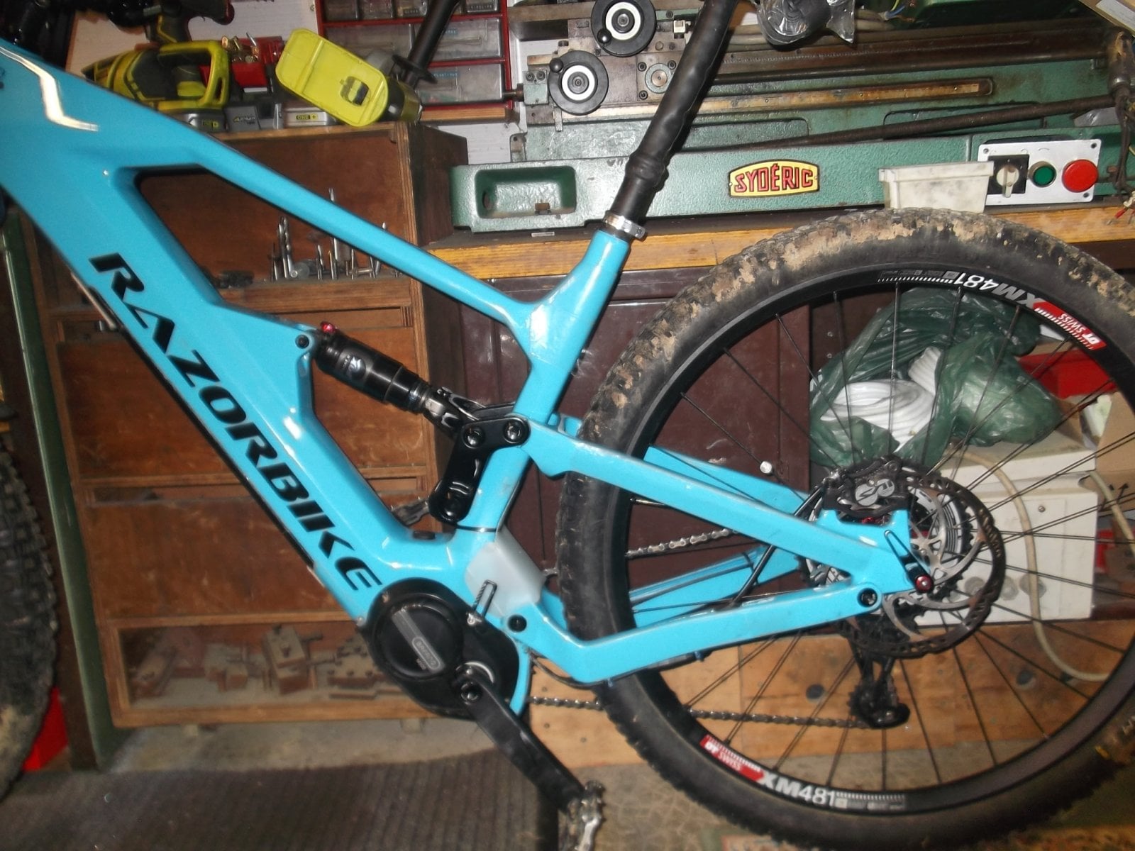

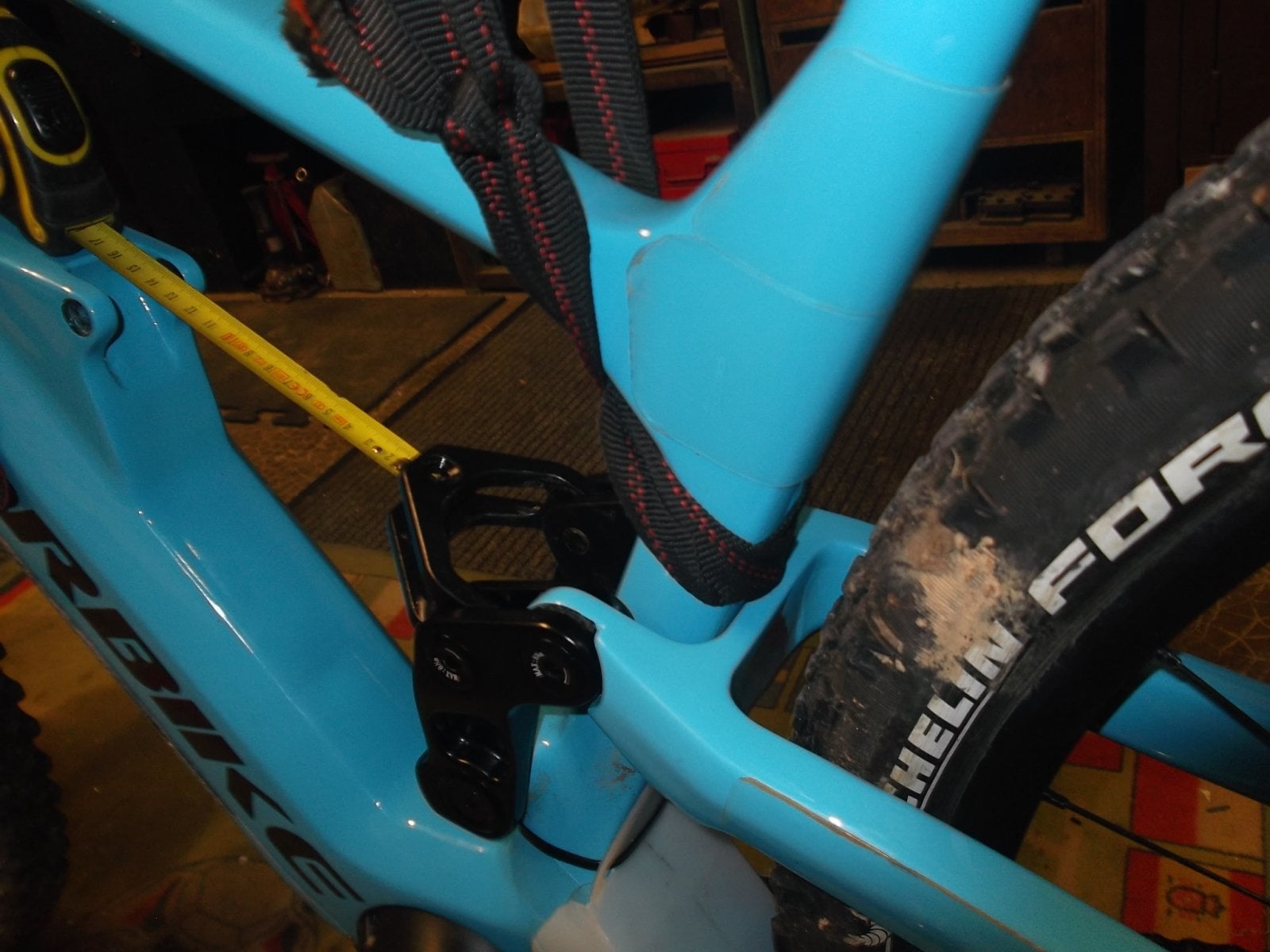

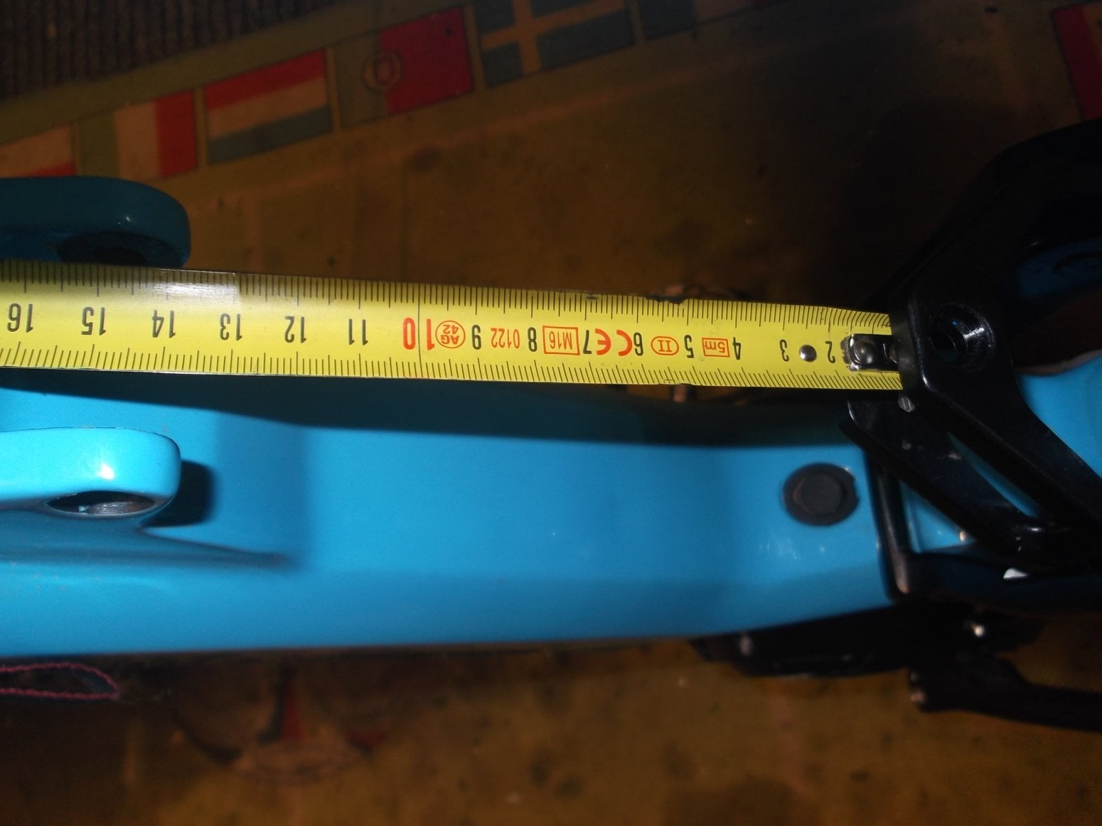

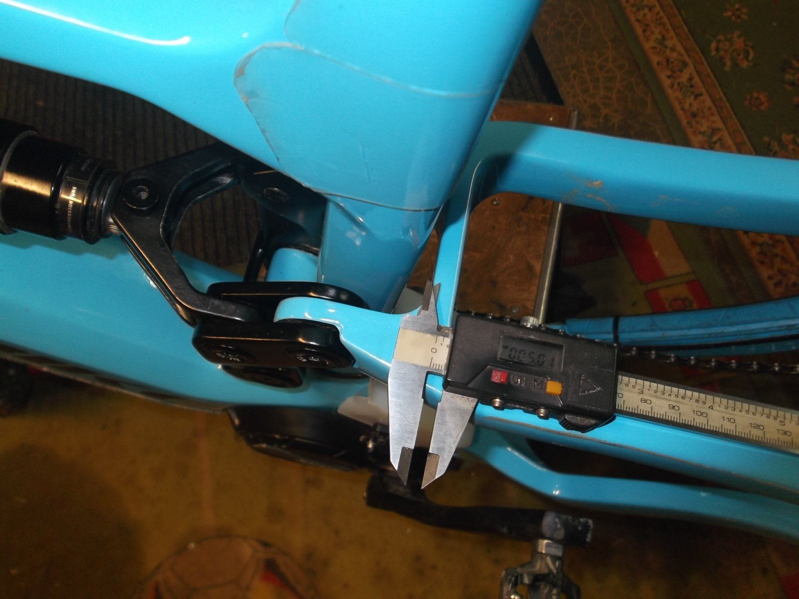

about shock usable. i will gave you the value for my XL E10 frame, with that everybody can use calculator to appreciate his size.
space available for rear shock fully compressed is 150mm (+-1)
About the modification done on yoke to use 215x60:
original yoke width is 26.4mm. i have reduced mine to 22.5.
I have mounted 215x60, after: 1) calculation 2) test. I say "on my frame it is working". May be 216x63 also, but I don't guarantee it whitout testing. This frame is not a "piece of wood", i find it permissive and may be it have some flexibilty. It is the raison why i prefer to keeep safety margin of 5mm rather less. In any case i do not recommand to use 200x57 (may be it is these people who speak about broken frame ?)
Hi Patdam, do you know how much tall is your Durolux 29 16cm?? I'm doubting between 16 or 17 cm travel fork.
iI have setted mine in 160. Durolux 29" is easily adjustable between 150 and 170, it is only little clips to position in air chamber
OK, sort of a fess up here.

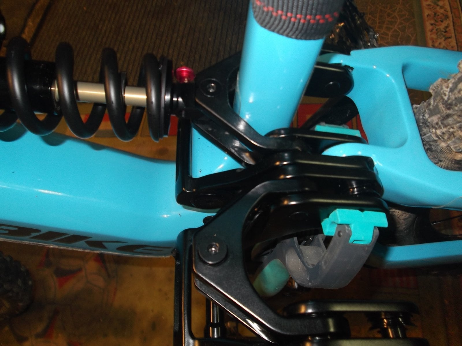

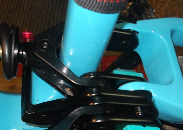

In true school boy error or in true theory not meeting reality, having measured out the 200mm shock in place in the frame and its clearance of 60mm between the seat tube and the cross bar between the top stays, one would think with a 57mm stroke you should have 3mm clearance. I thought having seen Patdams photos I had better check by letting all the air out ( I had only let 50% of the air out due to the piggy back arrangement on the DH5, where its not recommended by Fox to work the shock without pressure in it ) and seeing fully the suspension in operation. Previously with some air in, the cross piece missed by about 3mm, tick, but was that true full deflection ?
Allas its not quite true. With all the air fully out and total movement, its not so.The cross piece rotates by about 15 degrees as it goes through the 150mm range at the back, reducing as it does the theoretical clearance of 3mm to about 0.5mm. Is that enough ? Yes and no, get some mud on there and its going to be compressed.
OK how do we give it more clearance, an offset bush in the shock will give about 3mm at each end
So if you insist on using your 200mm shock as you have one sitting around as I did, then yes you can use a 200mm shock as long as its max 57mm travel, but to give yourself true mud clearance, then fit either a single offset bush or one either end to give you back an extra 3-6 mm of length and thus clearance.

You may need to check on the clearance of the crosspiece at the top of the top of the rear triangle just behind the seat tube as it will get very close to touching with the longer travel. My 200 x 57 gives 0.5mm clearance at full travel with standard bushings, to give some idea. You may have to accept a higher BB and not use offset bushings.

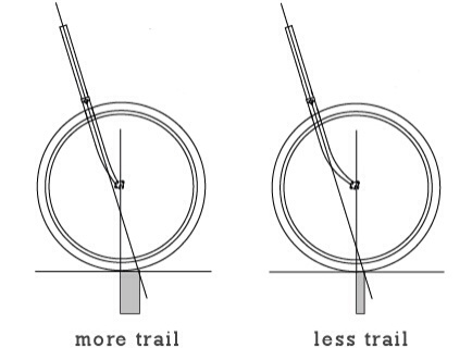

Hi guys, wich offset would you recomend for a frame size M, 44mm or 51mm. I'm planning Mullet, 27.5" 15cm rear, 29" 16cm front
I was studying how offset affects geometry but I'm not sure how to put it on the overall geometry.:cry: In theory shorter offset increases trail wich contribute to feel more confident on steps and more stable on high speed wich is good, but in some cases it would be counter-productive, so I still don't know wich offset choose :D
In Dengfu specs size 17 have 1220mm of wheelbase and 66º head angle with 560mm of fork length. I will use a 572mm fork length and mullet so my head angle will be arround 64.5º - 65º So... What do you think ????

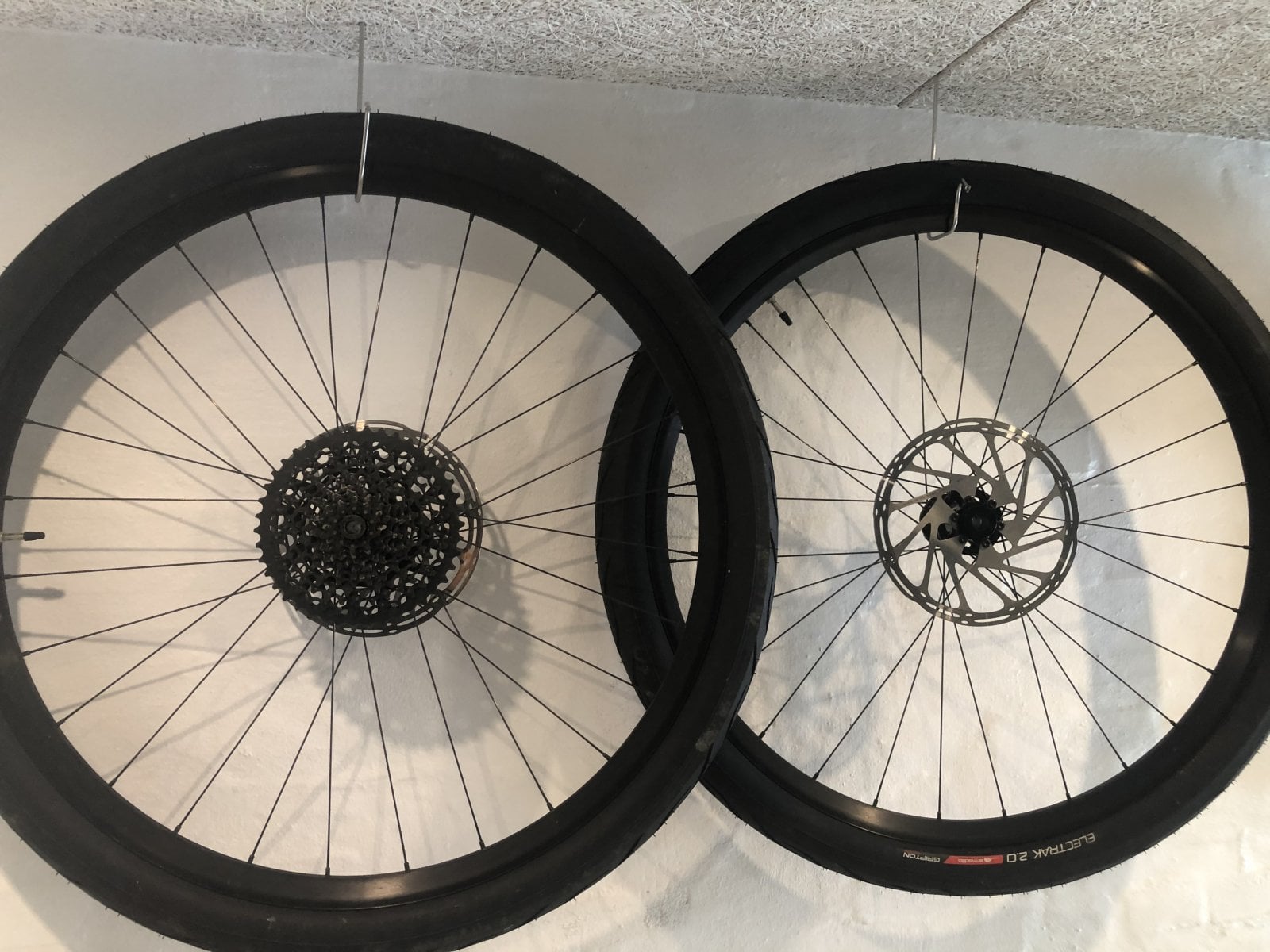

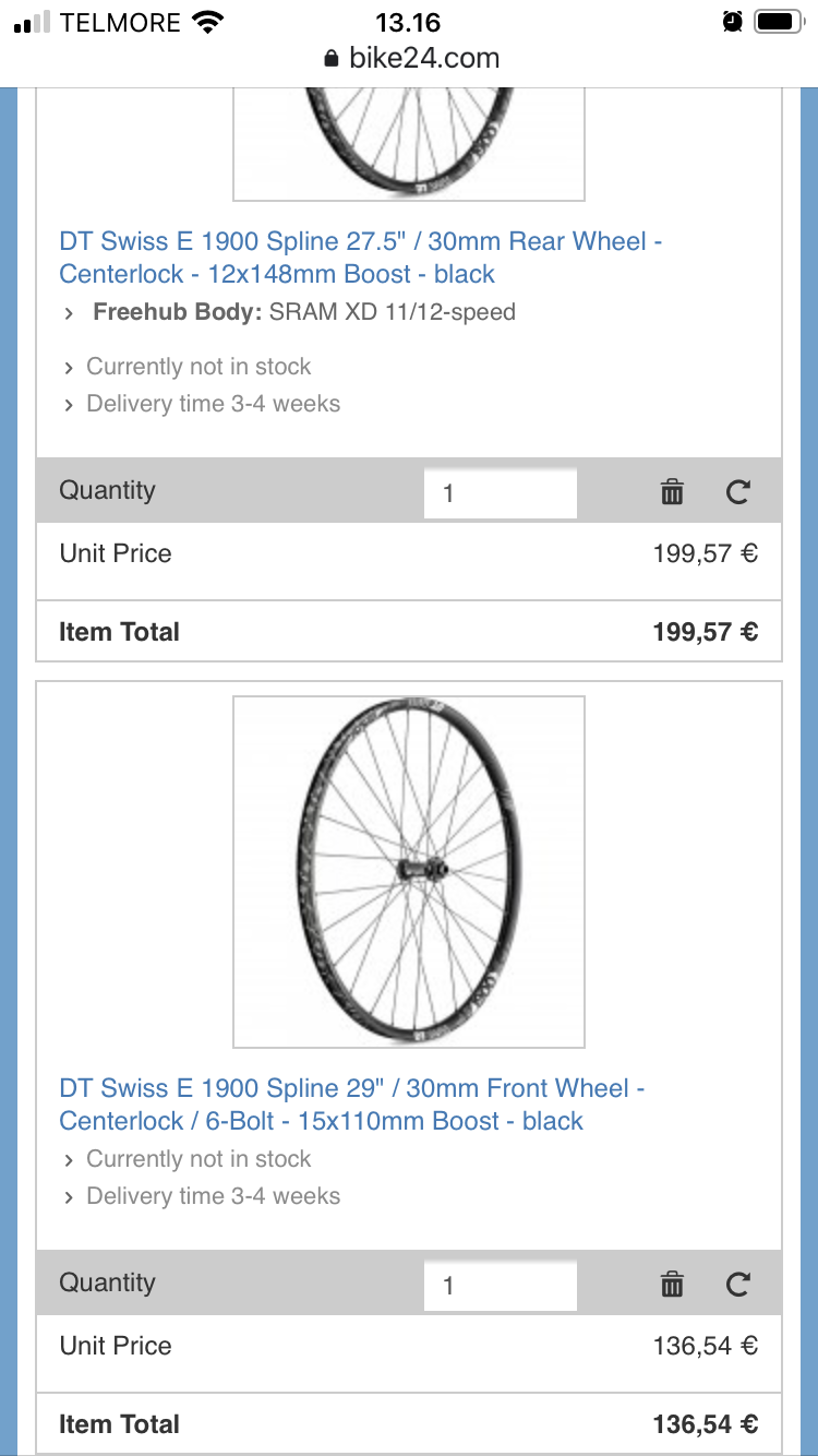

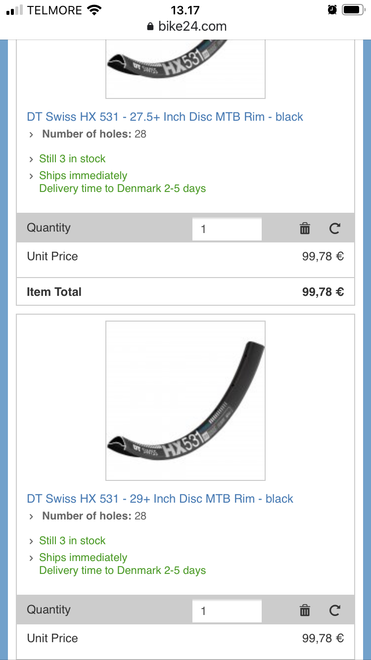

Big wheel qustion.
i want to run with mullet setup. and I have a set of Roval 29 from my former levo expert. so what would you do?
buy a Roval rims in 27.5 and rebuild my rear wheels?
buy two new DT Swiss XT 531 rims and rebuild both my wheels?
Or buy two new Dt Swiss E1900 wheels?

Do check on the suspension range without the coil on, you might be a tad long on the stroke and if so don't complain to us when the rear triangle hits the seat tube. But on the other hand it will be good to know if a longer shock will fit.
Nobody share his thinking regarding fork offset???
Personal choice following you use and wishes (stability/maniability) allready explained about size. personaly with long reach i prefer short offset. In add i can say that shorterner offset as been develloped for new geometries.
Bigger fork offset reduces the fork trail for more direct handling. If you go with a slacker steering angle, it may be benfical to use a fork with more offset for sharper handling.
