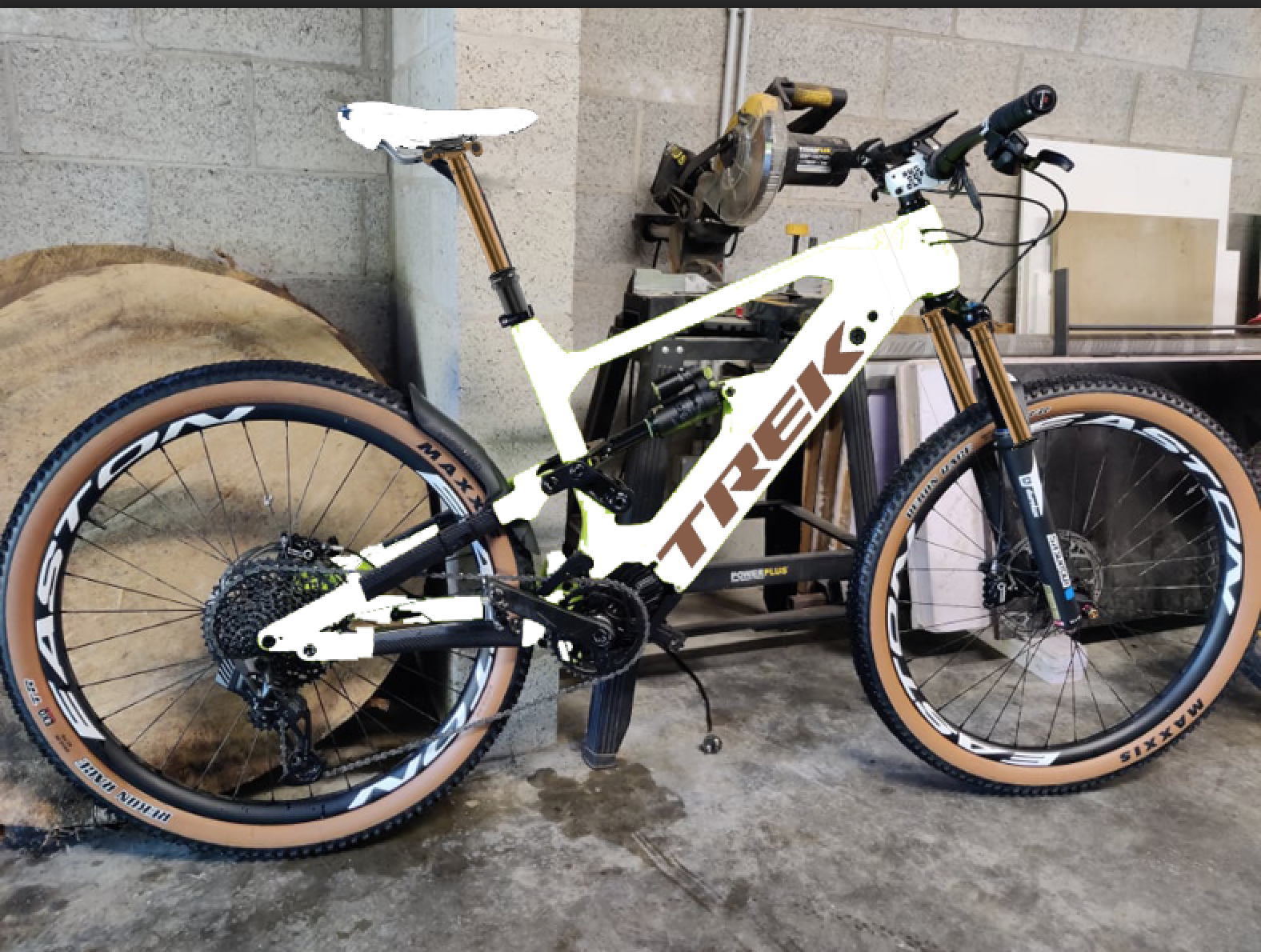

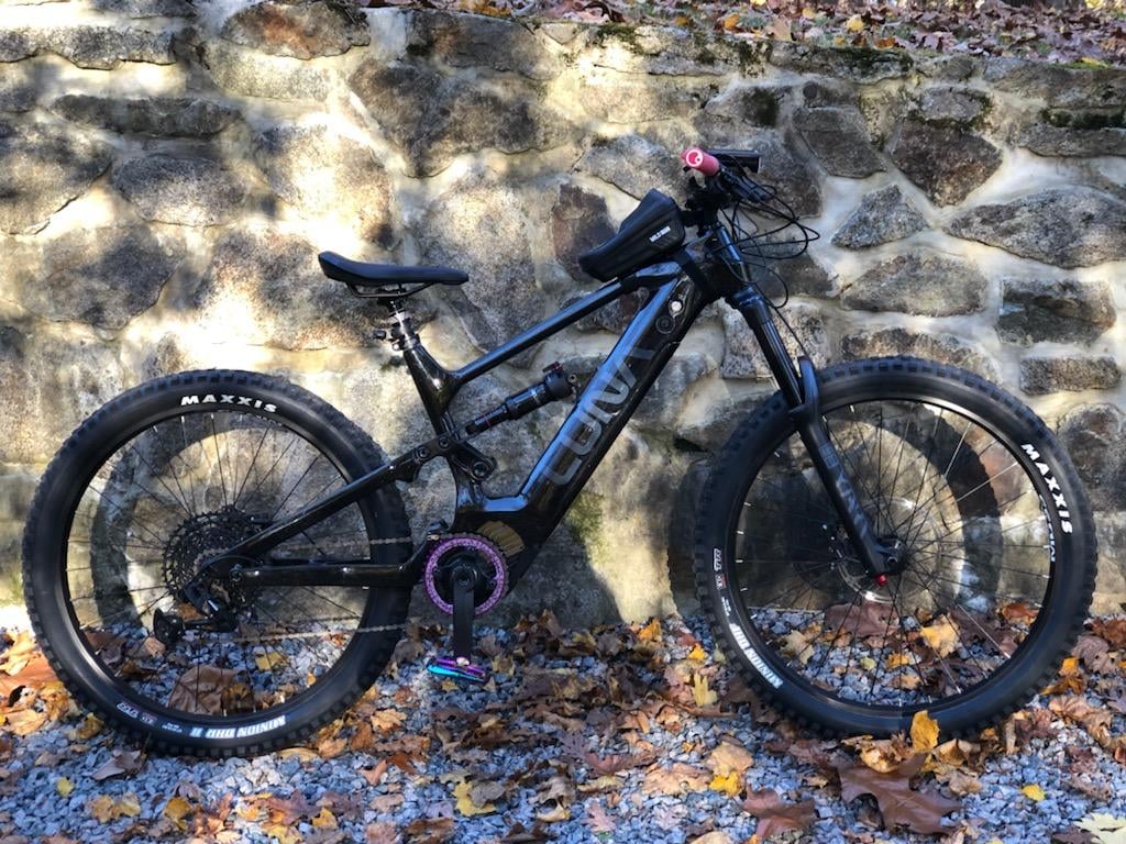

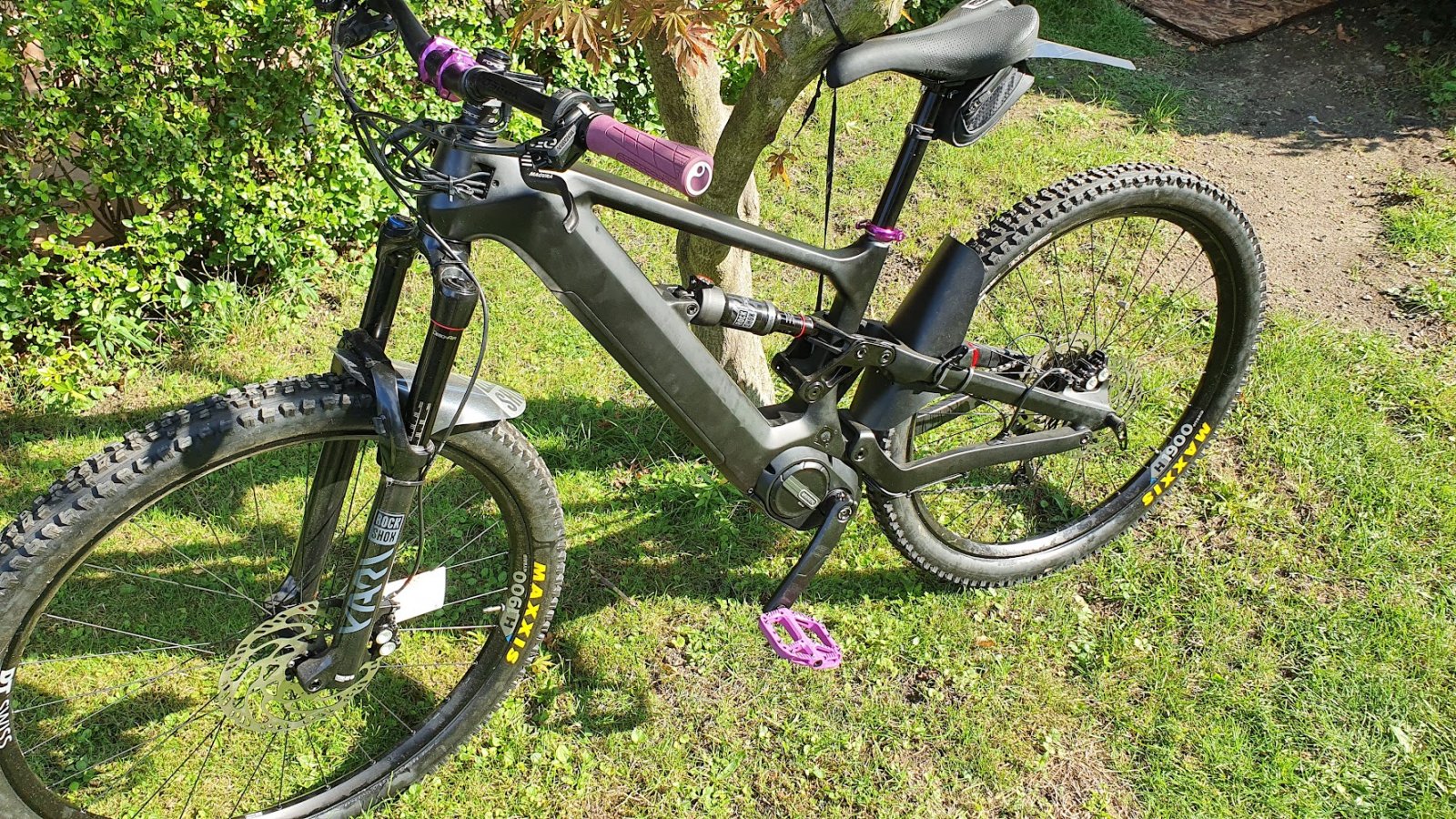

I'm still waiting for everything, but that hasn't stopped me art directing it crudely on Photoshop...
That setup looks decent👍🏿
DVO Topaz and Suntour Durolux fork is a good combo (hell, I run the same fork now on my Levo HT in 160mm travel).
Not to mention, both DVO and Suntour suspension products are fairly easy to service for any home mechanic.
Nah, I'll probably stick Fox front and rear on it.
The bike I found online with a light colour to Photoshop just happened to have a Suntour on it.
Gotta get that gold popping...

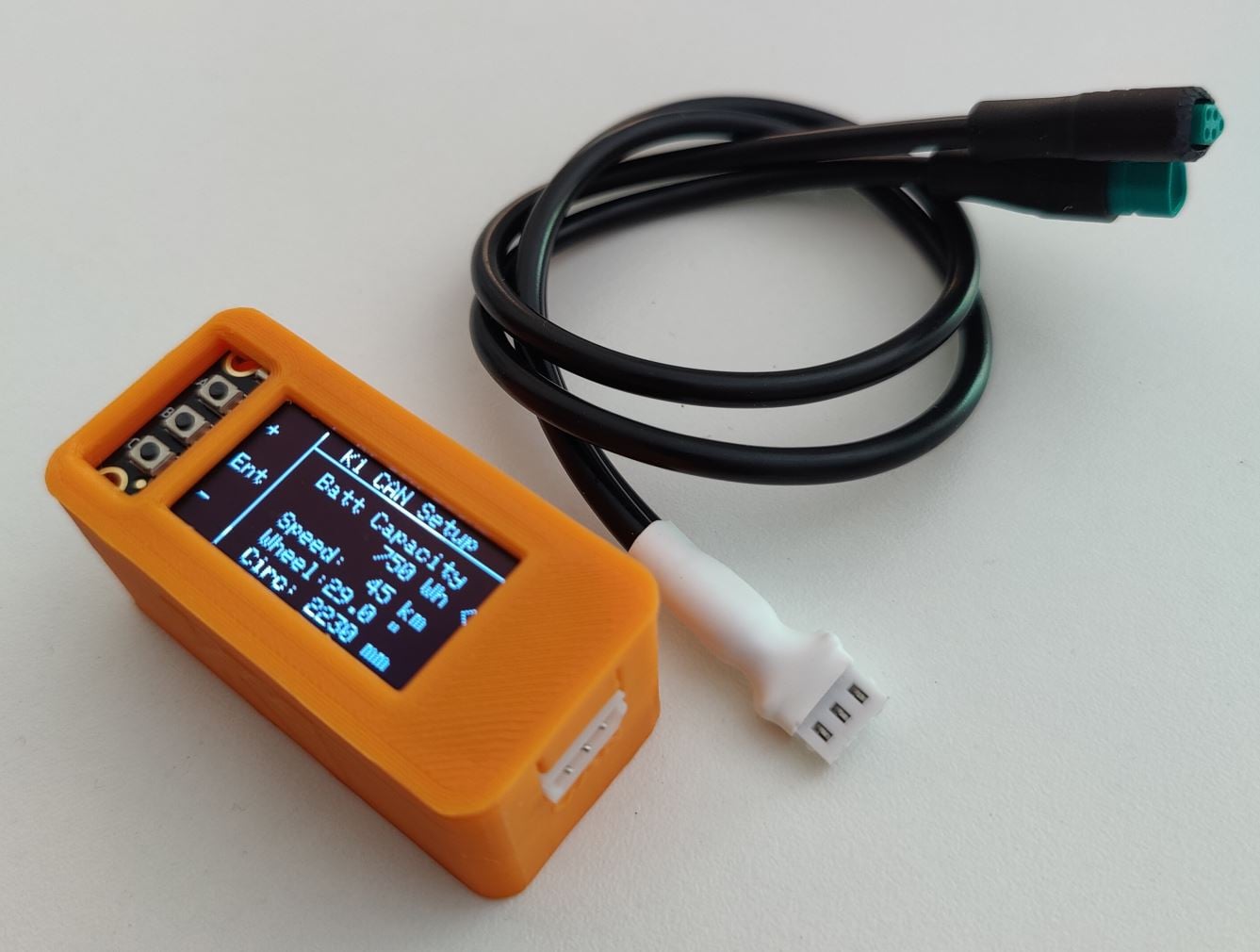

Hello ebikers.
K1 eBikes has designed small, portable and simple K1 CAN Monitor & Speed Unlocker - no need computer or mess with BESST. Works ONLY with Bafang motors with CAN bus (green connector to display with "house" shape 5 pin connector).
For more info check the following link:
https://endless-sphere.com/forums/viewtopic.php?f=31...
How to unlock speed:
https://youtu.be/6z3TzEqNWsQ
If you interested, send an email to [email protected], will answer any questions and will send user manual.
K1 CAN Monitor is determined for testing purpose only and is not waterproof.

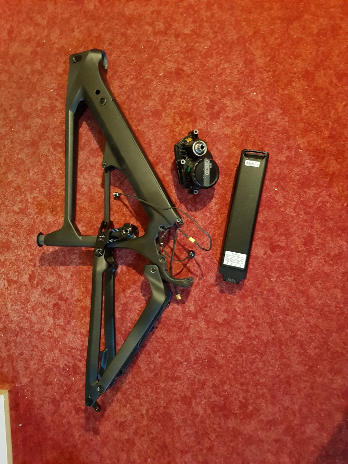

How do u Feel about running a 205X62.5 Trunnion Rock Shox Rear shock on an E10? I know the Dengfu E10 can run several different setups. I want to get the max Travel for my 54lb eBike without bottoming out. I think the 2023 Rockshox Super Deluxe Ultimate is my next Rear Shock|( I think it's the right answer for me but I have a lot to learn). Currently running stock LUNA suspension I run Rock Shox Select+ rear shock 210x55 which gives me 160mm travel in the rear. But yours is longer in the eye to eye and 60mm stroke but only 150mm rear travel? I don't understand how u have +5mm rear stroke on your rear shock, but less travel than me who runs 210x55mm on my E10. I run 160mm Yari upfront rebuilding to 170mm or 180mm Lyrik internals RCT2.1. But when it comes to my Rear shock, I want the best, I want something designed to take the extra weight for the frame. I only weigh 150-155lbs depending on the day. My current setup of 160/160 travel front and rear. These stock shocks of X2 are fine on gravel, road, & flat trails. But the single track, dirt, downhill it can't handle the hits it's not heavy-duty enough. Just Doesn't have the durability, & tends to come really close to bottoming out. So for now that was my plan. I wanted to ask what is your front fork, & rear shock travel and why you went with that? Sorry I'm kind of a newb, trying to learn.

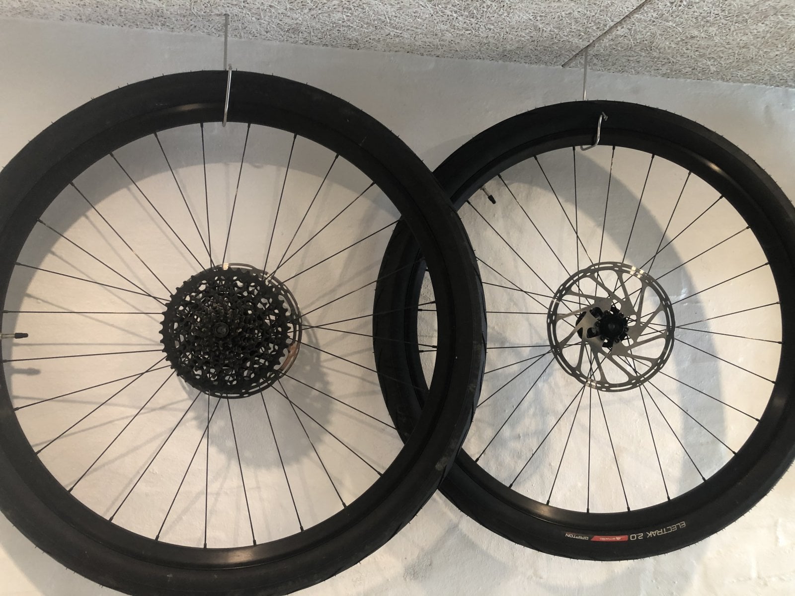

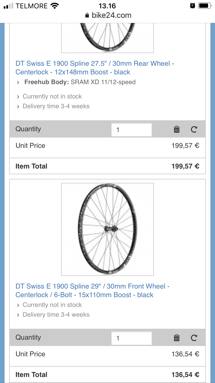

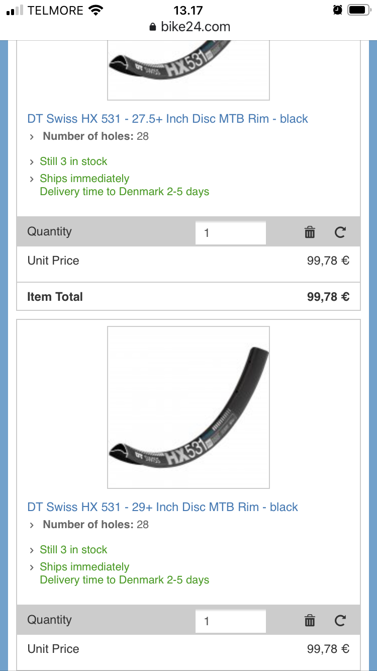

Big wheel qustion.
i want to run with mullet setup. and I have a set of Roval 29 from my former levo expert. so what would you do?
buy a Roval rims in 27.5 and rebuild my rear wheels?
buy two new DT Swiss XT 531 rims and rebuild both my wheels?
Or buy two new Dt Swiss E1900 wheels?
Nice I'd buy RaceFace ARC35 Offeset rims, or DT SWISS XM 521 or FR541. But I like my tire sizes to be able to fit the Cushcore + insert and I ride 27.5x 2.8" front and back, considering going to a 2.6" in the rear though. Never ridden an MX bike so I don't know much about that. Except the front is 29" rim and the rear 27.5". I do know my Online friends in BC I turn to a lot for performance part questions like to run 2.4-2.6" tires no matter if 27.5" or 29" but they all seem to run 0.2" smaller width in the rear.

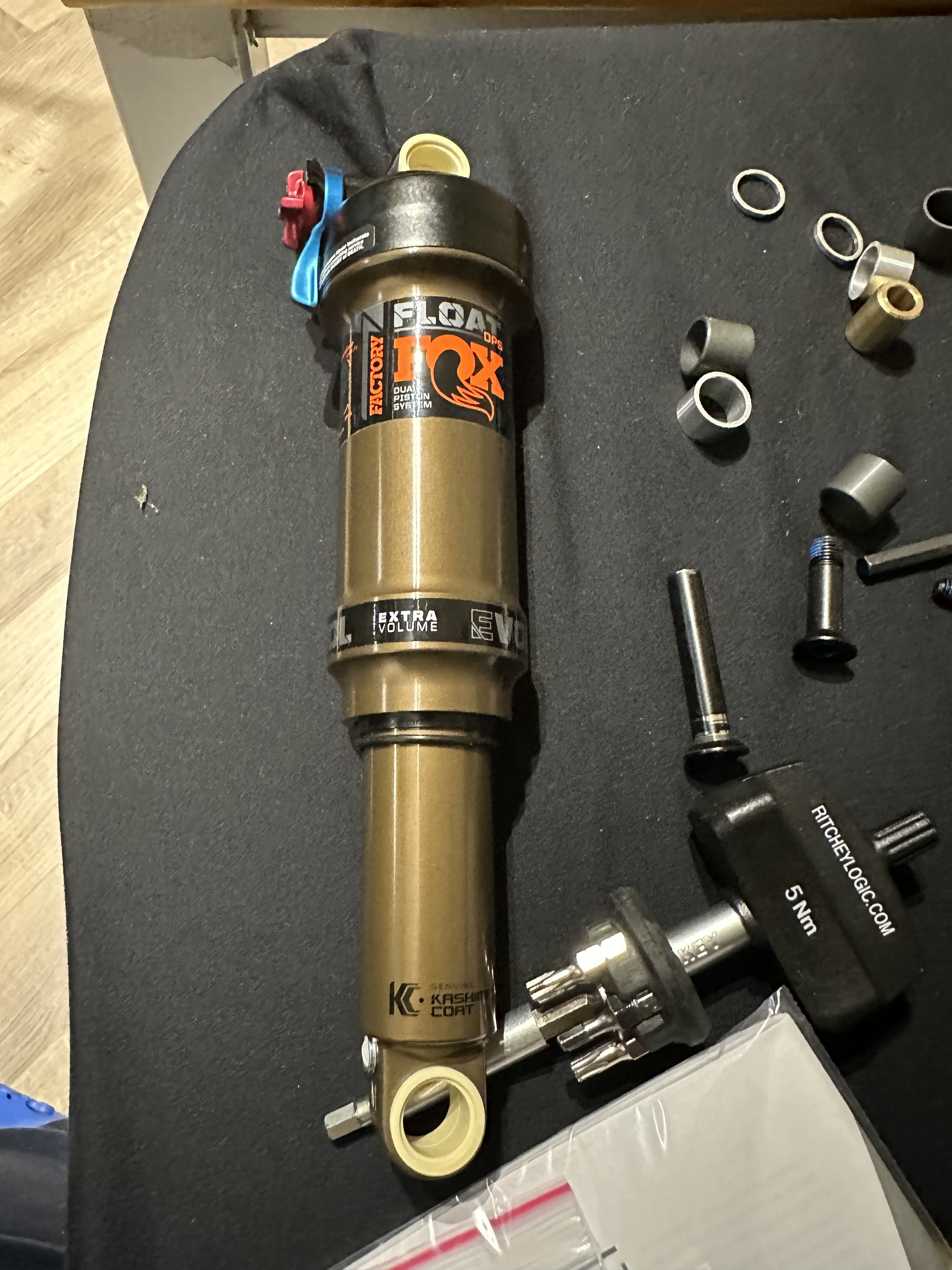

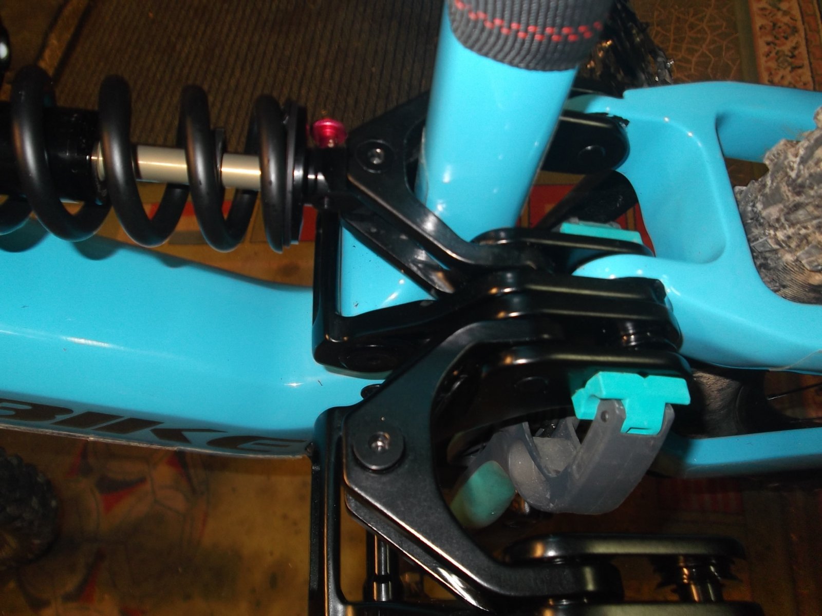

Can some help me with a rear shock selection for E10. I got this by accident but it seems like it doesn’t fit due to vertical/horizontal alignment 🙃
The bushings from Offset only have 2 mm offset using 8 mm bolt diameter at the E10 frame. 3 mm offset is only available for bushings with 6 mm bolt diameter. Be careful if You use 2 mm offset bushings on both sides. The reduced shock length of 216 - 4 = 212 mm will result in a fully compressed length of 212 - 63 = 149 mm only. The rear triangle may crash into the seattube in case of a hard impact landing. I measured it, I tested it with no air in the shock. I decided not to take the risk, used only 1 offset bushing, and reworked the yoke accordingly.
Just so I am getting this right, can I use offset bushing(-s) with a 210x55mm (coil) shock, or would that (likely) make the rear triangle hit the seat-tube?
210mm-0mm-55mm = 155mm (official spec)
210mm-2mm-55mm = 153mm (seems safe?)
210mm-4mm-55mm = 151mm (still safe?)
TIA!
