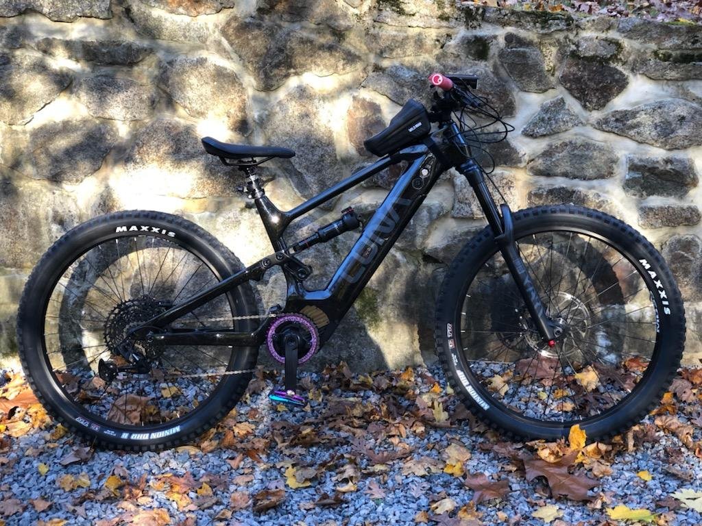

Can anyone tell me where I can get the custom Yoke to put a 215x60mm Rear Shock on my E10V2? I found offset bushings, I am not very mechanically inclined and I ride hard. Single track downhill. I need to be sure I will get full travel without it striking against the seat post. I am in the middle of about 10 different mods, going from 70mm+6 degree stem to 50mm 0-degree stem with high rise 35mm Rise x 35mm Raceface Atlas bar. Also ordering new groupset & Wheelset. Final step is to upgrade the rear shock & go to the 2023 170mm Zeb Ultimate for 27.5". I notice my Bike is a little tight for me, but the Large is big. I feel like maybe someone can tell me of a few mods to extend the reach besides just the stem and the handlebar. I also just installed the TRP DH-R EVO Brakes & I wish I had gone with MT7. But the rear caliper came DOA, so I am a little pissed about that. I am reading Shimano levers with Magura give you the benefits of the best of both worlds that TRP was supposed to have built-in. I hate the TRPs so far. Thanks for any and all help.
Sounds strange. I run the more common 216x63 on my E10, using one offset bushing on the yoke side (-2mm installed length = 214mm) and I milled away a little aluminum on the yoke, just enough that the yoke clears the seattube with the longer shock. I never had an issue with my 27.5 / 2.6 rear wheel hitting the seattube, nor the seatstay bridge touching it (Yes, I bottomed out the shock a couple of times). If Your shock is really 215x60, just install it and rework the yoke to make it fit.
